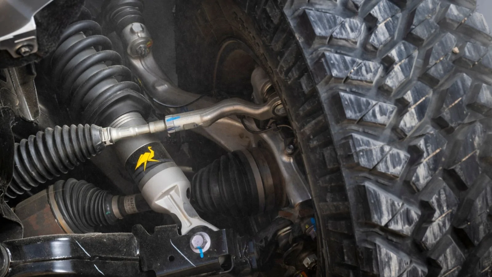

If you're building a 4th gen Tacoma, suspension is the smartest place to start. It's the foundation every other mod sits on. The height to clear bigger tires, the travel to soak up the trail, the capacity to haul what you're about to add.
Whether you're still on stock and ready for your first lift, or you've outgrown a budget kit and want real performance, the goal is the same: a tuned and matched 4th gen Tacoma suspension system designed around how you actually use your truck. And we’ve got the best options for your truck.
Old Man Emu: The Best Suspension Options for the 4th Gen Tacoma

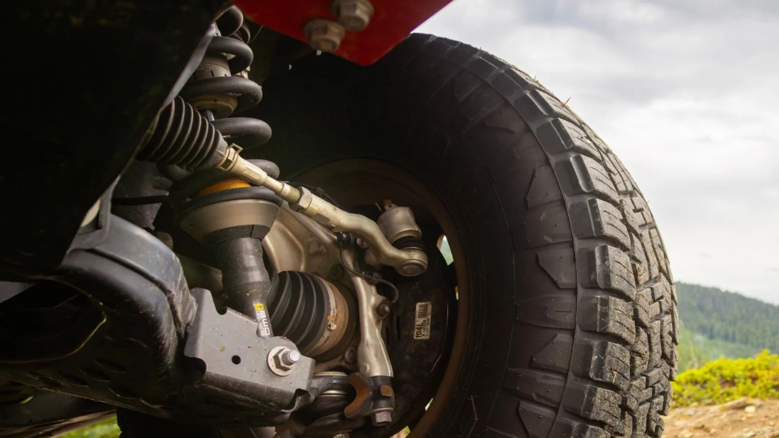

Every one of our kits is an integrated system, with coils, shocks, and valving tuned for your weight and use. For the 4th Gen Tacoma, we offer two options: the big-bore MT64 and the fully adjustable BP-51.
The MT64 is one of the largest monotube shocks on the market. Its big 2.8in aluminum body holds more oil for better heat control and consistent performance, on the trail or the daily commute. It stays smooth over everyday bumps, firms up the moment the terrain gets rough, and cushions the big hits you don't see coming.
The BP-51 is OME's flagship and the most capable shock we build. It's fully adjustable with 10 levels of compression and rebound, tuned right on the truck with no tools. The remote reservoirs hold extra oil to keep the shock cool on long days off-road, and its position-sensitive design blends highway comfort with off-road control.

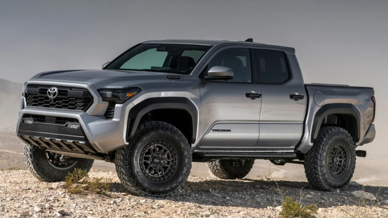

Every 4th gen Tacoma kit in both ranges gives you 3 inches of front lift, enough to level the factory rake and clear larger tires. What separates the kits is how each one is matched to weight.
Up front, BP-51 coilovers are rated for a 0–330 lb front accessory load, so a bumper-and-winch combo won't drag the nose down. The rear is where you really tailor the kit, with configurations matched to the constant weight you carry: 0 lb for a mostly stock rear, 440 lb for a moderate build with a rear bumper and gear, or for BP-51 only, 880 lb for heavy rigs loaded down with gear.
You don't need to put your truck on a scale. Just think about how you'll use it. Will it be a daily driver, weekend overlander, dedicated trail rig, and figure out what you plan on constantly having in your truck. That points you to the right front and rear ratings. We'll go deeper on load ratings in our next post.

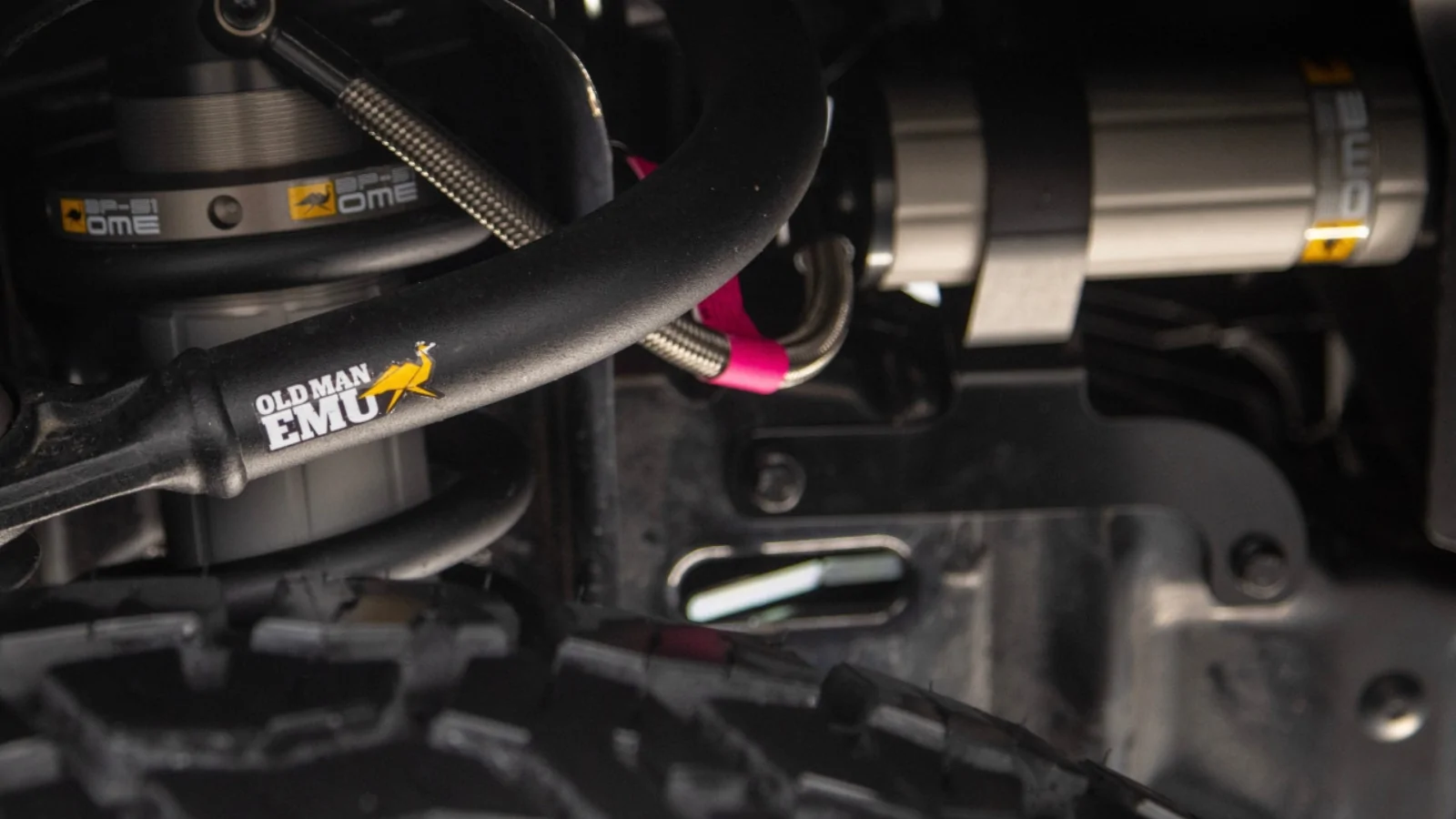

You'll spot some kits labeled w/UCA and some without. But do you really need to upgrade your upper control arms?
At 3 inches of lift the front geometry shifts, and ARB's matched upper control arms put your alignment angles back where they belong, free up ball-joint clearance at full droop, and toughen things up for hard trail work.
But we want to hear from you–who's running aftermarket UCAs on their 4th gen? Worth it or not, and why? Drop your take below.

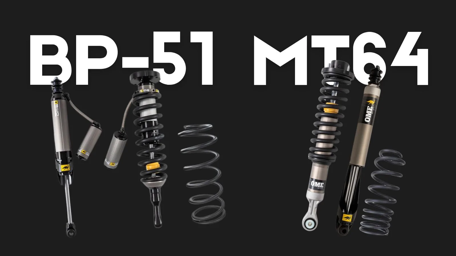

Go MT64 for a big, do-it-all monotube you set and forget. This is the best option for overlanding, towing, and daily driving. Complete kits start around $2,280, or about $3,280 with matched UCAs.
Go BP-51 for on-the-fly tunability with 10 levels each of compression and rebound, adjustable right on the truck, and the sharpest performance OME makes. Complete kits start around $3,290 and top out near $4,290 with UCAs.
Whichever you pick, you're getting more than parts. Every OME kit is designed, tested, and built in-house by ARB and backed by our 3-year warranty.
