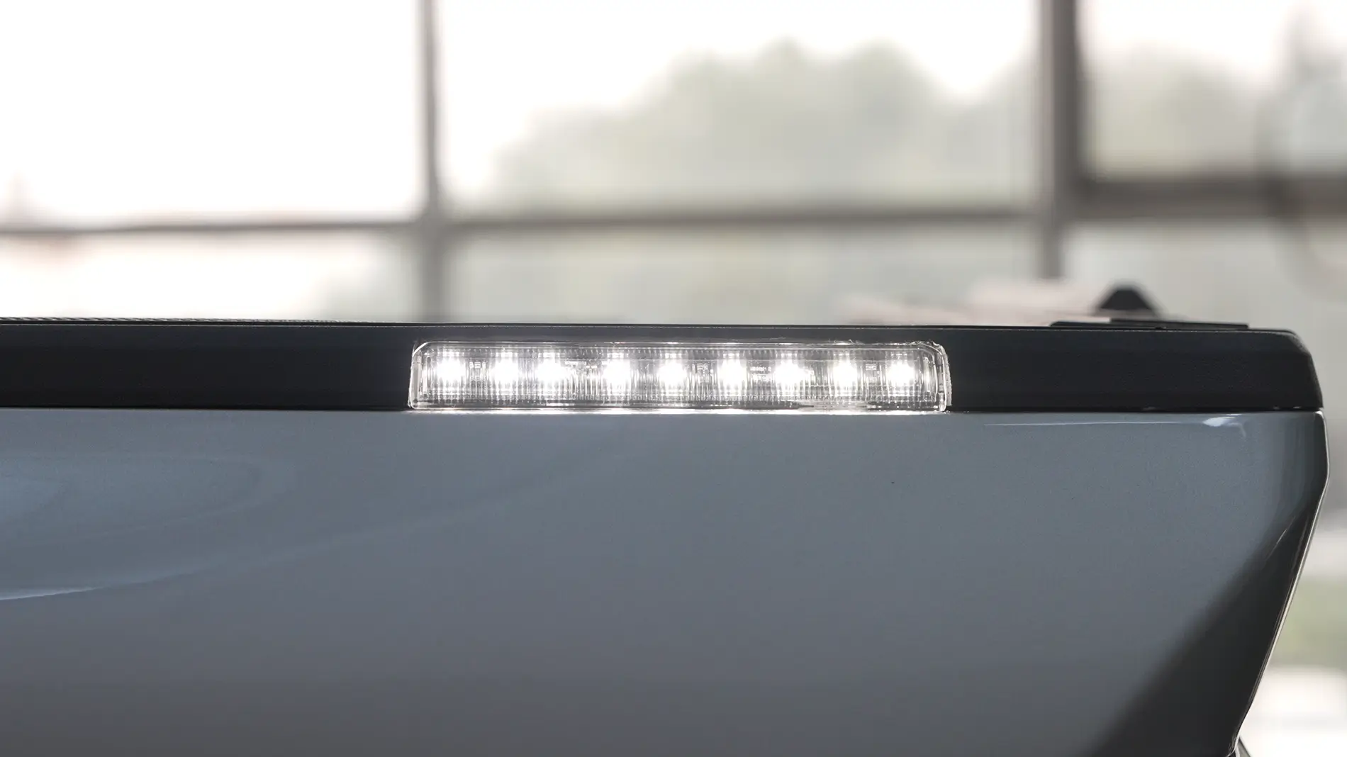

We recently went through the process of adding bed scene lights to a base-model Tacoma that didn’t come with factory ones. I wanted to share a quick breakdown of how the install went.
I’ve put together a few photos and basic steps below in case anyone is working on a similar project. Hope this helps!

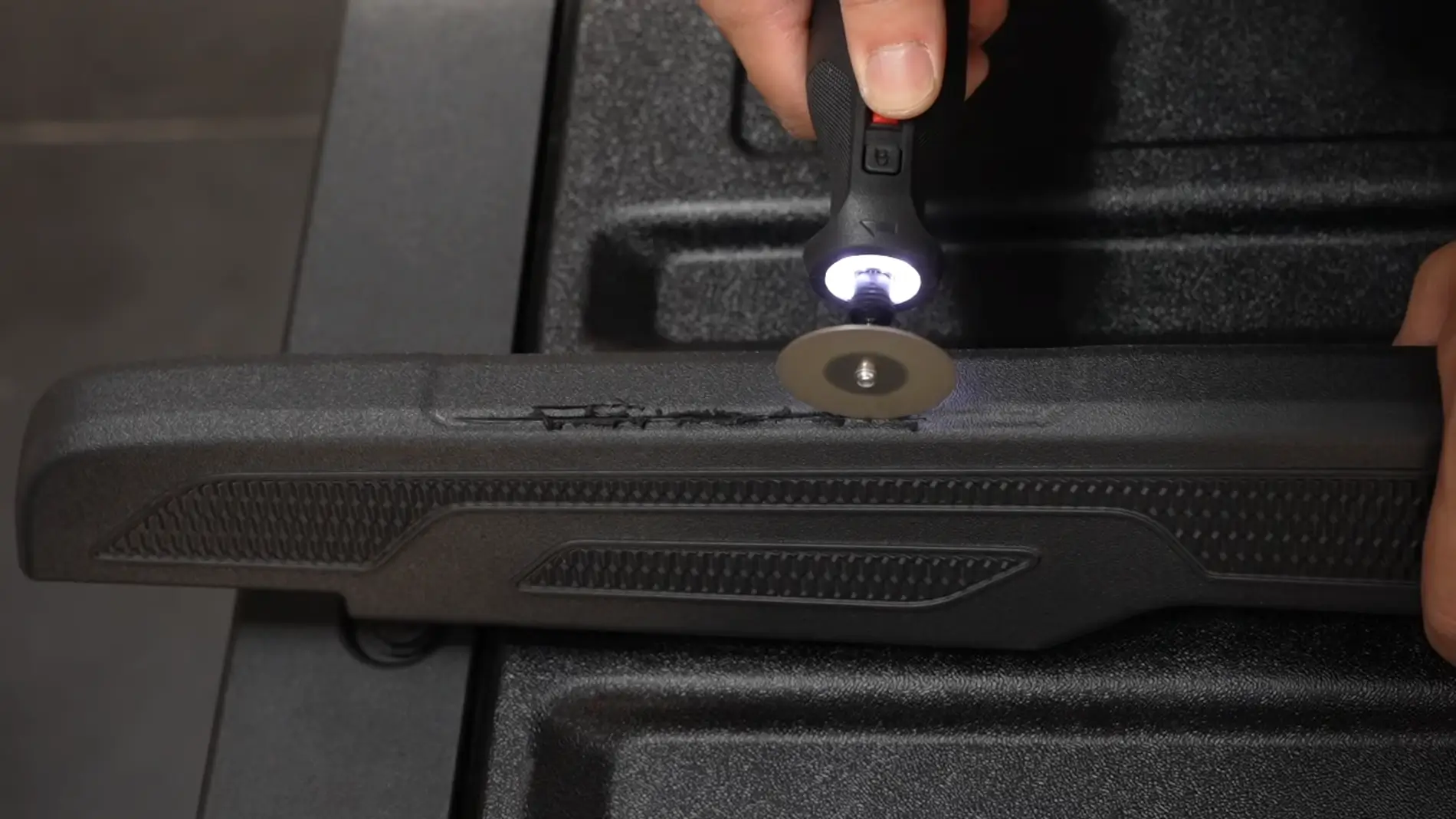

First, pop off the bed rail cap. Use a rotary tool (like a Dremel) with a cutting wheel, and carefully cut out the openings along the factory-molded guide lines.
2024 Tacoma How to Add Bed Scene Lights to a Base-Model Tacoma SR5 installation (11)

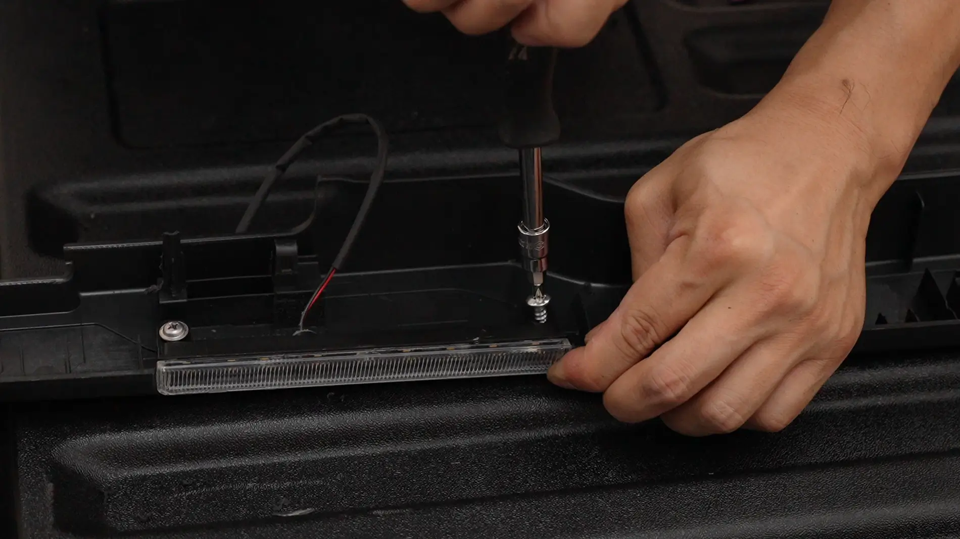

Next, insert the scene lights into the cutouts you just made, and secure them using the factory mounting holes on the back.

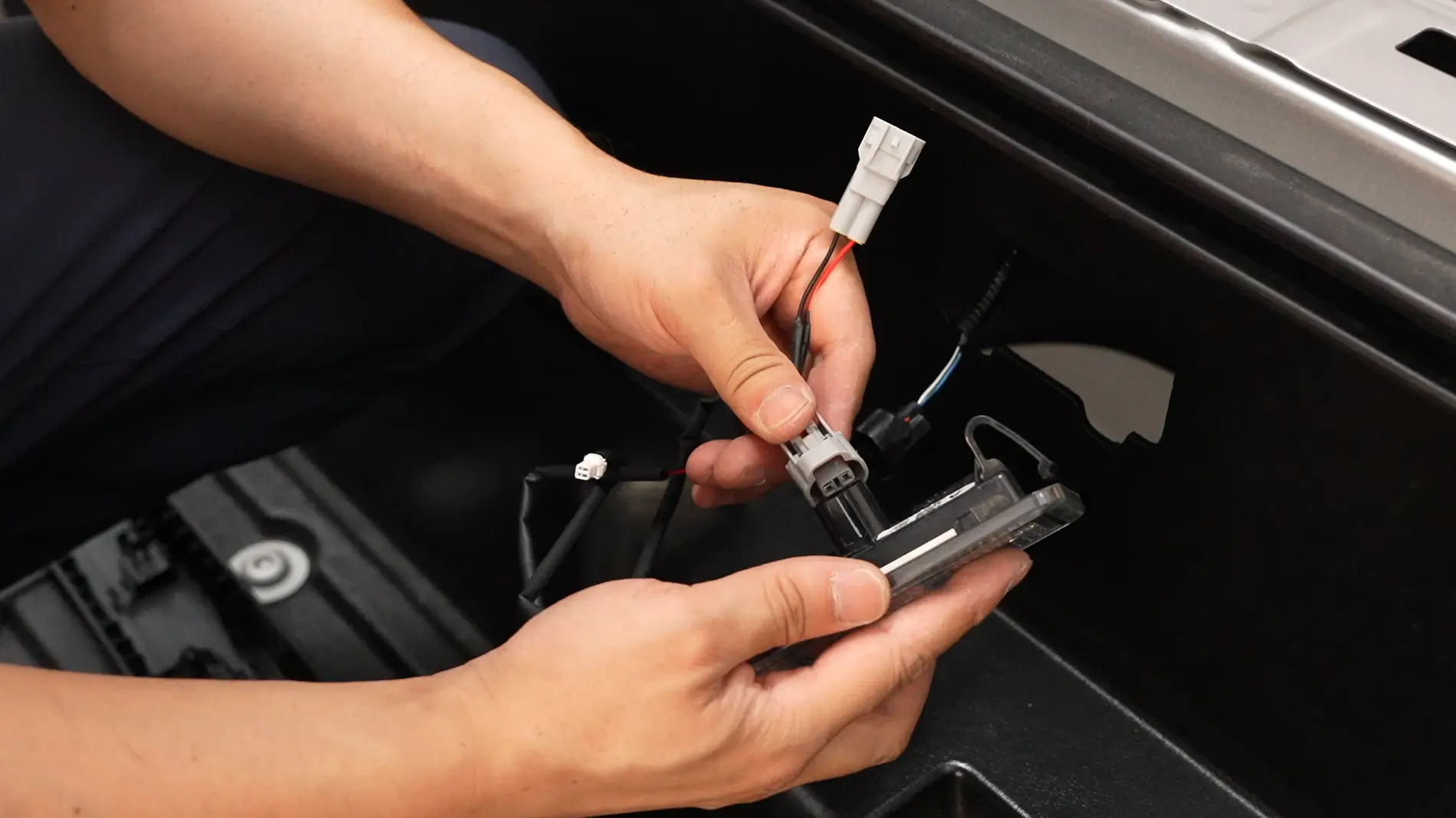

Moving on to the wiring. Remove the factory side light and unplug it. Then, use the splitter harness to connect the factory plug, the side light, and the new scene lights.
2024 Tacoma How to Add Bed Scene Lights to a Base-Model Tacoma SR5 installation (1)
2024 Tacoma How to Add Bed Scene Lights to a Base-Model Tacoma SR5 installation (7)

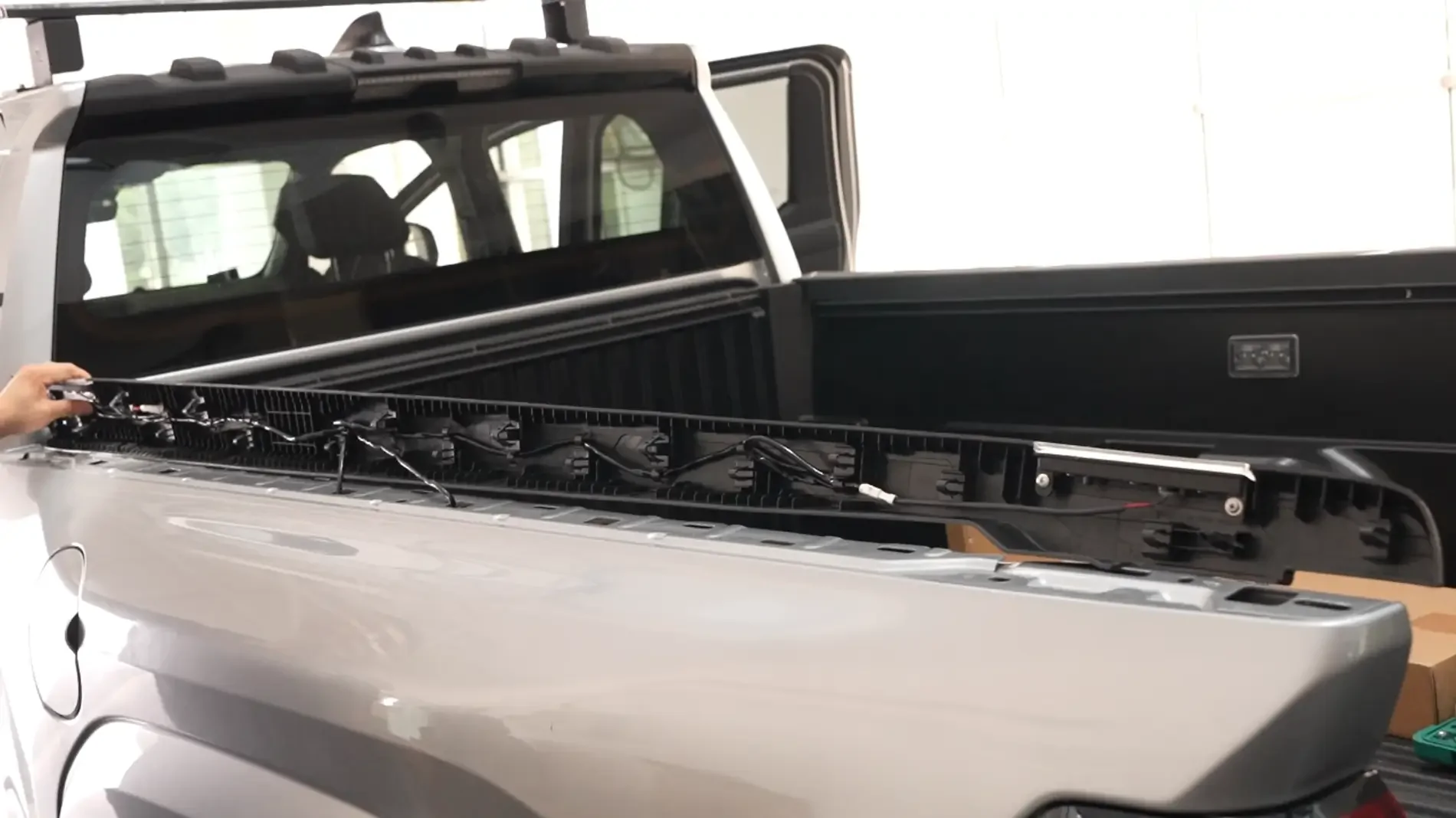

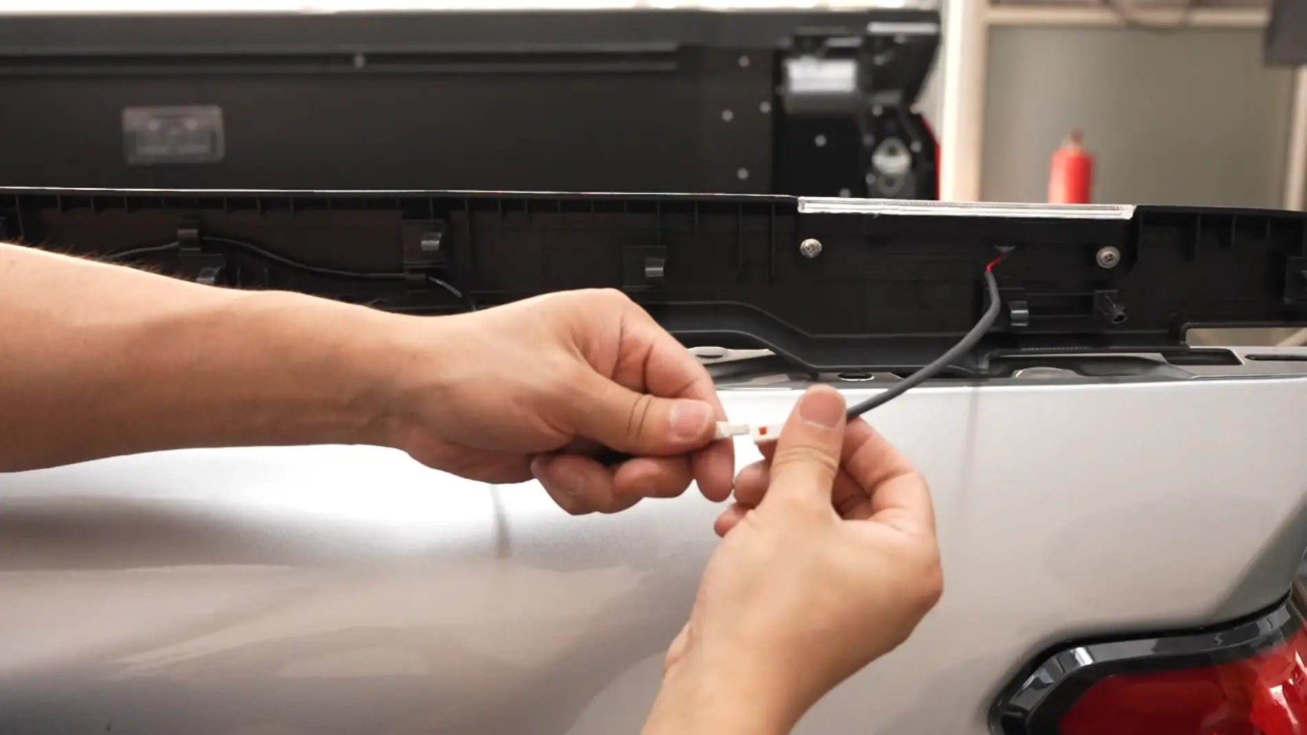

To keep things looking clean, route the wire under the bed rail cap and secure it in the clips.
2024 Tacoma How to Add Bed Scene Lights to a Base-Model Tacoma SR5 installation (8)

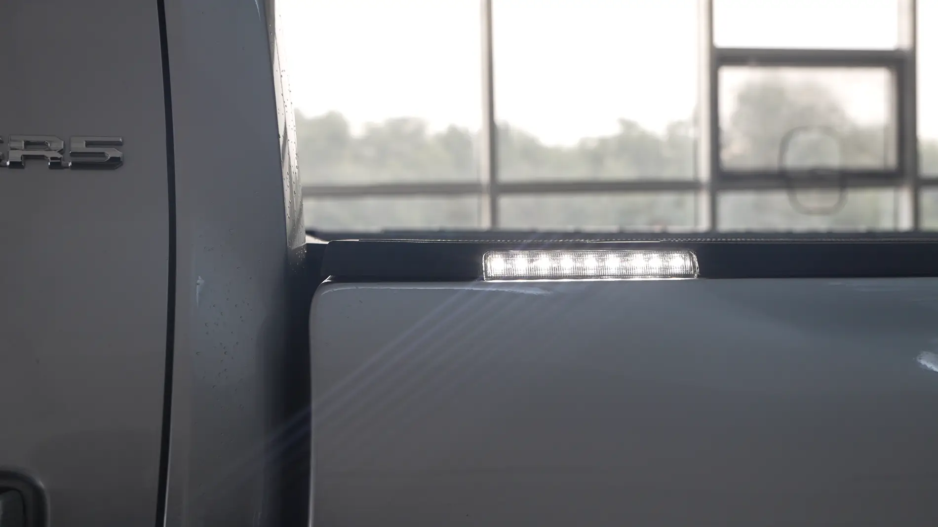

Finally, snap the bed rail cap back into place to complete the installation.
2024 Tacoma How to Add Bed Scene Lights to a Base-Model Tacoma SR5 installation (9)
2024 Tacoma How to Add Bed Scene Lights to a Base-Model Tacoma SR5 installation (10)

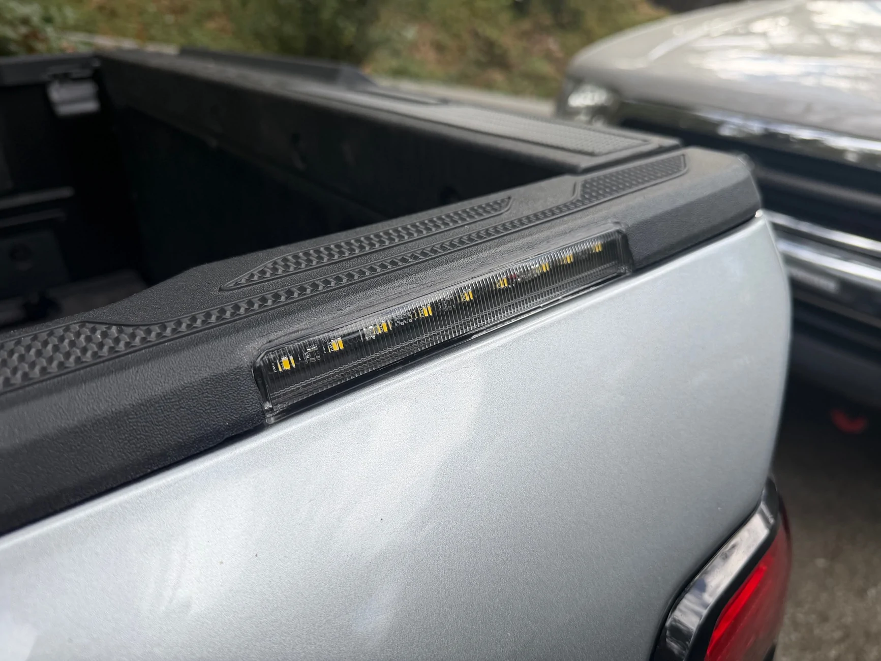

Anyone have these already? I’m curious about any water intrusion under the rail cap and onto the underlying body panel - any more than the stock un-cut bed rail
Cabby30
Jun 4, 2024
167
193
CA
2024 DCLB TRD OR
Based on this image it doesn't look like there is any sealing involved, from the factory or this installation. I ordered these so I'll know more once I attempt the install when they arrive.

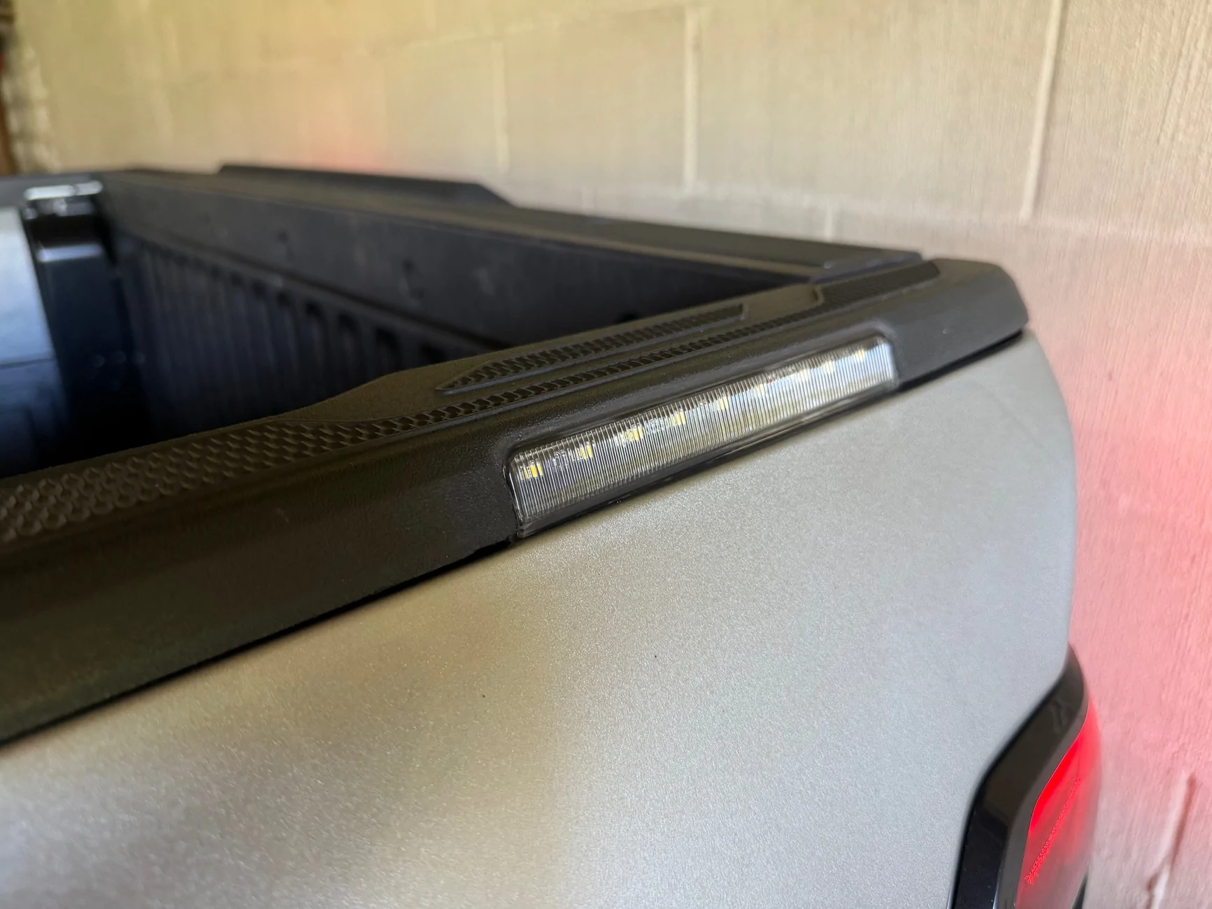

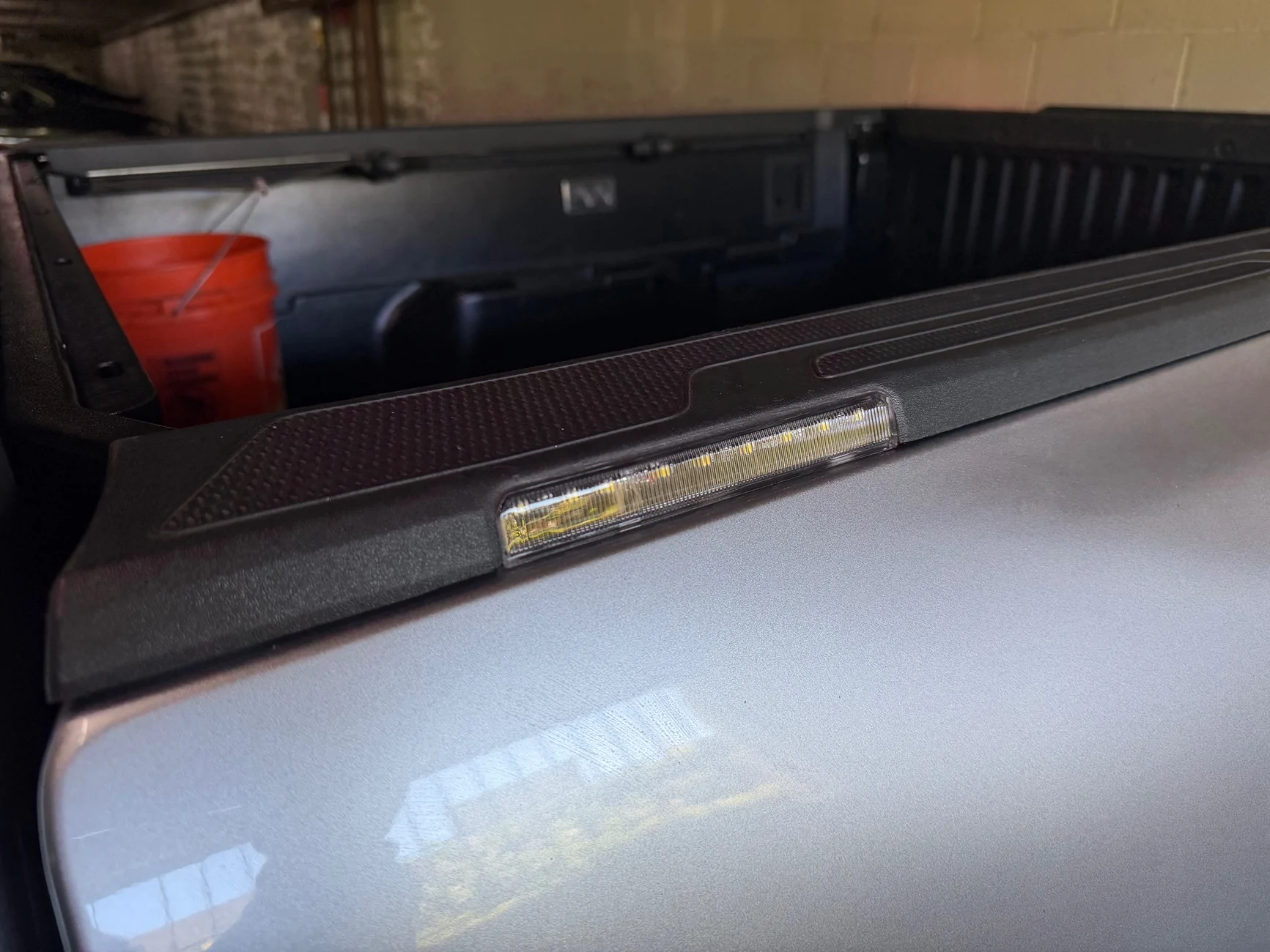

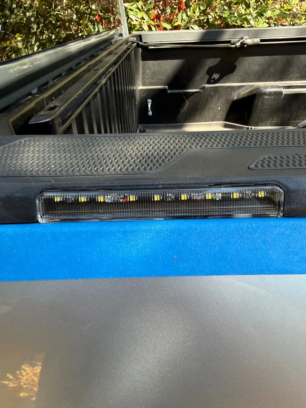

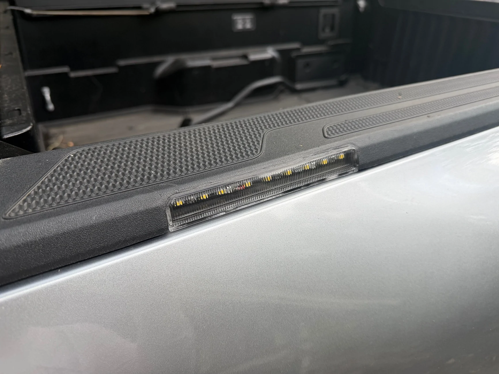

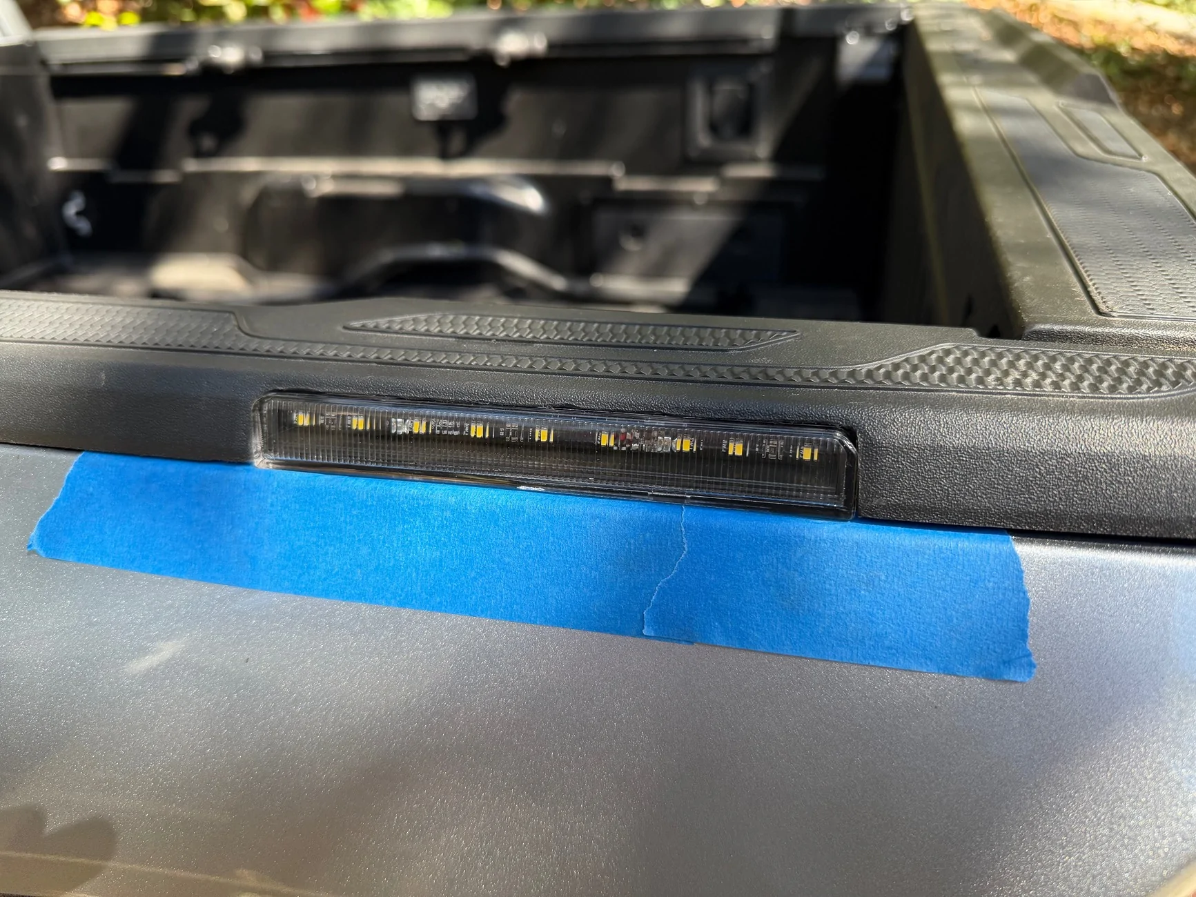

My process:
1. Cut out the bulk material with a Dremel and die grinder bit;
2. Then I used a fine file to remove remaining material and try to straighten out and smooth the cuts.
3. Used a lighter to heat the material to smooth it out; applied the flame and then just used my finger to get any extra material smoothed/removed.
4. Mounted everything to the truck and checked function.
5. Protected the truck paint with painters tape and applied black RTV to caulk the seams. Used isopropyl wipes to remove excess RTV and clean the trim and light. (This was very messy)
My main advice is to go slow and not over cut. The first light took me 1.5 hours as I worked out my process. The 2nd took less than 30mins. I have only done one side so far)
Light output is good; especially for the price. I havent seen the OEM ones so I cannot compare. I'll upload a night shot later.
I did like that the kit came with the harness and everything else was plug and play. I would recommend it. Maybe the only other thing I would do is add even a little bit of extra RTV where the connector wires comes out of the light, just in case.
Before RTV:
2024 Tacoma How to Add Bed Scene Lights to a Base-Model Tacoma SR5 IMG_7725
2024 Tacoma How to Add Bed Scene Lights to a Base-Model Tacoma SR5 IMG_7727
After RTV cured:
2024 Tacoma How to Add Bed Scene Lights to a Base-Model Tacoma SR5 IMG_7758
2024 Tacoma How to Add Bed Scene Lights to a Base-Model Tacoma SR5 IMG_7967
2024 Tacoma How to Add Bed Scene Lights to a Base-Model Tacoma SR5 IMG_7759
2024 Tacoma How to Add Bed Scene Lights to a Base-Model Tacoma SR5 IMG_7966
