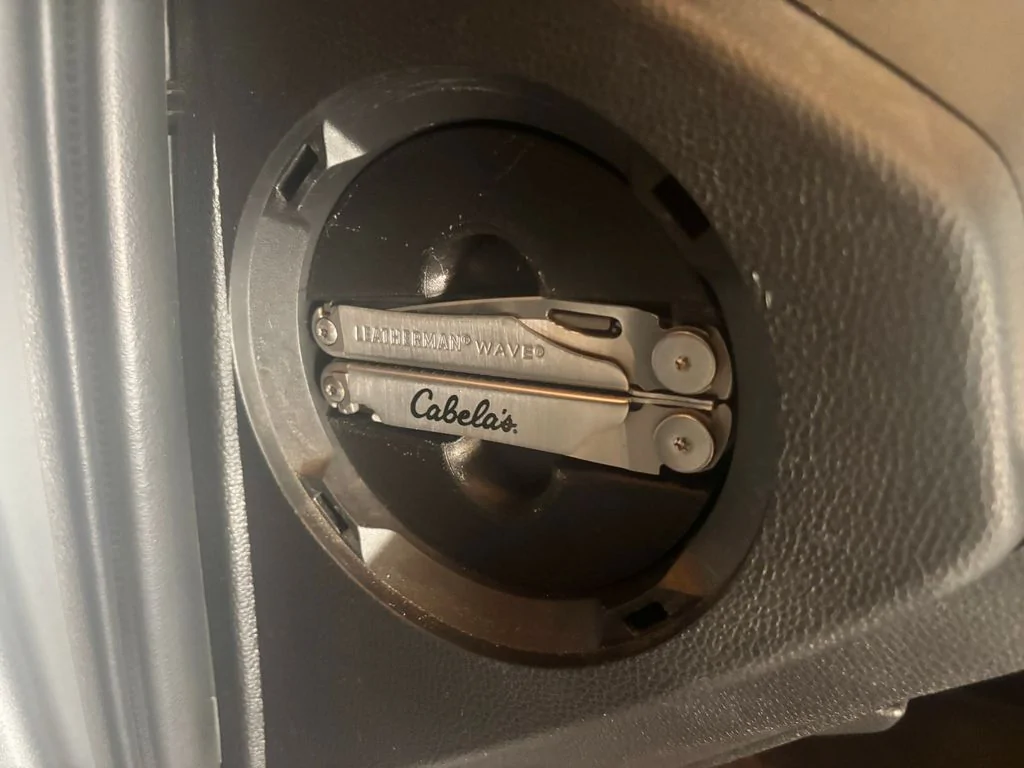

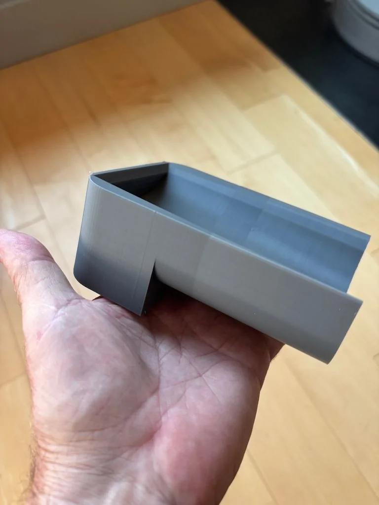

I got bored on a 5hr flight and figured I would make the "secret cubby" organizer. The main things I wanted to store are the lug nut key and a spare battery for the key fob (and card fob). I was also able to fit in a Leatherman Sidekick (though I'm sure other small multitools would fit). On the back there is a cut out for 2 command strips to help hold this in place (some velcro strips would work too, though they might need some trimming). I added some moleskin to the inside of the upper Leatherman cutout to help hold it into place and help silence any rattling. I think a slot or 2 for keys would be a good option, but with how easy it is to break into vehicles, I thought it might be better to not include it... STL included so you can add yourself if you think it is an acceptable risk.
NOTE: the point of this organizer is not to be something you use daily, just something you use in a pinch (key fob/headlamp goes dead, wire needs cut, etc)
STL image
2024 Tacoma Secret Cubby Organizer 3D Print DIY (STL included) 1791224046139-wu
Installed Image
2024 Tacoma Secret Cubby Organizer 3D Print DIY (STL included) 1791251982569-bo
(Black plastic doesn't photograph as nice as the grey stuff from the other post, sorry!)
Some notes:
  • Command strips do not stick to the plastic in the cubby very well
  • A layer of moleskin on each side of the Leatherman stops it from shaking (maybe have it wrap around to the front of the organizer to stop fraying and improve longevity)
  • I removed the pocket clip on the Leatherman to help it fit better
  • Getting batteries out is a little challenging, but with command strips (or velcro) pulling out the organizer isn't an issue
Potential modifications:
  • Adding an angle/champers to help guide the multitool in
  • Key slot (at your own risk)
  • Slots for some common socket sizes
  • Socket wrench or screwdriver with different tips
  • Flashlight
  • Air Tag/Pixel Tag (go Android) if you forget your parking spot often
  • CR123 batteries
Enjoy! And if you make some changes take a pic and share!

Thanks. I see this as less useful than the center console organizer from a few weeks back. It can be tricky to get the batteries out without pulling the whole organizer out. I think ergonomics could be improved by using 1 type of battery (AA, AAA, CR123) and installing next to each other with a little more space between them. Dang that ease of use/space trade off.
I hope you're inspired to improve on it or make something else! Tag me if you do!

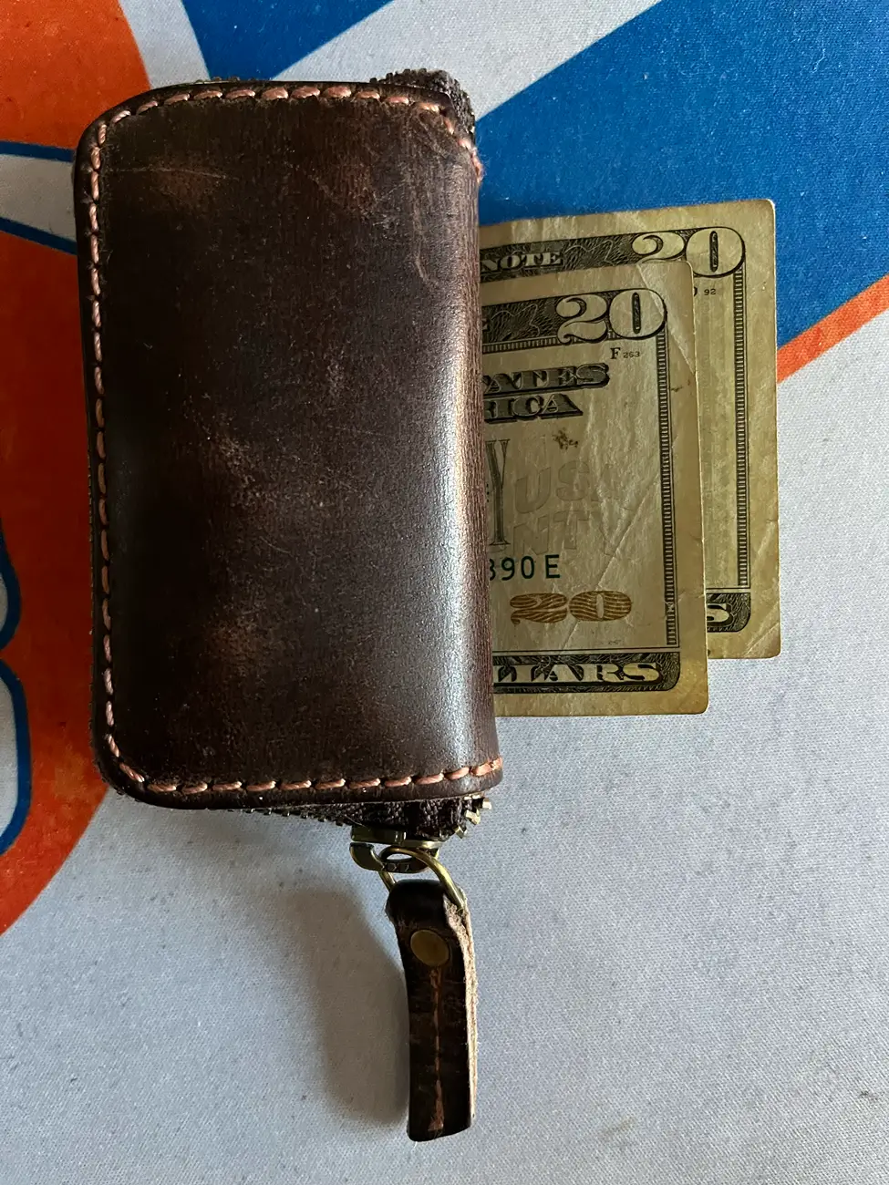

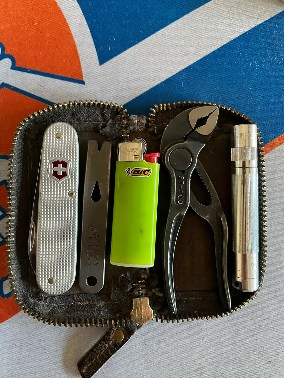

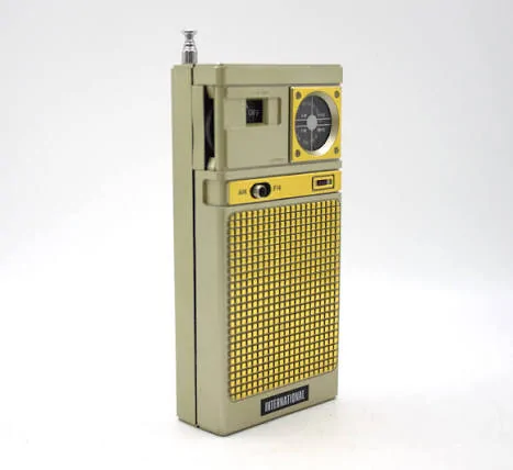

You have and thanks. I spent half the night trying to build on your idea for that round cubbyhole in my 2024 Taco. I'm more of a "prepper" kind of guy and I was thinking of stashing a micro hand crank am/fm emergency radio, a mini Bic lighter, and a couple of other things. Kind of what i keep in my pocket every day. I'm headed to Lowe's later today and see what i can find. You're onto something great. Thanks for sharing.
