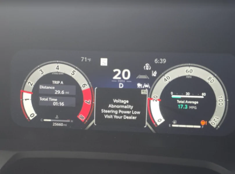

4 tacoma off road 25k miles - Just had this happen this morning after about 10 minutes into my drive. "Voltage Abnormality Steering Power Low Visit Your Dealer" It was present for about 10-15 seconds before it disappeared. I used my carvista obd2 tool to pull current codes from the vehicle, but nothing was there.
From a quick search in general it seems like a bad or low starter battery can cause this, which makes sense.
However I dont see that to be the case since my battery is only a year old and i have a bluetooth based battery monitor hooked up to my starter battery(been like that for 2 years), in which i checked the historical data of the starter battery from 12 hours prior to when i started the vehicle up to the point the error was thrown. And it was at 12.6v throughout the night, as expected. And then jumped to 13.7v with the vehicle started as i headed out in the morning. Which tells me the starter battery itsself was not low, nor is there an alternator or charging issue. So a vehicle wide low voltage issue shouldnt be the case.
Which makes me think it was either a one off electrical glitch or theres something more about to happen like a bad connection, corrosion or a connector or some sort of module issue that controls the power steering that could be indicative of a measured low voltage at that module if not something else. Anyway, if anyone has any other thoughts of what to look at or anything id appreciate it. Im waiting to see if its going to happen again before i stop by the dealer.
