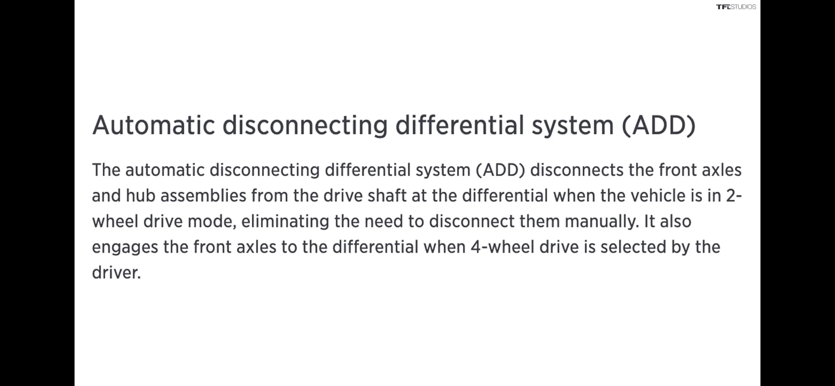

What broke? The automatic disconnecting differential system (ADD) in the front differential.
The ADD disconnects the front axles and hub assemblies from the drive shaft at the differential when the vehicle is in 2-wheel drive mode, eliminating the need to disconnect them manually. It also engages the front axles to the differential when 4-wheel drive is selected by the driver.

I’m sure the Toyota engineers will determine why that component failed, as I wouldn’t call what I saw in their video “extreme conditions”. Hopefully it was a one-off defect and not going to become a massive recall.

TLDW; They spoke directly to Tacoma chief engineer Sheldon Brown and Toyota put more than 20 people looking into this issue. They will be replacing the ADD and TFL should have the truck back in a few days.
What's interesting is the ADD is actually designed to fail (as a safety feature) to disconnect in specific situations to avoid further damage, but obviously it should not have happened here and Toyota acknowledged that.

it’s great that the ADD prevented more damage from occurring, and yeah the part shouldn’t have failed that easily, but i’m also of the mind that the traction control had a part to play in this with quick acceleration and braking when the wheels started spinning on the climb

on rewatch and from what’s in the video, and on checking my own truck, traction control is off automatically in 4LO and can’t be turned on. so i am changing my mind, the ADD is probably weaker than it should be. not a great look, but i wonder how hard it is to replace?
