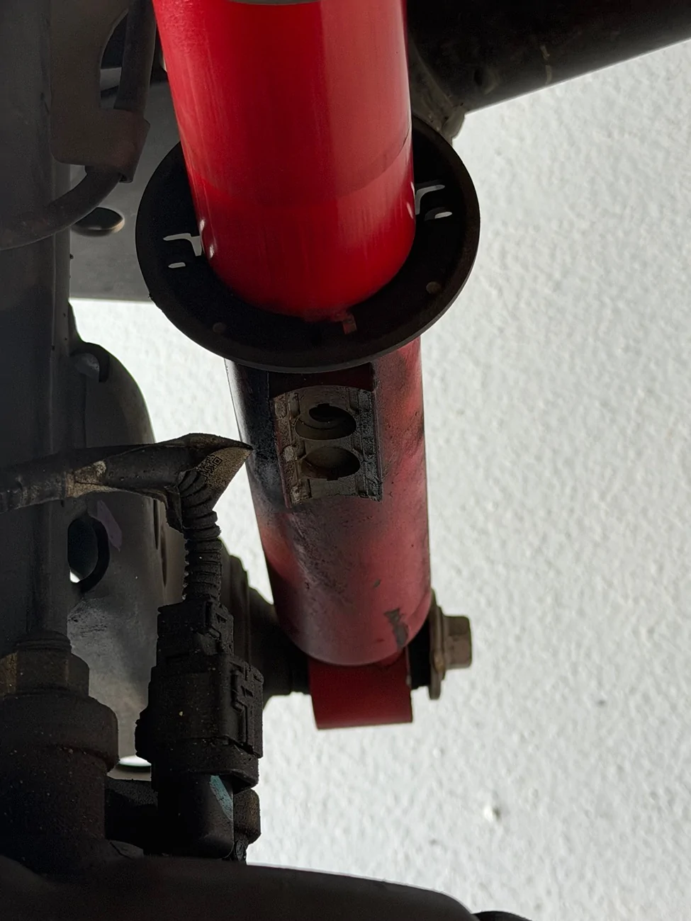

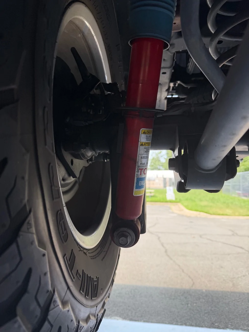

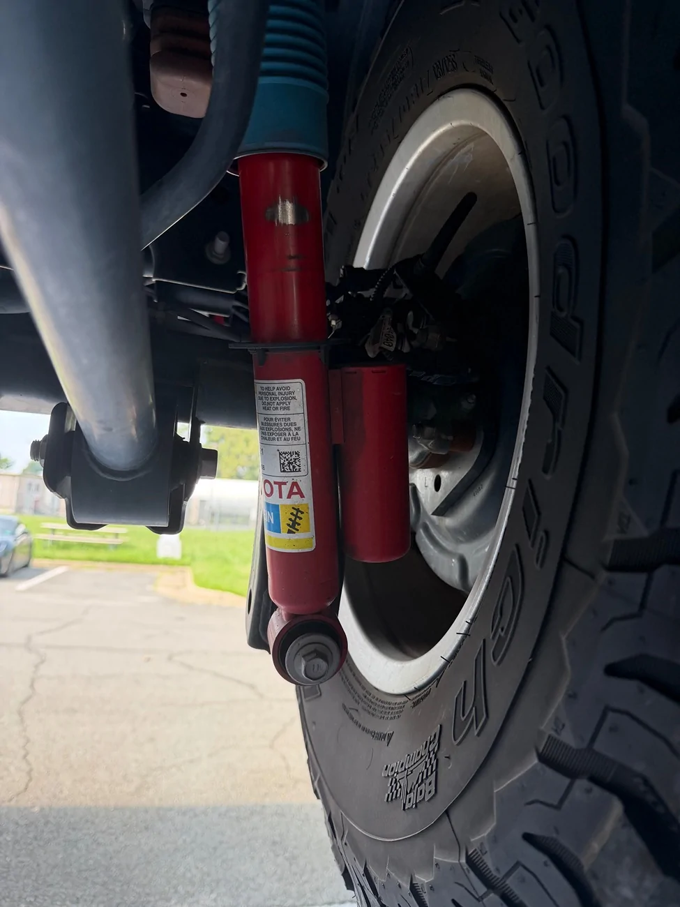

To anyone saying that the reservoirs don’t actually fall off, please enjoy these pictures of my MY2025 TRD OR at 25,000 miles that I discovered this morning when I changed my oil at the auto skills center at Quantico.
fully detached and nowhere to be found. March 2027 to get this fixed? I’m good.

I have a 2024 OR with 67k. The thing was terrifying to drive, I couldn't find parts; I was looking to trade it in. Thankfully this recall came around. I called Toyota because I couldn't wait until March of 2027, I'd wrap the thing around a telephone pole before then. They opened a case and set me up with an appointment at a dealer to get an inspection. I now have a loaner. The reservoirs on the passenger side front and rear are gone/fell off. Driver's side rear, the fluid has leaked out, but the reservoir is still attached. Apparently the driver's front is the only intact shock...on a pavement princess "Off Road" vehicle. No wonder it was a scary ride, just glad they're working with me.
