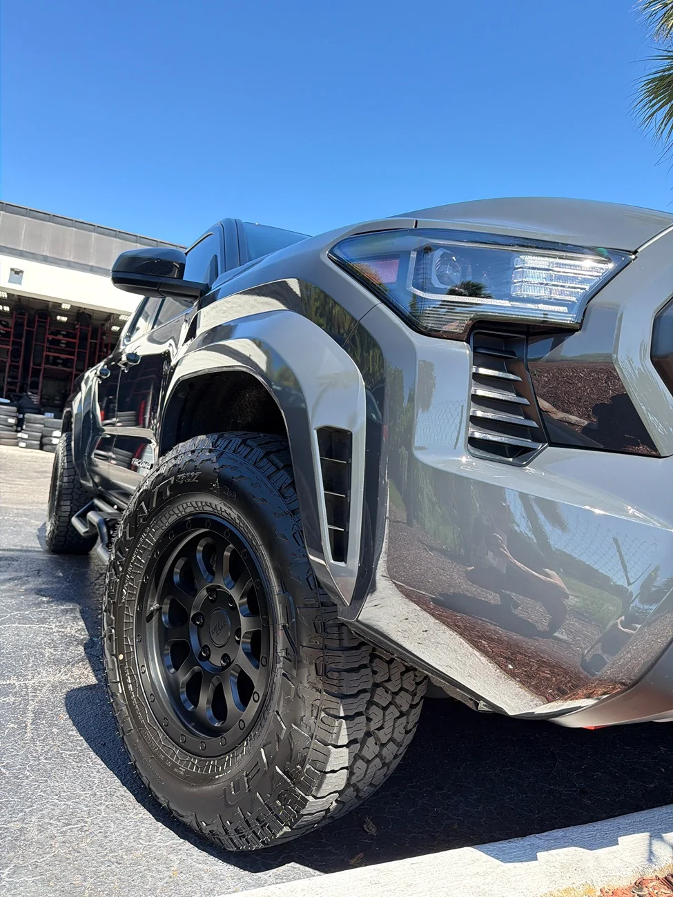

Agree on tire selection. I was in the same boat, was going to put some 33’s on my 18” OEM wheels, but tire selection was extremely limited. And I wanted to go with an SL tire, so just ate it and got some RockTrix RT111 17” wheels pared with Wildpeak 285/70r17 SL load tires. Drives better than OEM, light (only 6.5 lbs heavier per corner), and look great!
