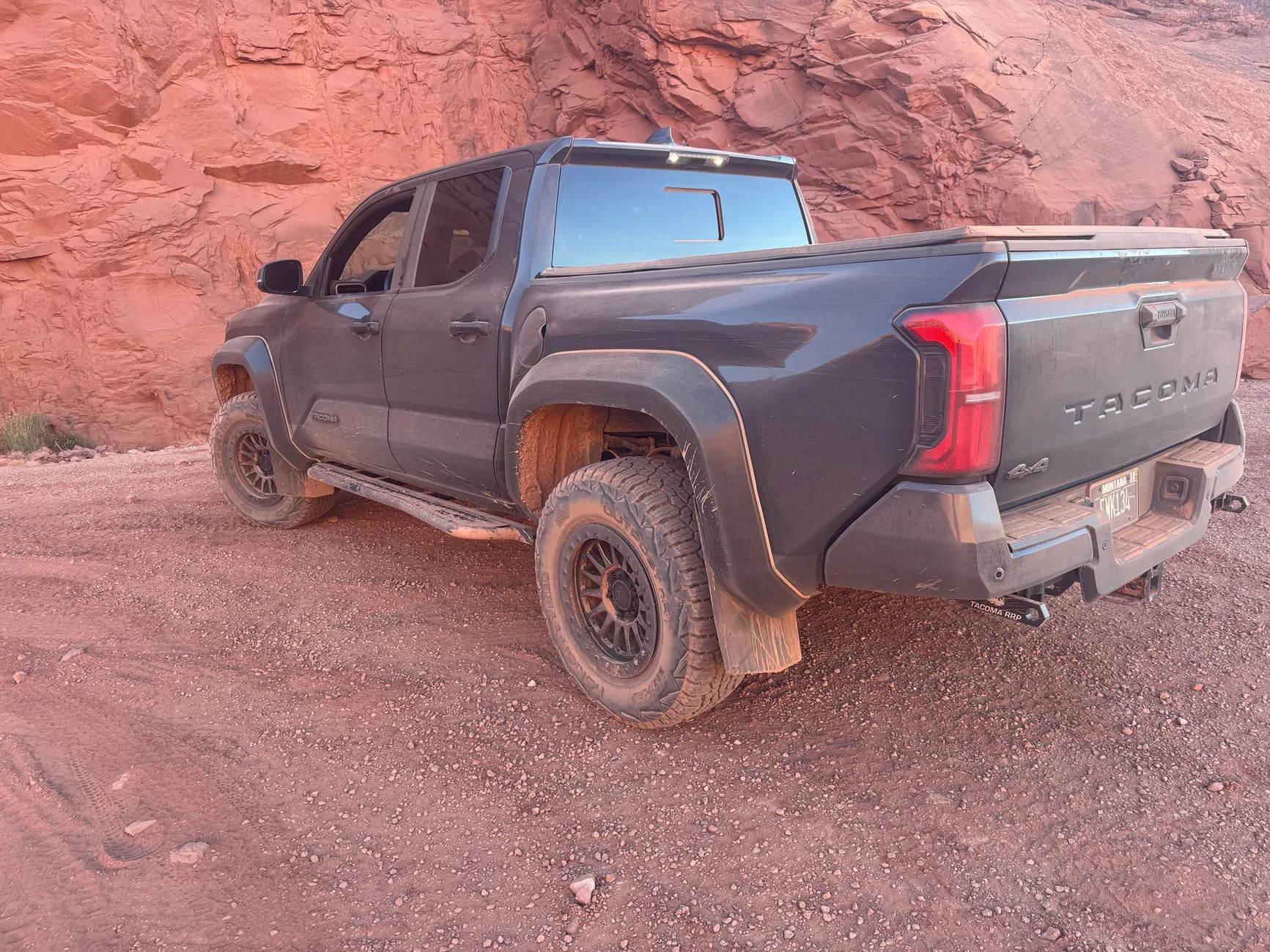

I stayed with 17’s. RRW’s with Nokian outpost NAT 285/70r17 (46 lbs) barely noticeable drive ability, Amrid (Kevlar) reinforced sidewalls, and about 1 to 1.5 mpg hit. Total weight per corner is 71lbs with steel protection rings.
2024 Tacoma 285/70/17 or go to 18s on TRD OR IMG_6781

I love my 285/70/17s. Method 705s with +35 Offset. BFGoodrich KO3s (E1). Stock height, no lift.
Feels good.
They weight about 86lbs/ea, since you mentioned weight. Here's my full thread on the upgrade.
