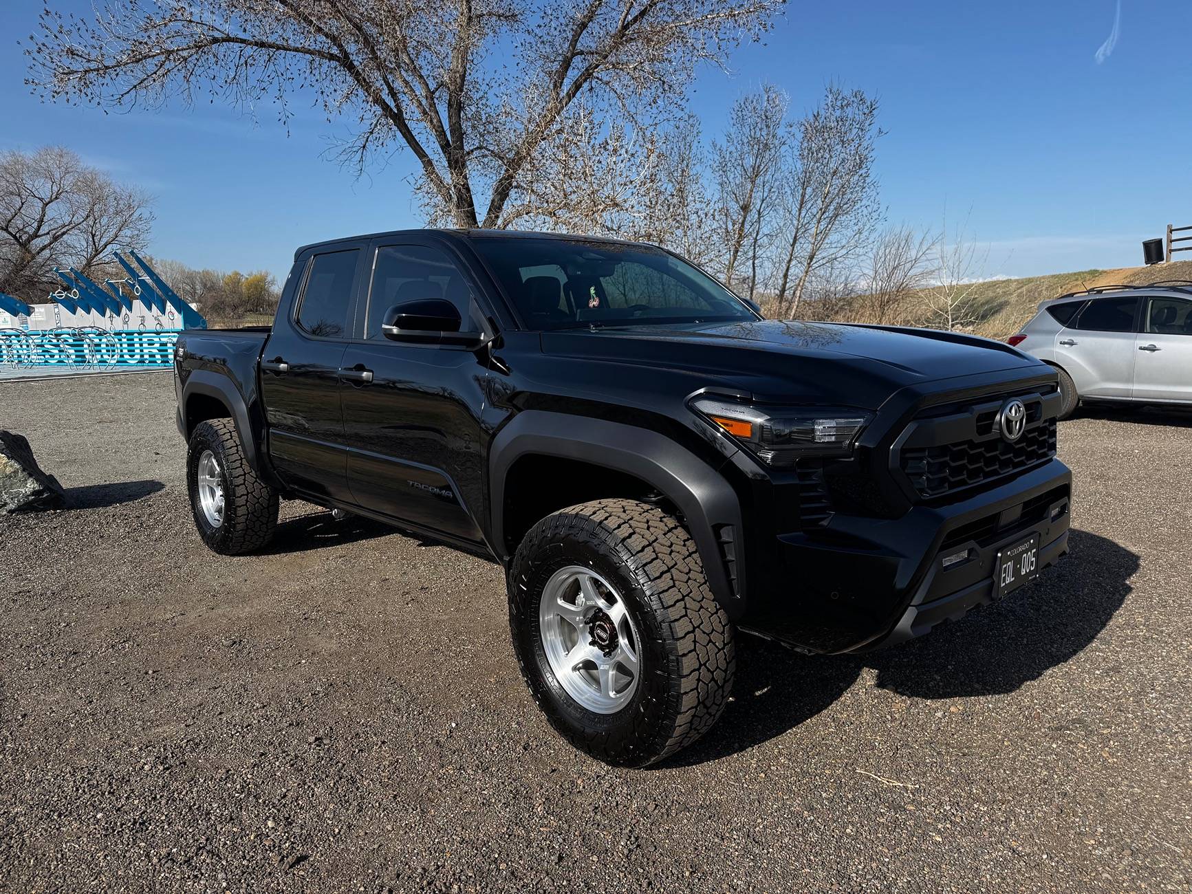

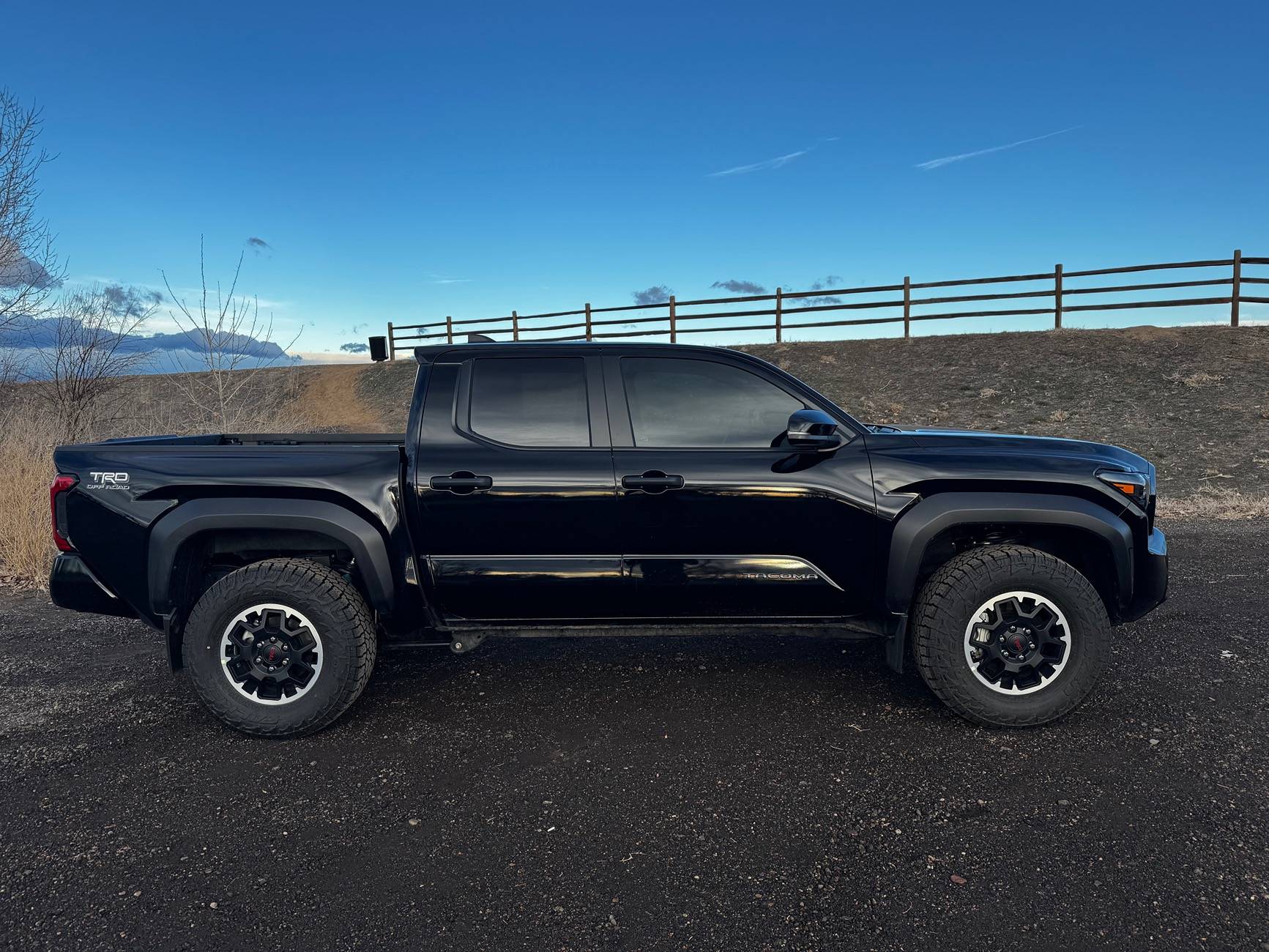

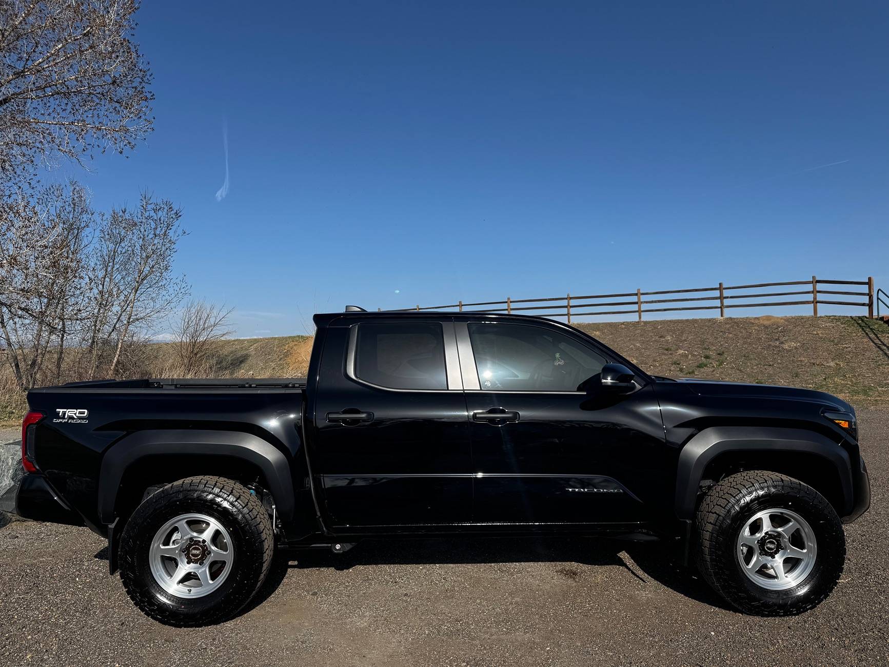

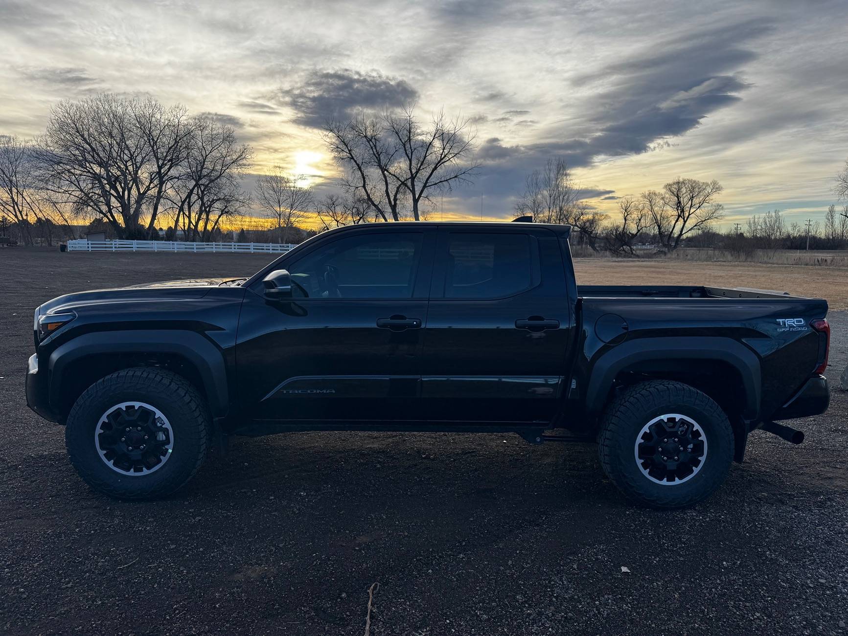

I went 285/70/17 Wildpeak AT4’s on the stock Off-Road wheels and they fit without rubbing. Then went to a 17x8 +15 with the same 285/70/17’s and added a 1.25inch peak suspension spacer only in the front to level it out a bit while still maintaining about 3/4in of front rake. Still no rub at all with the new RRW’s.

Looks really good! I ended up ordering some +25 relations race wheels. They come next week. I only have 265/70 tires (regret) but I’m definitely going to get bigger ones sooner I think because it’s bothering me lol #bigtireenvy

Yeah, in my opinion, Toyota should have sent the offroads out with a 285 from the factory. Perfectly proportional to the truck’s size and they fit within the wheel wells with ease with the factory suspension geometry. I think you will find 285’s in the very near future. I’m already wanting 35’s and a proper lift. There always seems to be a “next step” ?
