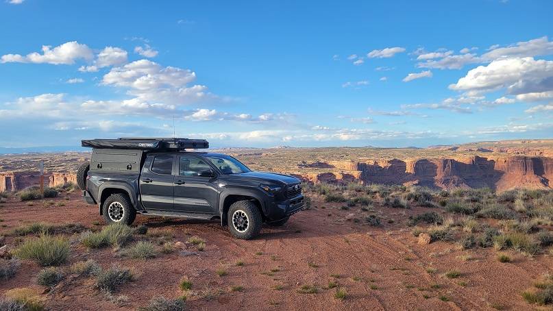

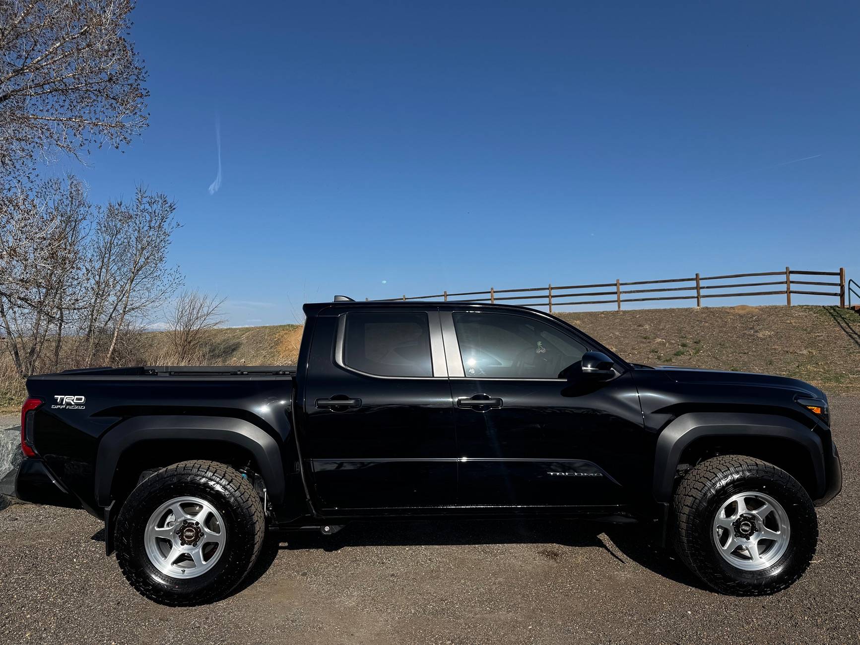

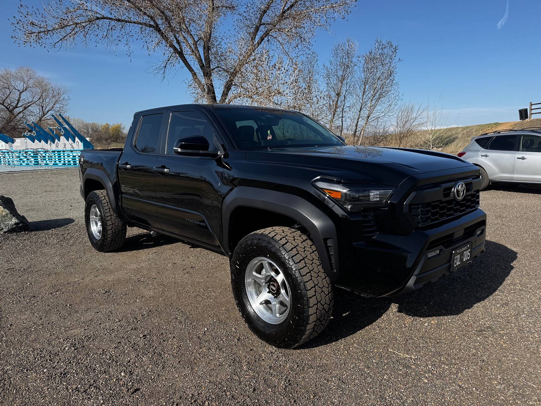

I have 285/70-17 Wildpeaks on my TRD-OR. Mounted to the factory rims. I had a 1/2" lift spacer in the front, and Dobinson 819V's in the rear with my camper. The truck sat at about factory height in the rear. You folks must not wheel your junk. I had some rubbing in the front on stuff with the wheels turned. Not much, but I did notice it.
The front spacers have been removed and replaced with Alldog springs. The 819V springs in the rear were replaced with 821V plus a 1/2" spacer. No pictures. Here is the before pic.
2024 Tacoma 285/70/17 tires with or without lift? 20250515_191928-sm
