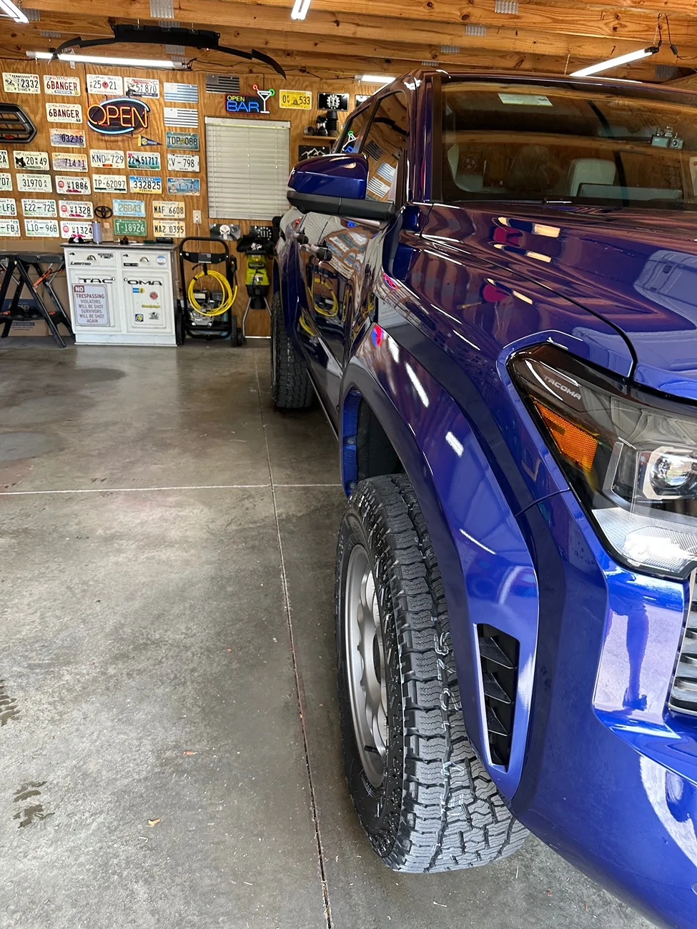

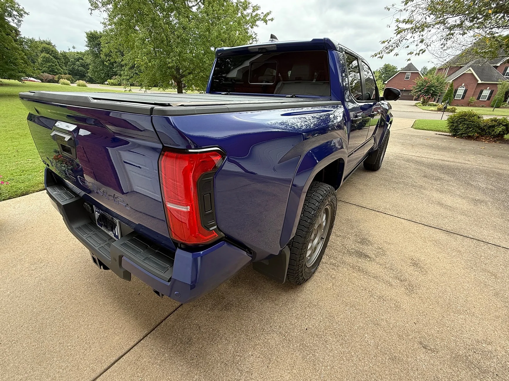

Raceline Rouge wheels 18x8.5 +35 offset. I also wanted to minimize poke but also wanted something different than black so that limited me a lot.
These are just barely out of the fender wells, looks to be around a quarter of an inch. i am happy with +35 and personally wouldn’t want to add any more poke than I have.
As for slinging rocks or debris, I went with the Toyota Canadian mud flaps and between the minimal poke and those wider mud flaps, I haven’t had much paint damage.

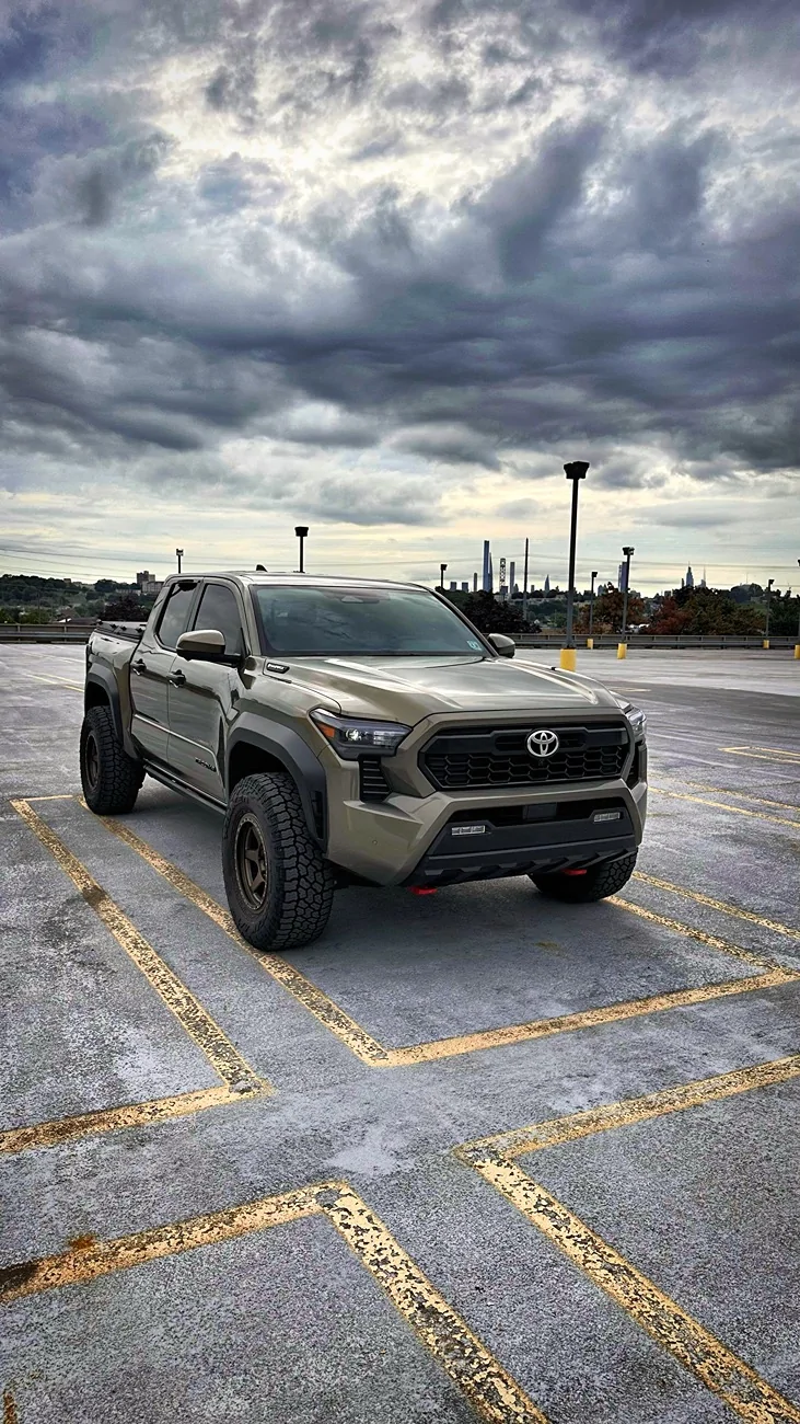

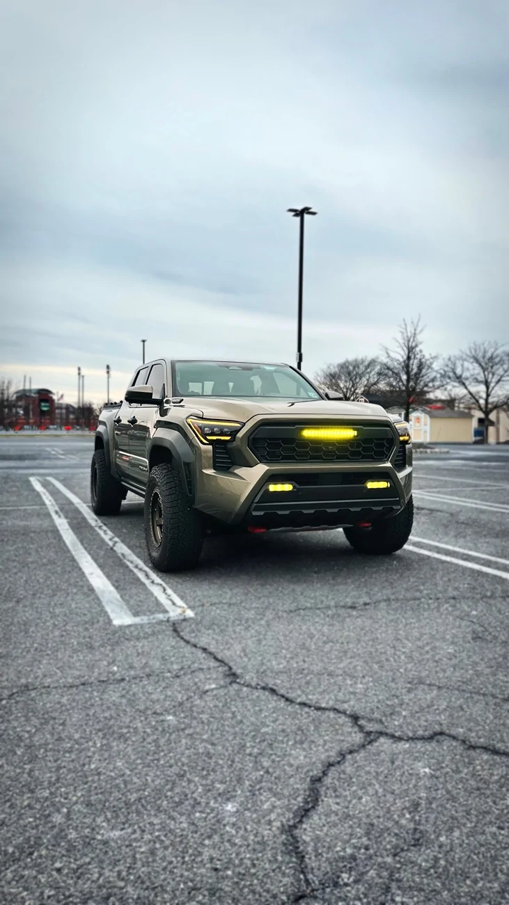

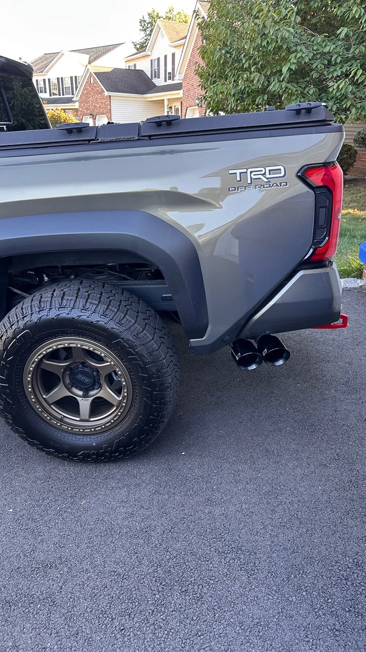

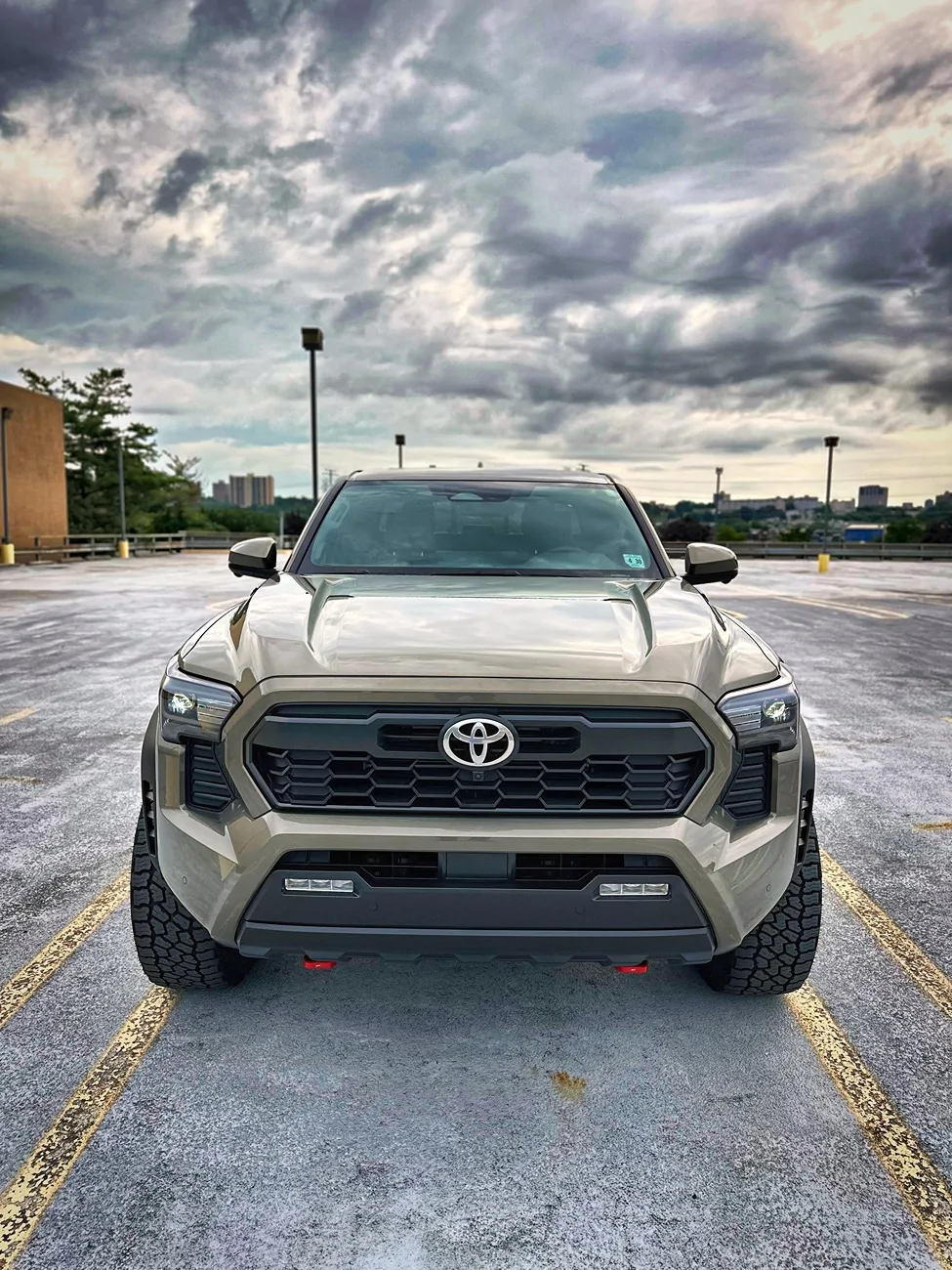

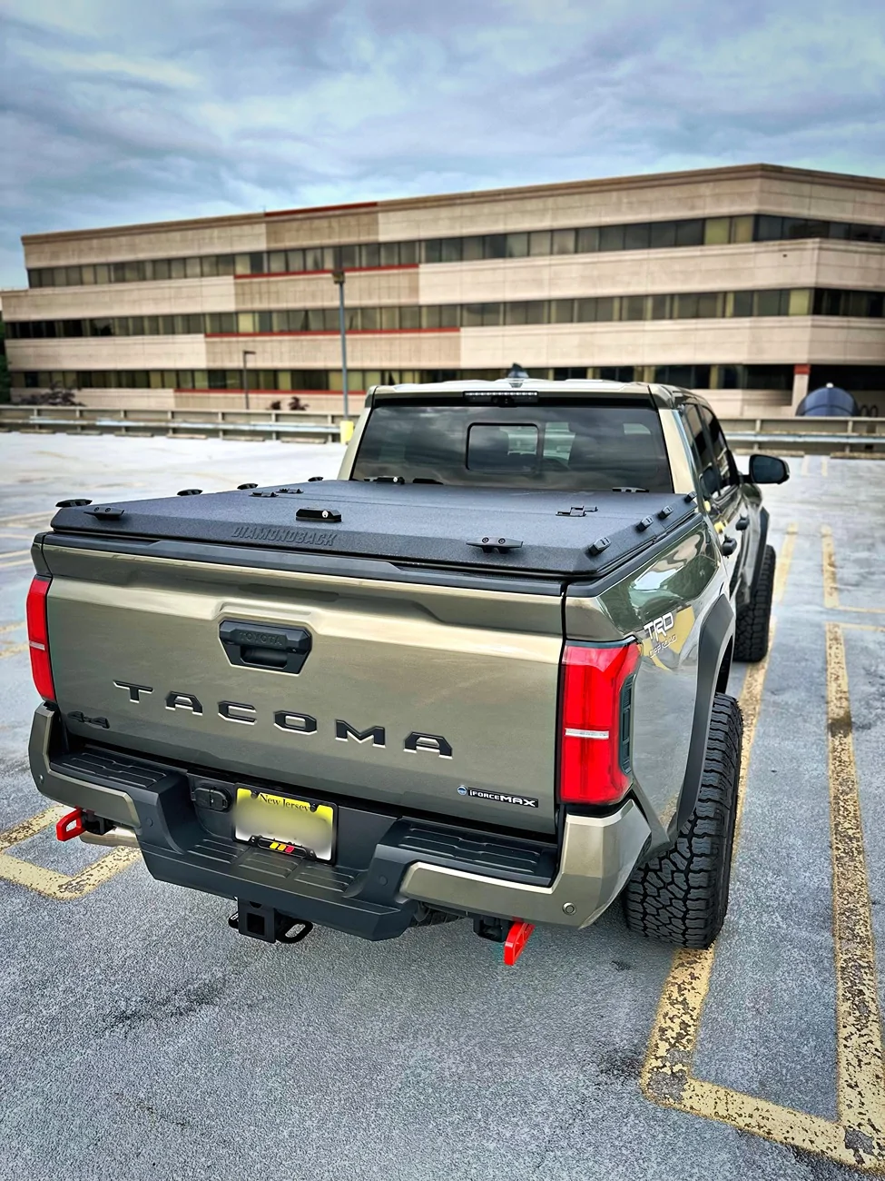

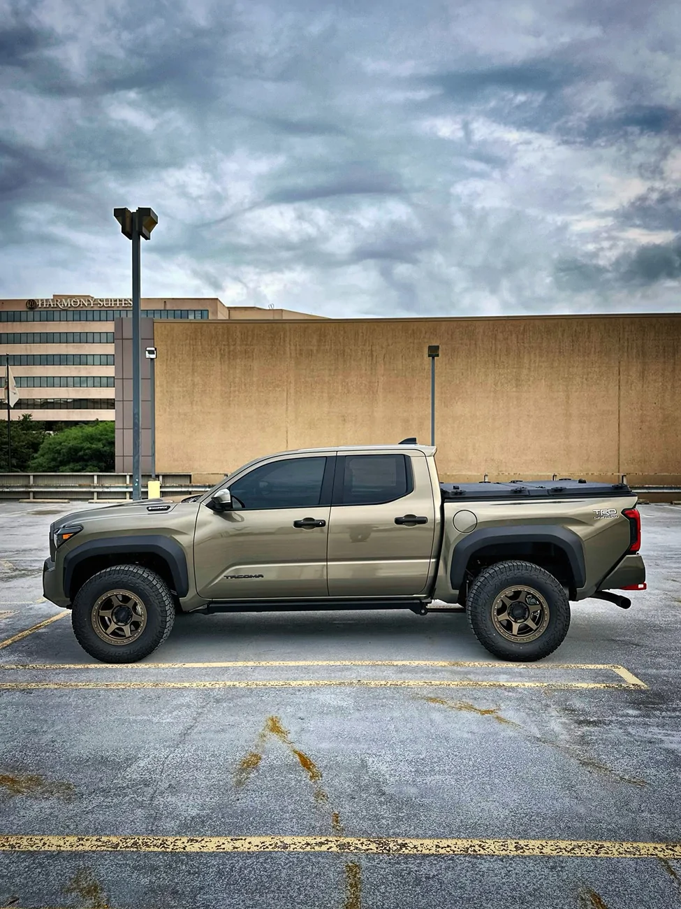

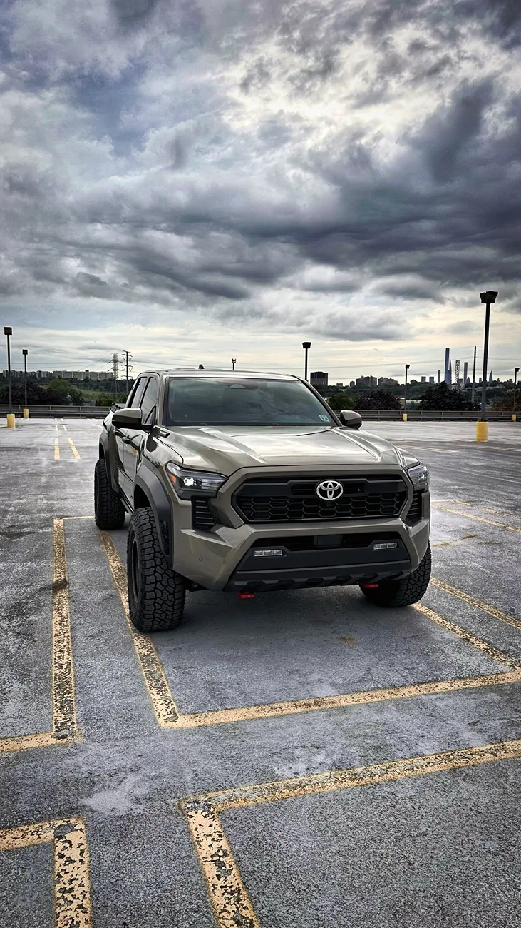

I would agree with you. That’s why I went with zero offset in mine. This gives about 1.5 to 2 inches of poke.
Here is a bunch of photos of my truck and aftermarket wheel. Tire is 285/70/17 Falken Wildpeak AT4W like the ones you’re interested.

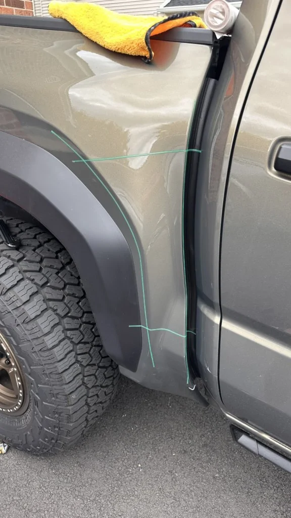

Agreed with above. I’ve applied ppf on mine.
5,000 miles so far and no issues.

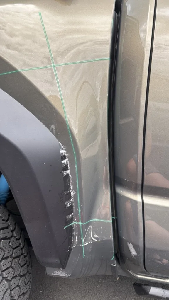

You did a great job! I did the exact same thing but struggled with the contour of the panel…had to make relief cuts. Still better than it being exposed

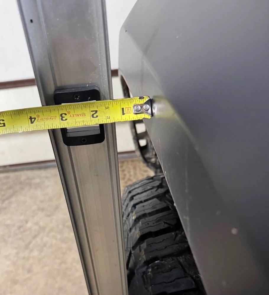

Here’s +25 with a 8.5 inch wheel width. So if the wheels you’re looking at are also 8.5 inches wide +35 will be 1cm (.40 inches) less poke.
