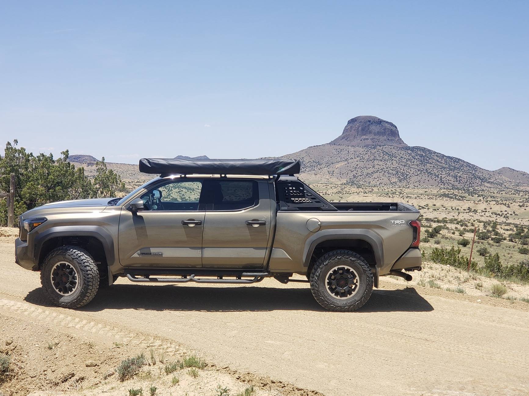

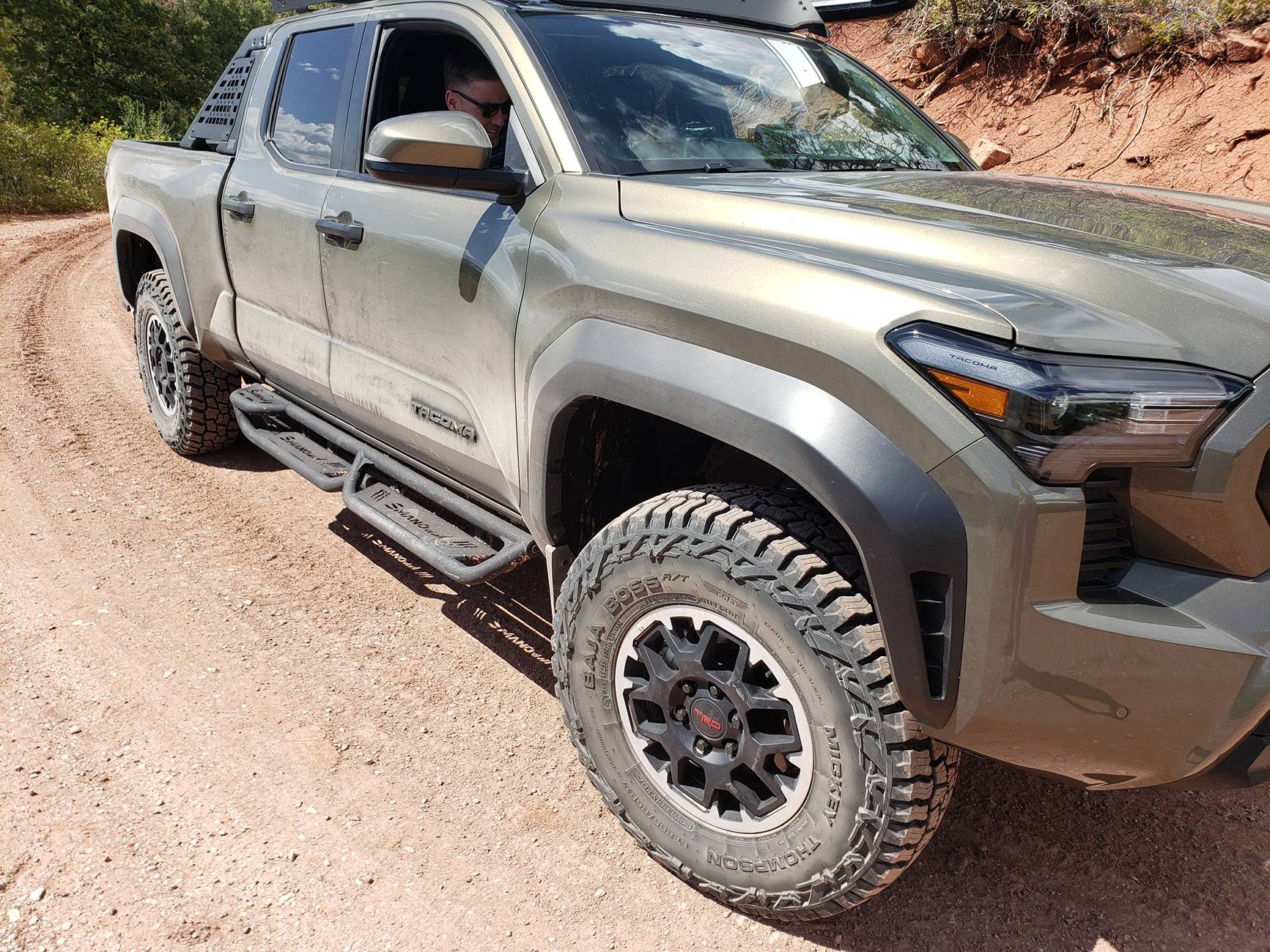

I also have images on a thread here. I will find it and attach. Anyway, the Mickey Thompson tires are great, I highly recommend. I do have a 3 inch lift in the front with 1 inch in the rear leveling kit
2024 Tacoma 35s on stock wheels? 20250527_130117
2024 Tacoma 35s on stock wheels? 20250527_144243

That looks great! Any trimming needed?

Mickey Thompson 255/85r17 are compatible with 6.5 to 8 inch wide rims according to their website. Also no rubbing.

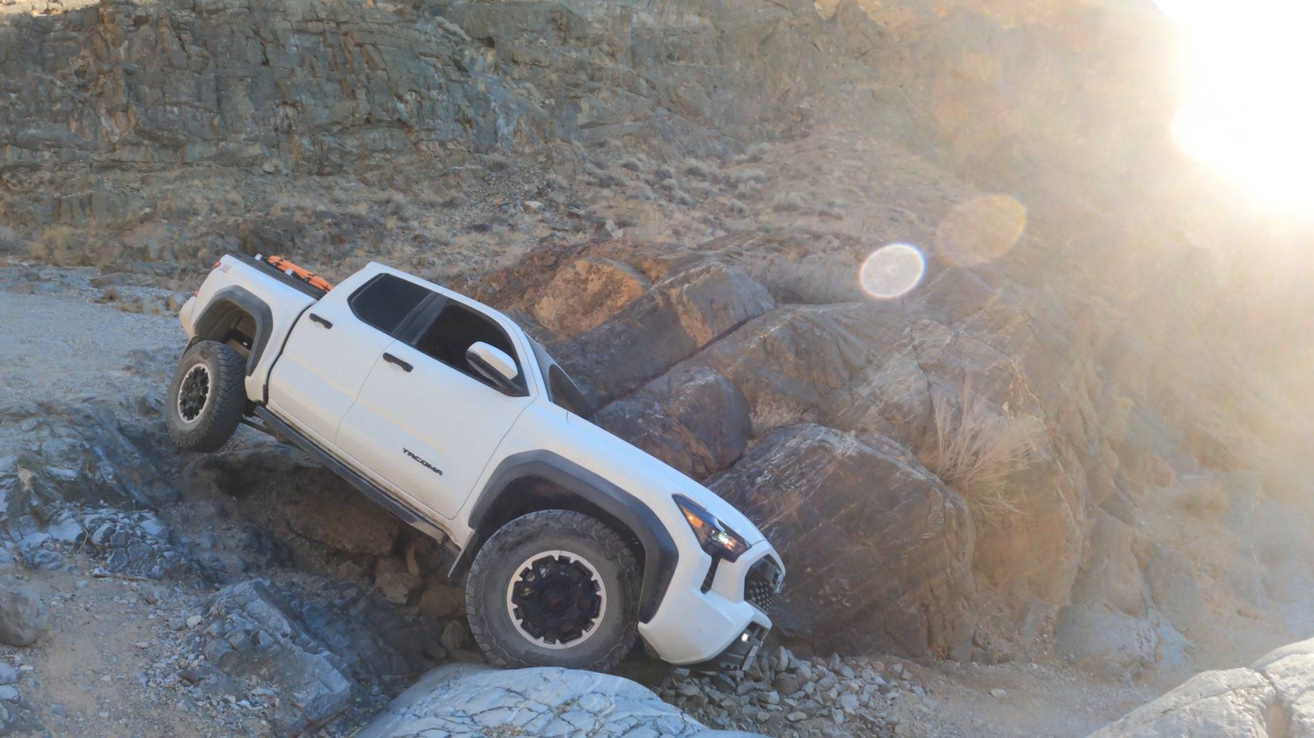

This is not accurate. I am running 285/75R17 KO3s (11.3" wide per BFG) on the factory TRD OR wheels and they fit fine / no rubbing. I am now at 1" lift but they fit ok without.
And to the OP. These are 33.8" tall per BFG. I am very happy with this size on the factory wheels and strongly recommend considering them if you dont want to go to different wheels.
2024 Tacoma 35s on stock wheels? 1000001733

Oh wow, completely flexed out and no rubbing without a lift? Interesting; do you have the SDM option? I've been looking at this size over the 285 /70 r17 but have been nervous about rubbing when turning while flexed, especially with the stock wheels (which almost no one seems to keep after a tire upgrade). However if it works for you like this.... I see a KO3 in that size in my future.
