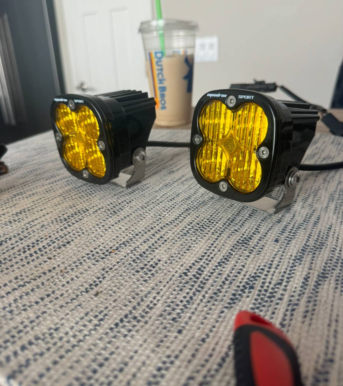

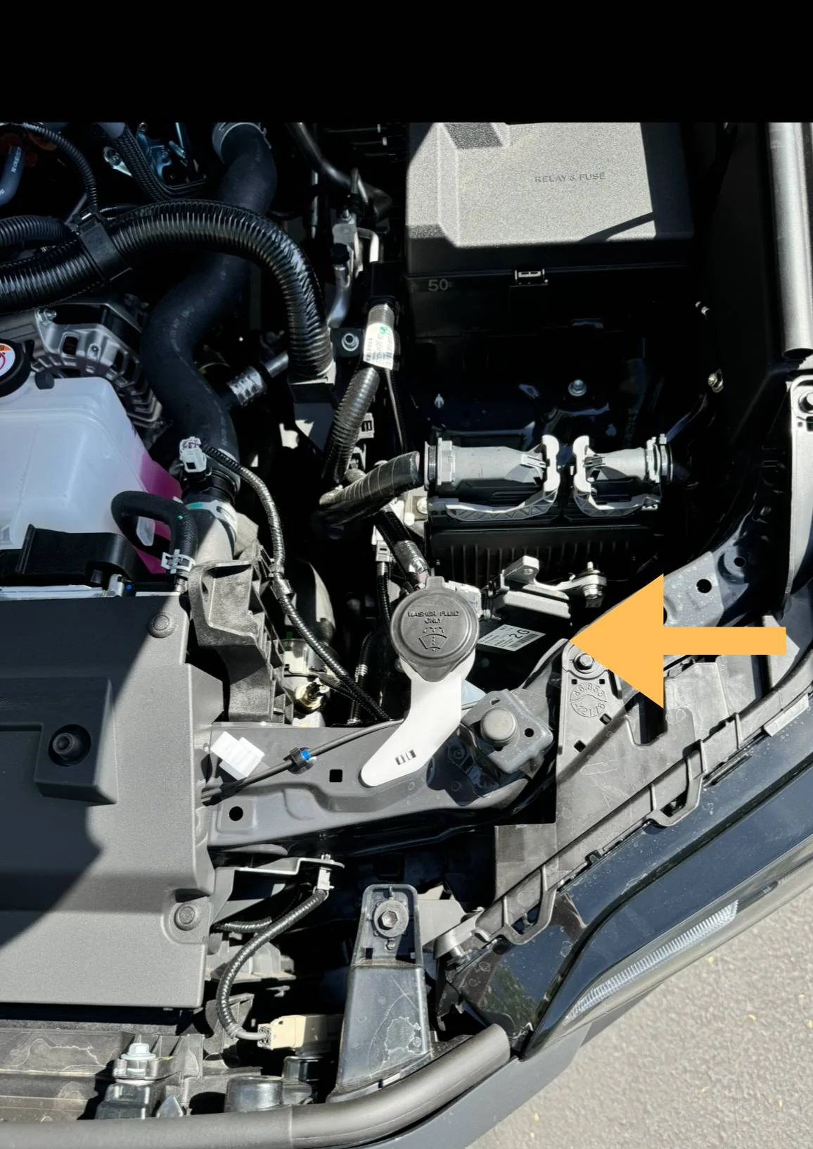

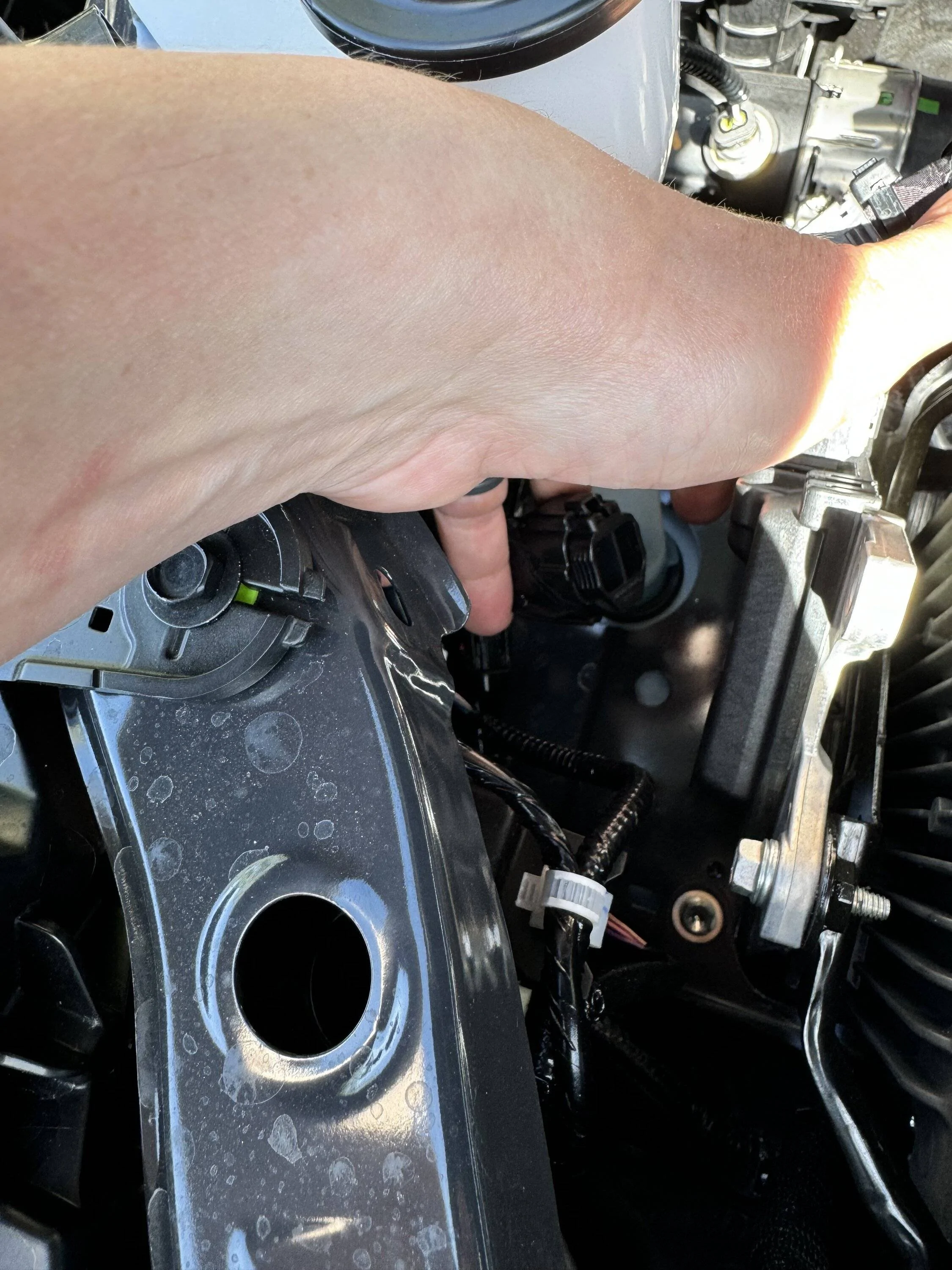

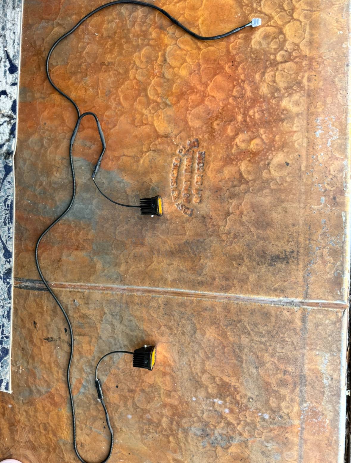

I haven’t really seen anybody do it yet so I wanted to share some photos from my install yesterday.
I made a wiring harness for my install. It’s complete plug-in play using the factory AUX switch and provided pigtails.
2024 Tacoma Ditch light install using factory AUX switch and pigtails IMG_3864
2024 Tacoma Ditch light install using factory AUX switch and pigtails IMG_3865
2024 Tacoma Ditch light install using factory AUX switch and pigtails IMG_3866
2024 Tacoma Ditch light install using factory AUX switch and pigtails IMG_3867
2024 Tacoma Ditch light install using factory AUX switch and pigtails IMG_3868
2024 Tacoma Ditch light install using factory AUX switch and pigtails IMG_3904

Toyota really made it easy with these prewired plugs I must say. When I ordered my ditch lights I was whining like a little toddler thinking I was going to have to go through the dreaded firewall before remembering I don't have to do it at all! ?
I don't like the placement on these prewired plugs though I must say. The one in front makes sense, for a light bar and what not, which is what I plugged my ditch lights into, AUX 2. Another one in the bonnet which would preferably make more sense for ditch lights and then they put the third inside the cabin somewhere if I'm reading the manual correctly which makes absolutely zero sense to me. I would've liked to see one near the middle or rear of the truck, for something like rollbar lights.

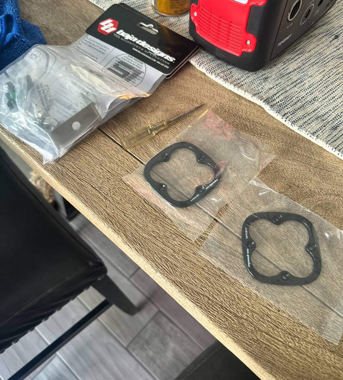

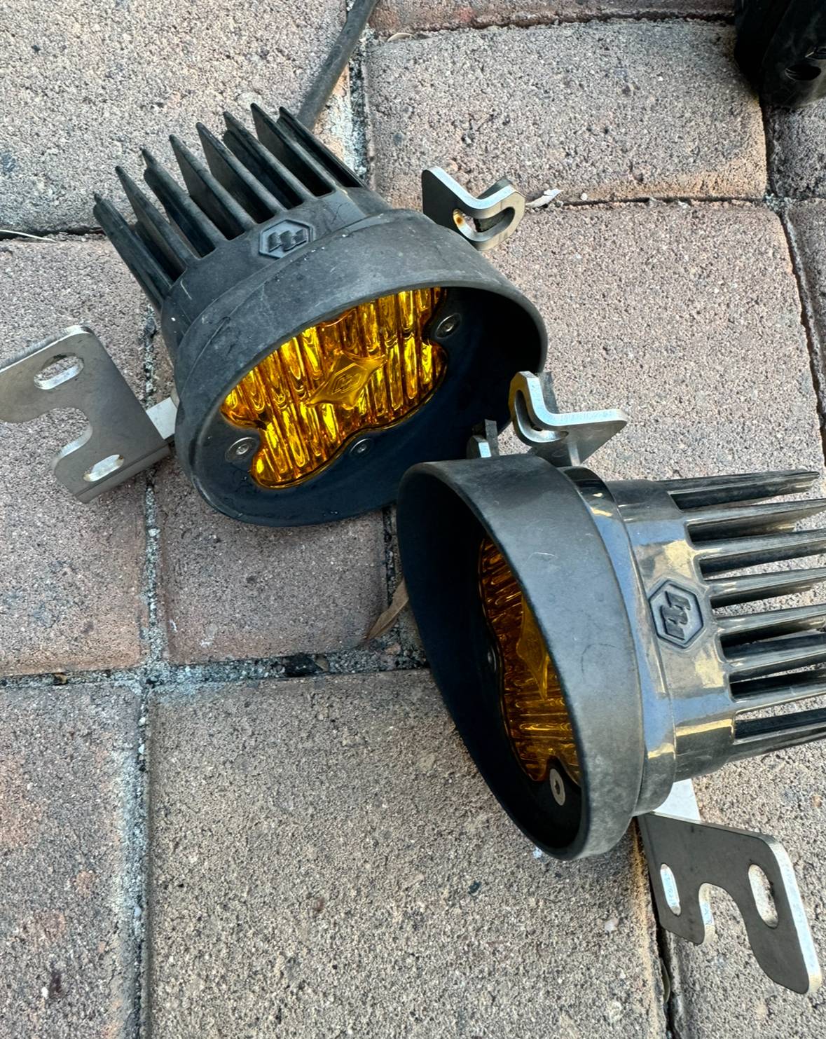

can you share which company these lights are from?
These lights are Baja Designs Squadron Sport. They were used as fogs on my 2021, I took them off before I traded it in. I ordered the flat face and the mounting hardware from Baja Designs. Gave them a shine and GTG.
The wire harness I made by measuring the lengths and soldering the connections together. Protected in some loom. I will post pics of the final install once the correct replacement mounts arrive.

Like you said, there's supposed to be one in the cabin somewhere but I have yet to try and locate it. I *think its behind the panel to the left of the pedals. There should be one at the rear bumper too, but again, I haven't gone looking for it yet.

Hi there! For the harness that originally came with your lights, did you just snip off the on/off switch and relay?
Yes that is basically what I did. I made my own harness. No power or relay. So yes just cut those off and should be good to go.
