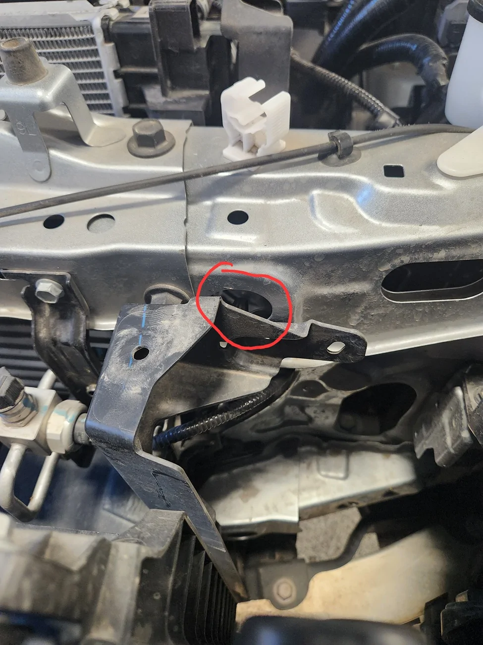

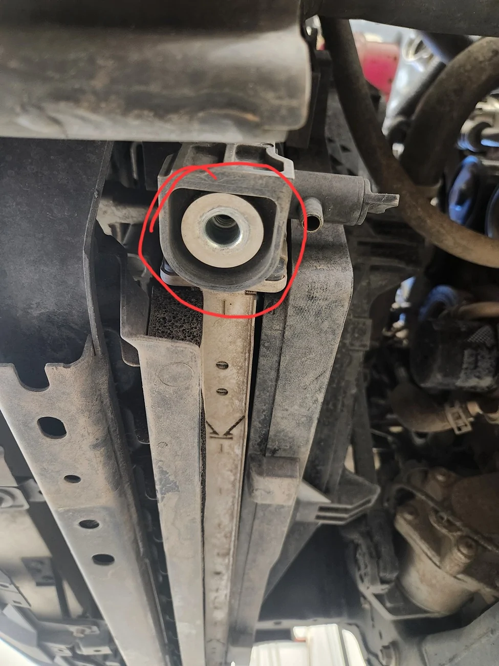

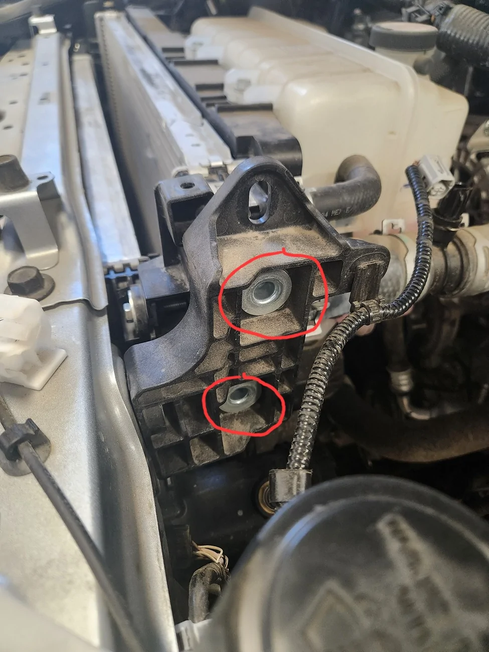

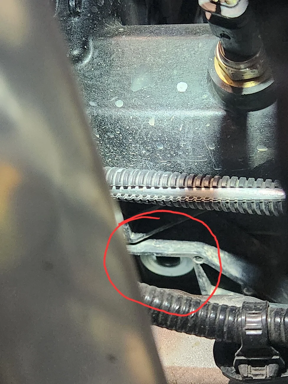

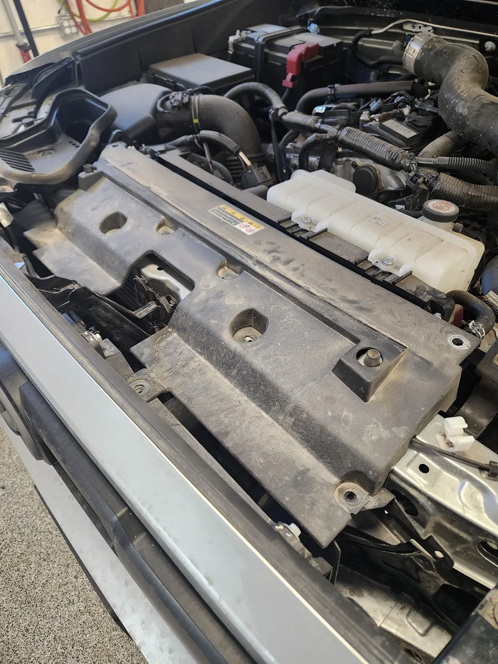

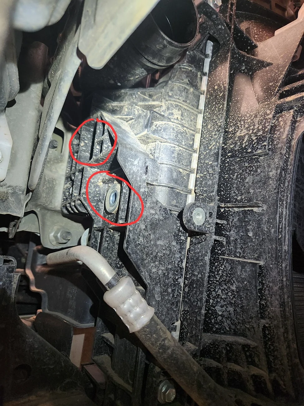

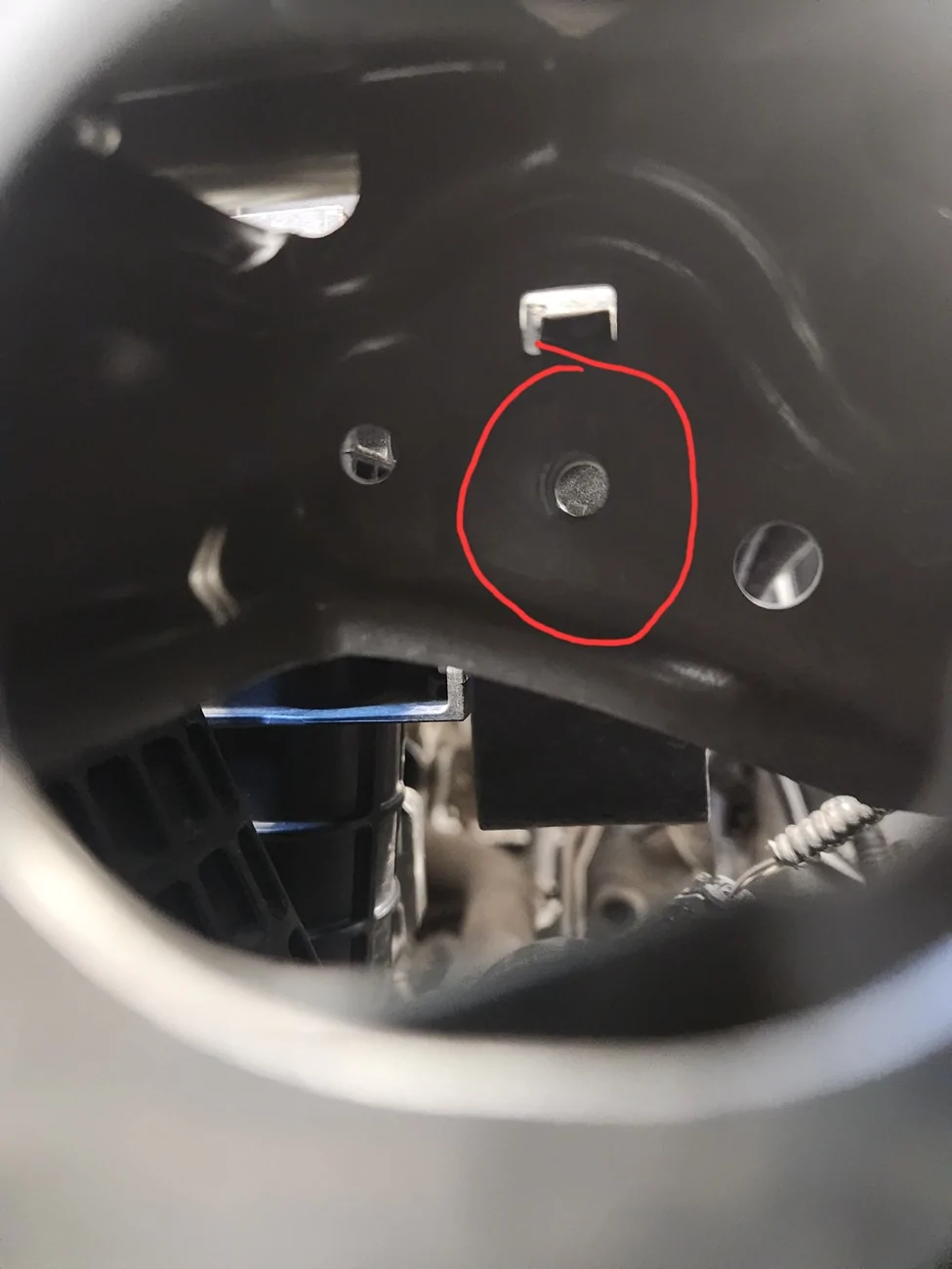

Here are the photos I took while doing the job. They might not be the best, but hopefully they help out. The bolt locations are circled in red. There are 6 bolts that I removed that allowed me to be able to move the radiator/intercooler assembly upward enough to get the bolt out of the control arm.
Remove this cover. The best way to remove the retaining clips is to push the center portion downward a little, then use a pick or screwdriver to pop the clip out.
Access the hidden upper bolt by moving the black plastic piece out of the way to gain access to the hole in the radiator support. You only need to remove the upper push pin holding the plastic piece in place. Its
There are two bolts located at about the middle of the radistor, just below the intercooler outlet. The upper left one you can't see in this picture, but figured I'd cire where it is. The next photo shows it from above.

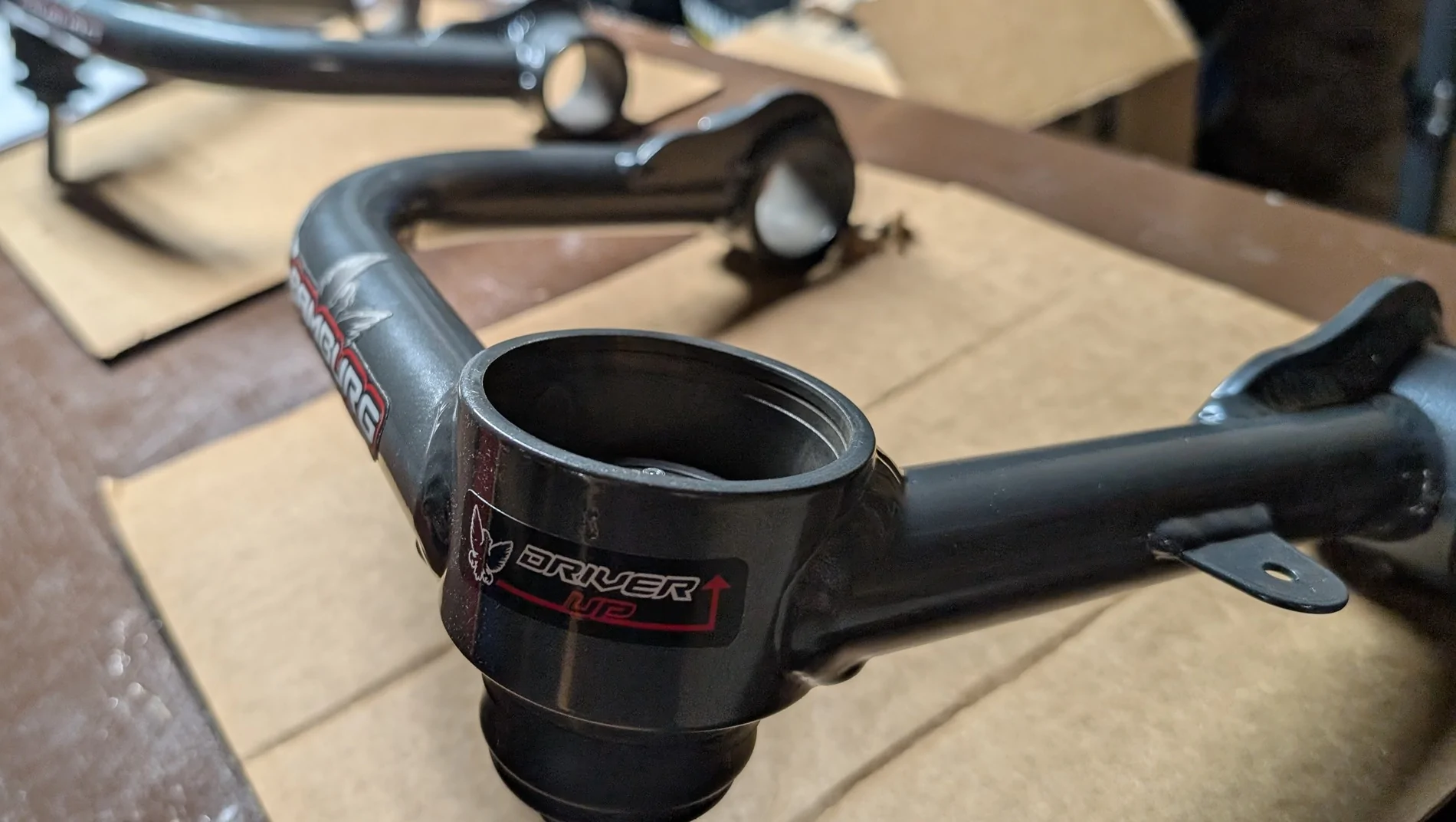

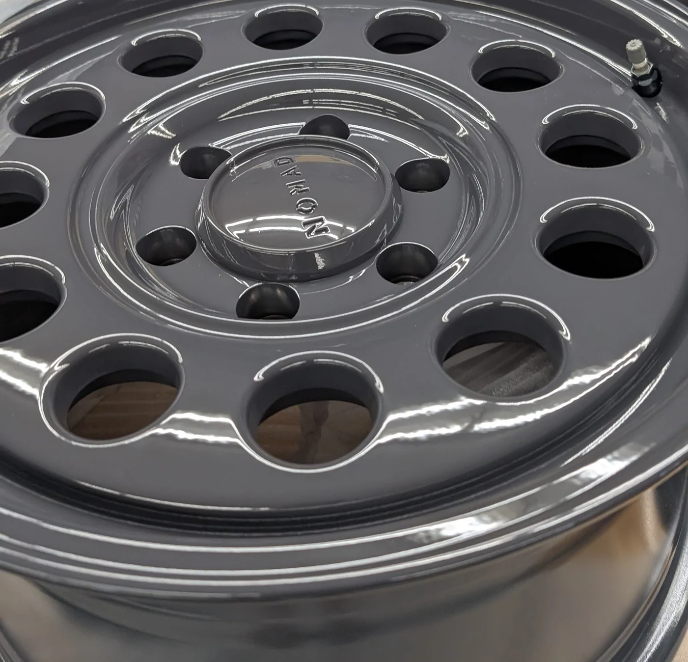

My Convoys arrived:
and so did my new UCAs as well:
