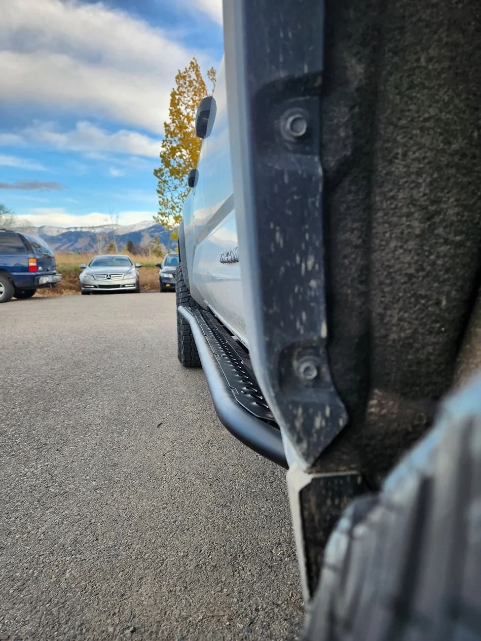

Tire poke is not that bad at all. I'll have to get something flat to put against the tire and measure to get a precise amount of poke, but it appears to be between 1.25" - 1.5" of poke.

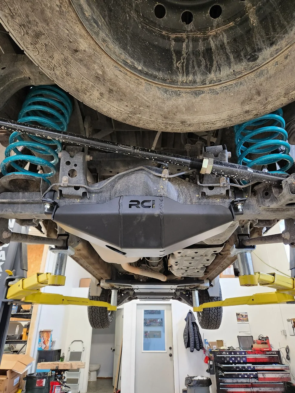

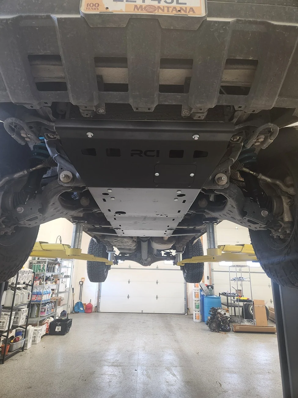

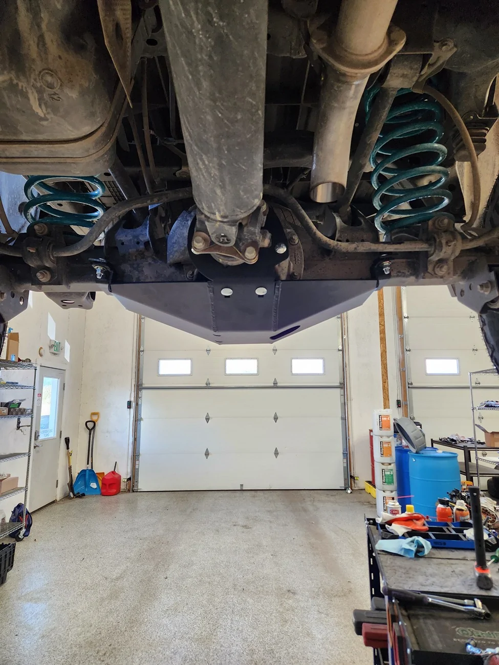

Added some more goodies to the Taco. Skid plates and sliders from RCI. I wasn't expecting the parts for a few more weeks, but was pleasantly surprised when they shipped early and arrived earlier this week. RCI's packaging and shipping is top notch.
2024 Tacoma 406Taco's 2024 4Runner TRD OR LB CSM Build 1000007498

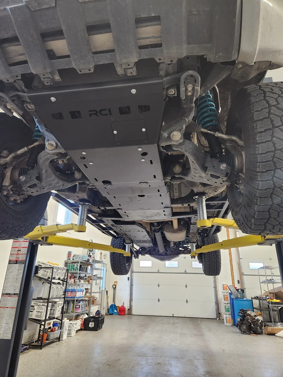

I installed several RCI skid plates, which included thier engine, transmission, transfer case, rear differential, and fuel tank skids. Install was pretty straight forward when following their instructions online.

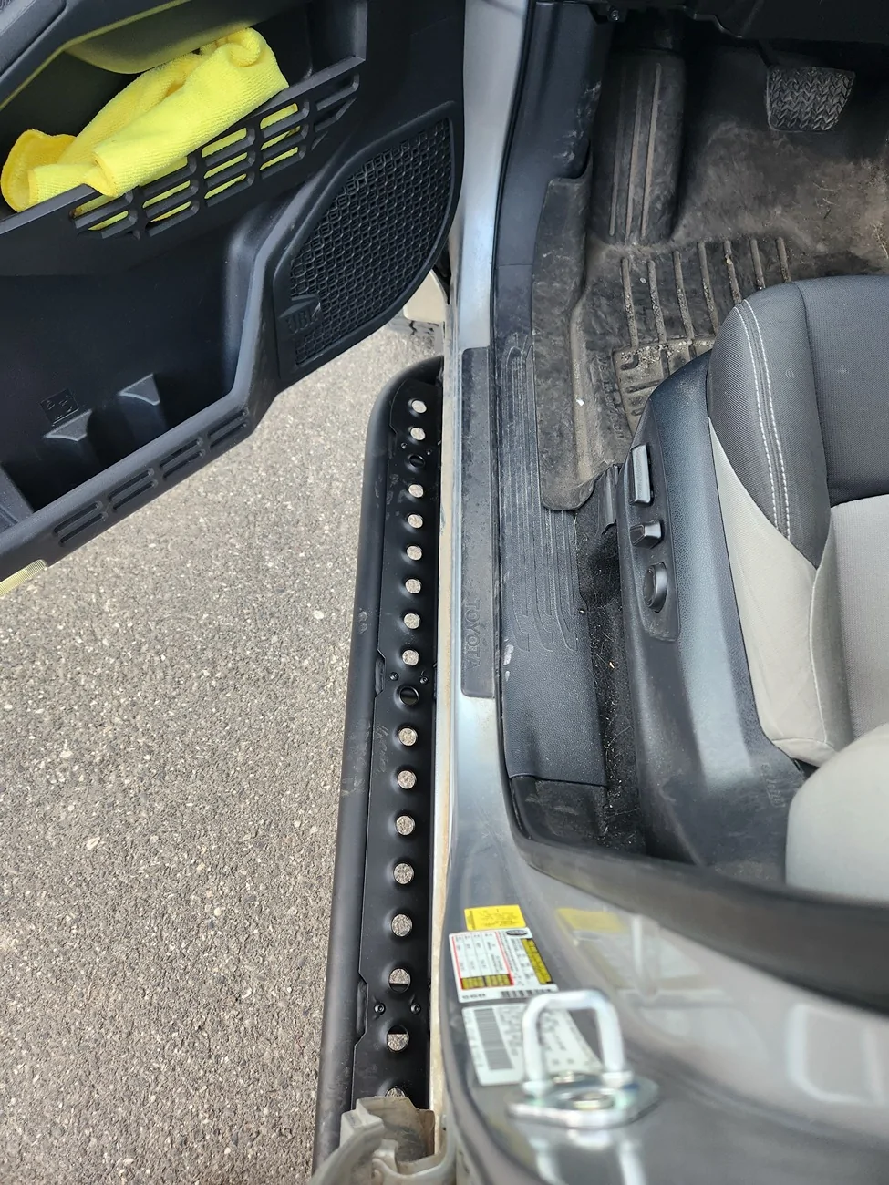

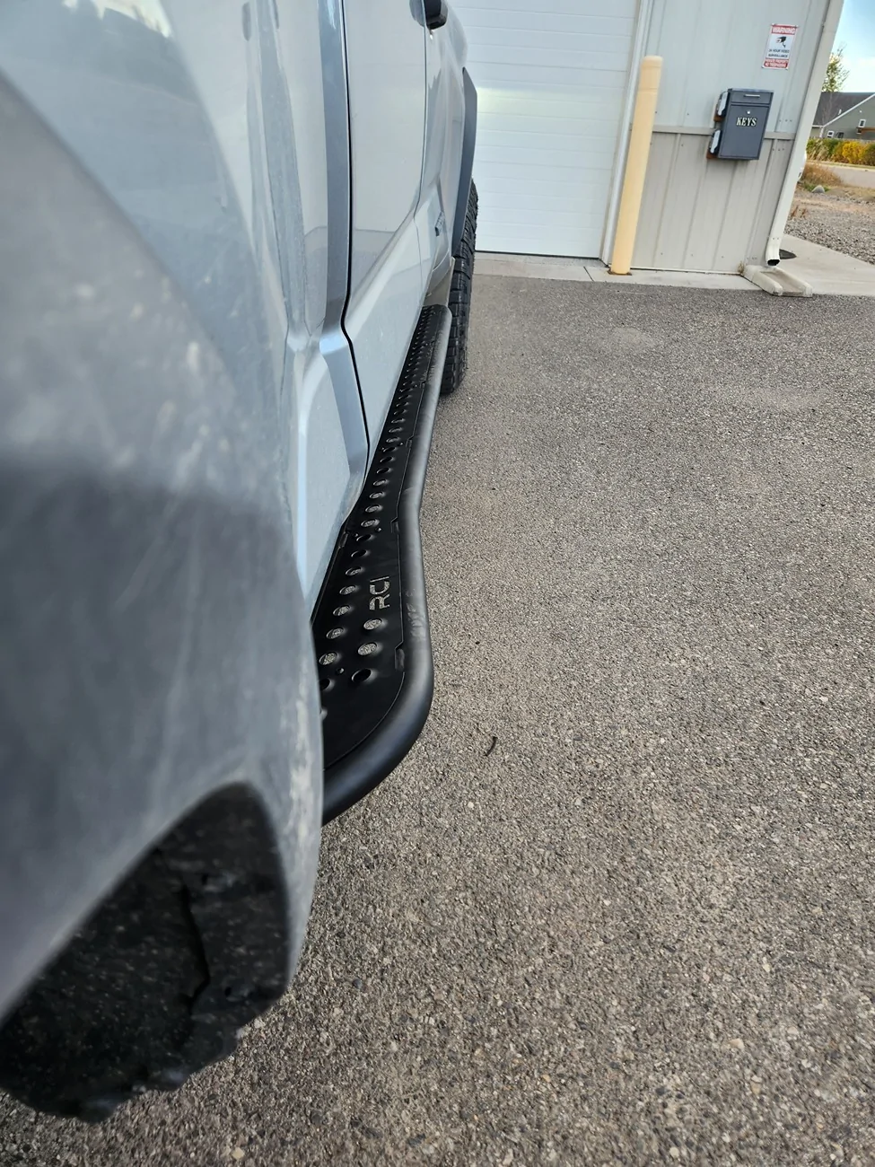

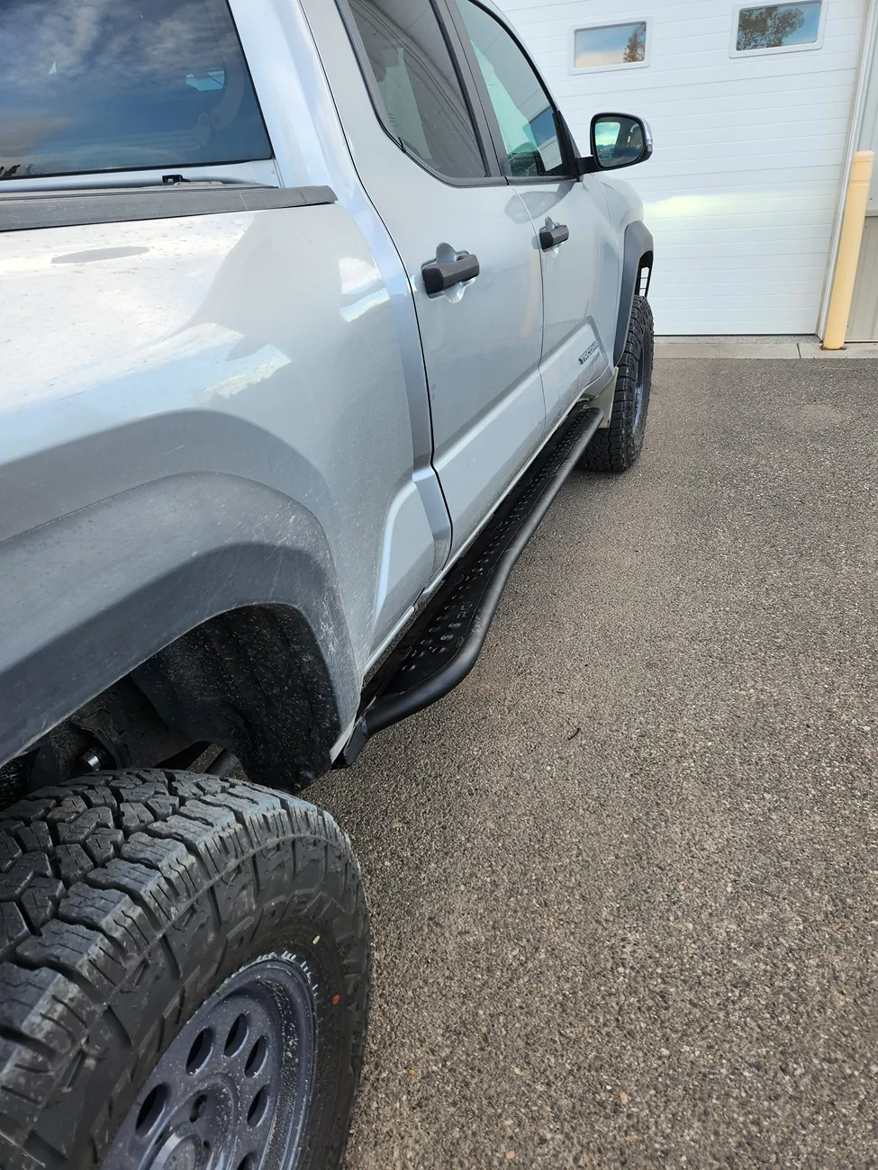

The only issue I ran into was that I had to remove the transfer case skid plate to install the rock sliders. I don't add wouldn't fault RCI for this, because its unreasonable to expect them to write in their instructions what to do for every possible scenario.
RCI does a pretty good job in their instructions for the skids on what to do if your installing another skid that uses the same mounting locations so that you are not having to unbolt stuff, which is nice.
The fit and finish of everything is pretty solid, overall. I imagine everything will perform just as good as they look.

Lifted long box’s look so good!
FYI had about the same amount of poke after I put on new wheels. Didn’t think it was going to be an issue until it rained, mud was slinging all over! Ordered Rough Country fender flares the next day. They add about 1.5 inches of additional width to catch the mud and rocks.
I don't mind the rain and mud flinging up on the truck. I come from Jeep land, lol. I may add some ppf to the bed in front of the fender flare to prevent paint damage though.
