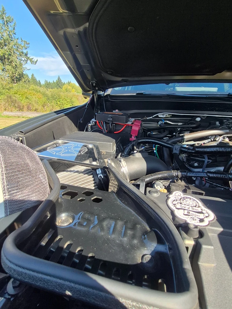

Distribution box
2024 Tacoma 5 amp switch for 4 amp lights ? 20250823_095718
