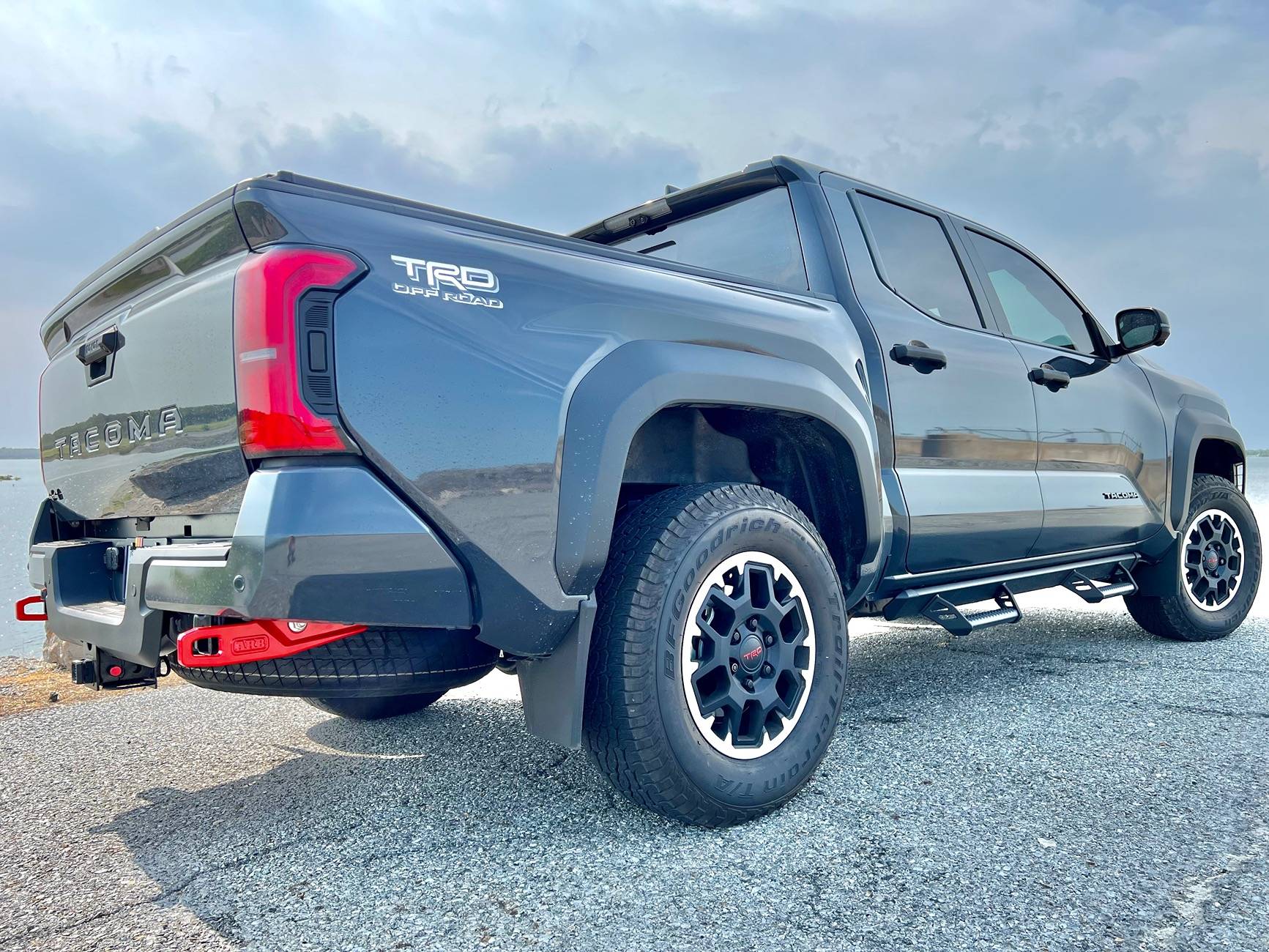

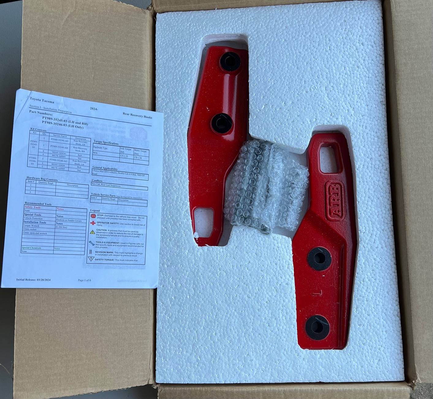

I installed the ARB recovery points on my 2024 TRD Off Road today.
Parts:
2024 Tacoma Install of ARB Rear Recovery Points on the 2024 Off Road Premium IMG_4820

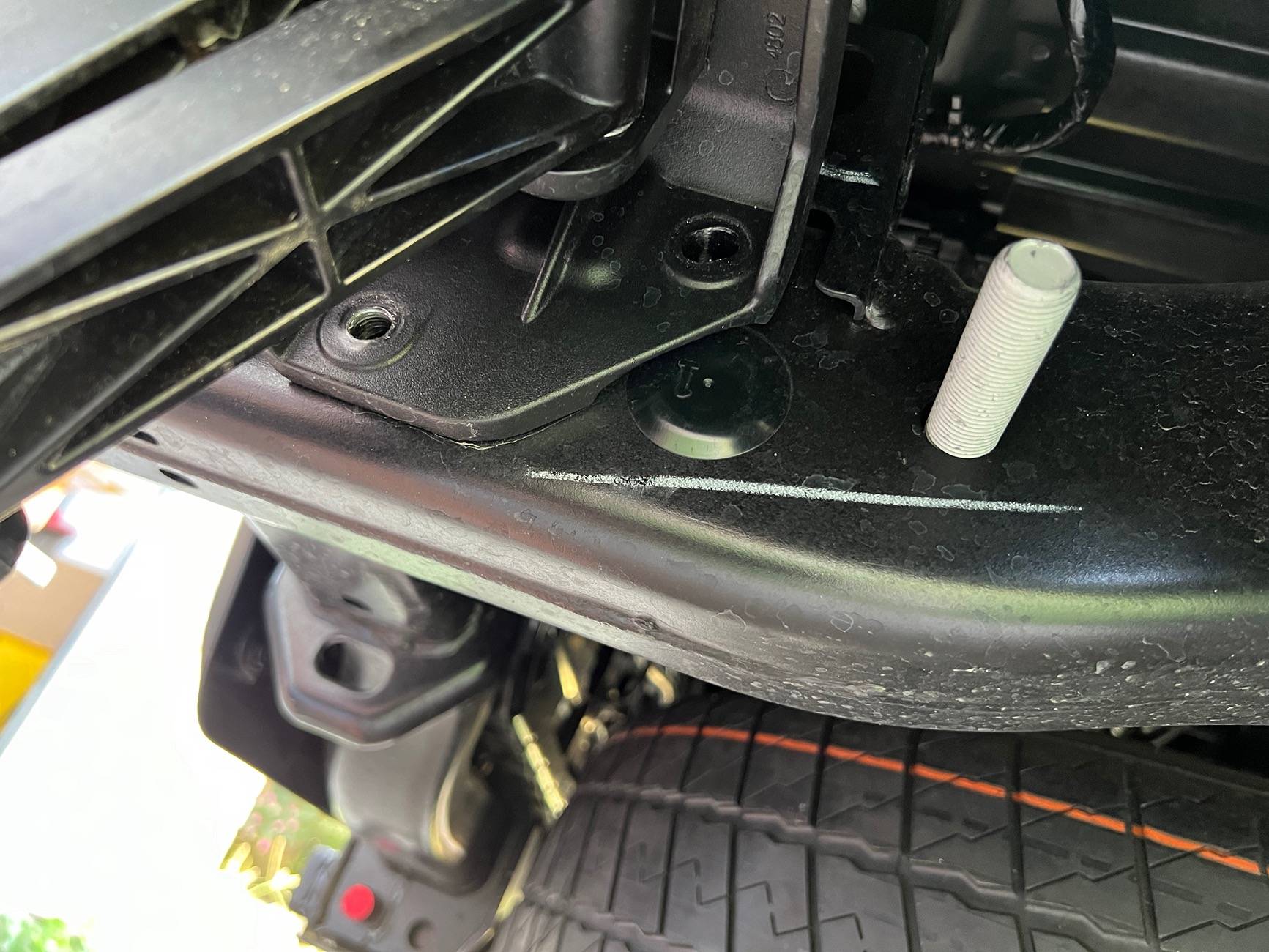

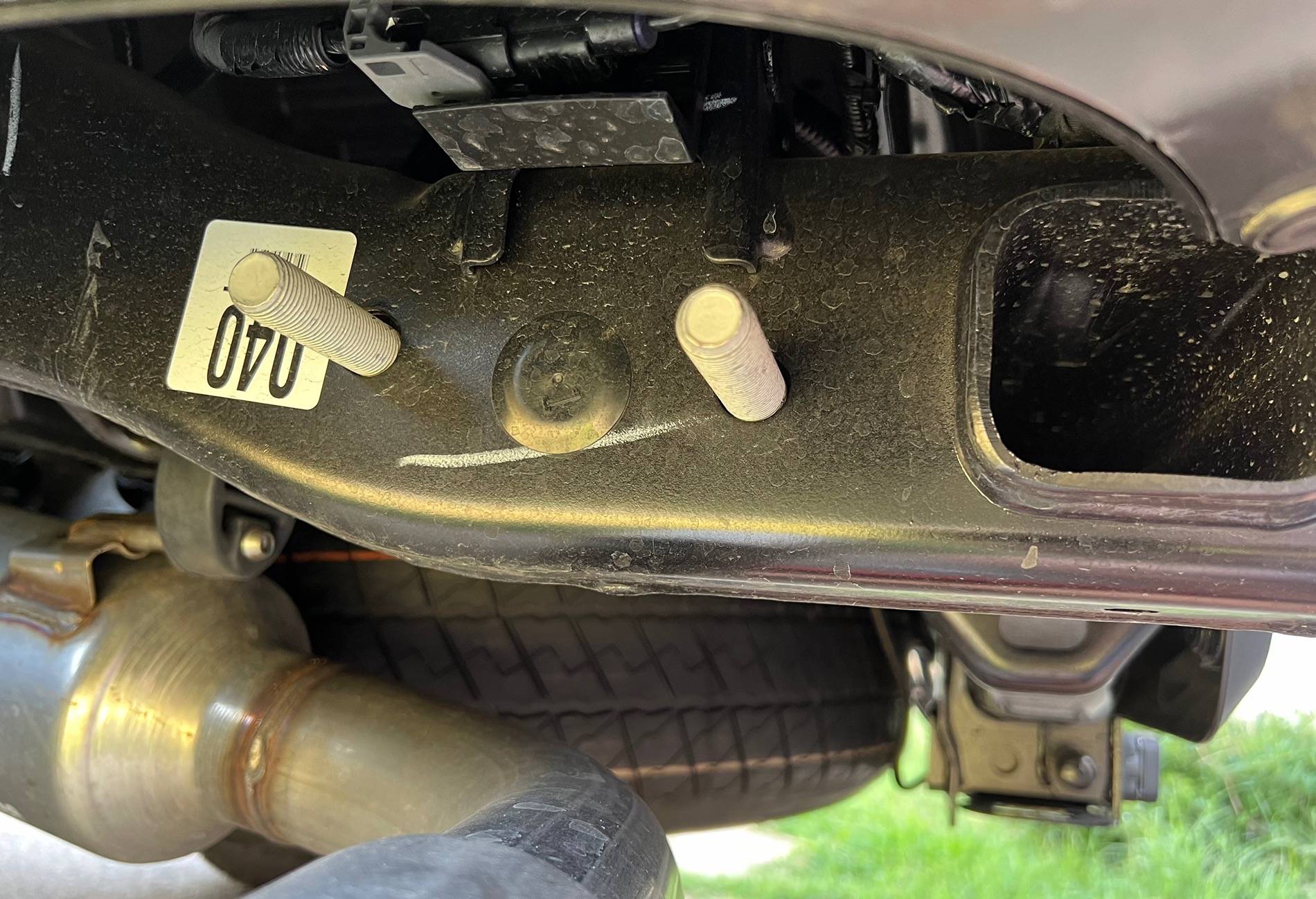

This kit ONLY fits certain models. You MUST have these holes in the frame to install the recovery points.
2024 Tacoma Install of ARB Rear Recovery Points on the 2024 Off Road Premium IMG_4821

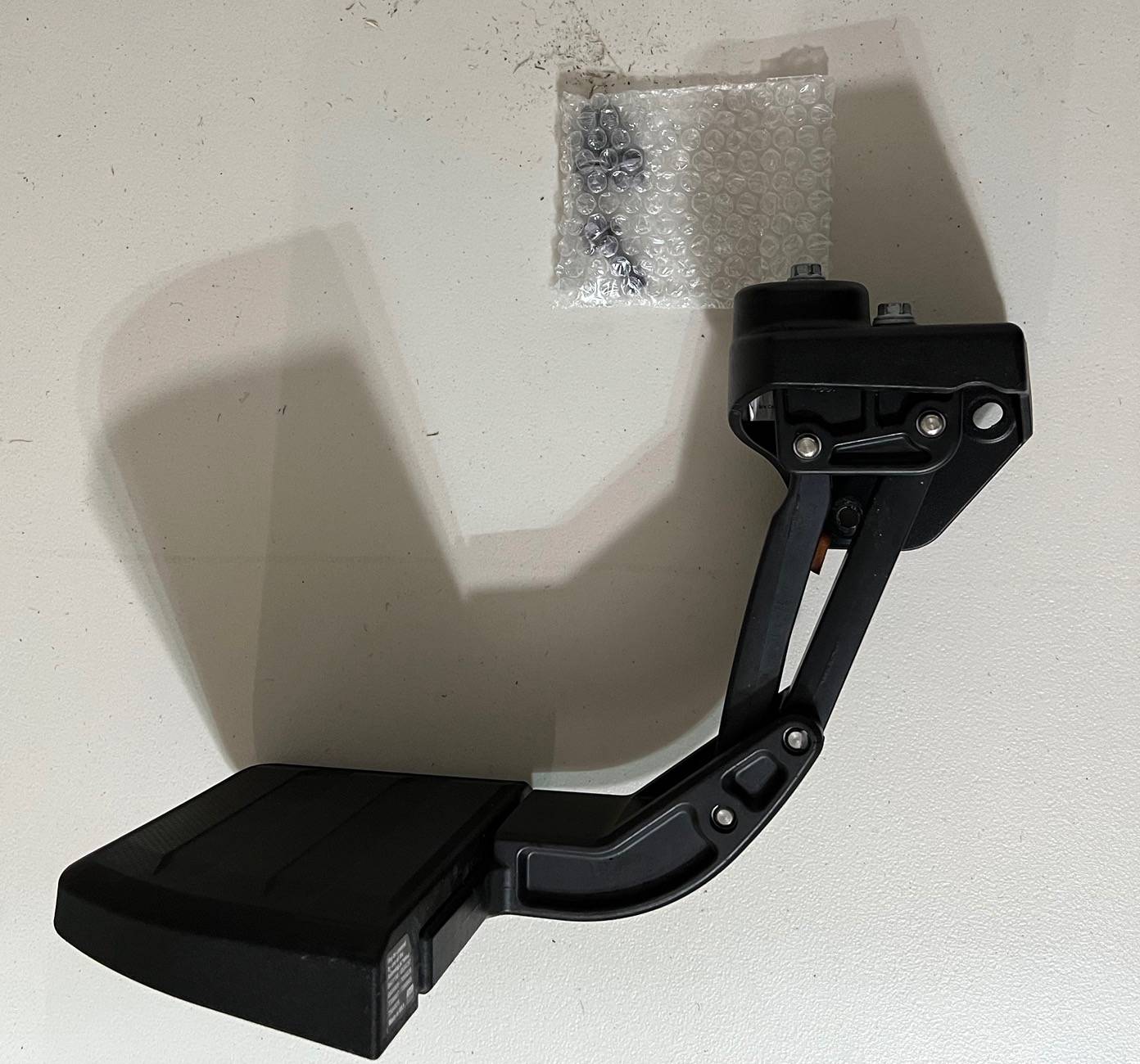

The left recovery point can be bought by itself if you want to keep the retractable bed step on the right underside of the tailgate. If you mount the right recovery point you must remove the bed step as it covers one of the holes needed to mount the recovery point.
2024 Tacoma Install of ARB Rear Recovery Points on the 2024 Off Road Premium IMG_4825
Once I removed the step the right recovery point mounts just like the left.

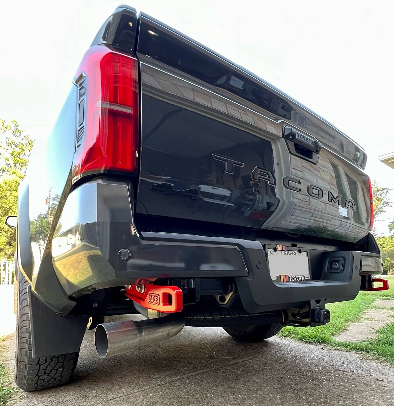

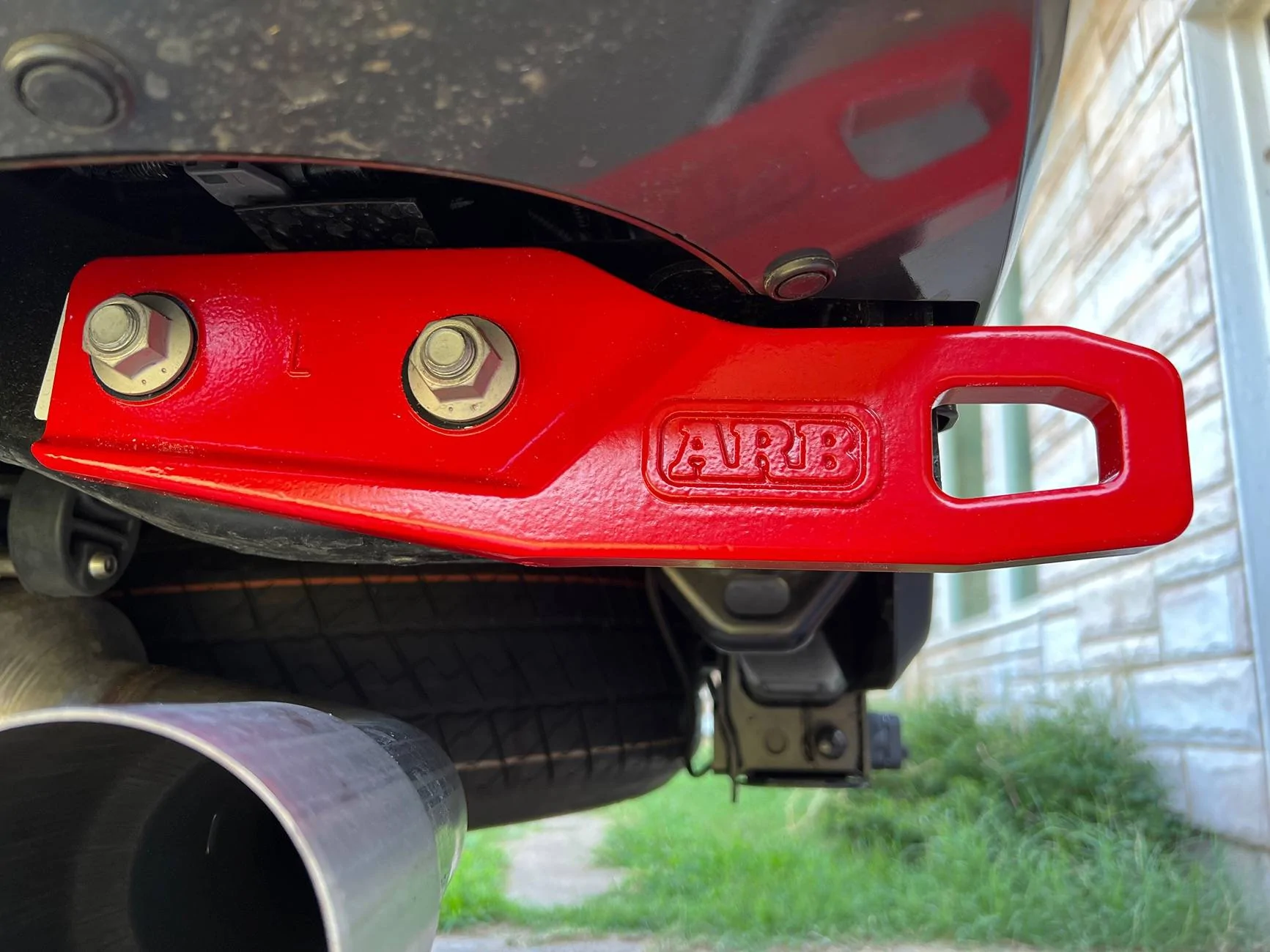

Installed:
2024 Tacoma Install of ARB Rear Recovery Points on the 2024 Off Road Premium IMG_4824
2024 Tacoma Install of ARB Rear Recovery Points on the 2024 Off Road Premium IMG_4830
2024 Tacoma Install of ARB Rear Recovery Points on the 2024 Off Road Premium IMG_4828
As a side note, I have an OEM retractable bed sep I can no longer use if someone is looking for one. lol
2024 Tacoma Install of ARB Rear Recovery Points on the 2024 Off Road Premium IMG_4836

Def looking for the step up ! I suppose it does, but do you know . . . does it fit a TRD Sport longbed ?
DoorKnob4531
Jun 18, 2024
64
2024 Tacoma Off Road TRD
The only way to be sure is to look at your frame and see if it has the threaded holes for the step hardware. The step doesn’t use nuts, the frame has nuts welded into it where the 3 step bolts mount.

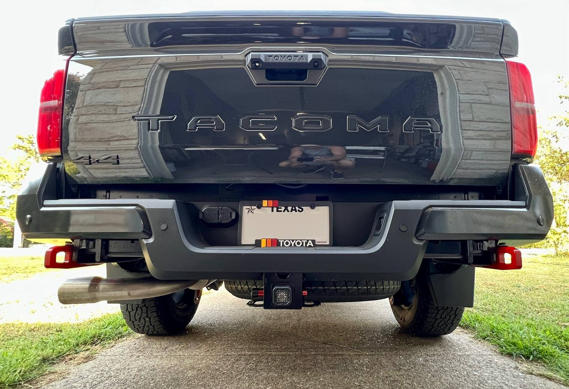

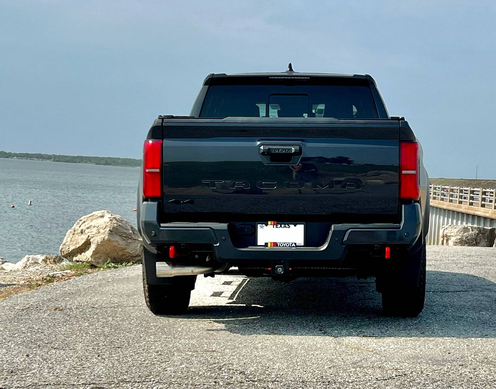

Could you post some overall, wider pictures from around the truck, showing the recovery points?

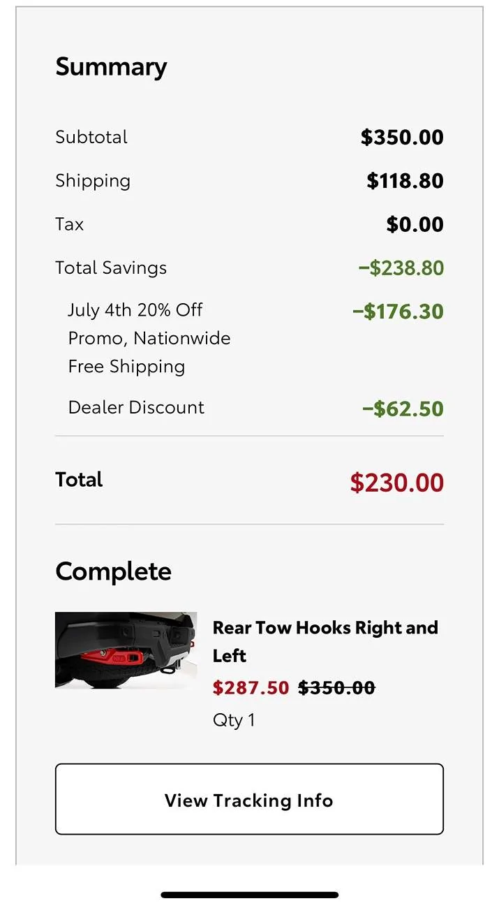

Great information but where did you purchase the kit? It’s not listed on the ARB website
DoorKnob4531
Jun 18, 2024
64
From a Toyota Parts dealer online. I order online so I don’t have to pay taxes and shipping is usually free.

So the steps don’t work with the recovery points? It’s either/or?
DoorKnob4531
Jun 18, 2024
64
Correct. At least the OEM Toyota model of step I have. Some aftermarket model might work if it mounted differently.
