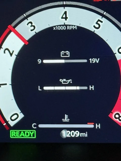

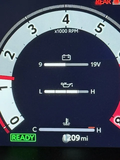

I agree Oldman, just did first oil change at 1100 miles and dropped in some 5w-30. Big change in oil pressure which is consistent with every other vehicle I've had and changed to a heavier oil. 5k miles and we'll see what the oil analysis says. Interested to see where it sits after fuel dilution and 5k miles.
You may want to further examine that. My findings are that even with 40 grade, pressure is basically the same in most conditions. That is because the variable displacement oil pump looks for certain pressure and it will do that no matter what viscosity is used.
According to the gauge the oil pressure at 2k rpm is one whole bar higher. I'm positive.

All previous vehicles showed the same increase in pressure with a heavier oil, and the fact that a Tacoma 15min south of the border is engineered for a 30w doesn't cause me to have any concern. Perhaps the concern would be a lower pressure with a 20w designated for cafe standards.

I think you’re misunderstanding. GSP is saying his pressure went up from the 5W-30. I said may want to check again because the variable oil pump generally keeps pressure about the same in all conditions because it is trying to meet specific pressures. So it opens up the flow to reduce the pressure to what it wants to see and it does that regardless of viscosity.
That’s because you’re looking at a cold engine. Need to compare hot to hot. Trust me, I’m running a thicker oil than you and my pressure starts where yours does cold and then it’s much lower when warm, unless revving 2000 rpm or more.
Yeah see this is cold behavior. When warmed up it’ll go down into the second bar at idle and way up to just at the 3/4 mark when revving. It goes into the 4th bar only when cold. So there is probably a small increase when cold but when it warms up the pump will keep pressure exactly where it was with the warmed up 0W-20.
I understand what you're saying but Im thinking its still much higher after reaching temp, Ill check on next go around.
