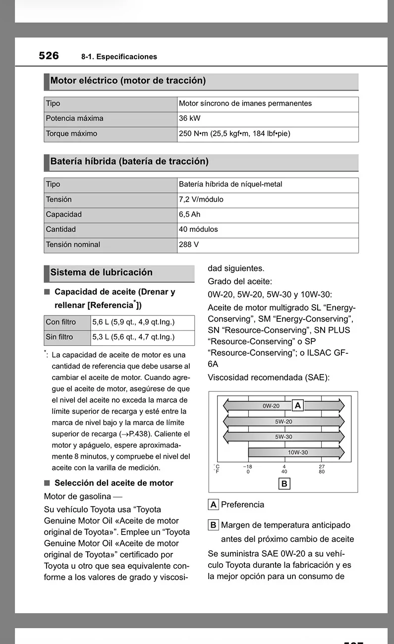

Can you advise all of us with the different parts+ part numbers for the T24A-FTS engine components that relate to the use of 0w20 engine oil, for the United States, compared to European T24A-FTS engines, which advise 0w20, 5w20, 5w30, and 10w30?
Also, these trucks are assembled in Mexico, engines assembled in the United States.. the same trucks with the same engines for the Mexico market, show the same oil viscosity options as the European engines.. also of note, Toyota indicates that 10w30 can be used from 0 degrees Fahrenheit and above- 10w30. From page 526..
https://www.toyota.mx/content/dam/tmex/pdf-manuals/manual-de-propietarios/tacoma/2024/OM04044S.pdf
2024 Tacoma 5w-30 IMG_0646
