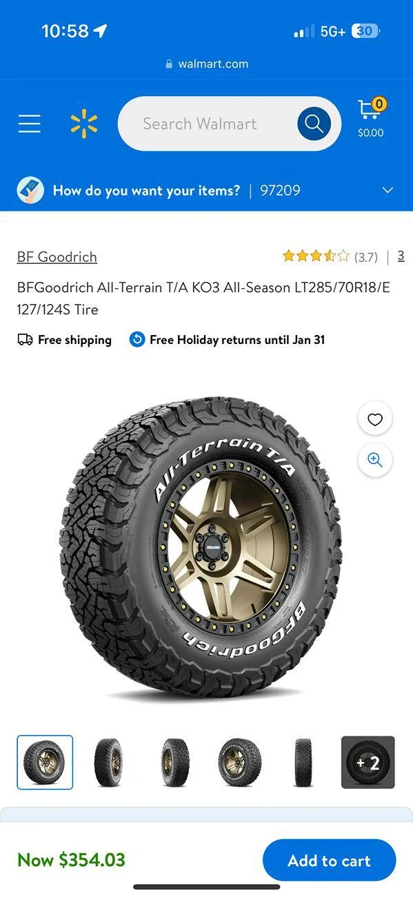

I know discount tire price matches. Did you pay discount tire prices or find a deal somewhere? I'm looking to upgrade also but think I will go with the 275/70R18 size so there is no rubbing at all. Still have to decide though, yours looks nice.

Yes, they matched WalMarts price. Which was a considerable amount of savings.
