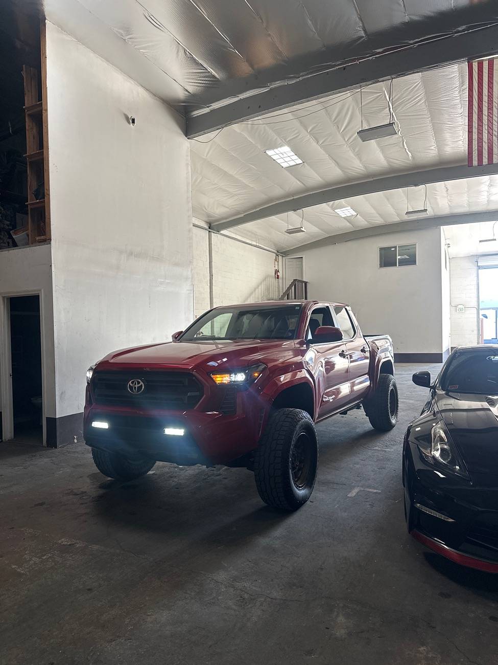

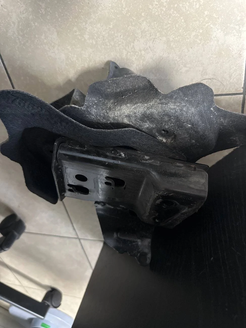

You should remove the back plate and gives you so much space to the point you can fit 35’s stock wheels
Interesting. Do you think you’ll have enough room for snow chains if you needed them?

Keep in mind that you are compromising frontal crash safety by removing the OEM crash pads. They are designed to deflect the heavy wheel/tire out of the cabin in a frontal collision.

That’s why I’m doing 285/70/18 and calling it a day, even if there’s a tiny bit of rub. I’m not comfortable removing the crash pads.

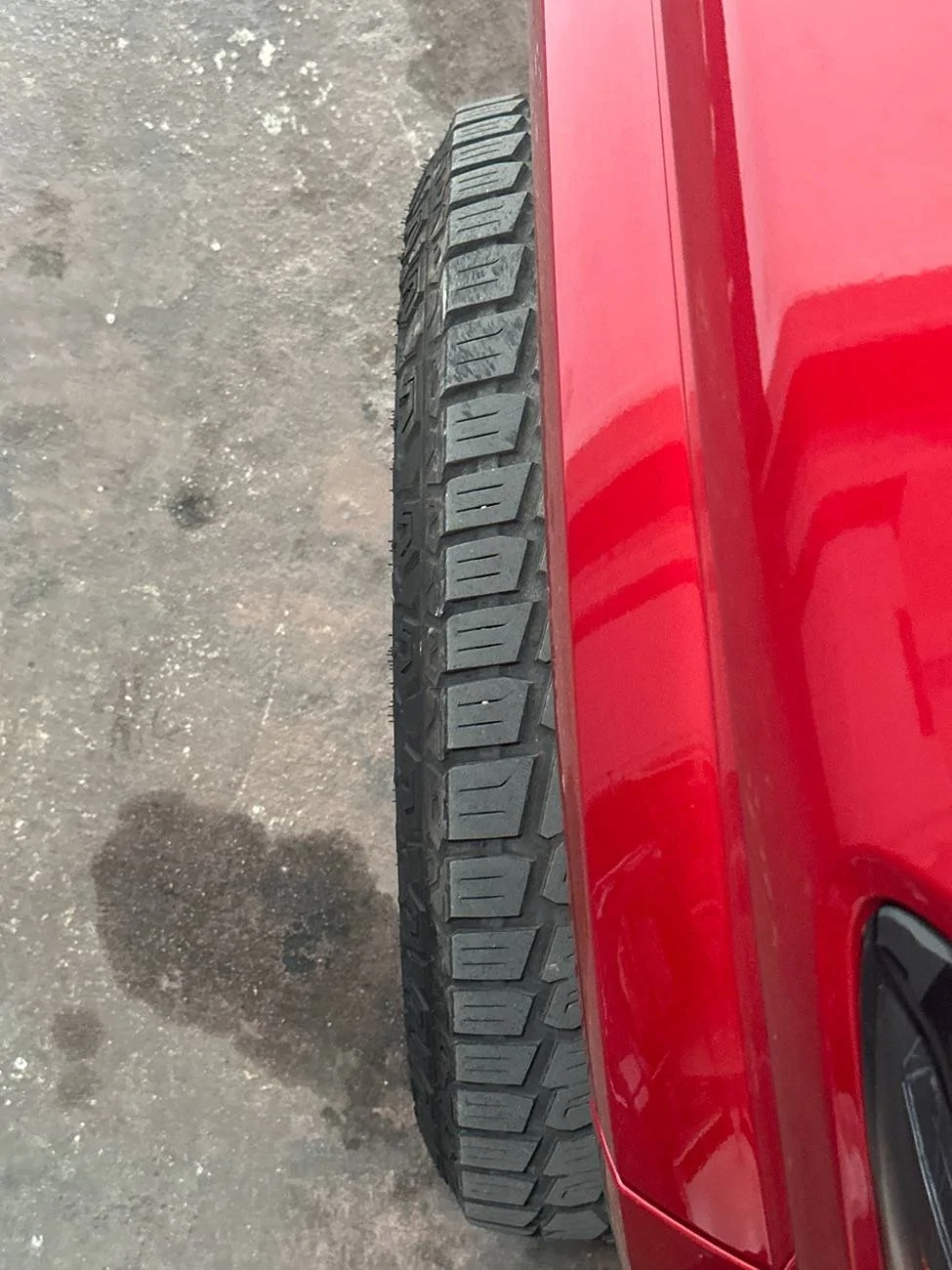

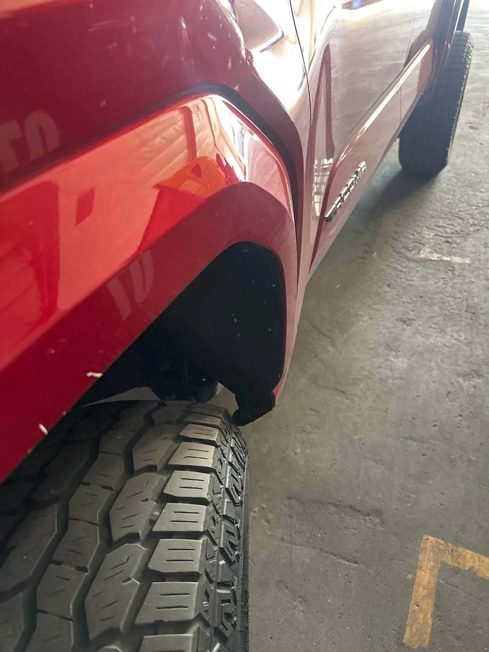

Figured I'd update ya'll on fitting 285's on stock Trailhunter wheels. Chris and TJ @Discount Tire in Seattle really took care of this install. No rubbing so far, might remove the crash pad after I take it out on some rough terrain to test any contact. I forsee having to get some aftermarket mud flaps....the OEM ones don't offer much coverage.
BFGoodrich
All Terrain T/A KO3
LT285 /70 R18 127S E1 RWL
BEFORE:
AFTER:
