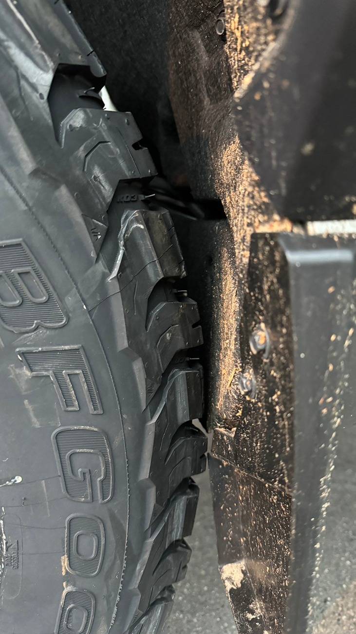

So this is the *exact* tire I want to put on my stock Trailhunter wheels - thank you so much for posting. You look super close to the crash pad. I’m surprised. Do you think it’ll rub? Keep us posted please.

Keep us posted. Any rub or wear should be limited to the crash pad felt, which seems fine

Looks great, keep us posted on any rubbing issues. It does look close to that crash pad and when your aired down its a little softer.

They don't rub enough to really be noticeable. If anything they just hit the felt. (See original post for update!)

So after driving in multiple roadway conditions, I have some findings to report. When turning full lock on a hill (up or down) I notice that there is a tiny bit of rubbing, but it sounds like it's hitting felt and not plastic. Also, I noticed that when in reverse, at full turn, there is some kind of vibration, but I need to investigate further with the help of an additional person. I will report my findings next week. I still don't plan on trimming anything, as I'd like to go a few hundred more miles so the location of the slight rubbing is more apparent b/c right now, everything still looks clean.

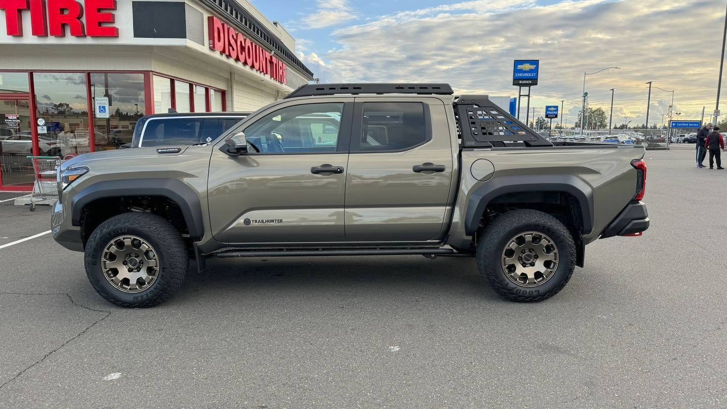

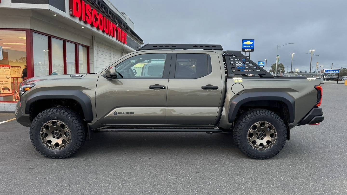

Figured I'd update ya'll on fitting 285's on stock Trailhunter wheels. Chris and TJ @Discount Tire in Seattle really took care of this install. No rubbing so far, might remove the crash pad after I take it out on some rough terrain to test any contact. I forsee having to get some aftermarket mud flaps....the OEM ones don't offer much coverage.
BFGoodrich
All Terrain T/A KO3
LT285 /70 R18 127S E1 RWL
BEFORE:
AFTER:

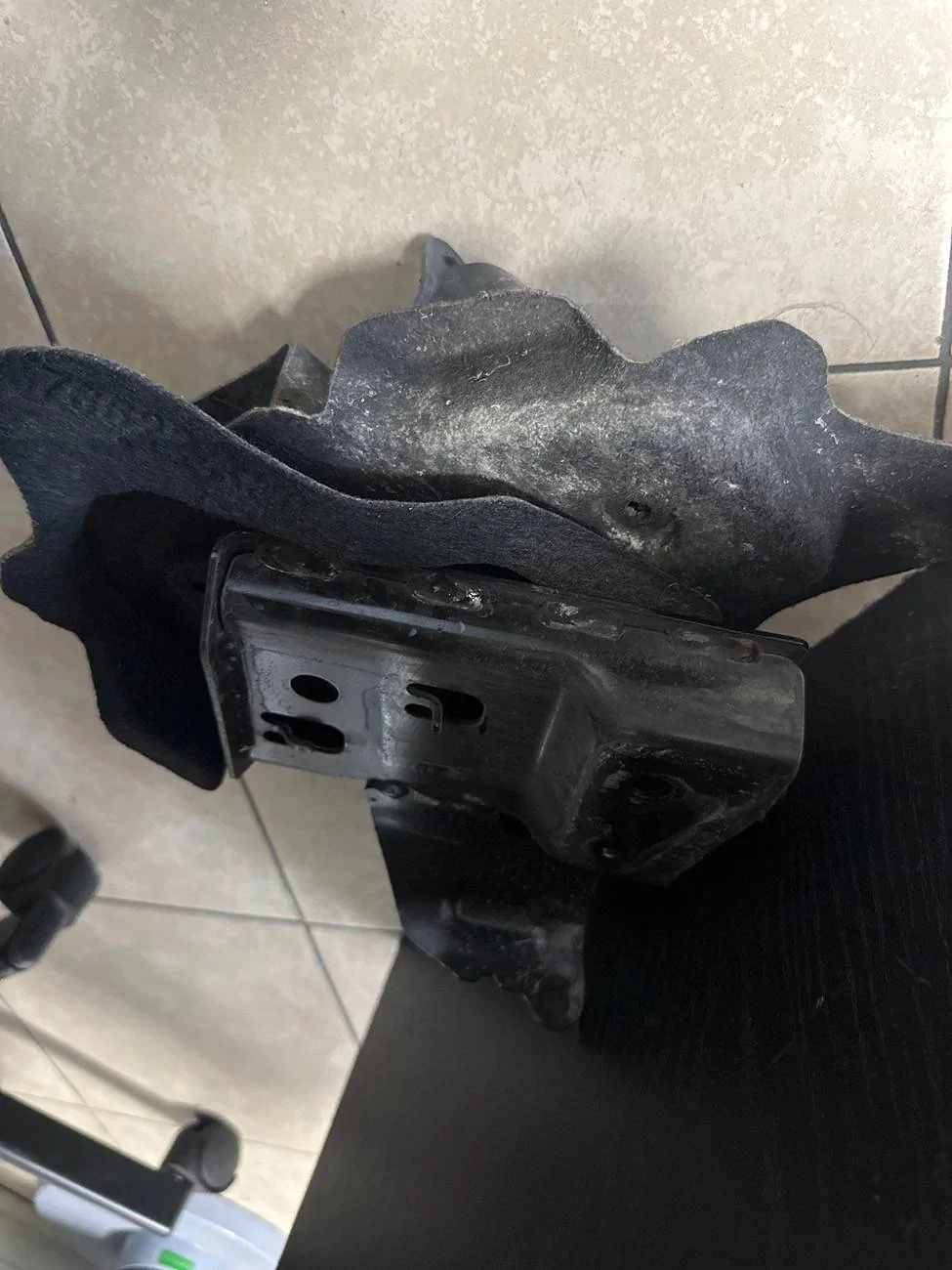

You should remove the back plate and gives you so much space to the point you can fit 35’s stock wheels
