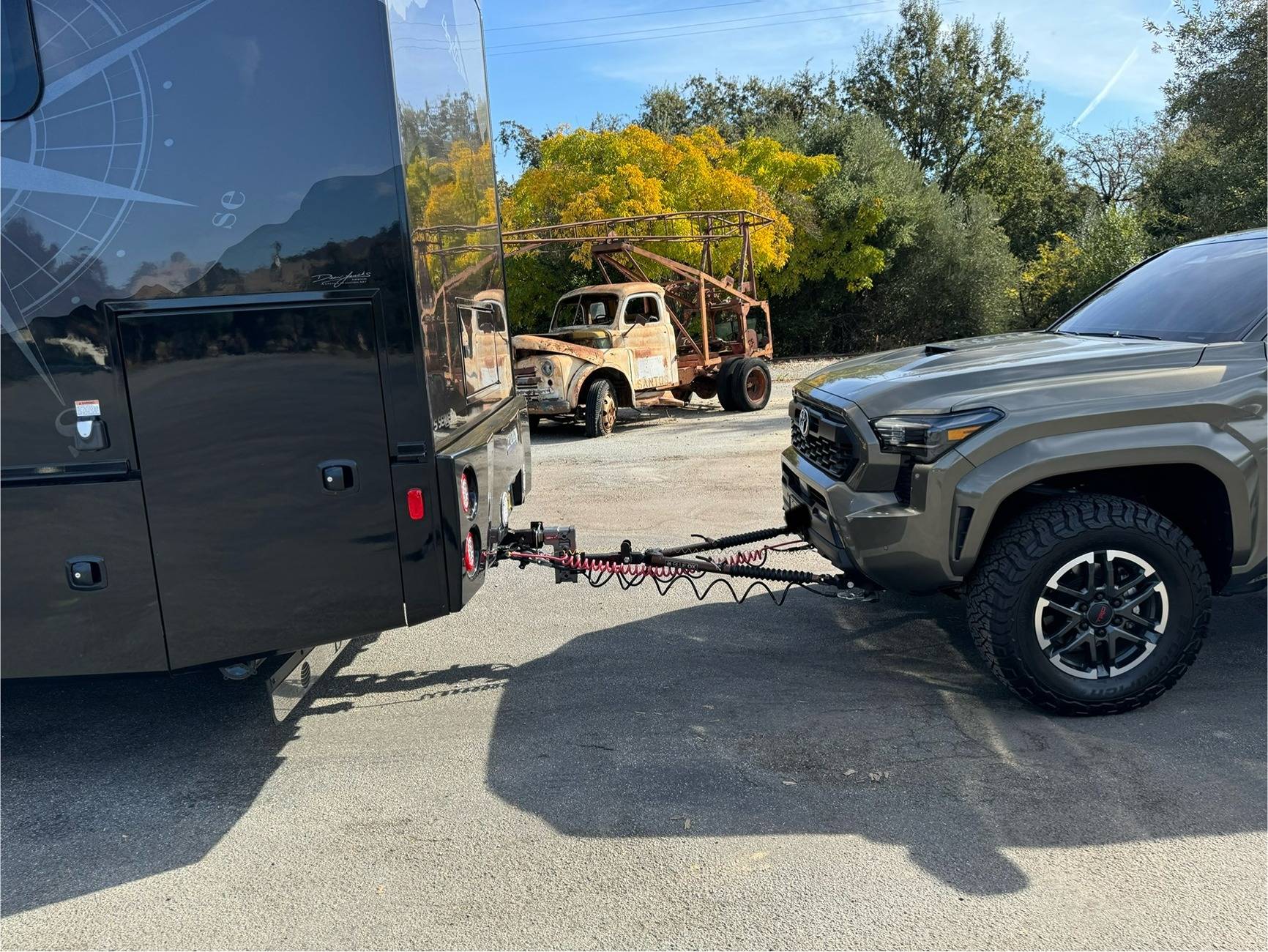

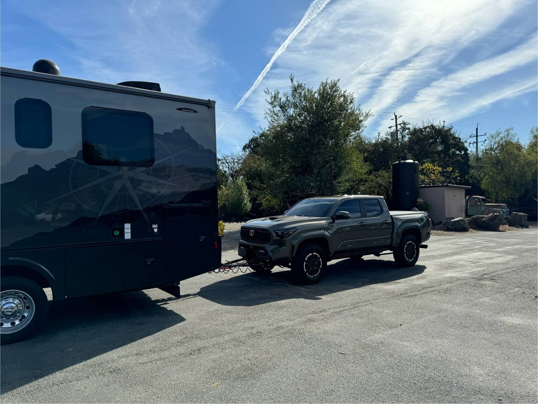

Just wanted to share that 4g tacomas can be flat towed with a driveline disconnect. There is NO steering wheel lock on this gen, so there is no need to bypass that at the fuse box. I tested this by leaving the truck off, locked, and on the air overnight, but the steering wheel did not lock. I also had the dealership look into it, and they confirmed that it does not lock (not sure why there’s a ā€œsteering lockā€ fuse either); they checked other units on their lot too. I completed a 500 trip this weekend with no issues.
The other stuff installed for flat tow its pretty generic. Here are some pics. Hope this helps other people, I sure scratched my head a few times getting this to work. Happy it works.
The other stuff installed for flat tow its pretty generic. Here are some pics. Hope this helps other people, I sure scratched my head a few times getting this to work. Happy it works. View attachment 21805 View attachment 21806
What does the red cable do? What brand hitch is that?

Sure thing. I have a blue Ox tow bar (7500 lbs) and used a Gen Y Hitch to achieve the appropriate height level between the truck and RV. I also added anti-rattle brackets at both places. It's a little overkill everywhere, but that’s me.
I used the front D-Ring shackle kit from Rough Country as baseplates for the Tacoma. It has a super clean look and is efficient.
Disclaimer here. This route isn’t for everyone, as the kit is designed for ā€œrecovery purposesā€ only and not for towing. That freaks people out, but I figured if they rated to be used during recovery, potentially stuck somewhere, and using a winch and other forces to pull/recover the truck; I figured I’d be okay. Nonetheless, I also asked some friends who happen to be engineers and enjoy doing complex math for a living at a company that sends rockets to space. They looked at the mounting locations, the material used, size of hardware, towing angles, and force used while towing and did not see a problem with my application. Again, it is not for everyone, and that is the risk I am taking, I am aware. Oh, super cheap too! $150 instead of $500+ for actual baseplates. I personally hate the look of baseplates, again that's me.
Anyhow, for brakes, I have the RVi breaking system, and I installed their battery charger +. The system works well, and it's neat to see everything on a tablet.
For wiring, I tapped into my taillights at the rear with diodes for variable-voltage LED lights. When I did it, I had to build my kit, but etrailer just came up with a kit that has everything.
I can't think of anything else. As I mentioned in the first message, you don’t have to do anything to your steering, as it doesn’t lock.
The driveshaft disconnect was sourced from a superior driveline in Iowa. I don’t need to say this, but this is the most important thing of the entire set up.
I hope this helps you. Let me know if I can answer anything else. I was almost a victim of selling the Tacoma to get a Jeep, but I'm glad I'm stubborn and made it work. It sucks there is a not tons of info out there in getting Tacomas flat towed, but many people have done it.
