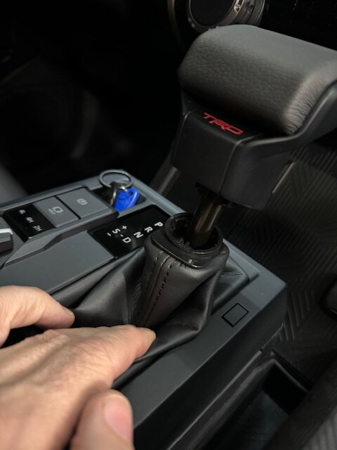

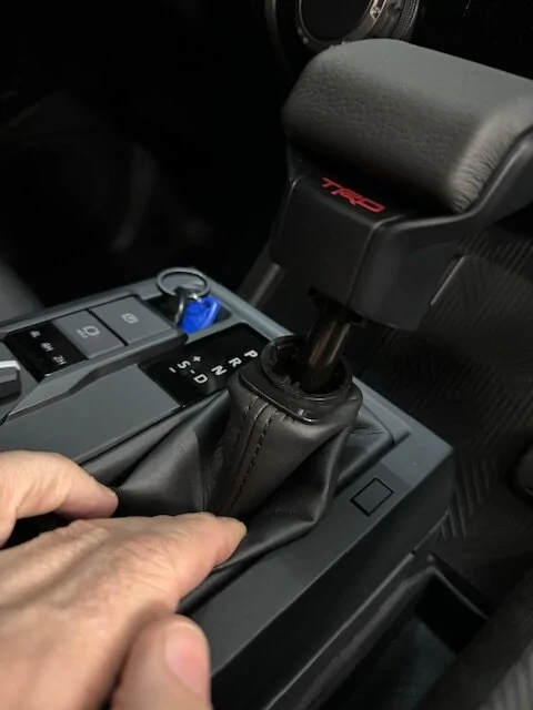

Console is easy to take apart
1st just pull down on the shift boot

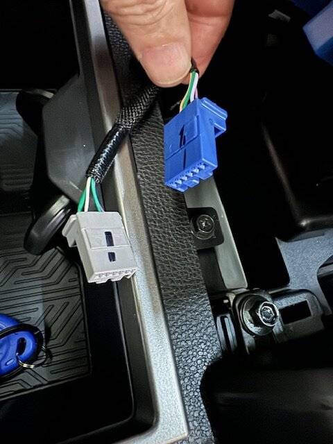

Also, there are 2 factory harness plugs in there, connected to the switch blanks in the console - I have no idea what they go to

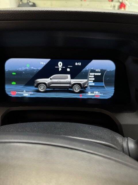

To the question about does it really work - I was in a dirt field by my house and tested. I cycled through the settings and drove. The dash light not only changed, but you can tell when the VSC would engage and disengage.
