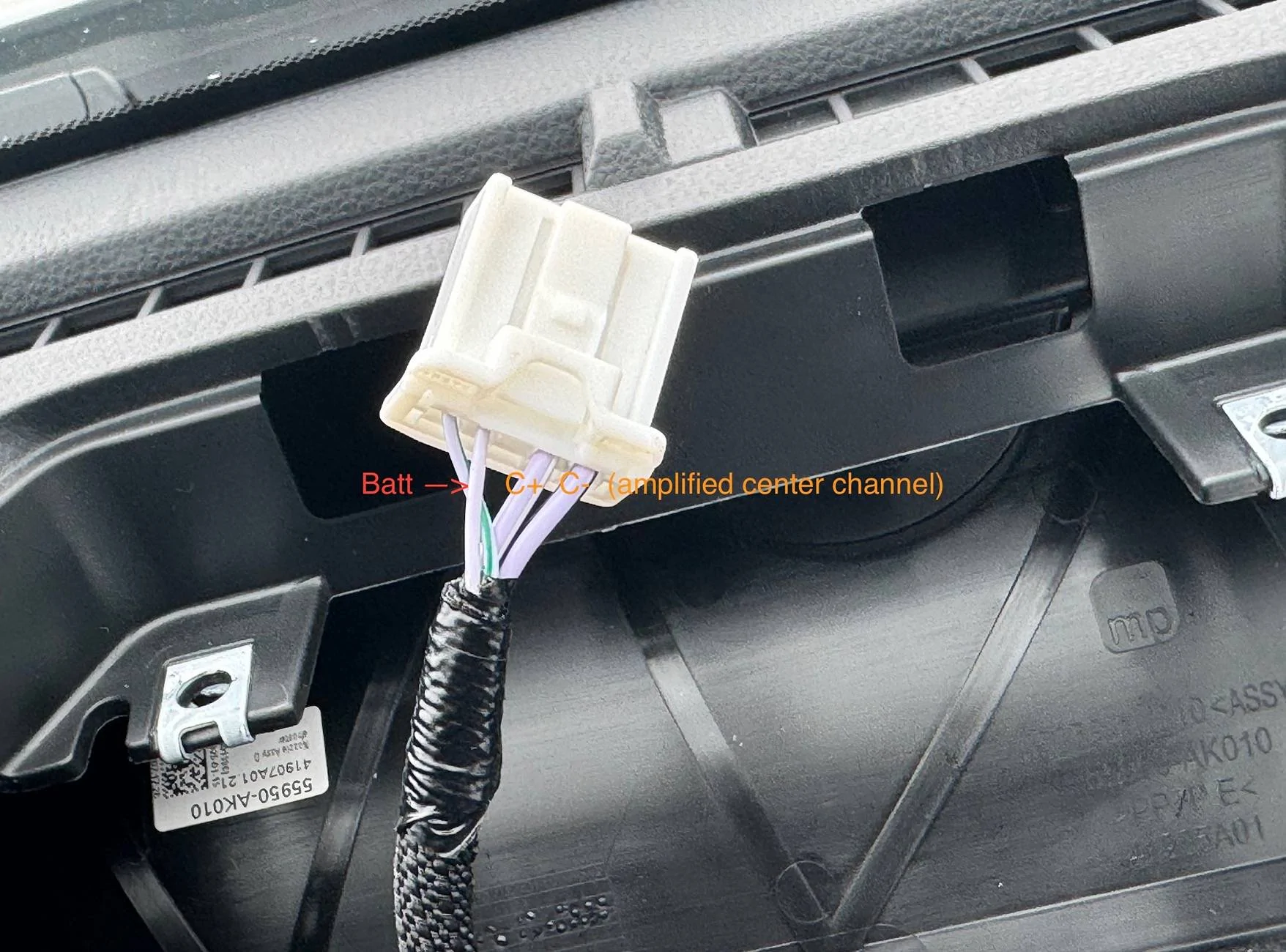

I would first make sure you're content with the front L/R audio when the JBL is installed.. It seems the EQ is reconfigured when the JBL is present (eg: battery/12v circuit closed on the connector below). This was not the case when I connected a passive center channel speaker, just to the amplified center speaker 2-wire pair.
- wall plate/cover would be removed from VOL7035
- Remove dock from dash, disconnect the connector [below]
- Install on the amplified center channel [C+/C- below]

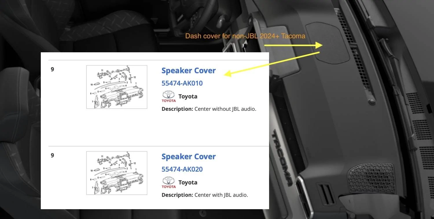

For those wishing to replace the JBL center dock assembly altogether with a custom center channel speaker using the existing amped center channel wiring the following would be needed:
1) Non-JBL speaker cover which would be cut to hold replacement speaker(s)
OEM Part No.: 55474-AK010
2) Replacement speaker(s) - EG 1 or 2 JBL Club 34F, Pioneer TS-A709/879 etc
JBL: https://a.co/d/ixfjjSb
Pioneer: https://a.co/d/0wTkOEF https://a.co/d/hyy2FFF
3) Speaker cover (black nylon else one/two 3" or one 4" speaker covers)
I've ordered two OEM non-JBL dash covers and the 2.75" Pioneer TS-A709s and will report back. I went with the 2.75" TS-A709s vs. other 3.5" expecting I can squeeze two side-by-side vs the larger 3.5" diameter speaker options.
2024 Tacoma Any fixes for levelling the JBL center channel yet? Tacoma non-JBL cover
