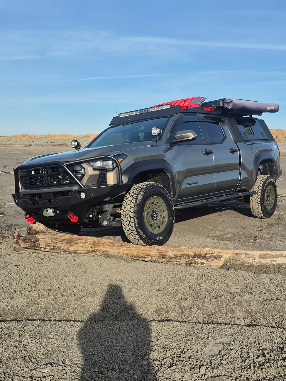

Total chaos up for control arms with a full king suspension and new king droplinks with Dobson 819 rear coils.
Amazing ride and unmatched performance.

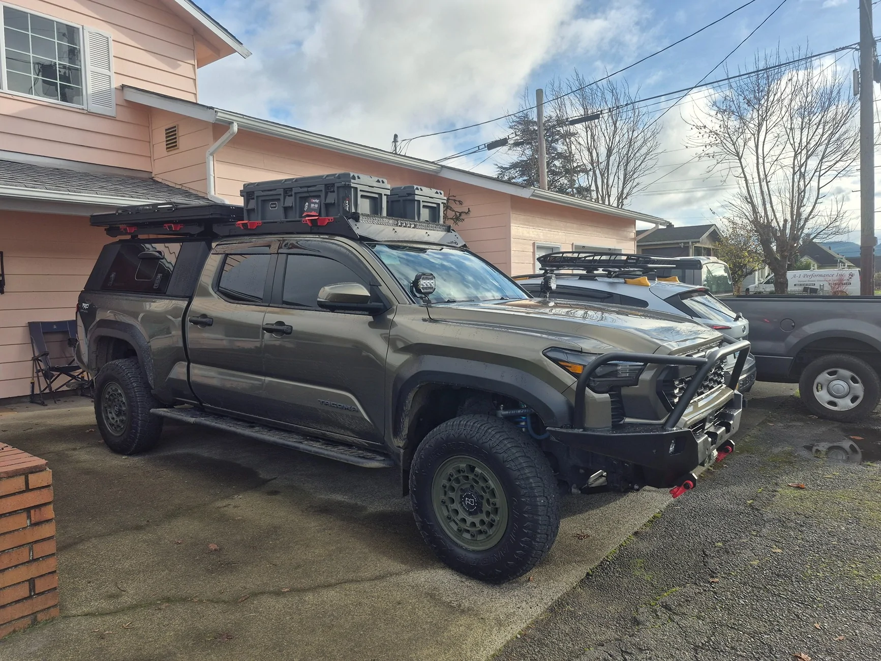

The way my truck is set up. It is a much softer ride than factory yet holds itself much better than stock in the corners.
My setup is around 2000lb over the stock curb weight and still handles amazing, and bumps are a thing of the past.

When you say bumps are a think of the past do you mean the “jolting” feeling when going over imperfection roads?
I'll let him speak for his truck, but I'll give my impression of similar suspension I've owned/driven in the past (Icon, King, etc).
As long as the suspension is properly tuned for the truck weight and spring rate...
Harshness practically disappears from any sharp bump the truck hits. Washboards and stutter bumps get absorbed by the shocks and don't make it through the steering wheel or chassis. Deeper compressions are smooth and controlled - I could [lightly] jump my GX470 and it felt like it didn't leave the ground.
The downside to all that performance is the maintenance - these shocks are not "install and forget" parts, they need fluid and o-ring changes every 25-30k onroad or 5-10k moderate offroad miles. If you're pushing them hard offroad, they need service every 2-3k miles. Full rebuilds with new bushings and seal heads every 2-3 oil changes, depending on conditions. Every service needs a nitrogen recharge too.
You either need to get really good at suspension work and invest in ~$1k of tools/equipment, or have a good suspension shop ready to do the work for you. And hopefully they are local because shipping your shocks every time they need work SUCKS.

Thank you! That was very helpful especially the additions maintenance part that is needed.
Exactly.It takes all the jolting and jostling out of the ride. I reel it in the deep sand all the time, it likes to catch air and lands beautifully
Glad to help. I miss my last Icon setup because I could drive the heck out of it, and the truck handled everything. But the maintenance is a harsh reality that most people don't talk about. If the maintenance is neglected, the main shock parts themselves start to fail and once the shaft and body are worn out it's effectively cheaper to replace the whole shock.
