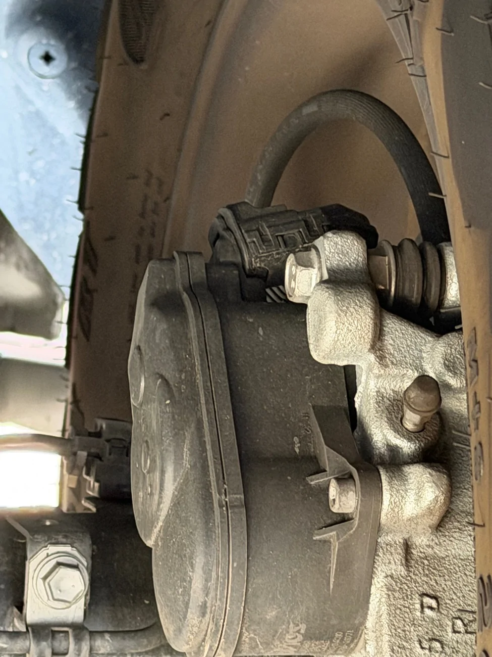

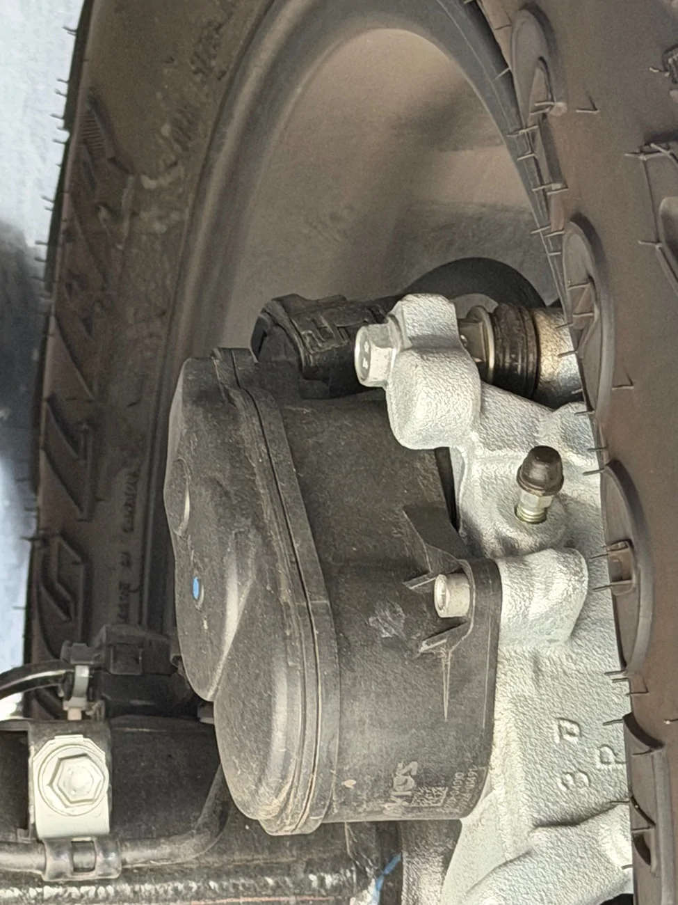

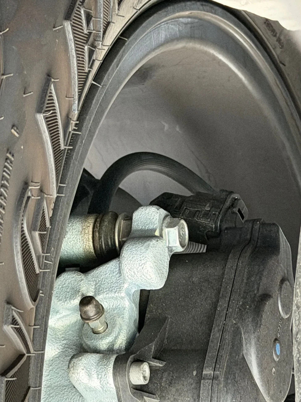

I was in for service and got the brake line recall on my '24 Tacoma. I took a photo before, and after. I really can't see a difference. Maybe the soft line is an inch longer in the after photo. Can you see it?
Before:
2024 Tacoma Before and After - Brake Line Recall BrakeBefor
After:
2024 Tacoma Before and After - Brake Line Recall BrakeAfter

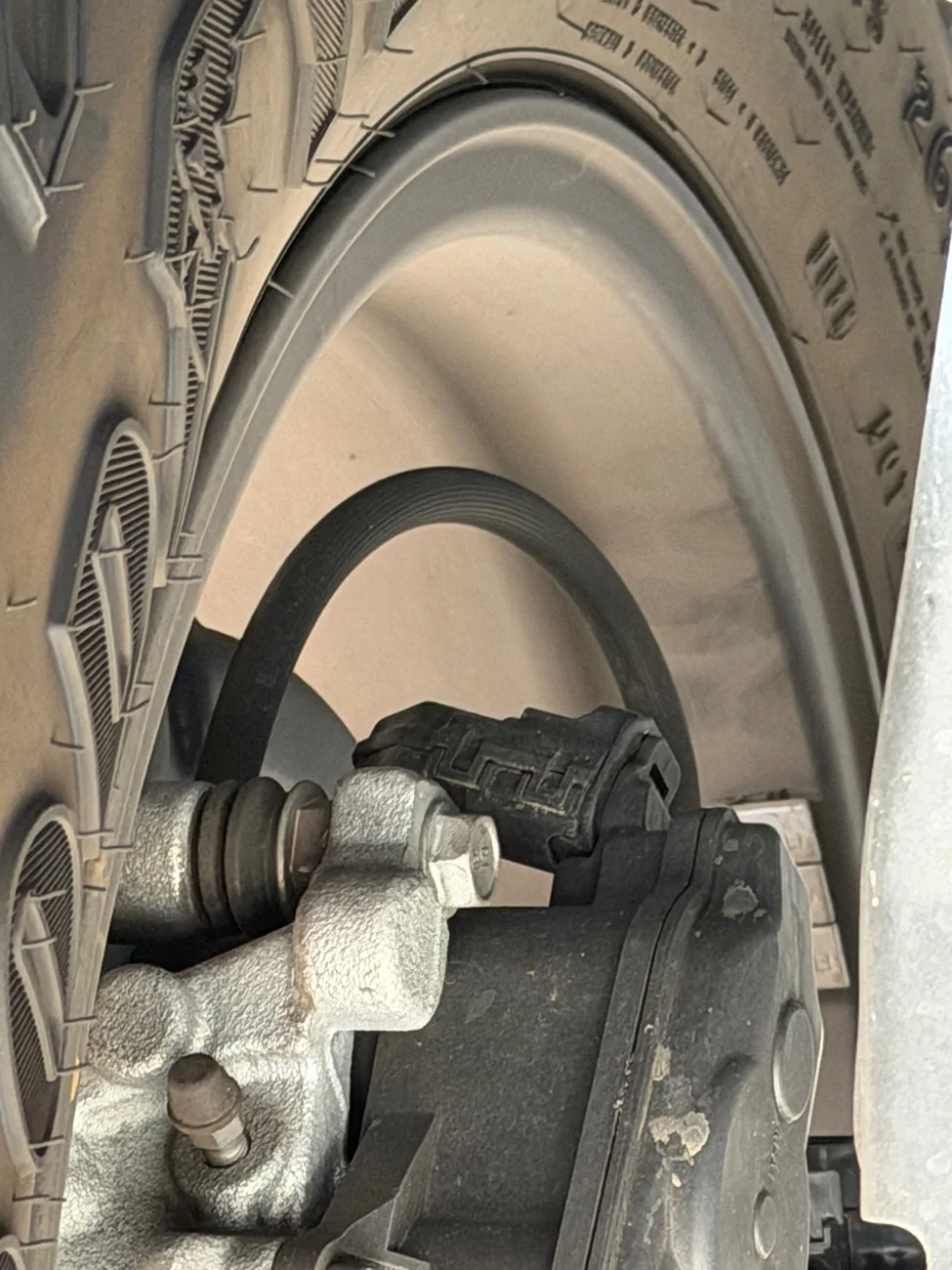

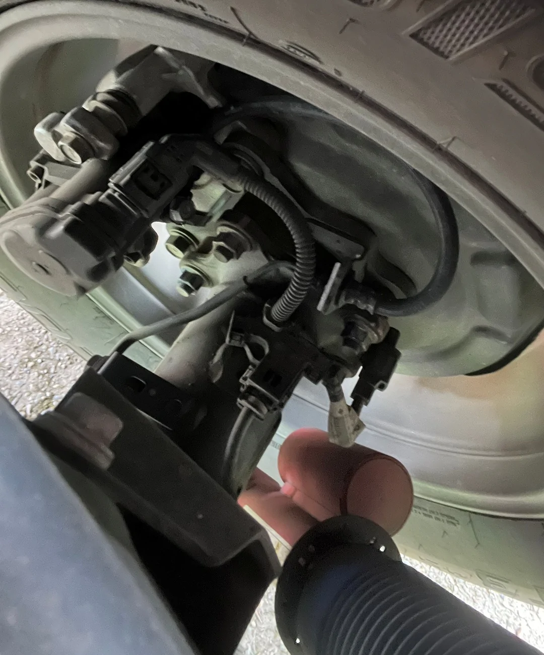

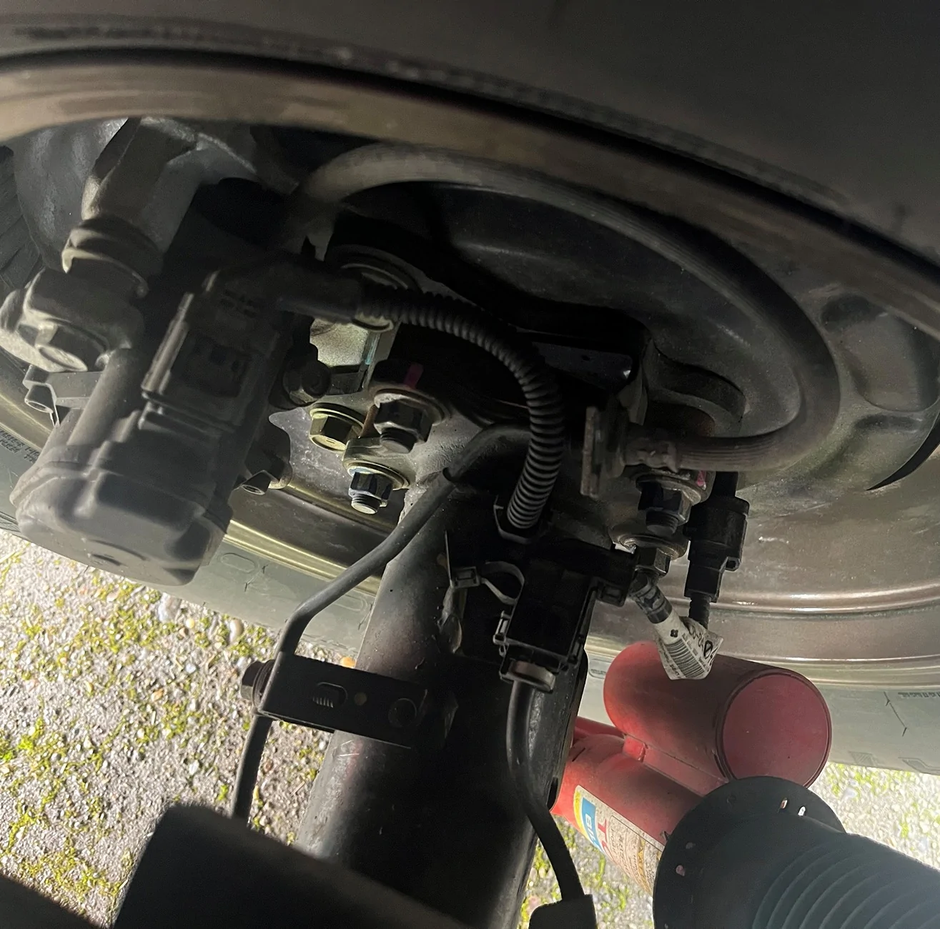

This is my truck vs my friend’s 2025. Both trucks are on 18’s.
2024 Tacoma Before and After - Brake Line Recall IMG_5784
2024 Tacoma Before and After - Brake Line Recall IMG_5782
2024 Tacoma Before and After - Brake Line Recall IMG_5783
2024 Tacoma Before and After - Brake Line Recall IMG_5781

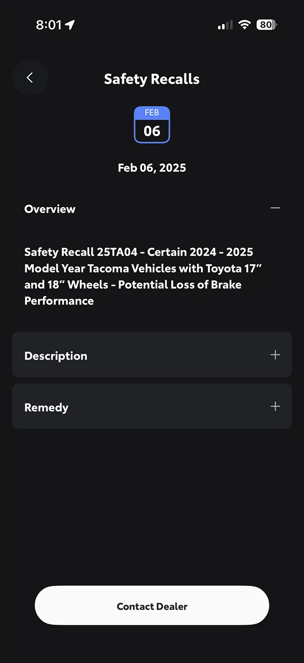

I believe the recall applied to trucks with 17 inch rims (not 100% confident on that though). So if my truck came with 18's....and never got a recall notice...but I put 17's on...do I need to modify the rear brake hoses??

FYI - I have a '24 SR5 with 18", I got the notice for the recall.

Wow, I never got a recall on my truck with 18" wheels either, so I consider myself lucky.

I would think the replacement one would be shorter, not longer since that is the problem. My local shop had a bunch of them to do so the shop foreman had one guy do them, and he was able to get a set done in like 20min.
Fun fact, my local dealership shop foreman is the one that caused that recall. One of the first 2024's sold here in Anchorage had driven to Deadhorse with it in the winter and by the time he returned he lost brakes rear brakes because of all the mud and ice and slush that had built up inside the wheel had rubbed holes in the hoses.
