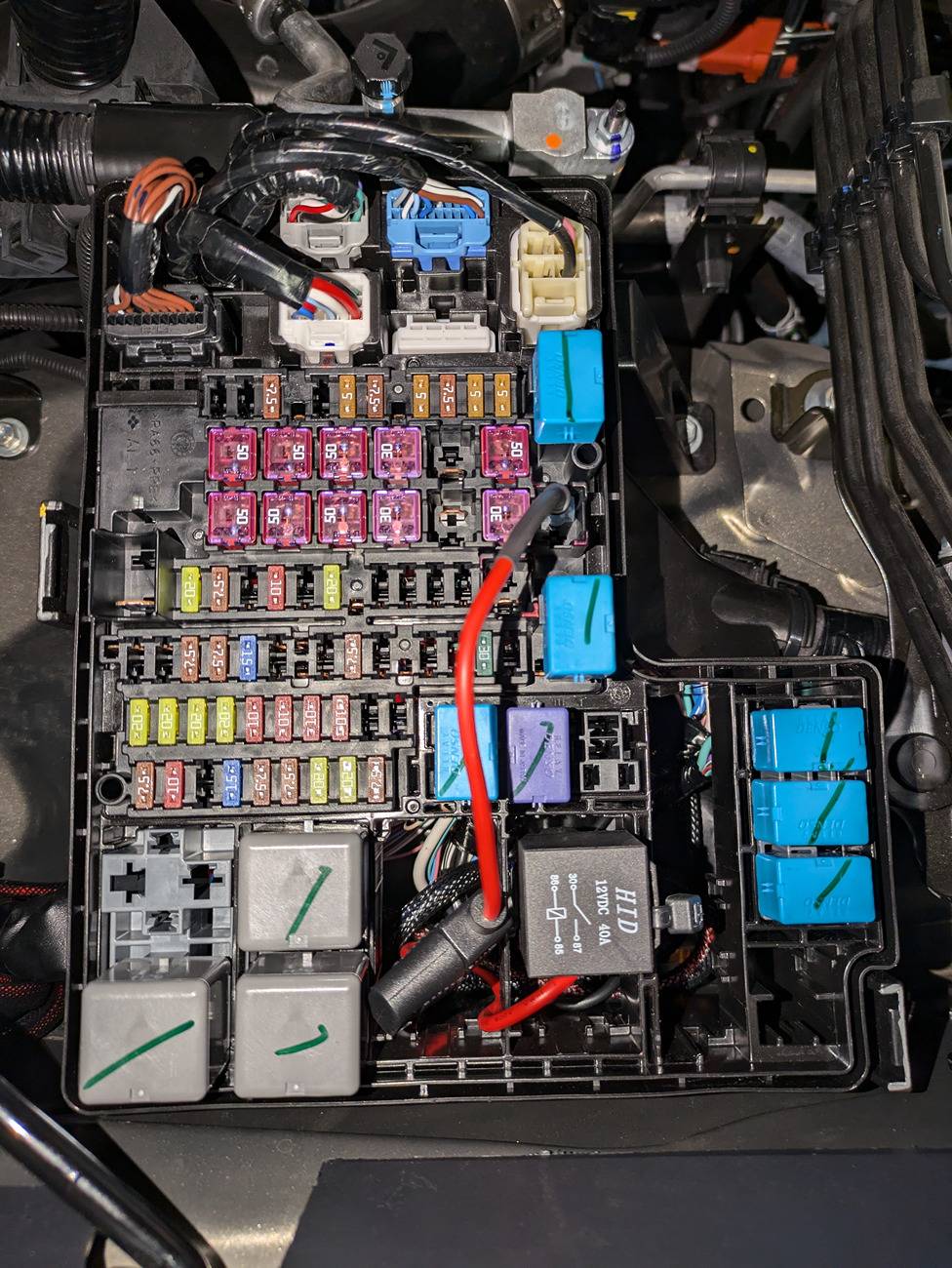

unused spades are not fused. You need to add the requisite inline fuse or sub-fuse box. It's simply an extension of the battery hot.
Here's my setup running to an in-line fuse, then onward to the switching relay.
I'm assuming that red wire is connected to the spade terminal?
Correct. Red wire ends with an insulated 14-16g female spade terminal that is then heat-shrunk on it's crimp fitting for safety. It's pressed down onto what was an empty male spade within the F&R center. The fit is snug enough you're using pliers to pull it loose. That wire then runs to an inline fuse, then to the relay you see zipped. from the relay, branch one runs out and through firewall to dash switch, while branch two runs out and over to the grille.
If you're interested in a bunch of photos on that journey, I have them here. You just have to scroll for the notes and pictures on wiring. I ended up taking the effort to pop the upper/lower fuse box layers apart enough to feed my wires out the OEM channels.
https://www.tacoma4g.com/forum/thre...ht-bar-on-a-vehicle-without-factory-aux.8252/
