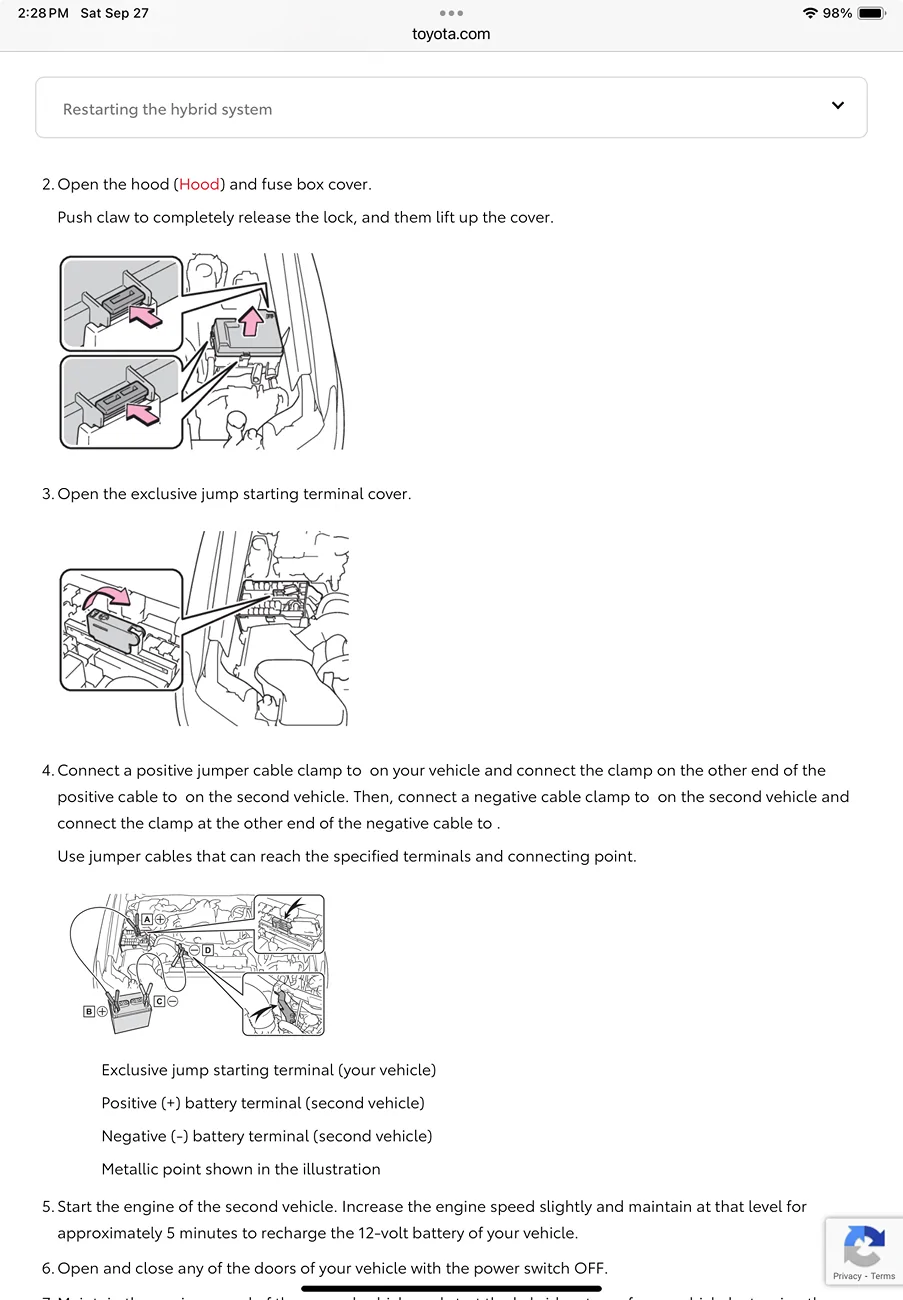

Hey guys,
One of the biggest questions I keep hearing is: “How in the world do you jumpstart a Tacoma Hybrid?” The 12V battery is hidden under the rear driver’s seat — not exactly easy to access when you’re stuck.
I just dropped a video showing the fast and safe way to jumpstart any 2024–2025 Tacoma Hybrid trim (SR, SR5, TRD Sport, TRD Off-Road, Limited, TRD Pro, and Trailhunter). Instead of tearing up the seats, you can use the dedicated jump-start terminal under the hood.
👉 Watch the step-by-step guide here:
What’s covered:
  • Tacoma Hybrid battery location (and why it’s tricky)
  • Where Toyota gives you the jump terminal under the hood
  • Exact steps for jumper cables or a jump pack
  • Tips to keep from frying electronics or wasting time
If you’re a new 4th Gen owner (especially Hybrid), this is something you’ll want to know before you end up with a dead truck in the driveway.
Curious to hear if anyone’s already had to do this in the wild — especially with the Trailhunter guys who are taking these things off-grid.

After a jump start, will ECU or other electronics need attention?
I had to jump start today. And am getting lots of errors since? See video.
I think I drained 12v battery sitting in truck listening to radio.
Used a portable jump battery to jump at the fuse box location.

It likely just needs errors codes cleared unless you bumped something jumping starting it from the relay under the hood.
Someone correct me if I'm wrong since i don't have my manual on me, but you're supposed to leave the truck in "ready" mode if you plan on running battery power or use the plugs for any extended period? The truck auto shuts off the ICE due to being still, and will restart itself it if needs to charge either the 12v system or hybrid system.
