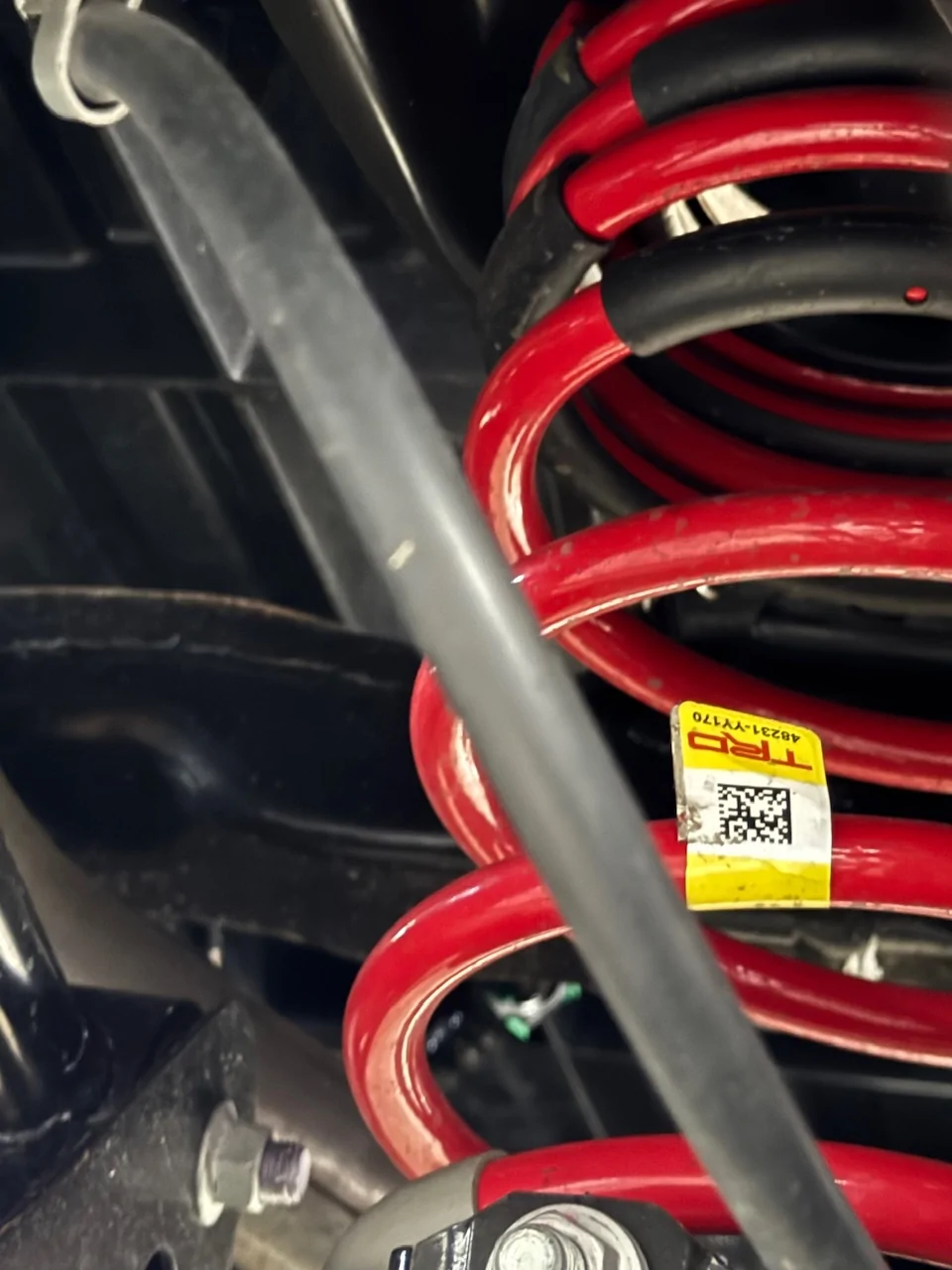

I bought mine with the factory lift, it looks and feels great, no weird noises or vibration issues, it performs perfectly on trails and streets, it might be on the stiff side of the spectrum compared to the Trailhunter, but I think it’s awesome
Are you talking about the TRD Lift? I'm curious what the part number is if that's the case. I haven't been able to find it.

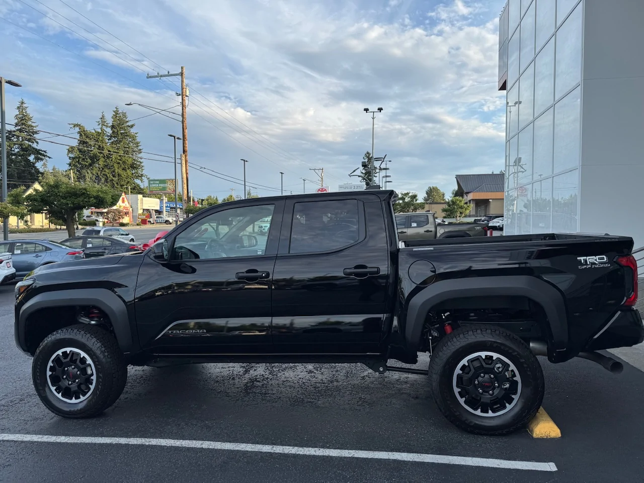

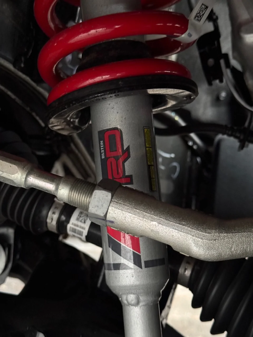

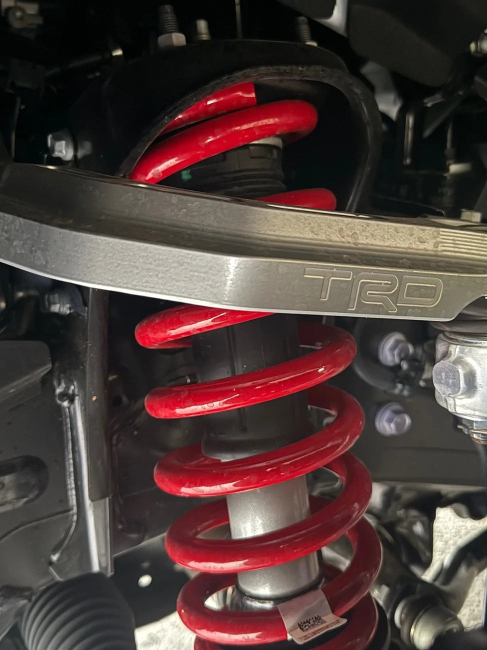

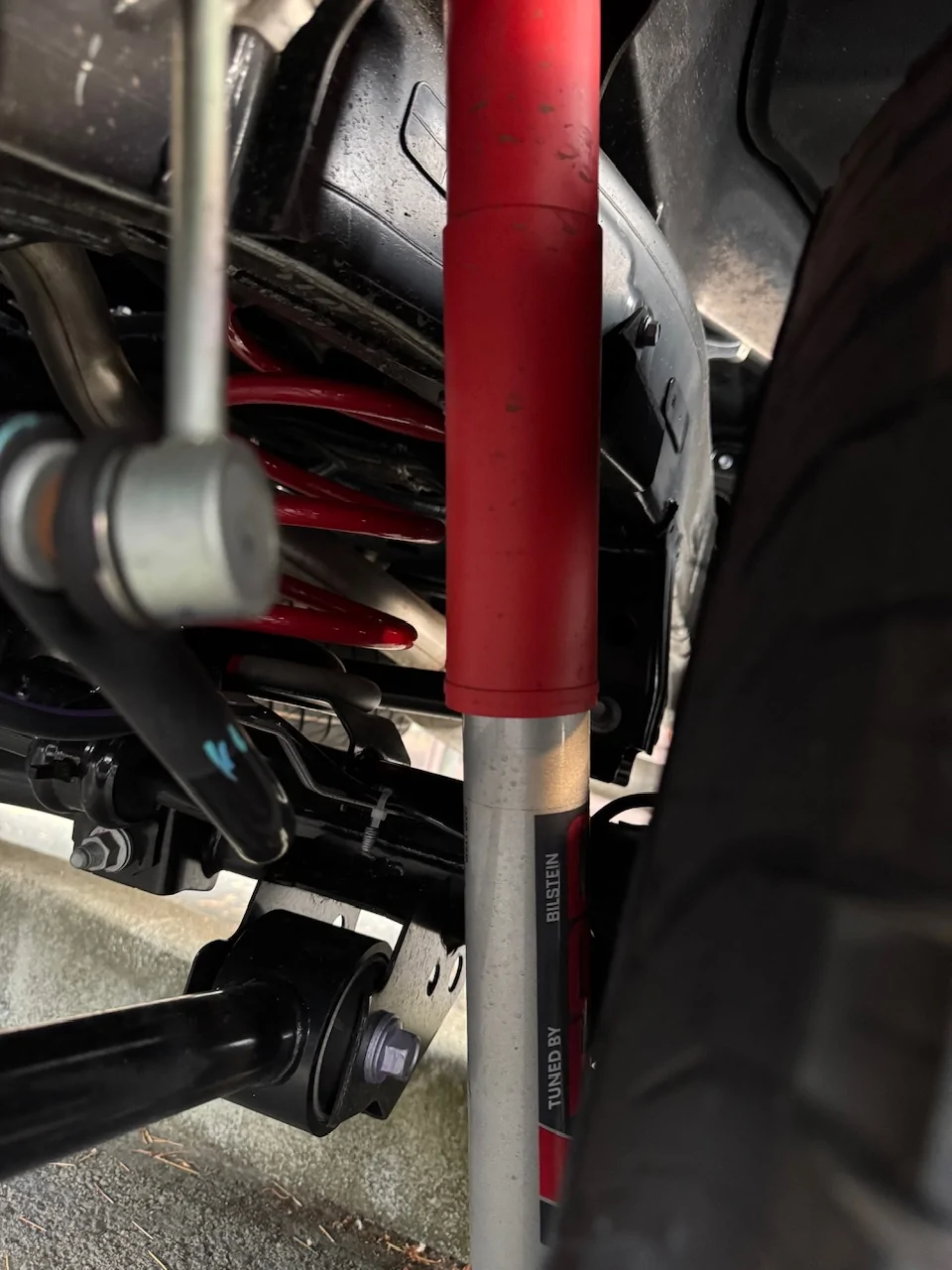

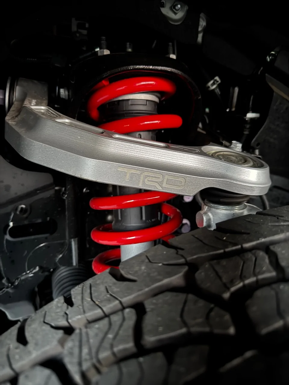

It is listed as: “Suspension Kit +2.5" lift” on the optional equipment list on the window sticker on my truck.
The new Tacoma TRD Lift Kit offers a 3" lift in the front and a 2" lift in the back, providing 2.6” of additional ground clearance overall.
  • Increased suspension stroke to support lift and aid in off-road performance & on-road stability
  • Toyota Safety Sense 2.5 compliant
  • Bilstein-Tuned Front & Rear Shock Absorbers
  • Forged Steel Upper Control Arms by Roush
  • Eye Catching TRD Red Front Coil Springs

You have any pics? I'd love to see how it looks installed!

I have 285/70/r17 terra grappler G2s and they look great stock. You can definitely go bigger with the lift. Thanks for the pics. Now I want these!

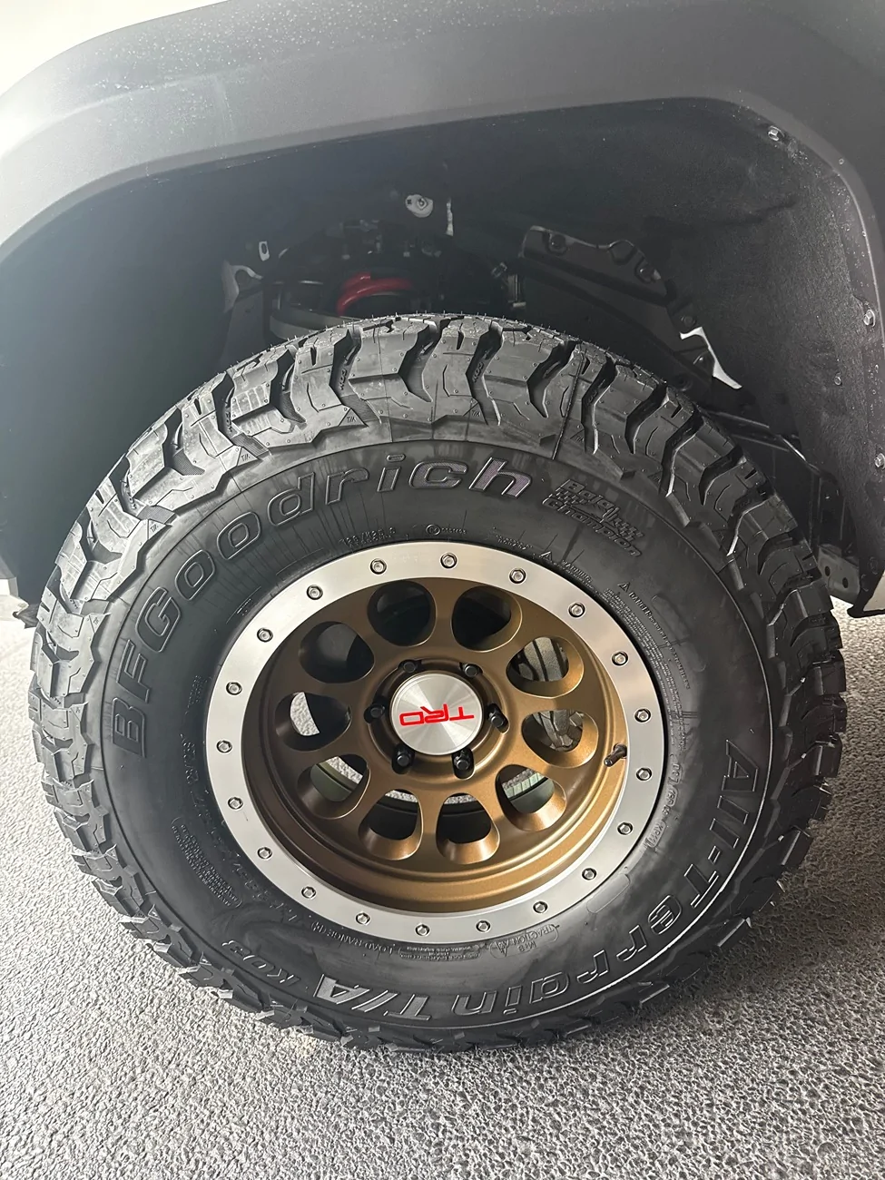

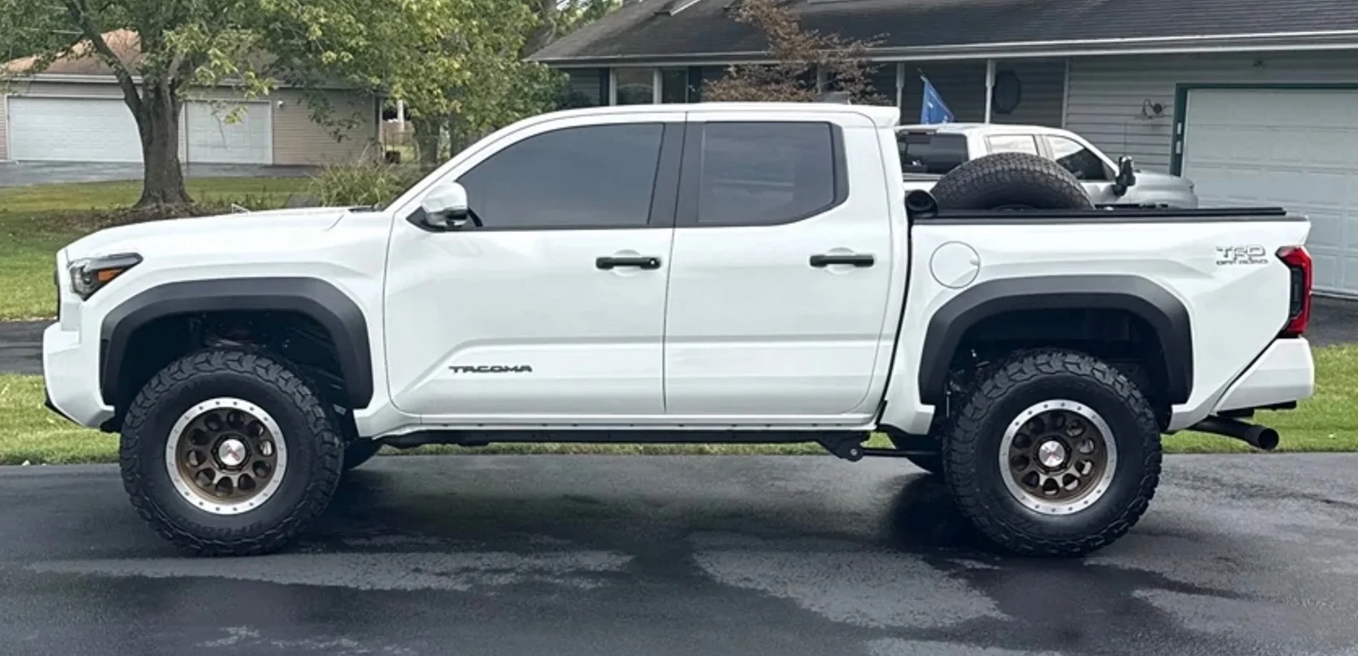

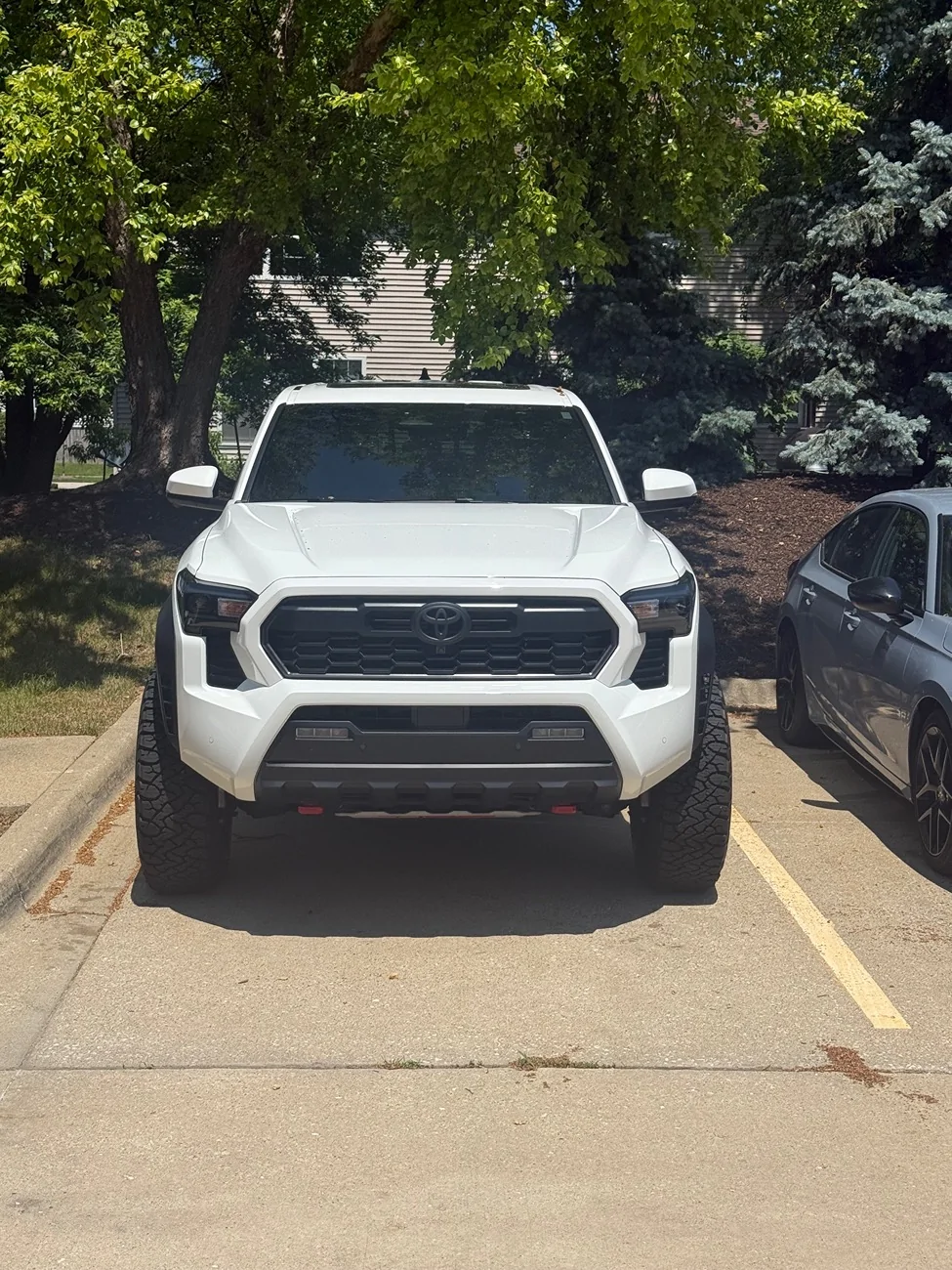

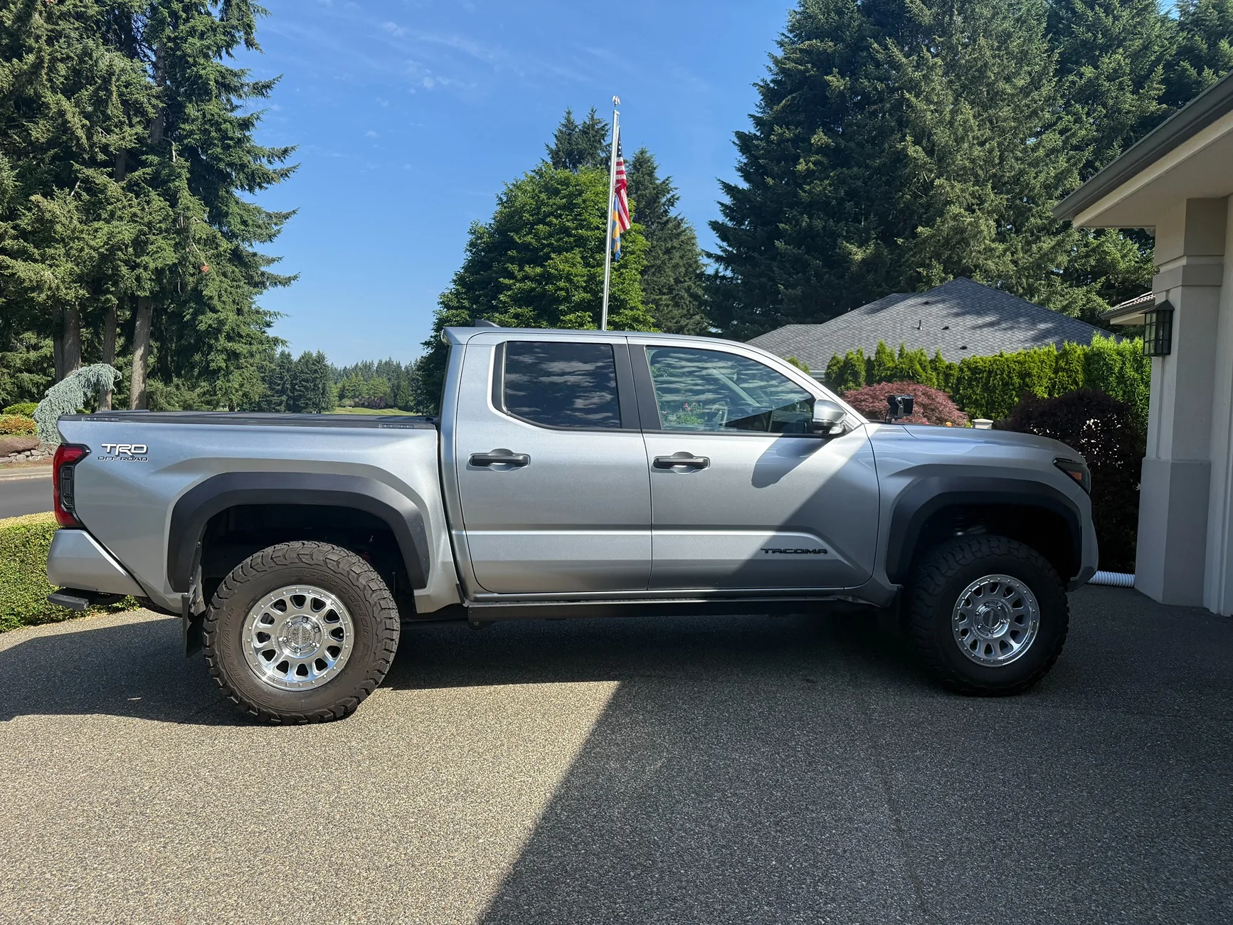

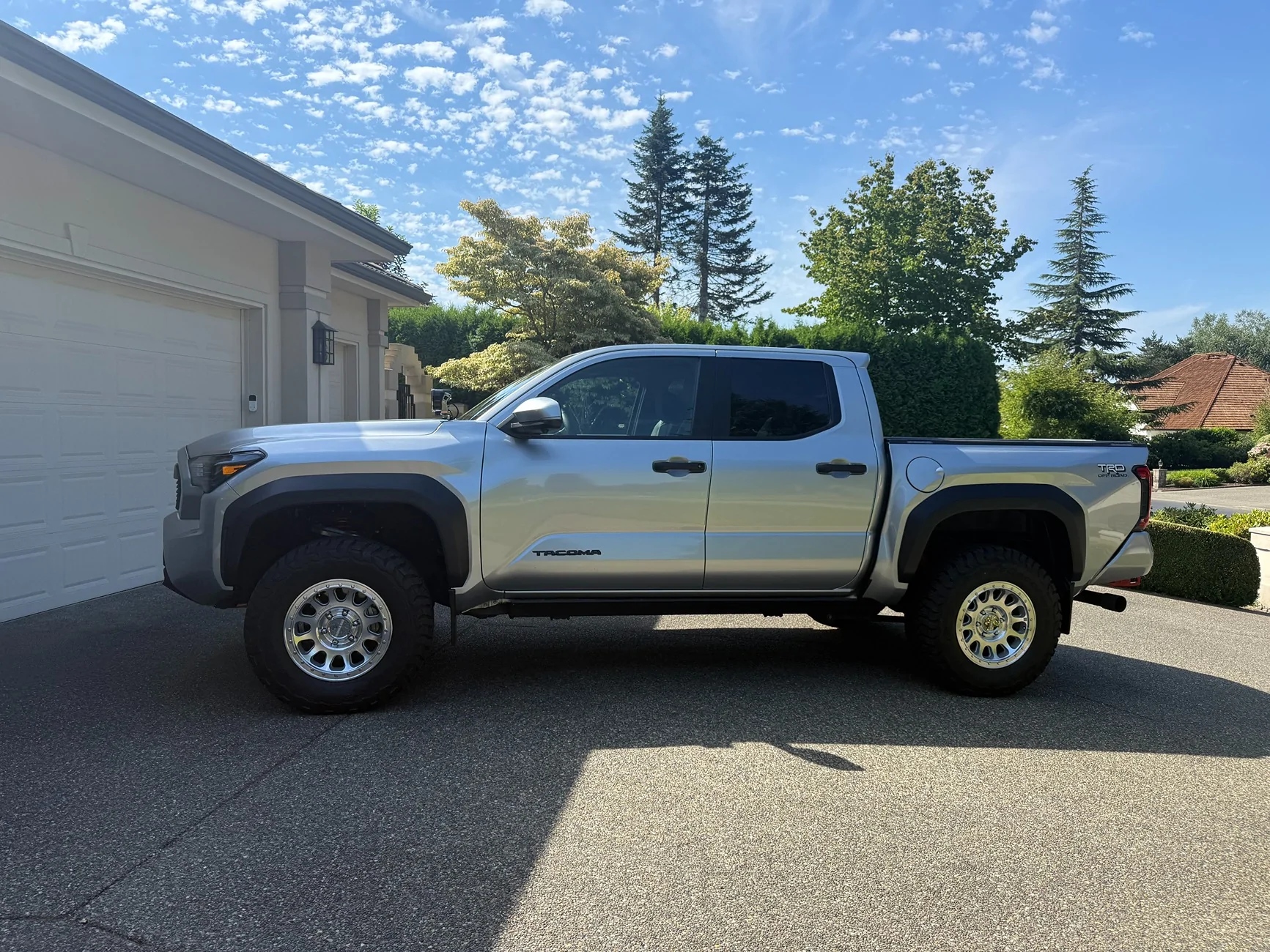

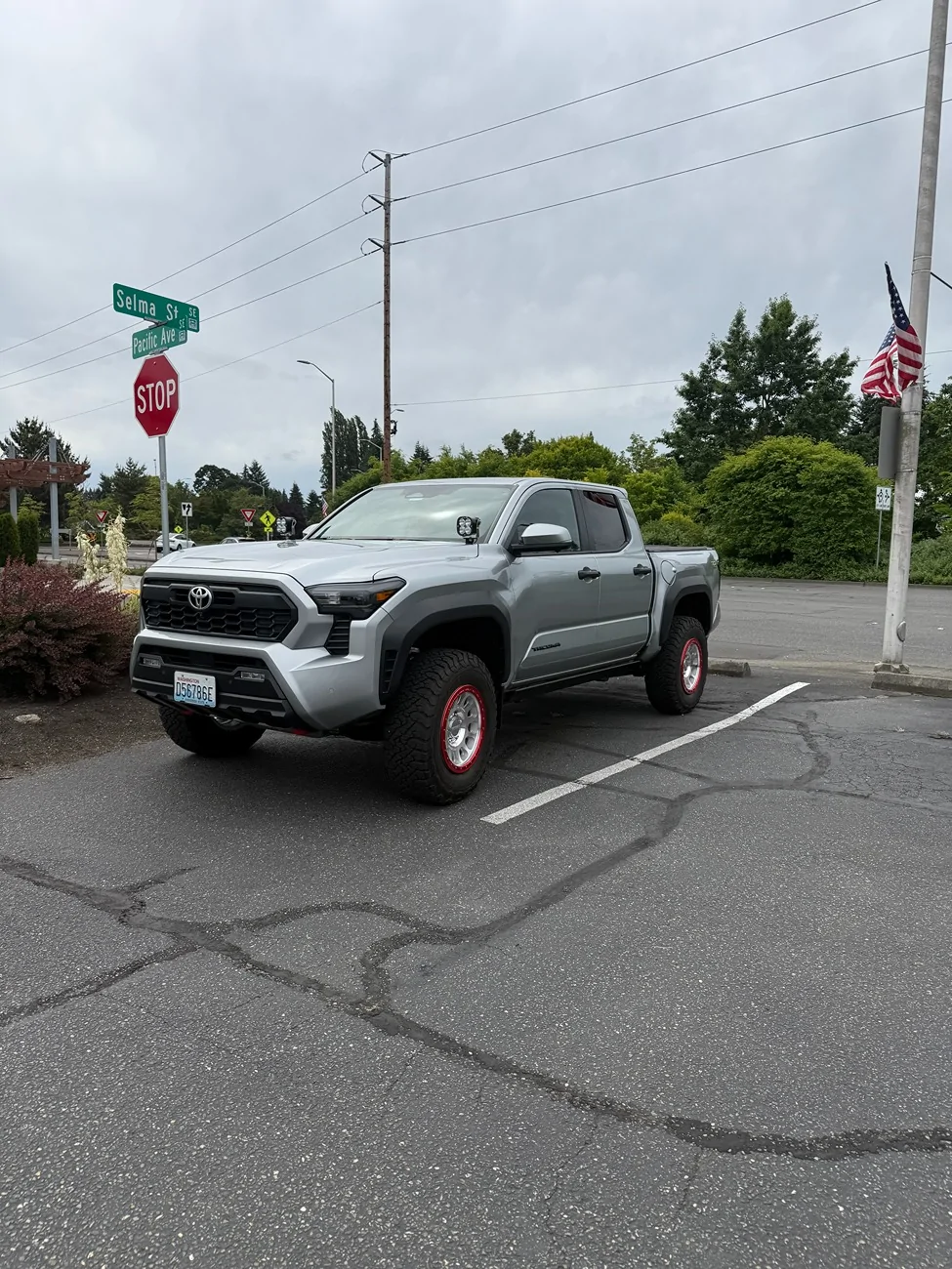

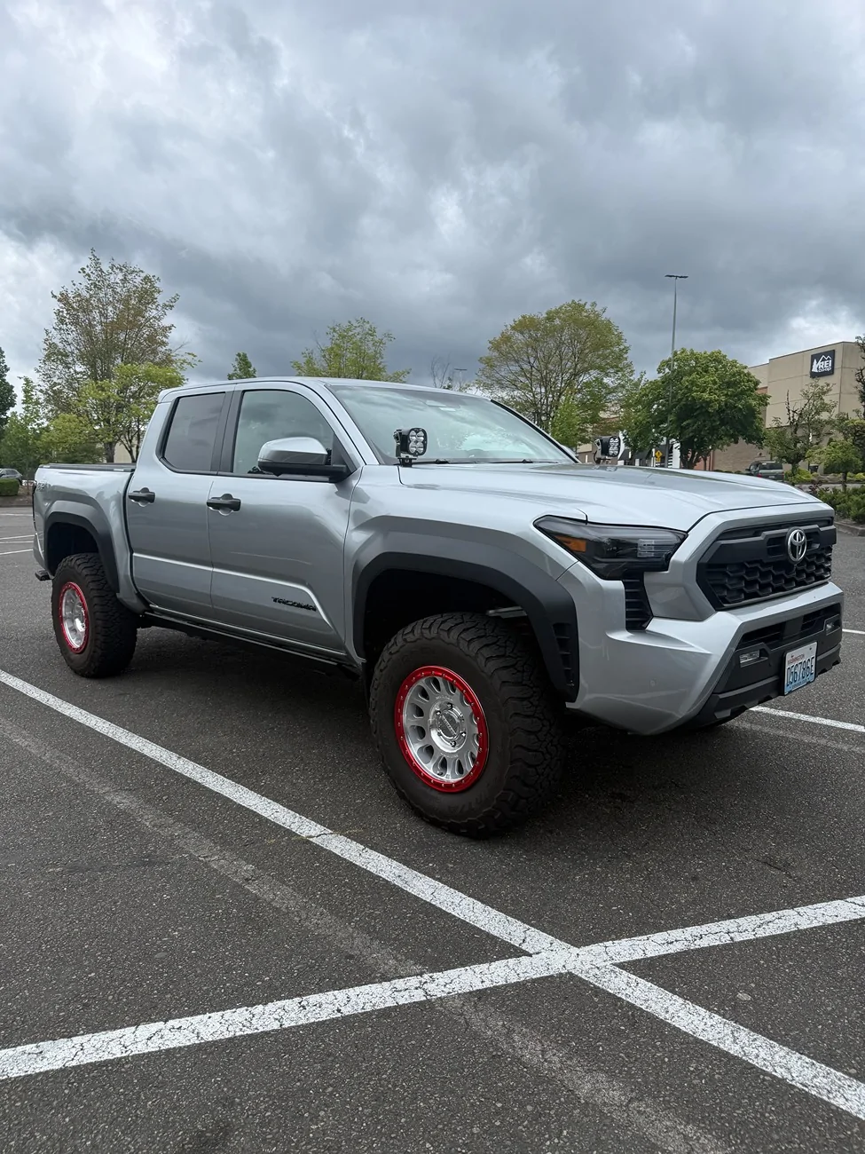

I also have the TRD lift on my 25 Off-road. I have 285/75/17 KO3’s on SCS wheels. I love it. I did had to trim a very minor amount of plastic due to my offset but it was no big deal at all.

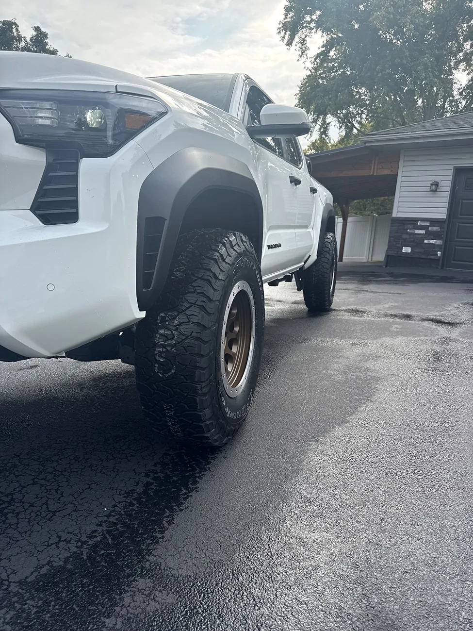

What offset are the wheels? Do you have any better pictures of the tire poke?

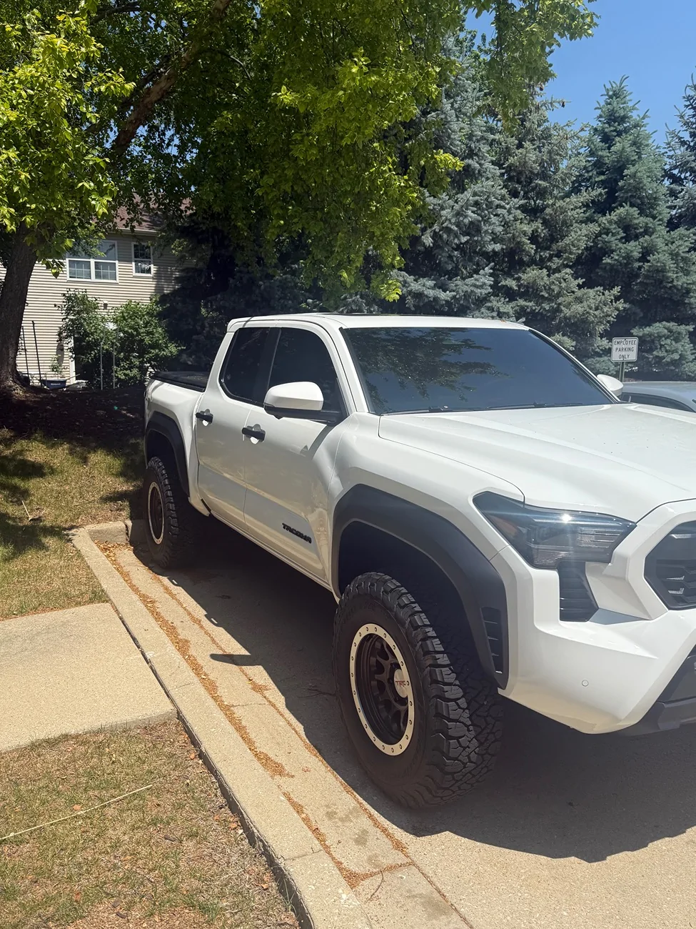

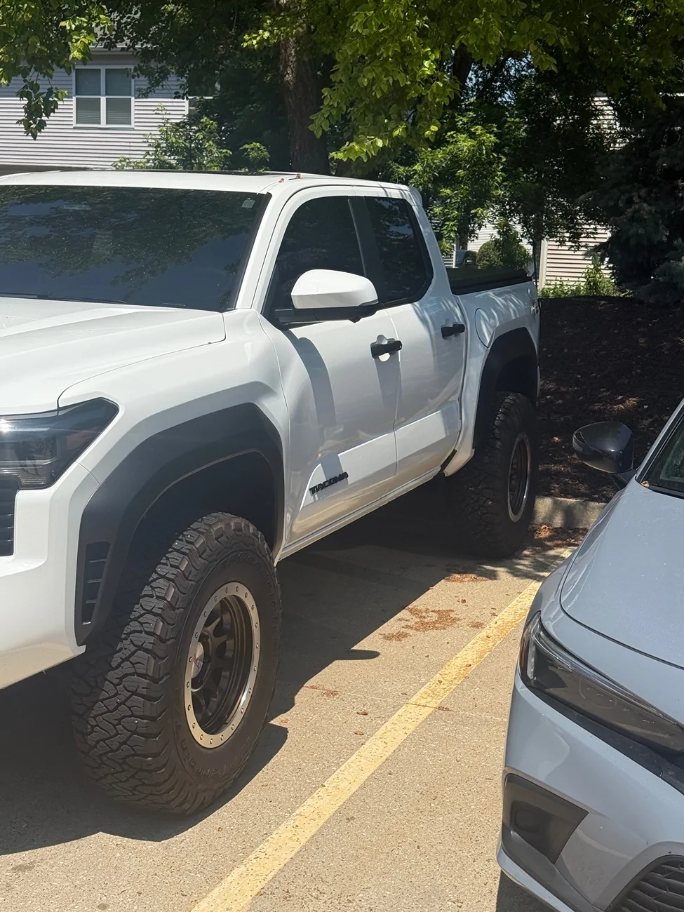

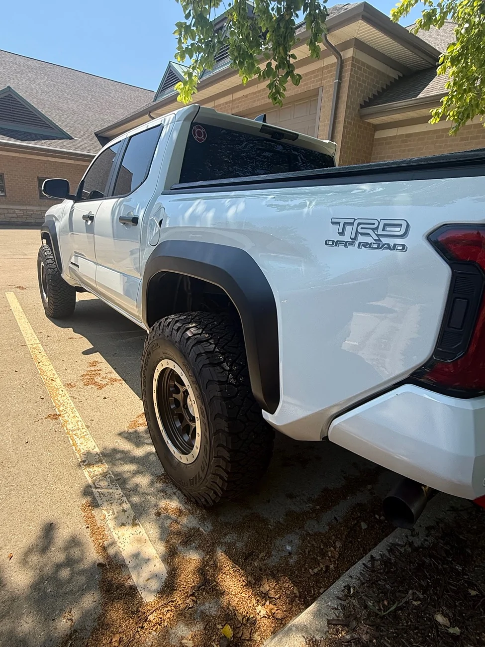

They are SCS Ray-10 wheels. -10 offset. They are technically the 2nd and 3rd gen spec. They fit the 4th gens with hub adaptors from the 95.1 to 106.1 size I believe. I had to trim a little plastic and liner but it was very very minor. EDIT….I had to trim because i am running 285/75 tires. If i ran 70’s, i most likely wouldn’t have had to trim.

@tkrum015 If you like these wheels. They make them in a more modest offset with a little less poke for the 4th gens. + 20 i believe. I know they still poke a little but not as much as mine do.

Truck looks great! Just installed Ray 10 in +20 offset on 285/70/17 Falkens and have the TRD suspension lift on order.
Did you have the lift installed by the dealer? If so, did they have to adjust your Safety Sense sensors?
Also, what dial setting did you adjust your headlights to?

My truck came with the lift installed. It was done at the factory. I strongly believe no ECU settings have to be messed with when adjusting 3” and under. Anything more than that, I cannot answer. As far as the headlights go. I just adjusted them at night (my first night time drive with the set up on) and picked a setting having them angle down a little. I can see where exactly they are at next time im in my truck if ya want.
