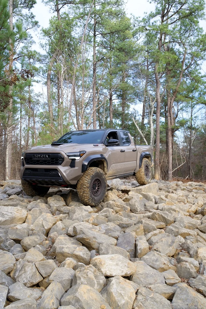

Just proper offset & maybe some slight trimming & you’ll fit 35’s easily. Be sure to remove the little bracket with the 3 17mm (I think? it’s been awhile). This was my truck on 37’s stock.
