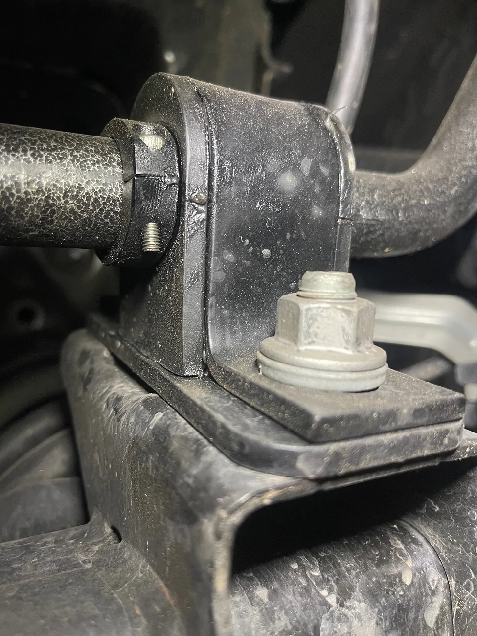

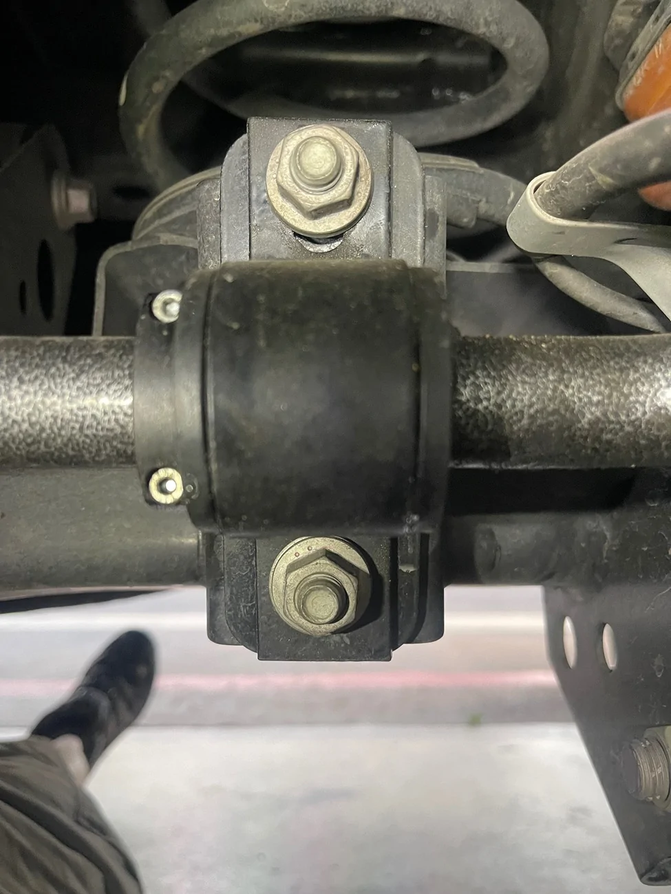

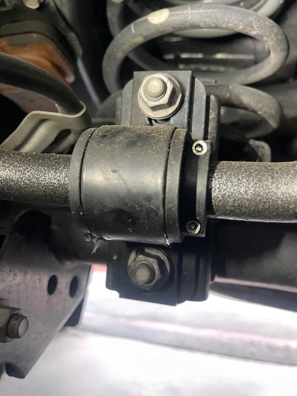

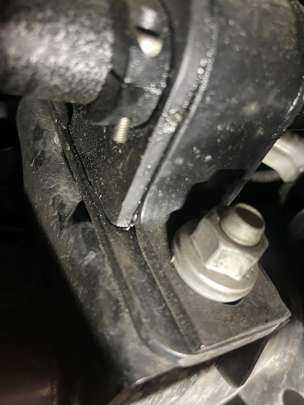

I torqued mine to 27 ft lbs as stated, I truly torqued everything....
Not the best pics but theres no marks on the U plates showing indication / witness marks that theres movement...
The studs are stationary so if the plates have been shifting since March, I think I would see some halos.....

I didnt get a good side profile look, but from my pics im not seeing much thread left at the end of the studs which would equate to the washers being a good idea....
