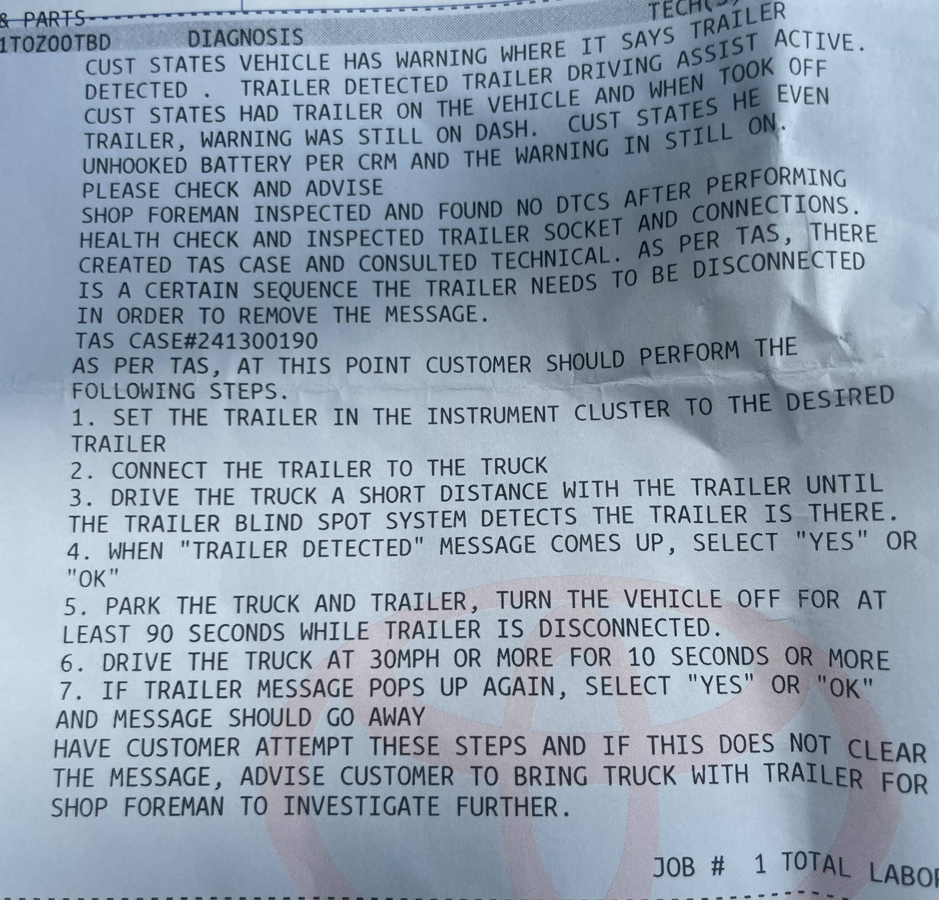

BFDJG
Apr 18, 2024
Chicago
2024 Tacoma TRD OR
Toyota finally responded and said the trailer had to be reattached to get computer to reset. I tried it but didn’t work. What did work was driving forward and backward with trailer attached until truck asked if trailer was attached. I chose “no” and the system turned off the trailer detection. Then turned off rear parking sensor so I could back the trailer up. Shouldn’t have to trick the system. Hope they fix the glitch for real.
