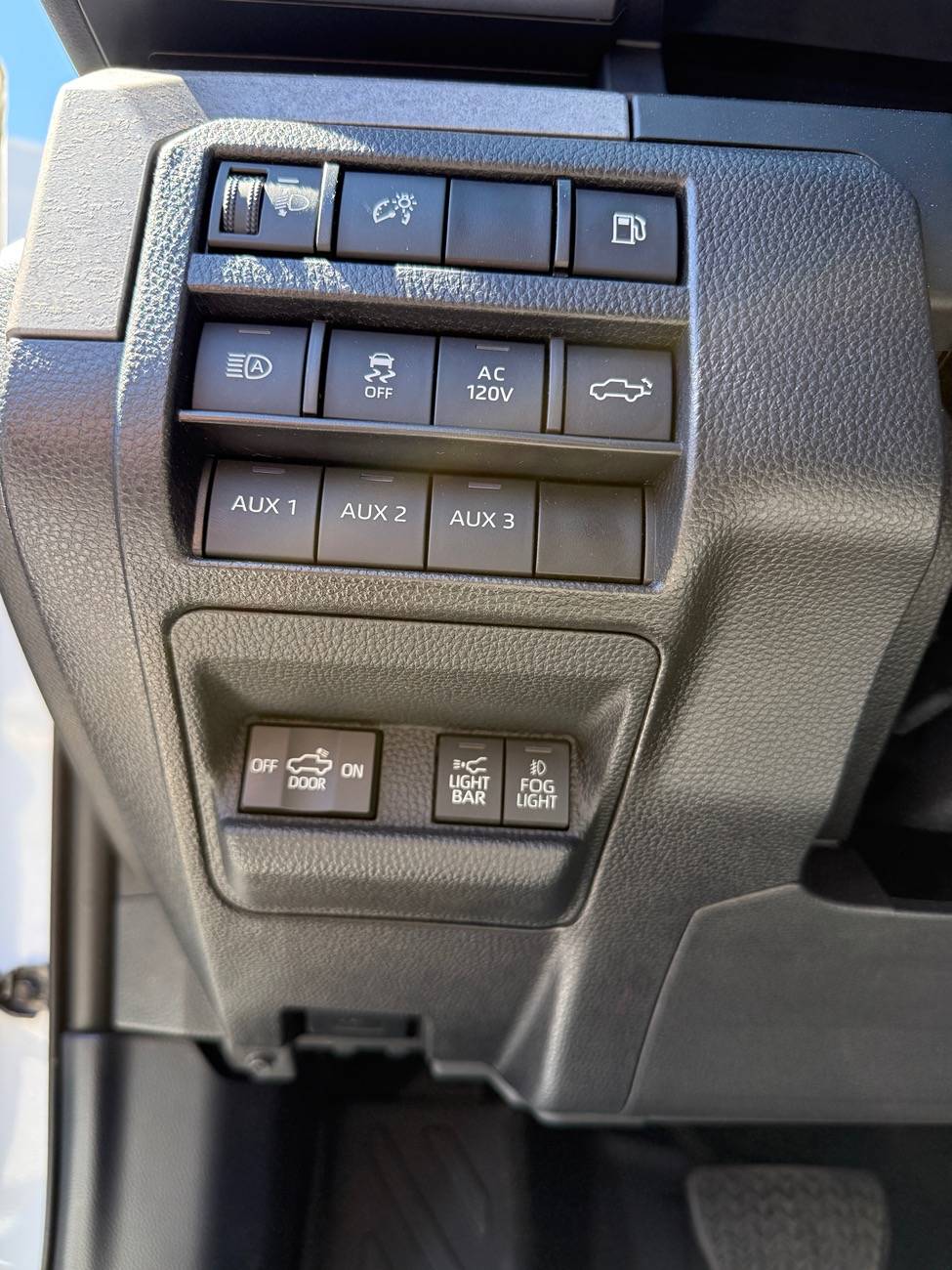

Greetings I just joined the forum last night, as I found out from one of my wiring harness dealers SPV about the forum; but to the question of the auxiliary switches: on my 2024 trail hunter, it only has 3 AUX Switches. See photo. The 2025 Trailhunter has four switches. The part number for Aux4 above is correct (Aux 4: 84484-AK040) as I called my local Toyota dealer this morning, and he said it is on back order and more than two weeks out for $129 including tax. I told him I don’t care how long it takes. I need a fourth switch as the Trail hunters are all wired the same way they just didn’t include the 4th switch on the 2024 model. There are four “ports“ on the vehicle, two under the hood, one in the driver, left foot side panel, and one on the frame in the rear. The plugs are all the same using Toyota supplied pigtails on higher level, trim packages. I am using plug and play adapters that I purchased from Specialty Performance manufacturing in Indianapolis.(SPV). Ask for John. And this is not a commercial for them. I just happened to buy some rigid ditch lights last night as I am staying with the rigid brand since the trail hunter has rigid fog lights, and grill light bar.

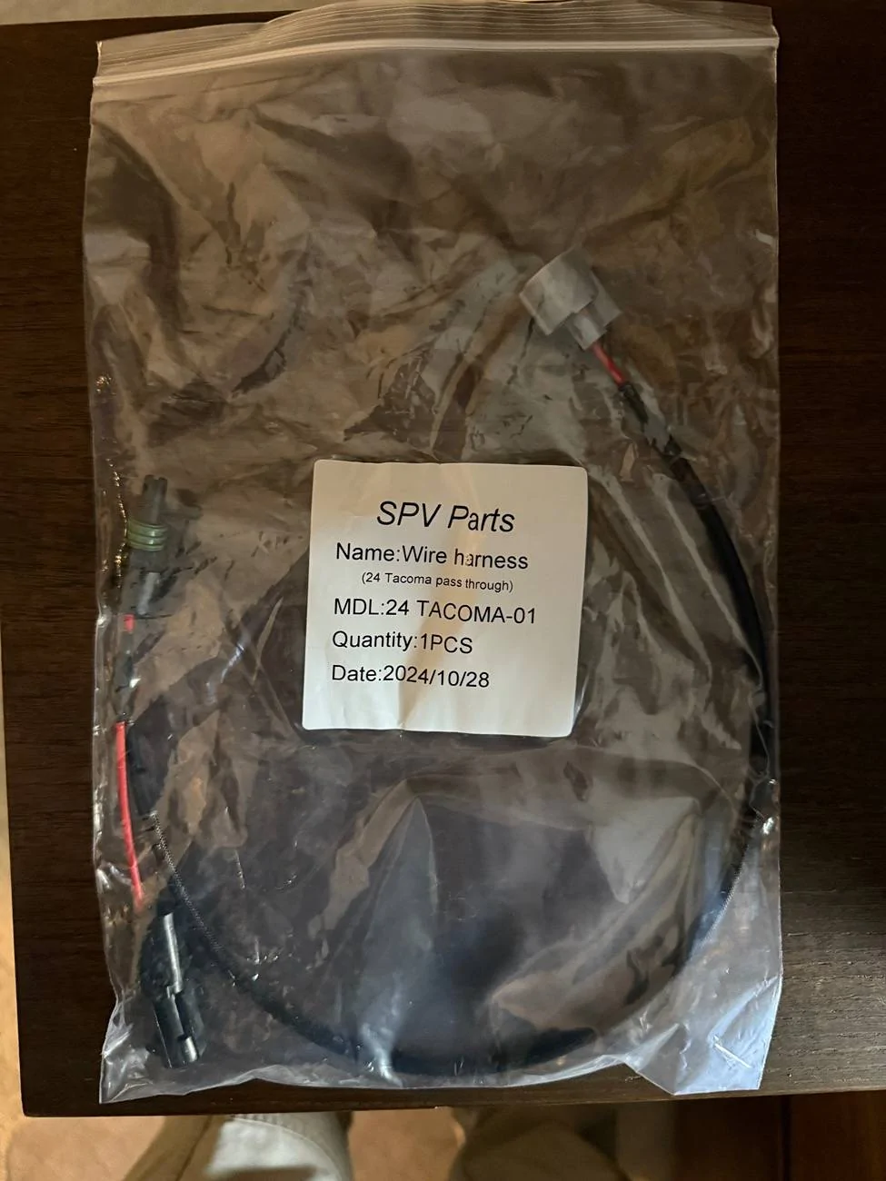

Which company had a wiring harness on their lights that was plug and play with the pre-wired Tacoma pigtails? Cali Raised LED says they can't make theirs plug and play and still requires some splicing, which doesn't make much sense to me. Did Toyota use some super proprietary connector or what?
Plug and play harness can be purchased from Specialty Performance Parts (SPV). They can give you connectors wiring harness and other stuff. Ask for John. I am not a paid endorser. I have bought 3 in the last two months

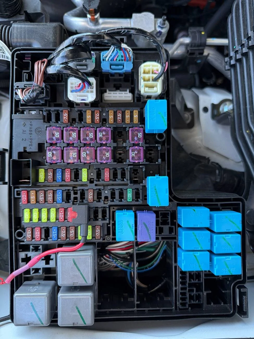

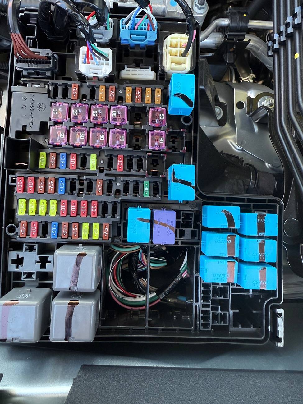

So I went to my dealer today and looked under the hood of the 2025 TH relay/fuse box on driver side and took a photo. 1st photo just below is the 2025, the bottom one is mine 2024. It looks the same as my 2024 TH relay/fuse box

There’s another fuse box on the passenger side engine bay, maybe it’s over there

We looked and there was AUX5, then AUX 4 H and L. I did not have that. Need to get more info. I installed my ditch lights and plugged in the DT connector from SPV into AUX3 which is the "C" plug in the engine compartment, and currently waiting on UPS to deliver the harness this afternoon. When I get it I will post
