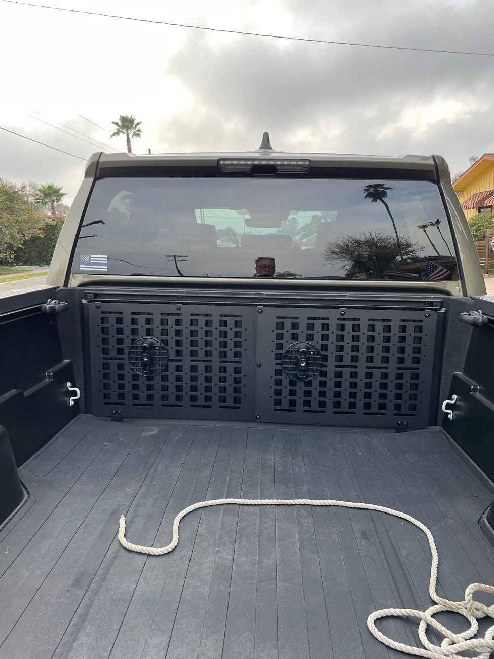

I decided to get some molle panel and mount it to the front section of the rear bed area.
I then purchased a plastic 30L fuel cell with a fill and vent fittings factory installed on one end.
I want to mount it horizontaly having the fill spout at the top and of course the vent closed completely on the bottom.

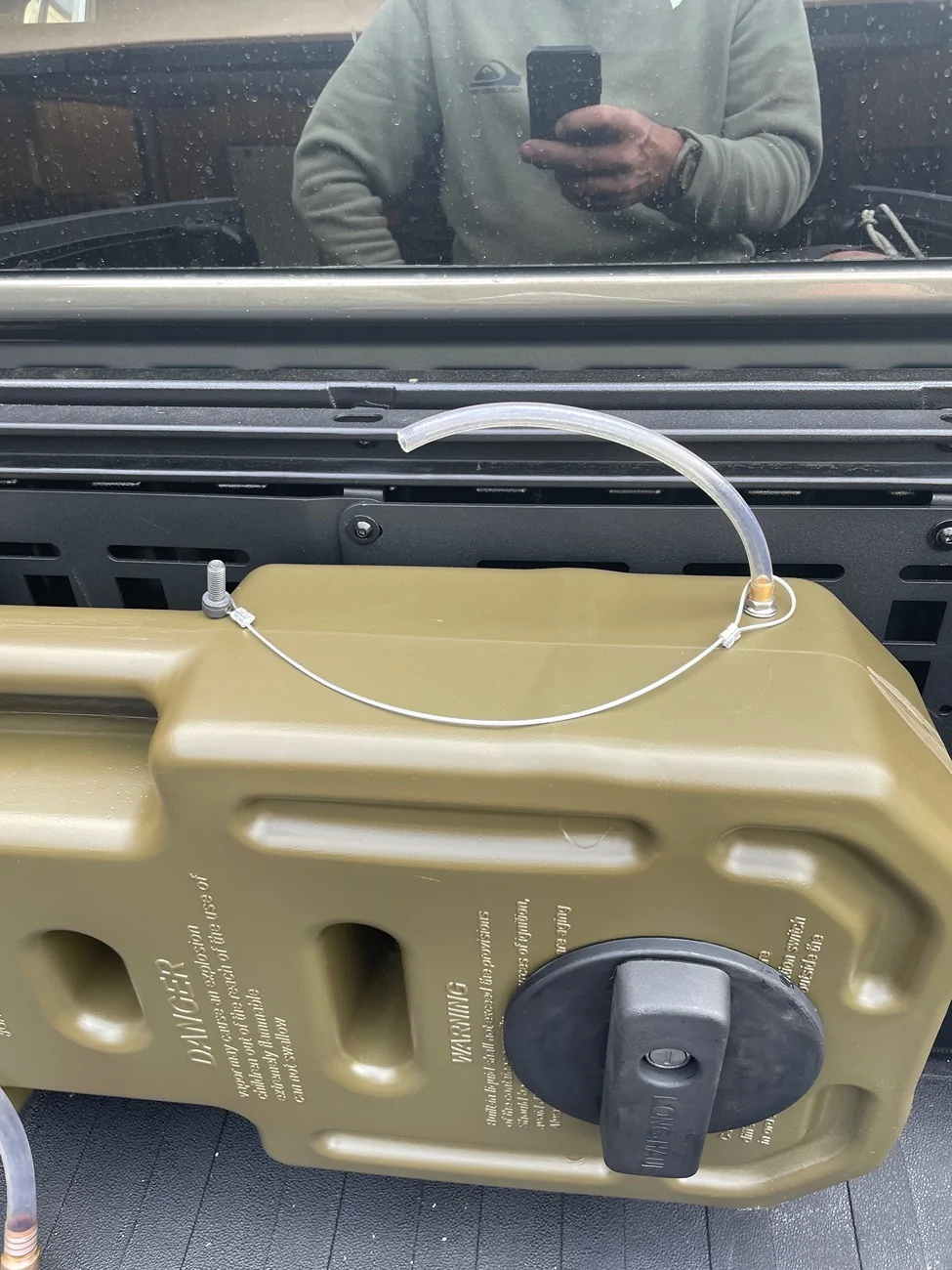

Here is a quick pic of the 30L fuel cell after I removed it from my truck.
2024 Tacoma Auxiliary fuel tank vent fitting? IMG_0047
Because I will be mounting the tank horizontally I can’t use the vent on the bottom under the fill area. So I am going to drill and mount a fitting along the top. As I am not planning to remove the tank and will use a syphon hose to transfer gas into my main tank when needed.
I will probably install a small piece of tubing on the fitting so I can leave it in the open position to vent all the time and not have to do it every day as the manufacturer recommends.
"All fuel cells have a vent".. please.......just look up rotoplex the primary supplier of fuel cells for offroad storage and 90% of them do NOT have a vent fitting.
Just got the fittings today and will post up a pic tomorrow of my install with the vent fitting installed.
Mine will be permanently mounted to the truck bed and will not be needed to be removable to fill my primary tank so maybe a different situation as far as filling/refueling for other situations.
Here is where it will be mounted.

Well I got the fitting I ordered and installed it into the "fuel cell" aka gas cans, fuel jugs, gas storage container.
So I transferred the fuel that was in the "cell" to my truck and then drilled a small hole and installed the fitting, pretty simple.
The fitting came with a cap but since I want it to vent constantly I stuck on a small length of tubing to allow it to equalize all the time and have a small bolt I can thread into the tubing if I want to remove the "cell" and no gas will spill out.

Not too bad. May want to consider sealing around it with some type of caulking that won't disintegrate with gas to ensure it doesn't leak around that.

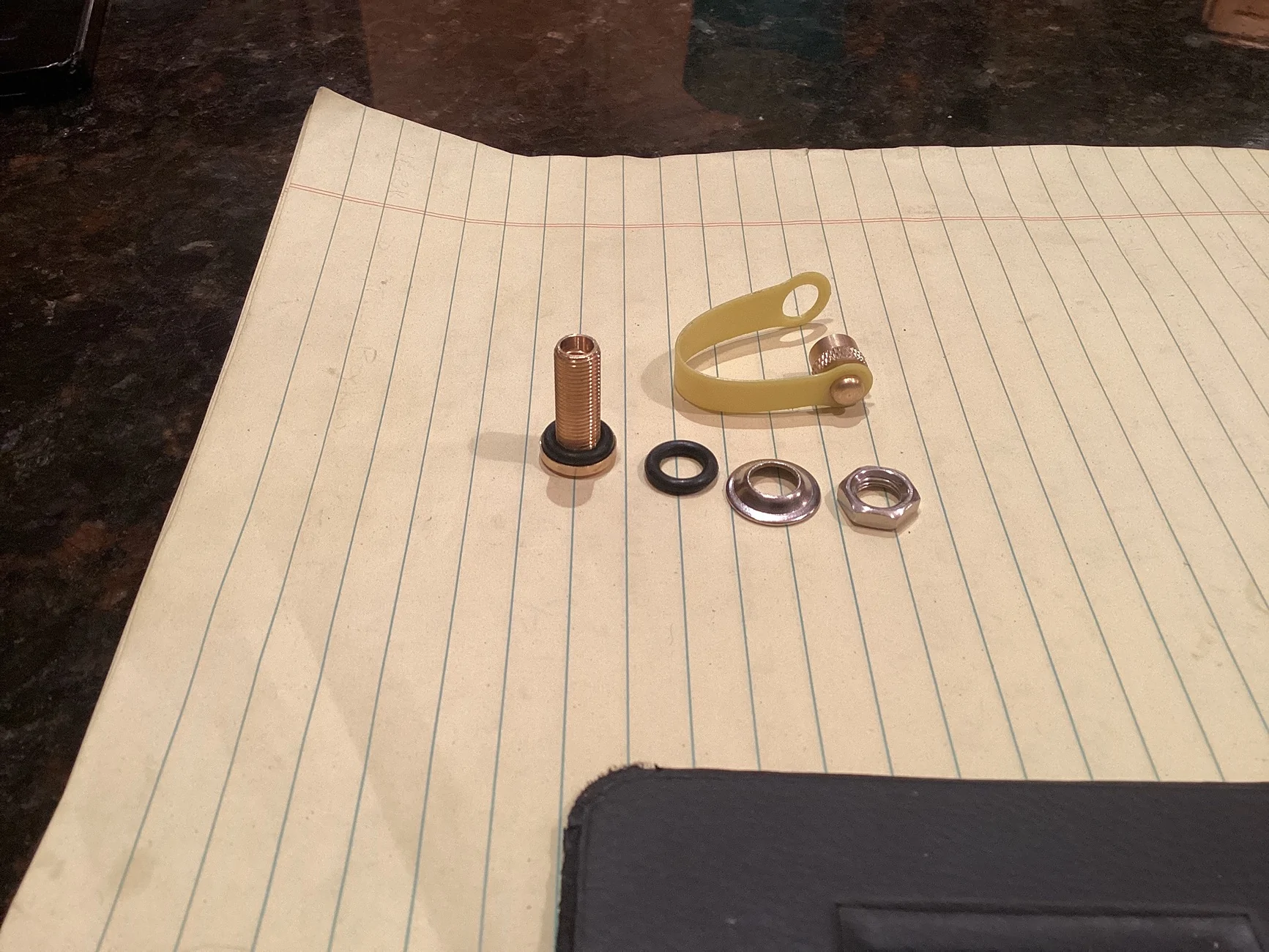

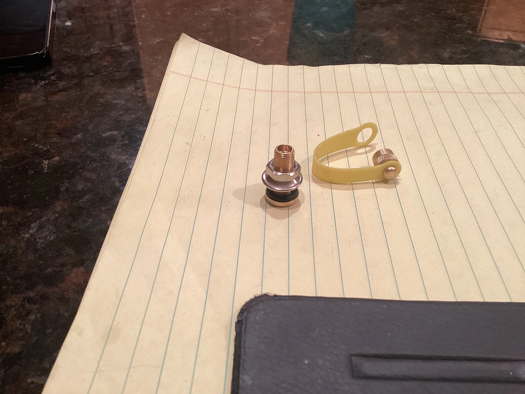

That Vent fitting has a rubber o-ring on the inside and the outside as well as a cup washer and then gets tightened down with the nut.
Supposedly the o-rings are compatable with being used for fuel.
