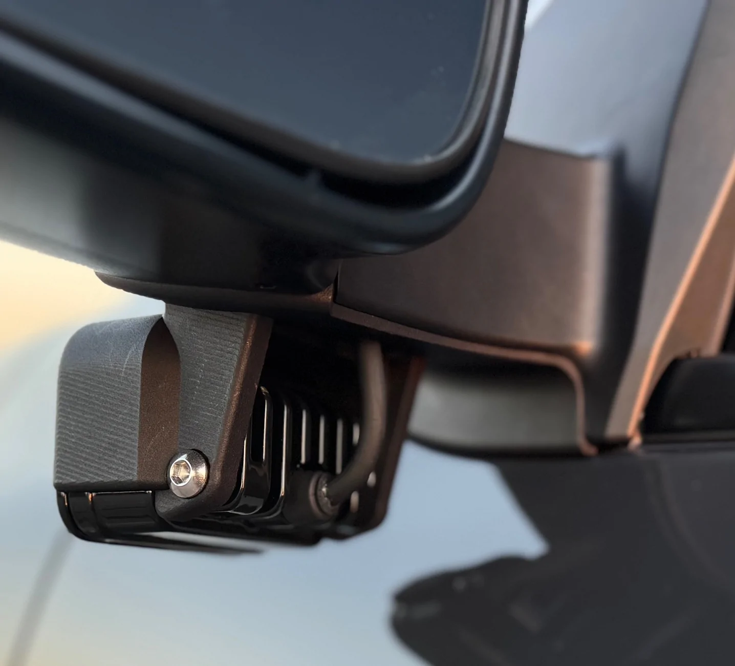

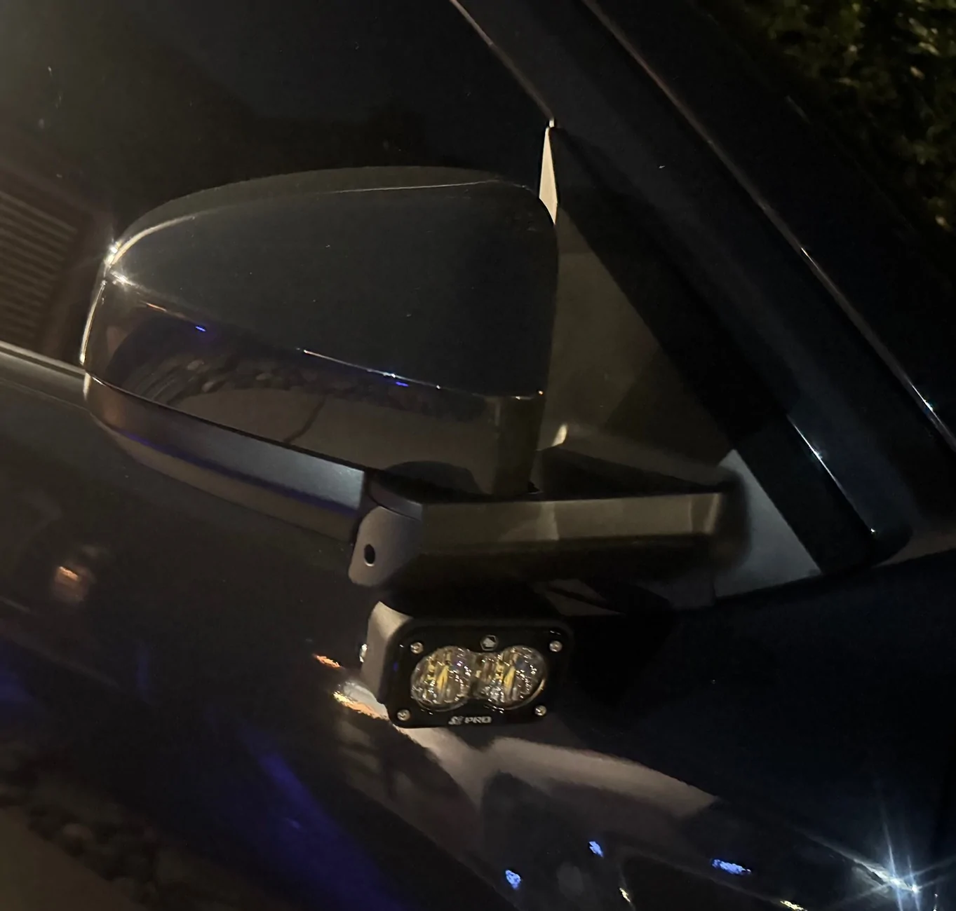

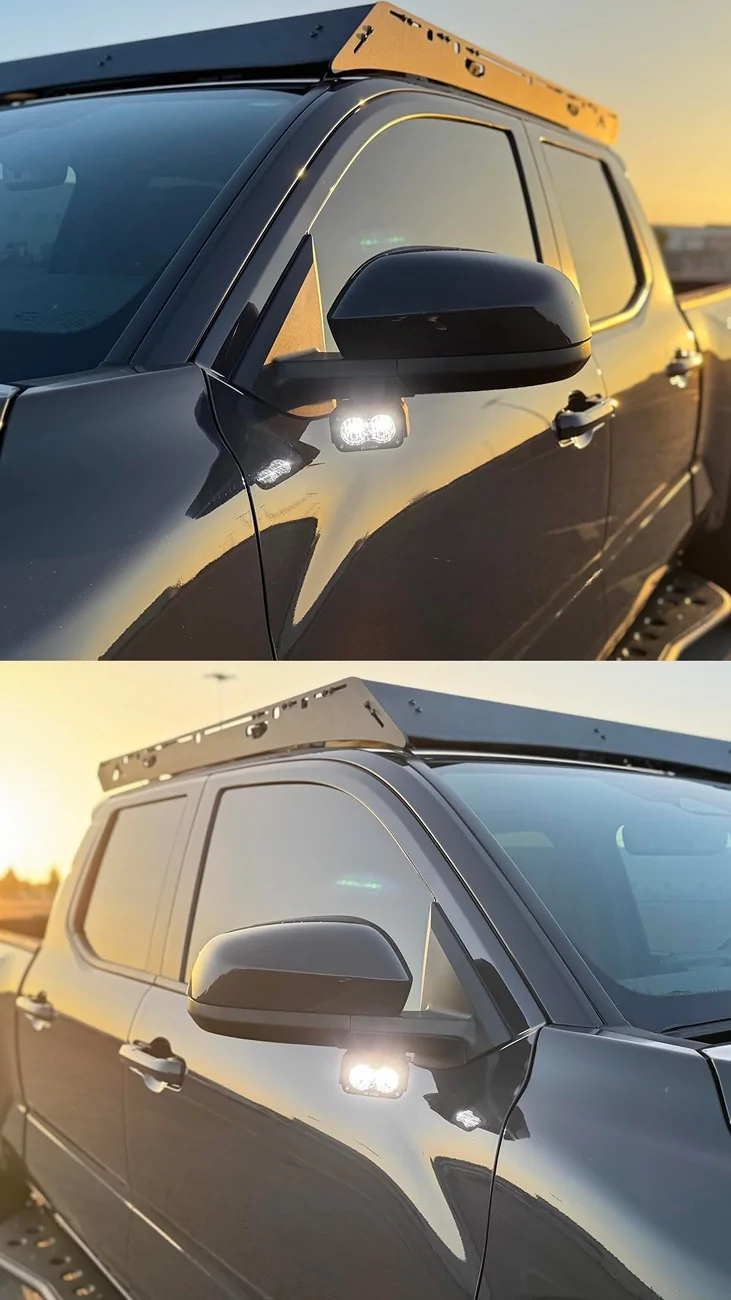

Not quite. But it wasn’t that bad.
- Remove Panels
- Drill two holes into each mirror (using the template provided with the harness).
- Secure mount using hardware provided
- Run each light to your power source (I’m using an 8 Panel Switch Panel)
I’m using Baja Lights. I’m not familiar with DD’s product line. There’s a few people on IG running DD’s with the harness. Looks awesome.

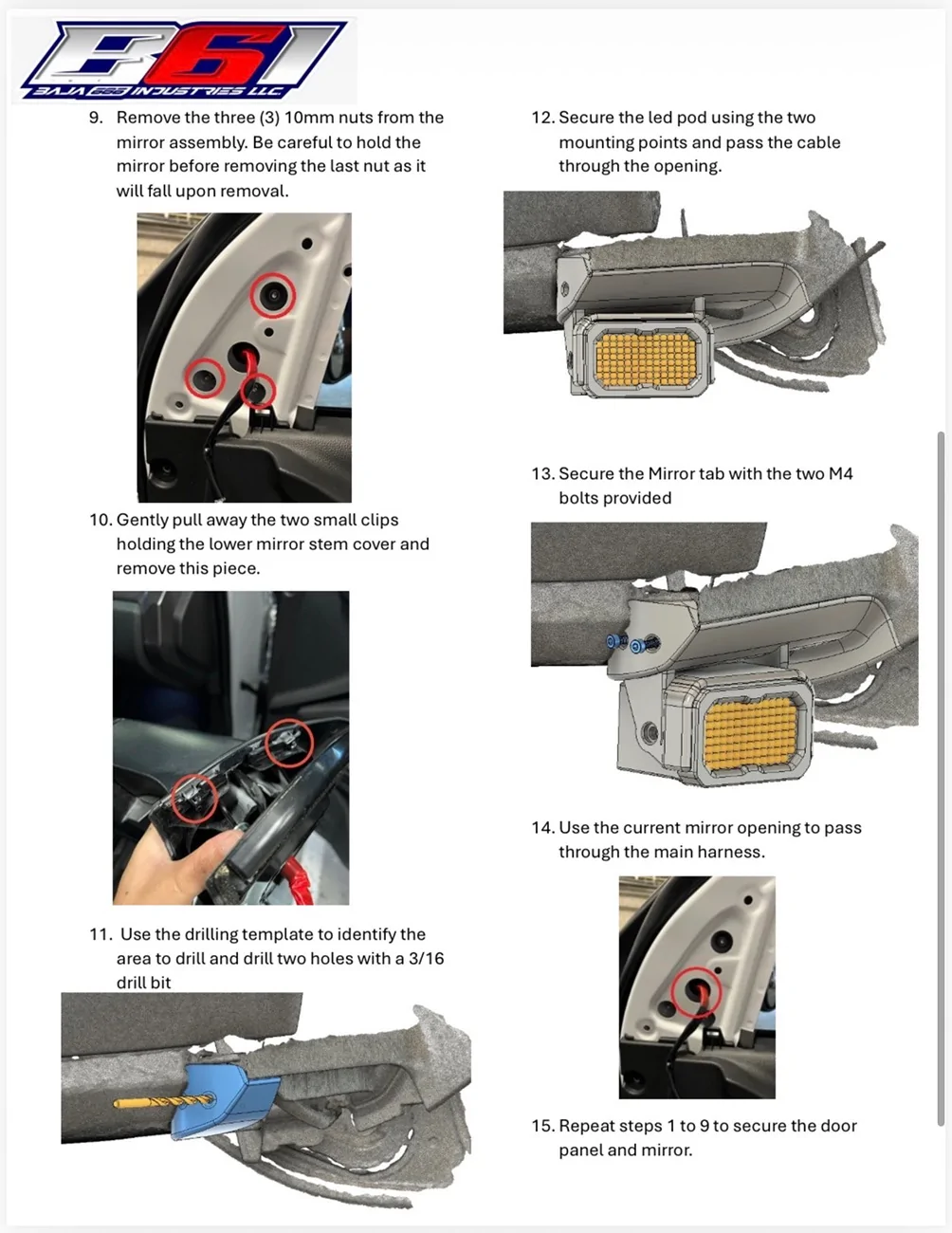

can you show a copy of the install instructions? I'm curious how the wires are routed to the engine bay.
dvrgz
dvrgz
Jun 9, 2024
562
751
Los Angeles

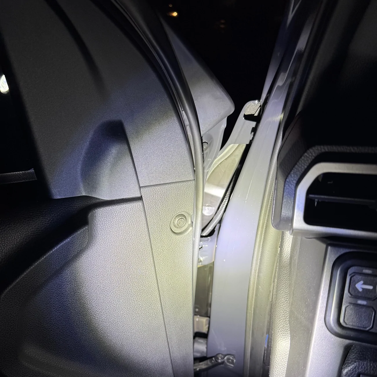

The instructions don’t get that in-depth. I attached the last page of the install instructions. I’ve seen it done a few different ways on instagram. I ran it through a crevice in the door jam and the engine hood. See attached.

Curious about the wire location. Have you had any issues with the wire getting damaged routing that way? Also do you have q pic of where the wire comes out from the door? Looks like it comes out of the upper hole.
