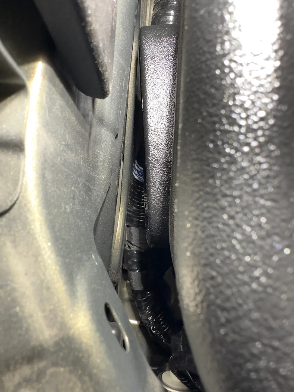

Decided to now try the Intake side port without the cap. Does anybody's side port not go into the fender? Everything else is installed correctly, just seems like it should be longer.
Just checked, mine is the same

2025 Toyota Tacoma Off Road
Interesting, guess that’s how it’s designed. I got more wooshhh sound without the cap at least.
