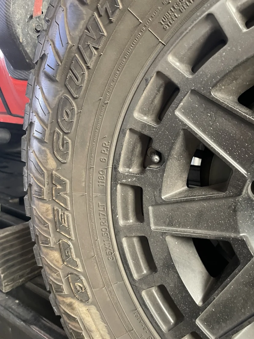

Wheel & Tire Setup
  • ICON alloy wheels
  • Toyo Open Country A/T tires
  • 35x11.50R17LT
  • Load Range C
2024 Tacoma Intake Power Gain Comparison (Factory, Banks, SXTH, K&N) — Same Truck, Day, Dyno, Surprising Results tir
It is important to note that this truck is running a significantly heavier-than-stock wheel and tire package. This absolutely affects measured wheel horsepower and acceleration rate on a chassis dyno compared to stock-equipped trucks.
The objective of this testing was comparative consistency between intake systems — not chasing the highest absolute dyno number.

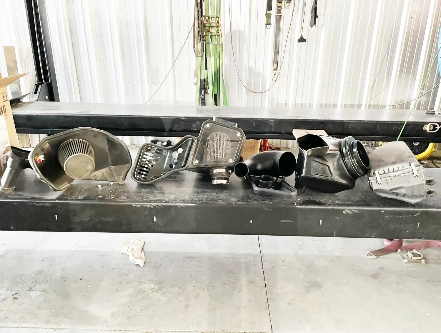

Intakes Tested
  • Factory airbox
  • Banks intake
  • SXTH intake
  • K&N intake (older version that does not replace the turbo inlet)
All intake comparisons shown below were performed on the factory calibration and stock turbocharger.

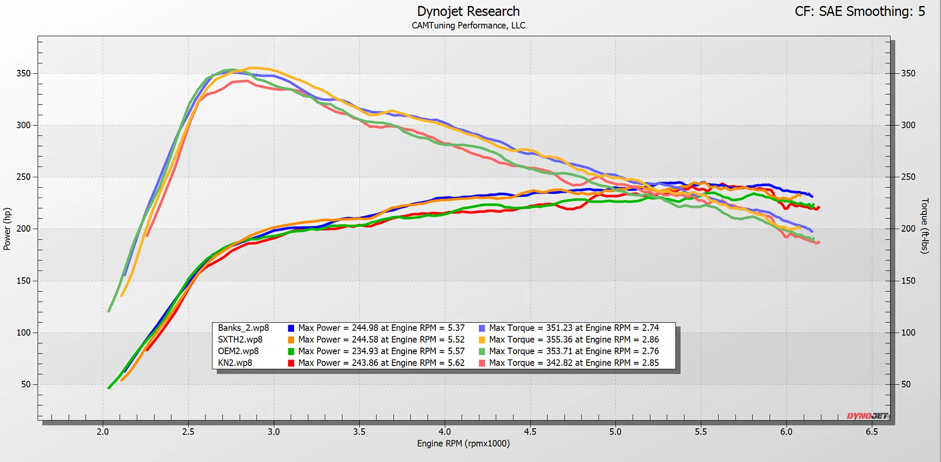

Dyno Results – Stock Calibration
Despite significant differences in intake design, the dyno results were remarkably close.
Peak horsepower results:
  • Banks: 244.98 whp
  • SXTH: 244.58 whp
  • OEM Airbox: 234.93 whp
  • K&N: 243.86 whp
Torque curves were also extremely similar throughout most of the pull.
The biggest takeaway from the dyno portion of this testing is that on the factory calibration and stock turbocharger, the ECU’s torque and airflow management strategy minimizes outright power differences between quality intake systems more than many enthusiasts expect.
2024 Tacoma Intake Power Gain Comparison (Factory, Banks, SXTH, K&N) — Same Truck, Day, Dyno, Surprising Results intake dyno compliation

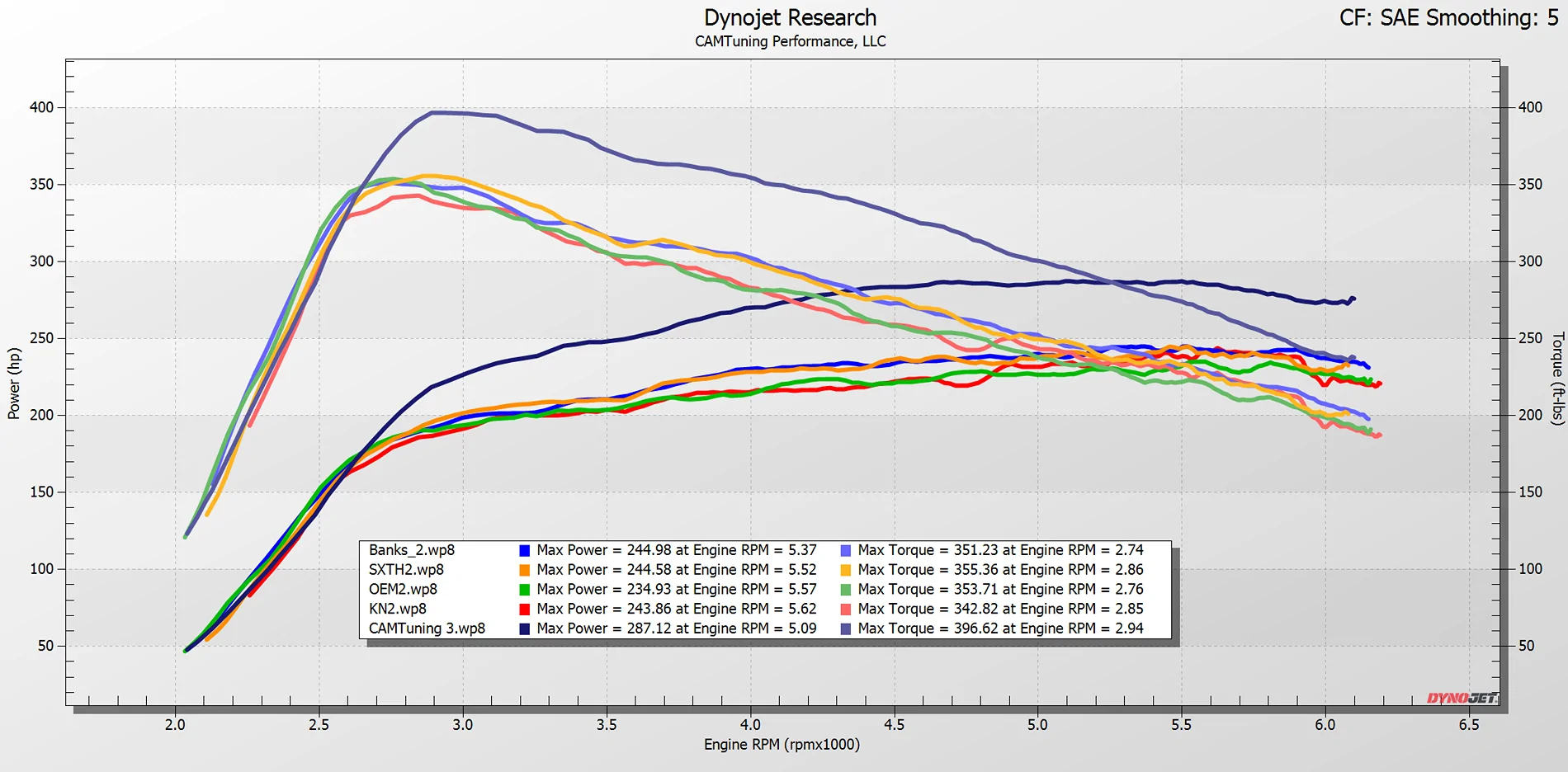

After completing the stock calibration testing, the K&N intake was professionally calibrated on 91 octane for the owner of this truck. Once the truck received a complete calibration — including airflow modeling, torque request strategy, fueling, ignition timing, boost control, and transmission tuning — the intake responded significantly better than it did on the factory calibration while maintaining stable fuel correction behavior.
2024 Tacoma Intake Power Gain Comparison (Factory, Banks, SXTH, K&N) — Same Truck, Day, Dyno, Surprising Results custom tune kn
That is the biggest conclusion from this testing:
These intake systems are all relatively comparable on the stock tune, but they have substantially more potential once paired with proper professional calibration.
The factory ECU is capable of adapting surprisingly well on its own, but custom tuning allows the airflow model, fuel correction behavior, and overall performance to be optimized correctly rather than simply compensated for.

Wheel & Tire Setup
  • ICON alloy wheels
  • 35x11.50R17LT
  • Load Range C
Intakes Tested
  • Factory airbox
  • Banks intake
  • SXTH intake
  • Banks: 244.98 whp
  • SXTH: 244.58 whp
  • K&N: 243.86 whp

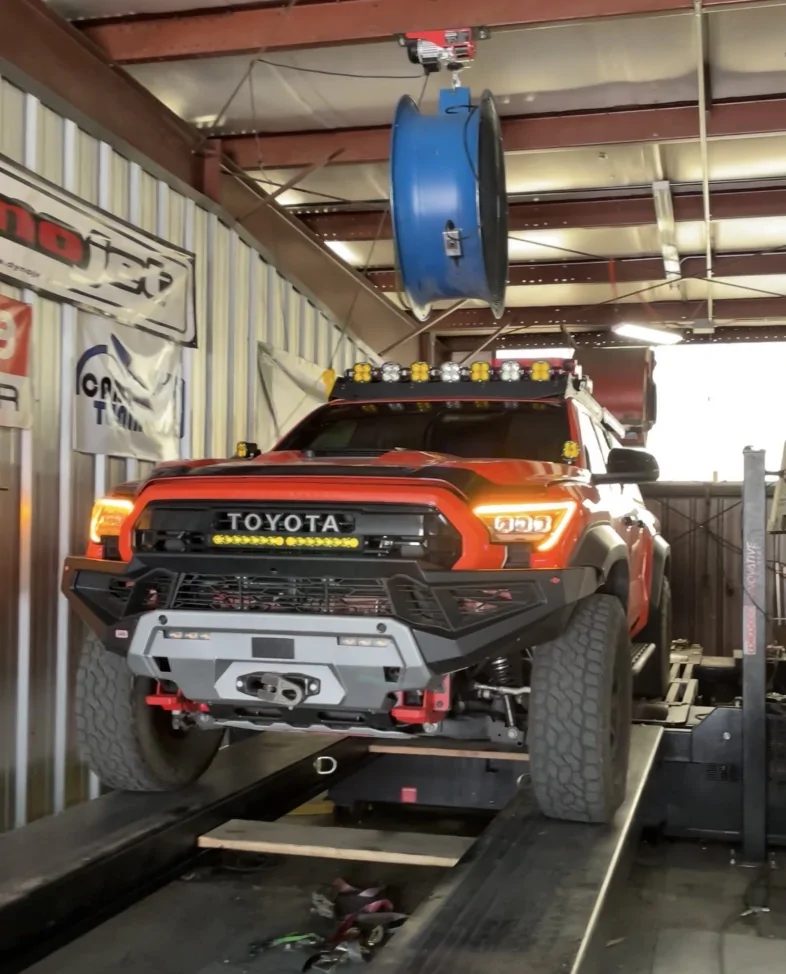

There's one thing I've always wondered about the Dyno tests. since they are "stationary" tests it doesn't take into account the effects of a larger ram scoop at highway speed. What would be the expected difference considering that parameter?
JayTech
Jay
May 5, 2025
218
222
2025 Toyota Tacoma TRD ORP
They typically have fans blowing air across the front during dyno runs to simulate airflow but for a way of measuring power that is probably as accurate and close as you can get. I don't know if there really is a calculation that can account for that as there are too many variables(wind speed, temperature, turbo/intercooler heat soak etc).
