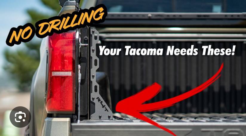

I got a pair just to be safe. Probably didn’t need them but I never know what I might be doing in the future. I went with the up top overland /R4Tacos no drill bed stiffeners. Just remove factory hardware and install. If you want it to be more secure you can drill and add more. If I remember there’s a video on YouTube.

Yes definitely would get the no drill. For my application, if I were to get them, drilling would cause more damage to the truck than anything the stiffeners are designed to prevent lol

I felt the same way. That’s why I looked for the no drill bed stiffeners. Plus they give some extra tie down points.

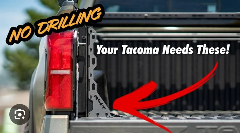

Yes, except mine has the R4T logo on it and the uptop logo.

Those Millercat bed stiffeners look great. They didn’t have those when I was looking (not that I know of) or I might have went that route.

Those do look good and no drill is certainly easier. It would seem to me they wouldnt be nearly as effective as ones that have several attachment points up the side, meaning dril.
