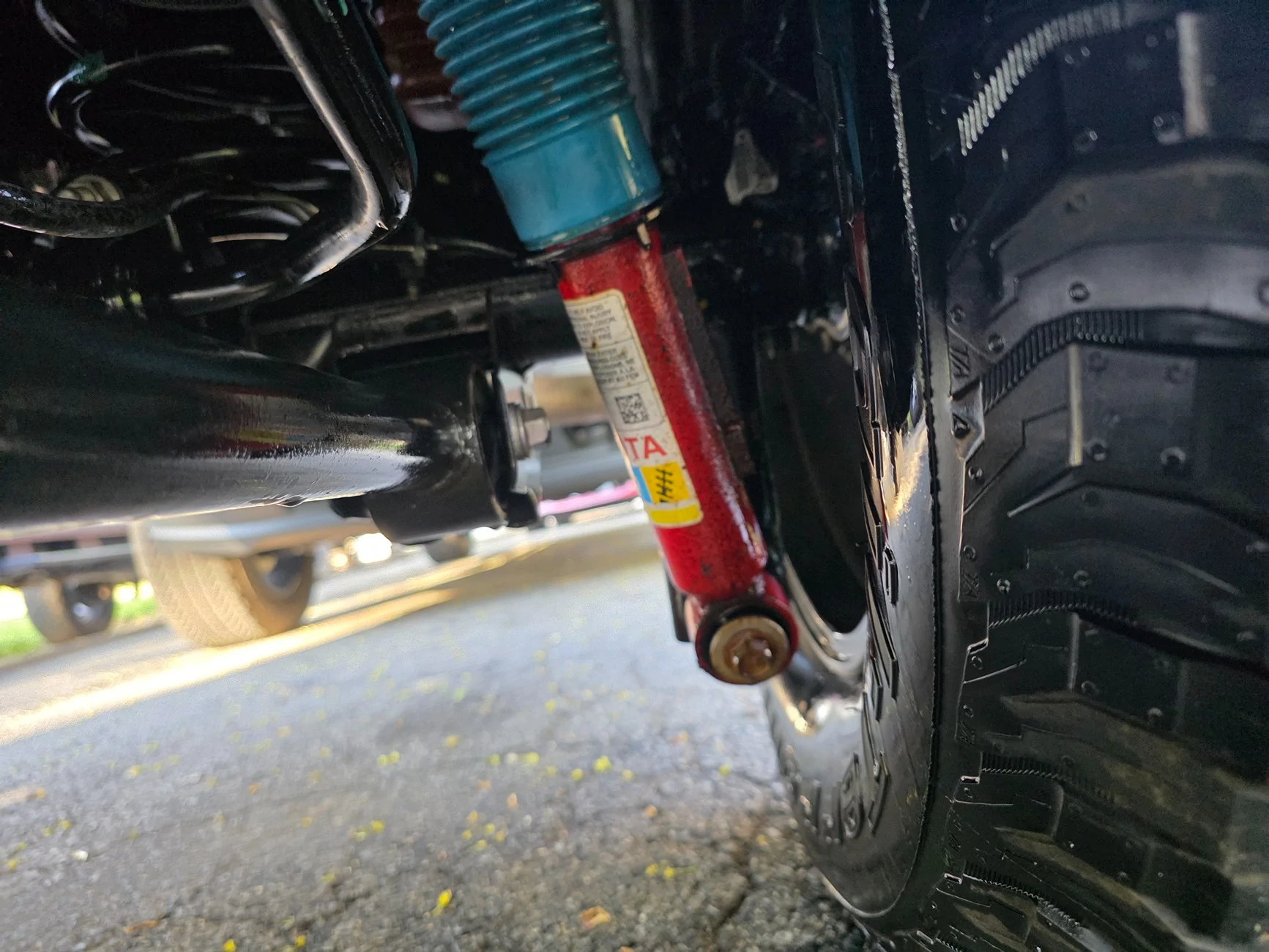

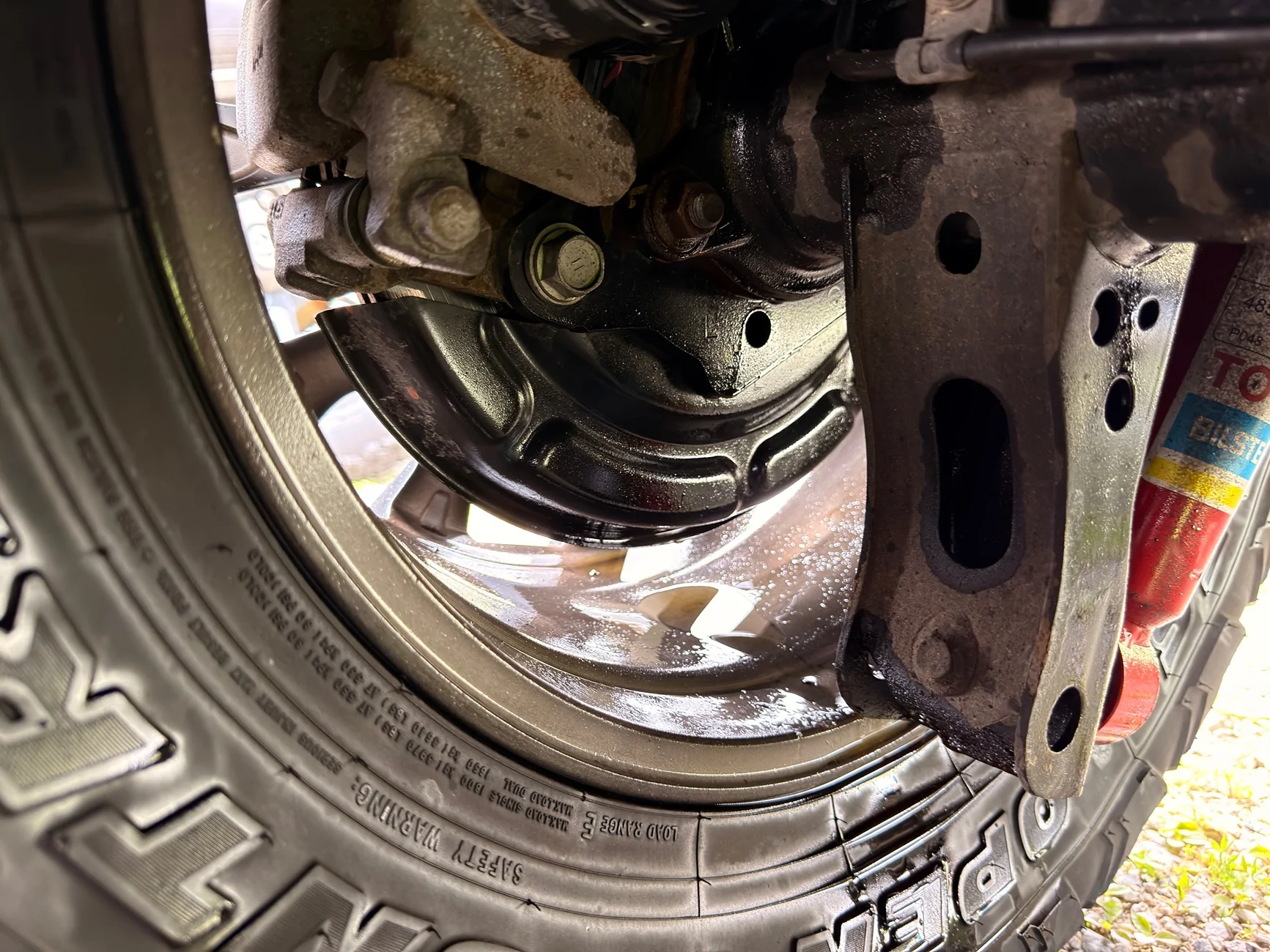

Same issue - the dealership calls it "The Clown Truck" as they tapped the brakes and it bouces into the service area. Toyota approved a single shock for replacement because "the reservoir blew off", but not the other (drivers approved, passenger awaits).
Has anyone tried the Bilstein B8 6100 — part number 24-333269 ? Slightly bigger diameter with now external bits....

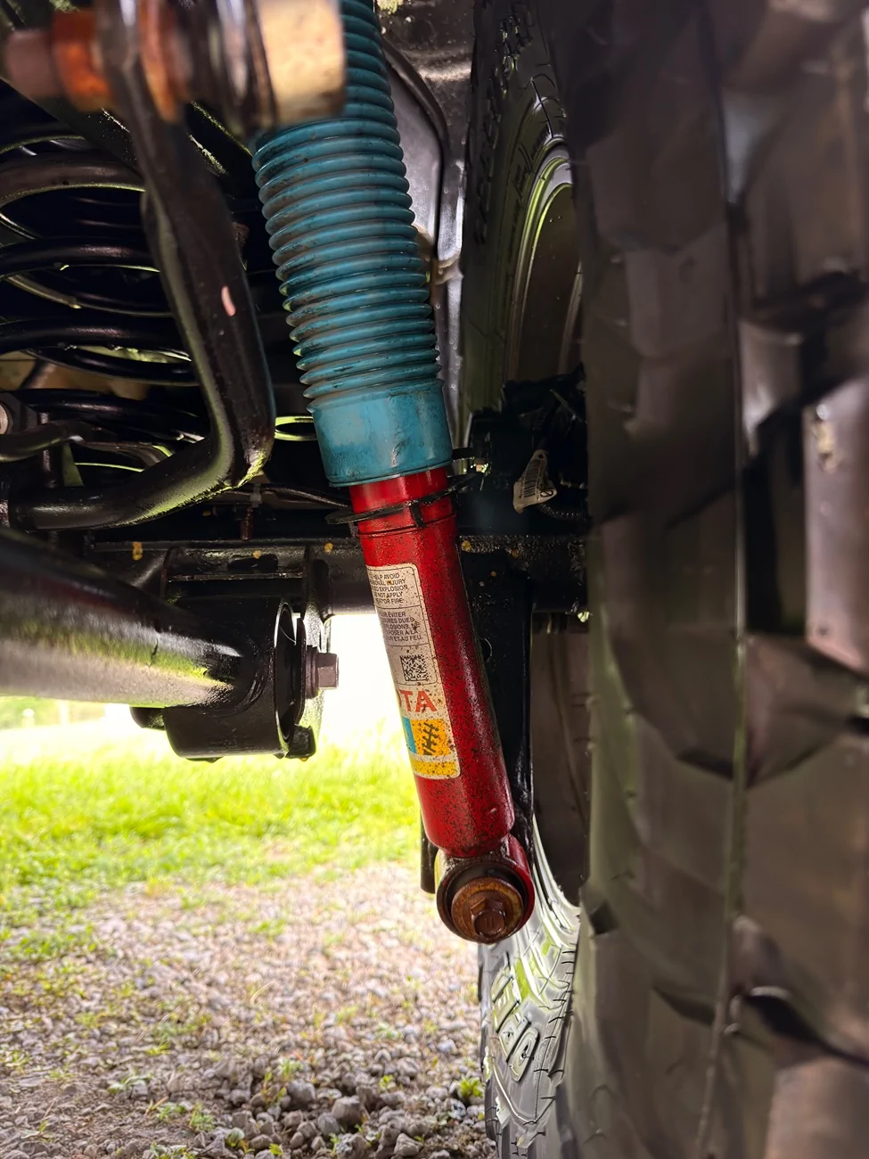

yup, same failure i had, mind you i have nothing in the bed, its a commuter so tank stays between half and full every day, thats it.
toyota extended warranty only replaced that 1 shock for me. bet the other one is gonna go soon. the new shock has a slightly different design with the way the reservoir is mounted

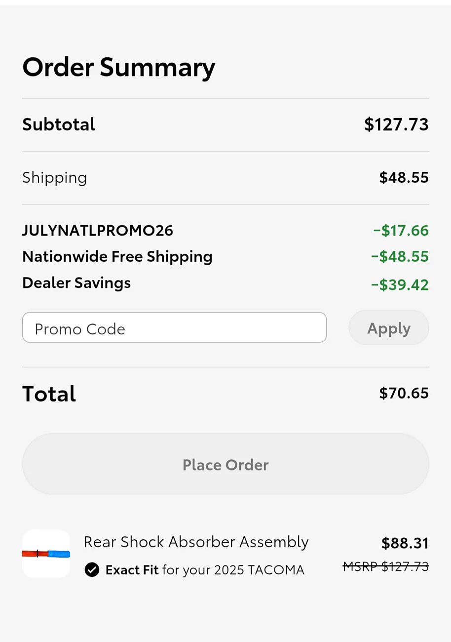

Is that worth with ? You can order them for $70 per side and put them on in 10 min without even lifting the truck.

I'm not sure, but this price check is through Serra Toyota. Could call and ask how fast they would ship. Or you could put something else on the truck that won't fall apart like that.
Sometimes some of these smaller things just aren't worth the dealer/warranty hassle man. That's a long wait just to put the same shock back on the truck.

Well that's nice at least ! I hope they do that for you. But yea man, those shocks are so cheap when Toyota is having a sale that it just makes more sense to do it yourself and get back on the road rather than be without your truck.
