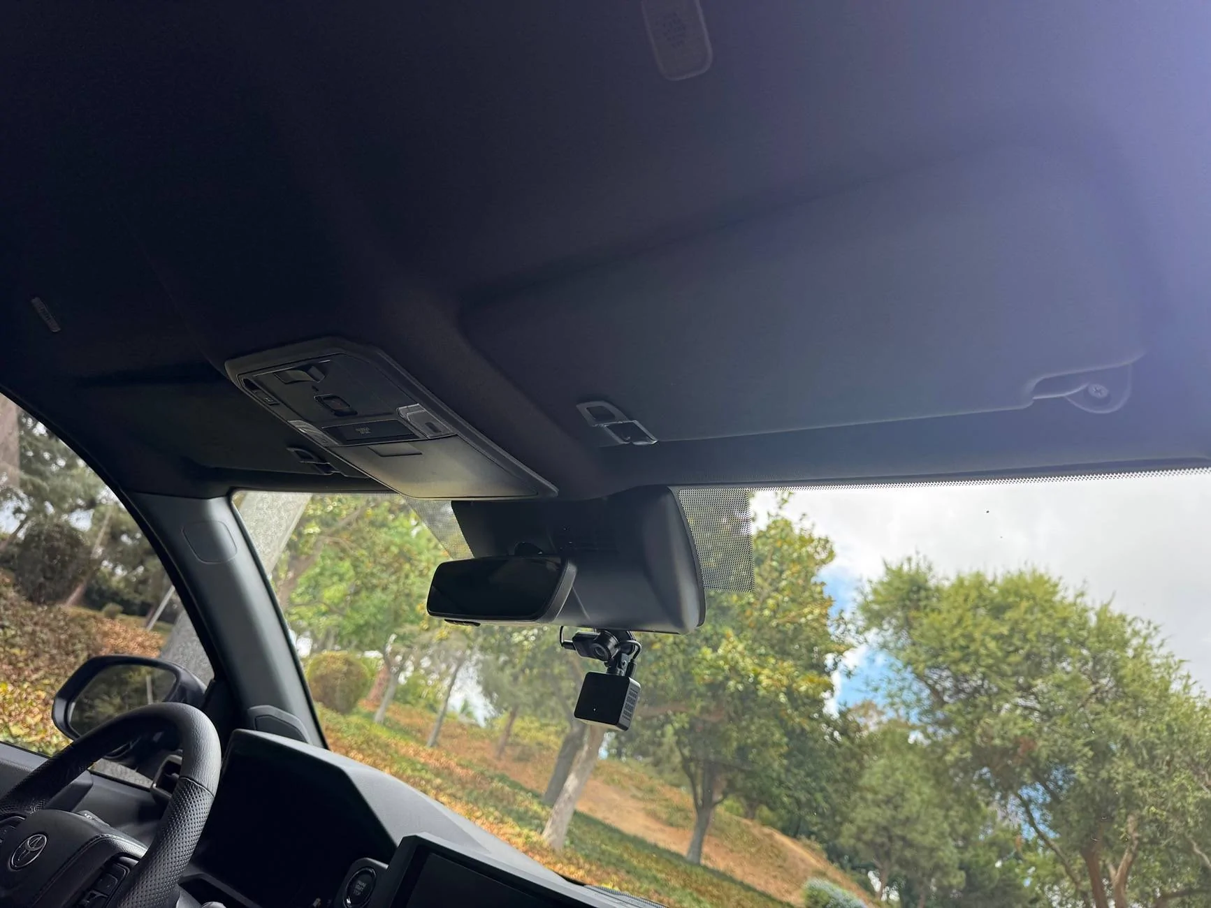

The bolts are a nice touch, but getting those ugly visor stickers off is epic. I have given up on other vehicles because they usually leave the visor material damaged. It looks like this is doable on a 4th gen and I will have to check this out.
I’m thinking @dvrgz has the best idea, light heat gun. I took some risk and yanked. Of course the first one was the one that went easier, then the second one, not so lucky. In the end to get the glue off it, I used some brake cleaner and a clean lint free rag. In the end I thought what was the worst that can happen, I need to buy a new sun-visor.

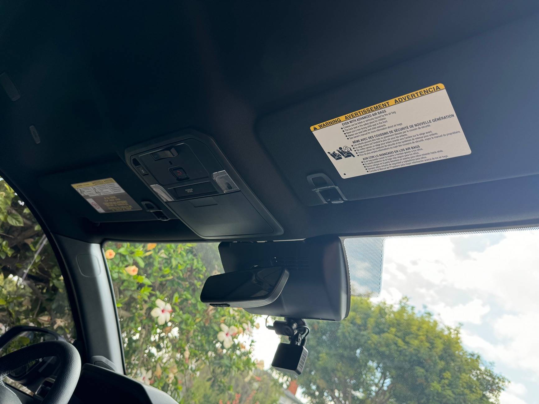

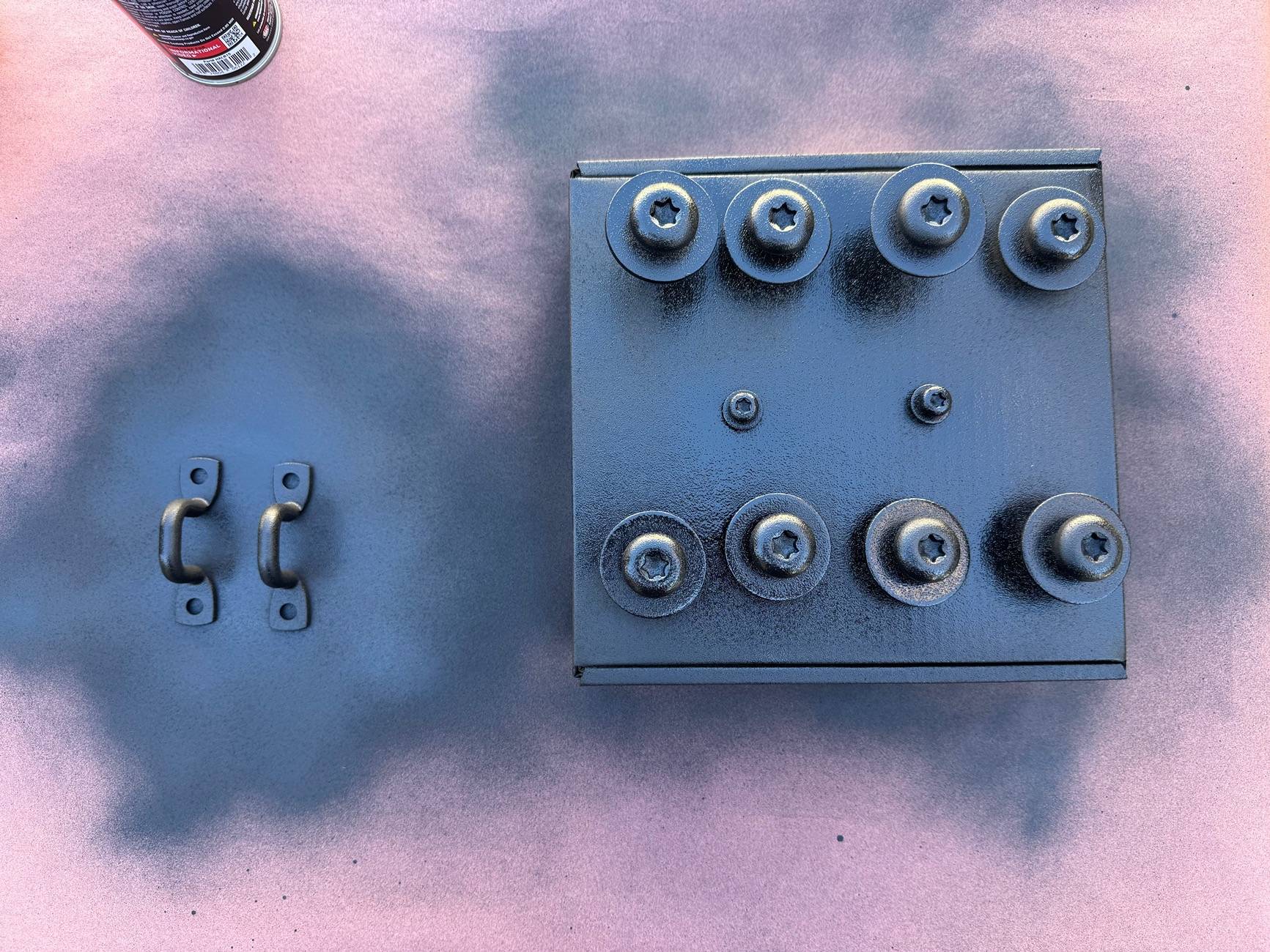

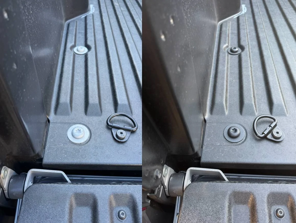

Bored. This is my last week of vacation before my peasant ass goes back to work. Decided to paint the truck bed bolts.
2024 Tacoma Bolts to Black & Visor Warning Removal IMG_7724
2024 Tacoma Bolts to Black & Visor Warning Removal IMG_7701

Great idea on the bolts, they look great. I am retired and always looking for something to spray paint LOL. Just need the weather to warm up. I was sitting in traffic and picked at the corner of the drivers side visor sticker and was able to slowly pull it off in one shot. The passenger side no so much. I used a heat gun carefully and it came off in pieces leaving glue residue behind. I continued with my heat gun and a tooth brush/finger nails and was able to get the remainder off. I took the visor off and working on a flat surface helped a lot.
