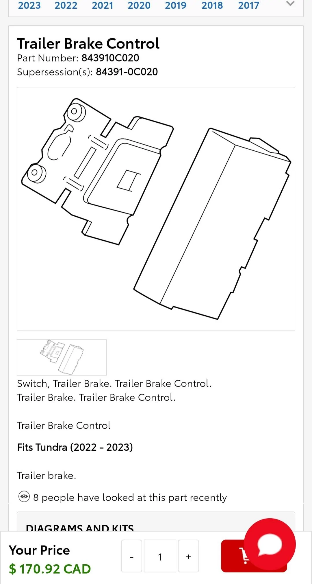

I wonder if the 2022-24 Tundra factory brake controller would be plug and play in the new Tacoma?
2024 Tacoma Brake controller harness for 4th gen Tacoma? Screenshot_20240317-180745_Chrom
This won't work, the harness for it is not even there, it also need the brake controller ECU which is also missing, the whole harness is different so we cannot even buy the ecu and plug it

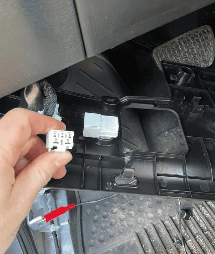

JBSwine
Feb 2, 2023
482
502
2022 Kia Sorento
Look under the dash for something like this:
2024 Tacoma Brake controller harness for 4th gen Tacoma? Screenshot 2024-04-16 095835
