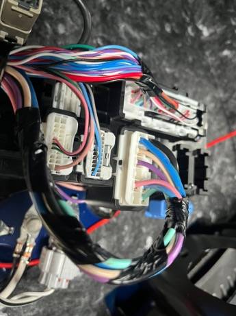

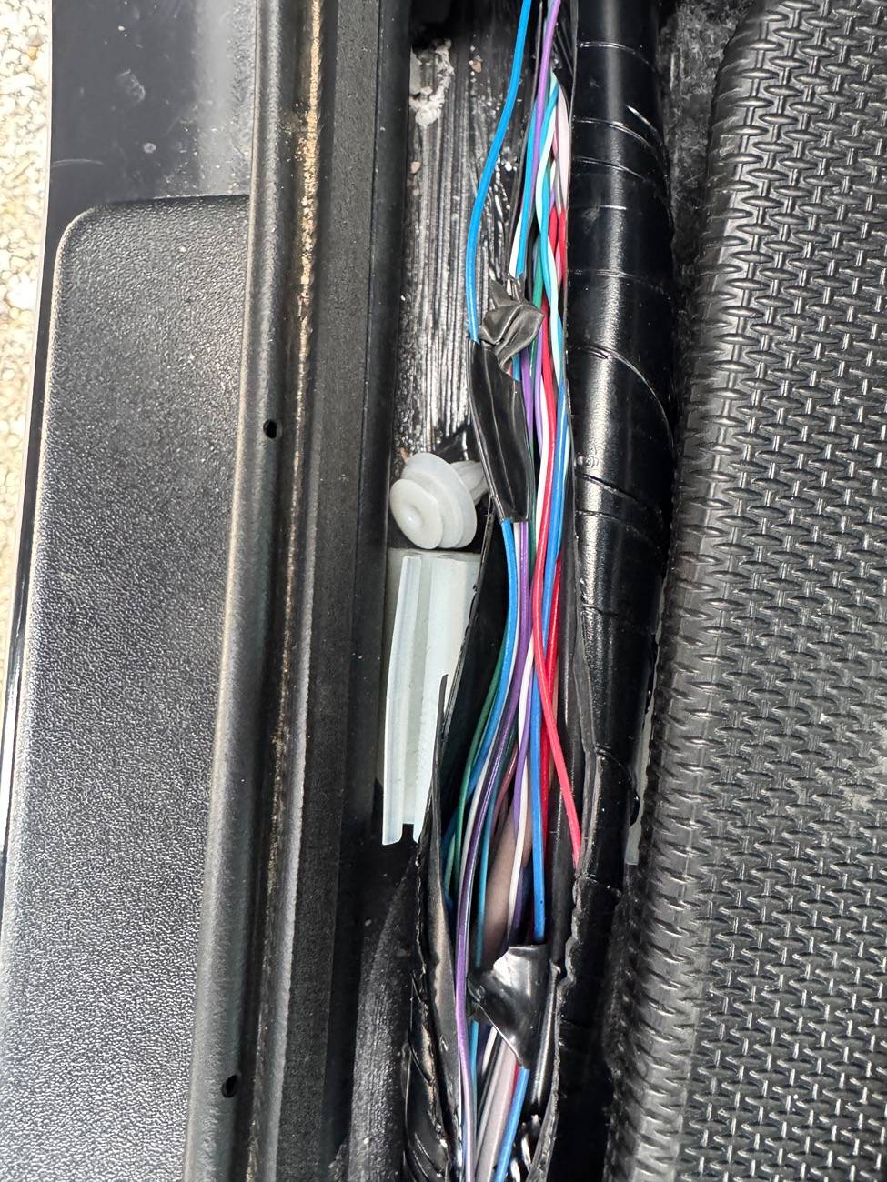

I photo of where you found that brake signal wire might be helpful to others.

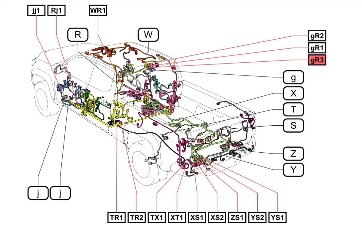

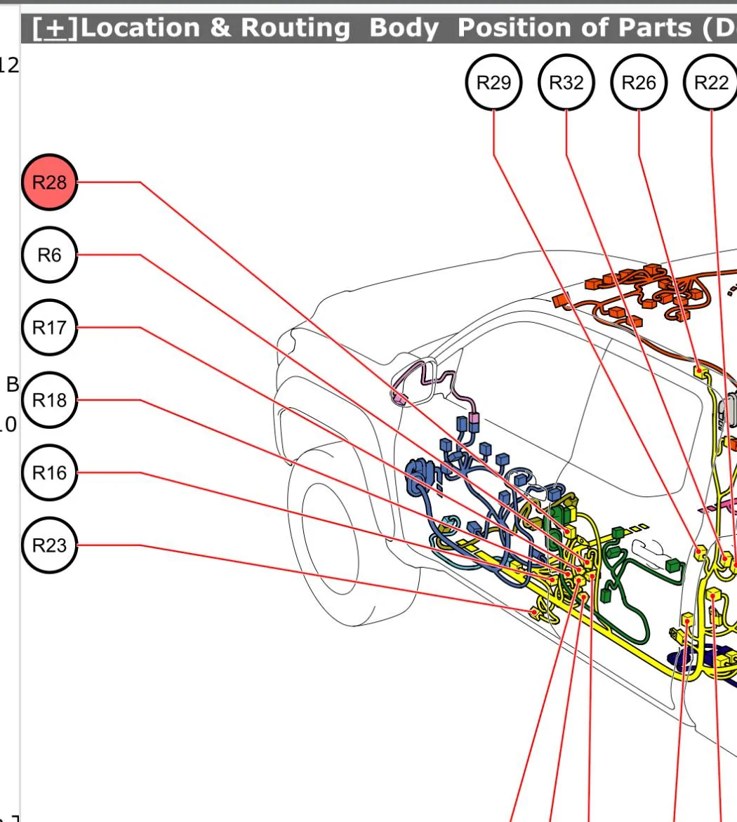

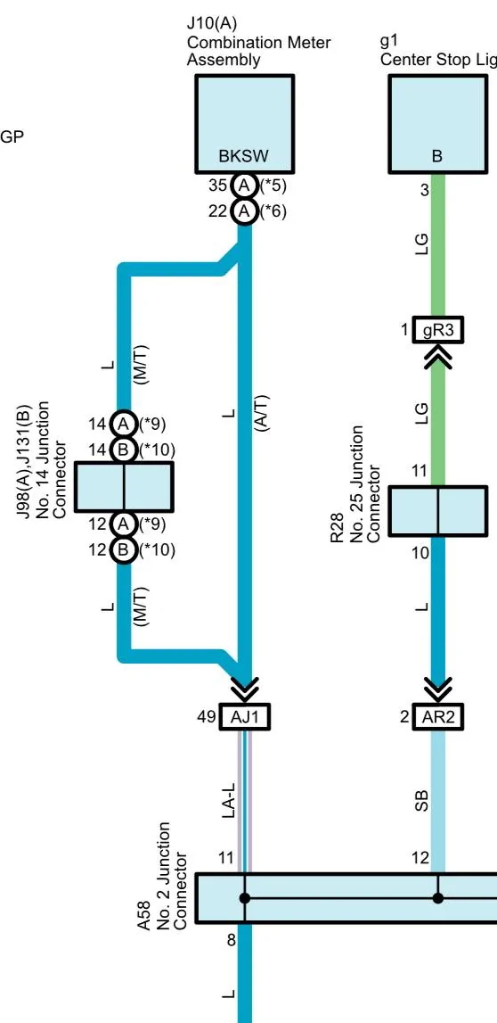

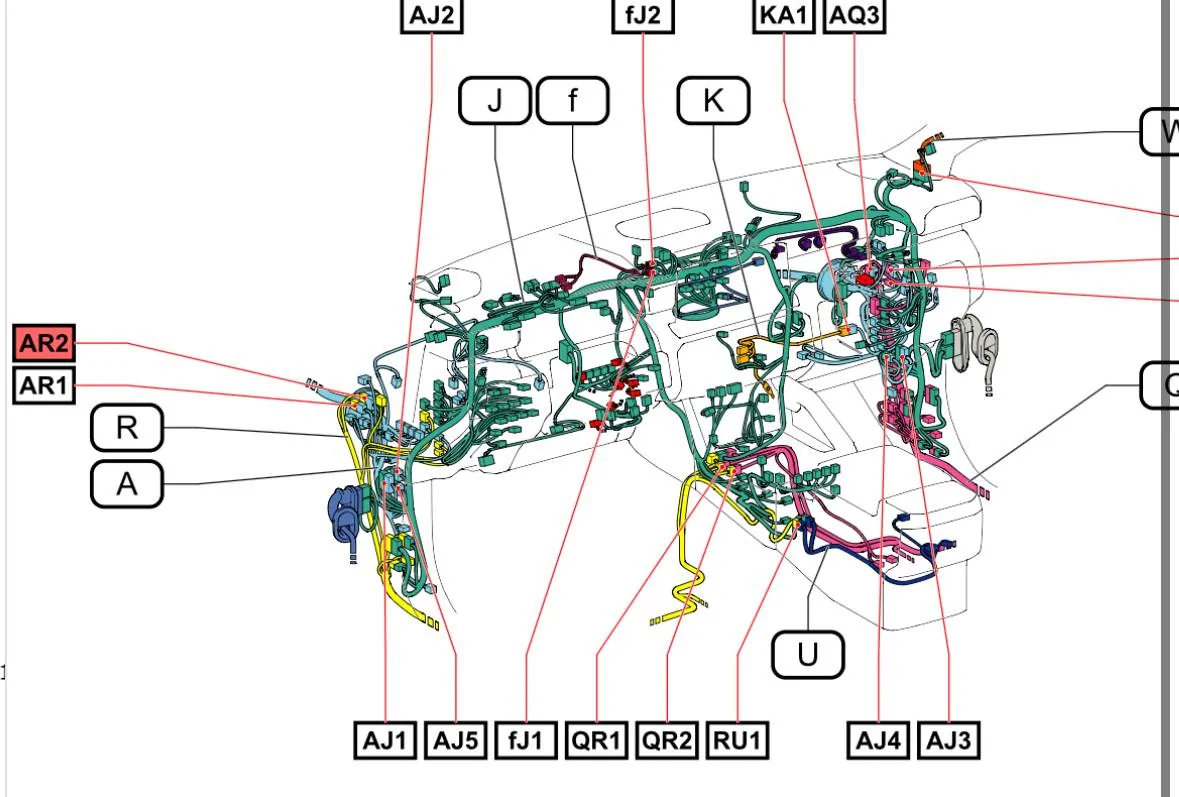

good call - see here! the wire in question is blue, next to the red wire, with a small tag of electrical tape toward the bottom
of the image. This is under the driver’s door trim in a double cab TRD OR. If you are looking at the tacoma circuit diagram, this is the blue wire between AR2 and RG28. Folks installing the Redarc controllers seem to prefer the light green wire between R28 and gR3 under the back drivers side door trim. This makes sense, given that the Redarc control units are being installed under the back seat. The problem with tapping into this circuit under the driver’s door trim is that there are two blue wires. it may ultimately be a better choice to tap into the light green wire under the back drivers side door trim if there is only one light green wire there.
