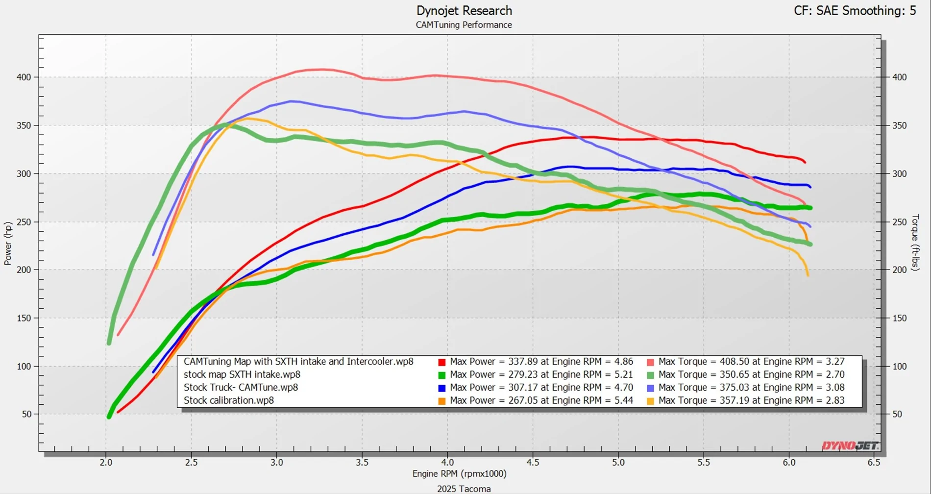

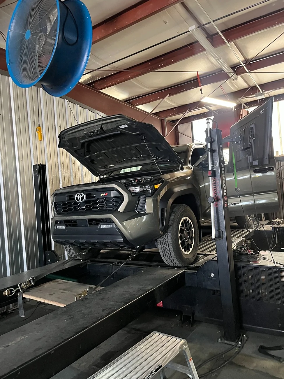

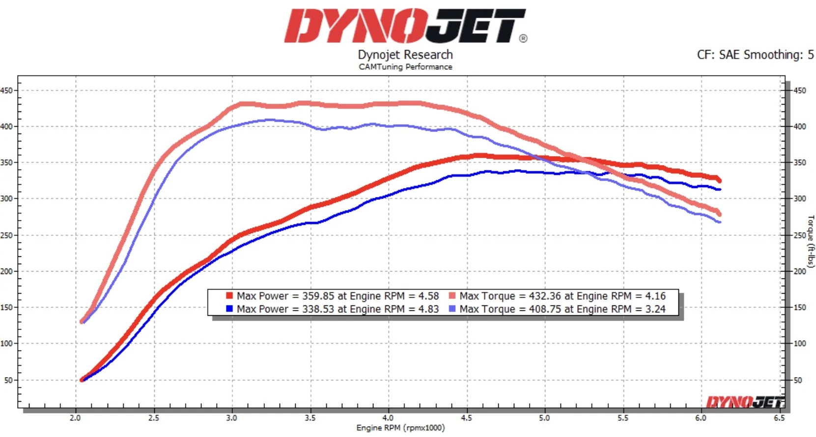

We spent the whole day on the dyno today and have positive results to share. This was all tested on 91 octane (no ethanol added, so E10).
SXTH intake was on the truck and we did a couple of pulls on the stock mapping, then on the map that produced 309whp a couple of weeks ago. Then I did some further tuning and pulled some power power out of it.

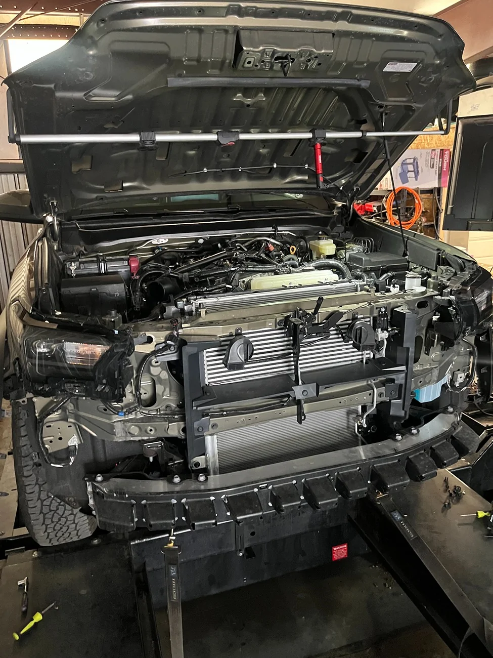

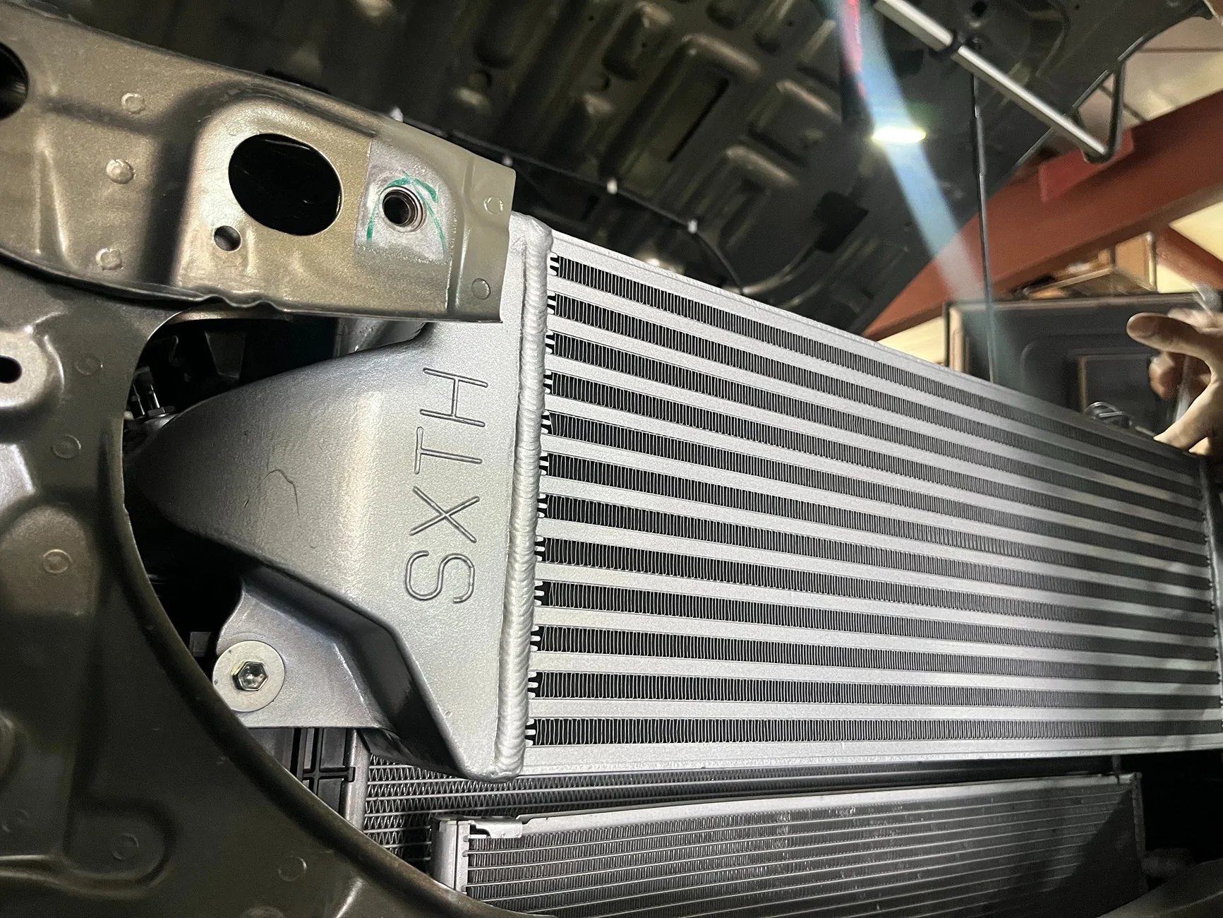

We then left the truck strapped to the dyno and swapped the intercooler, did some stock calibration pulls, and again further tuning.
There's a lot going on in this graph:
CAMTuning map with SXTH intake and intercooler is the custom calibration done today with IC and intake. (RED)
Stock map SXTH intake is the stock calibration and SXTH Elements intake (Green)
Stock Truck CAMTune is the truck completely stock, with a custom tune using Cobb (Blue)
Stock calibration is stock tune and stock truck (Orange)
I'm impressed with the gains on the intake with no tuning (+12whp), but more impressed in the jump in total power and torque when tuning was added with the intake and intercooler (+70whp/51wtq) over stock.
We did a total of 39 dyno runs today gathering data and fine tuning. Next step will be to put the truck back on an ethanol blend with the new parts and see what it will make. It made more power on 91 today than it did on an E30 blend last week.

Ver cool to see some real data on these, I appreciate your effort and it looks like a blast to be able to do. I am ifnorant in all things tuning and was curious what your thought is on the intake and stock tune seeming to get a slight jump on the power in both graphs.
Also I can’t quite see what the two separate graphs are differentiating. What was the change in those?

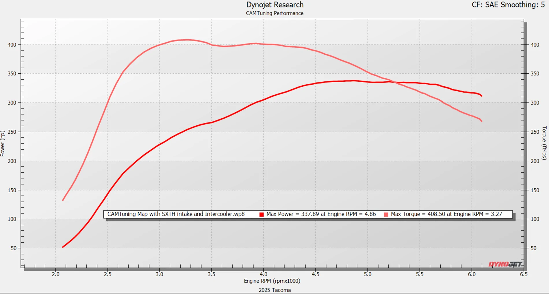

Thanks for the comment. If you are asking what the difference in the 2 lines of the same color are, one is horsepower and one is torque (measured at the wheels)
Here's a single graph for better explanation- RPM is on the X -axis, and in this case the Y axis is scaled the same for HP and TQ. You sometimes see them scaled differently and it will change the way the dyno looks. The HP and TQ lines will always cross at 5252 RPM, because they are related by this equation: Horsepower = (Torque x RPM) / 5,252.
You will see dyno graphs that look very different depending on engine displacement, whether or not it is turbocharged, etc. A small turbo usually makes a steep climb in torque early, and it will trail off like you see in the top left curve in this graph.

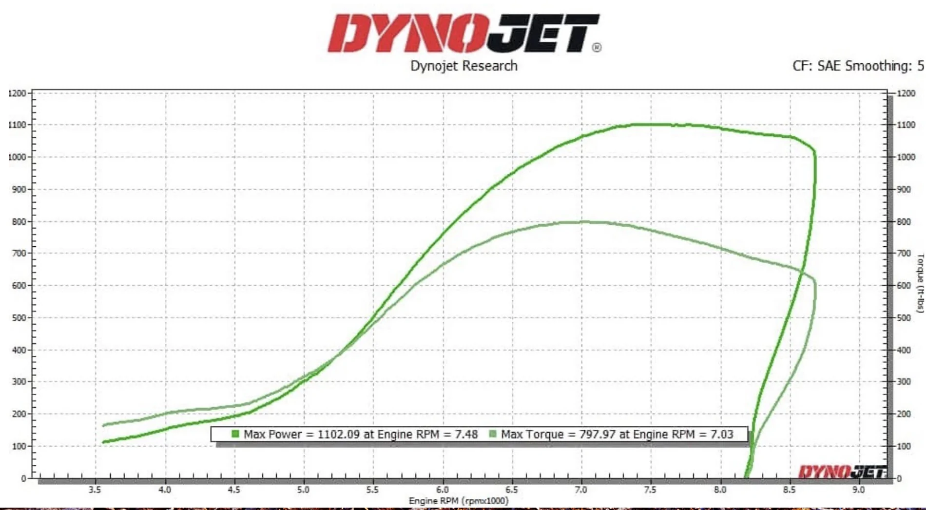

Here's a different example to show a very large (76mm) turbo on a 2.5 L Subaru that I tuned last year. Look how torque comes in so late, but HP and TQ are held much better up top. This car is zero fun on the street, but for drag racing it moves.

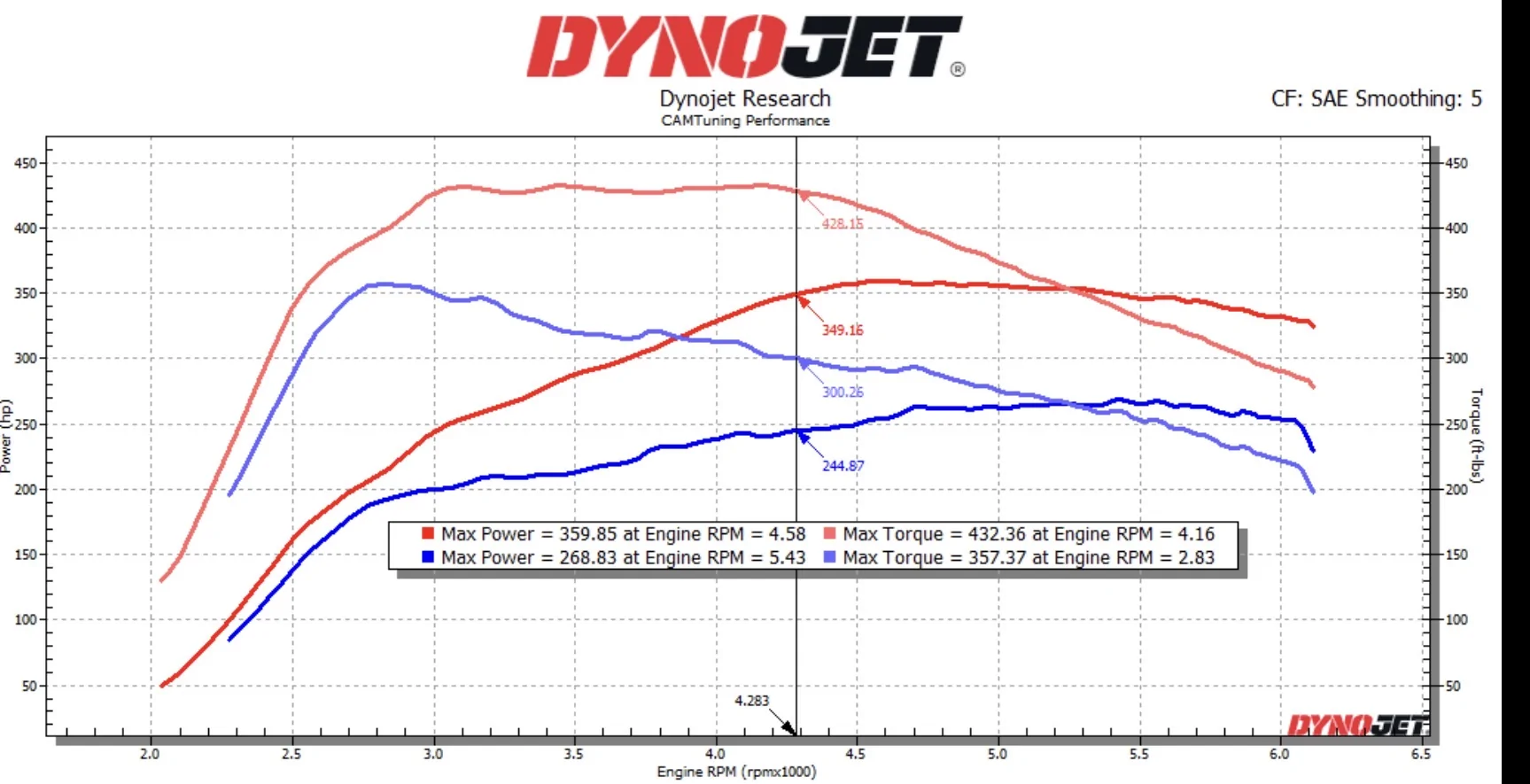

E30 ethanol blend made another big jump. I have a content gauge on the truck and this was 30.1%.
I put the cursor on the graph to show the +128wtq and +105whp in the mid range. The torque curve is so much flatter than stock. I daily drive this truck and have put almost 8000 miles on it since the end of March.
This graph shows the gains from E30 vs 91 on the same mods (SXTH intake and intercooler)
