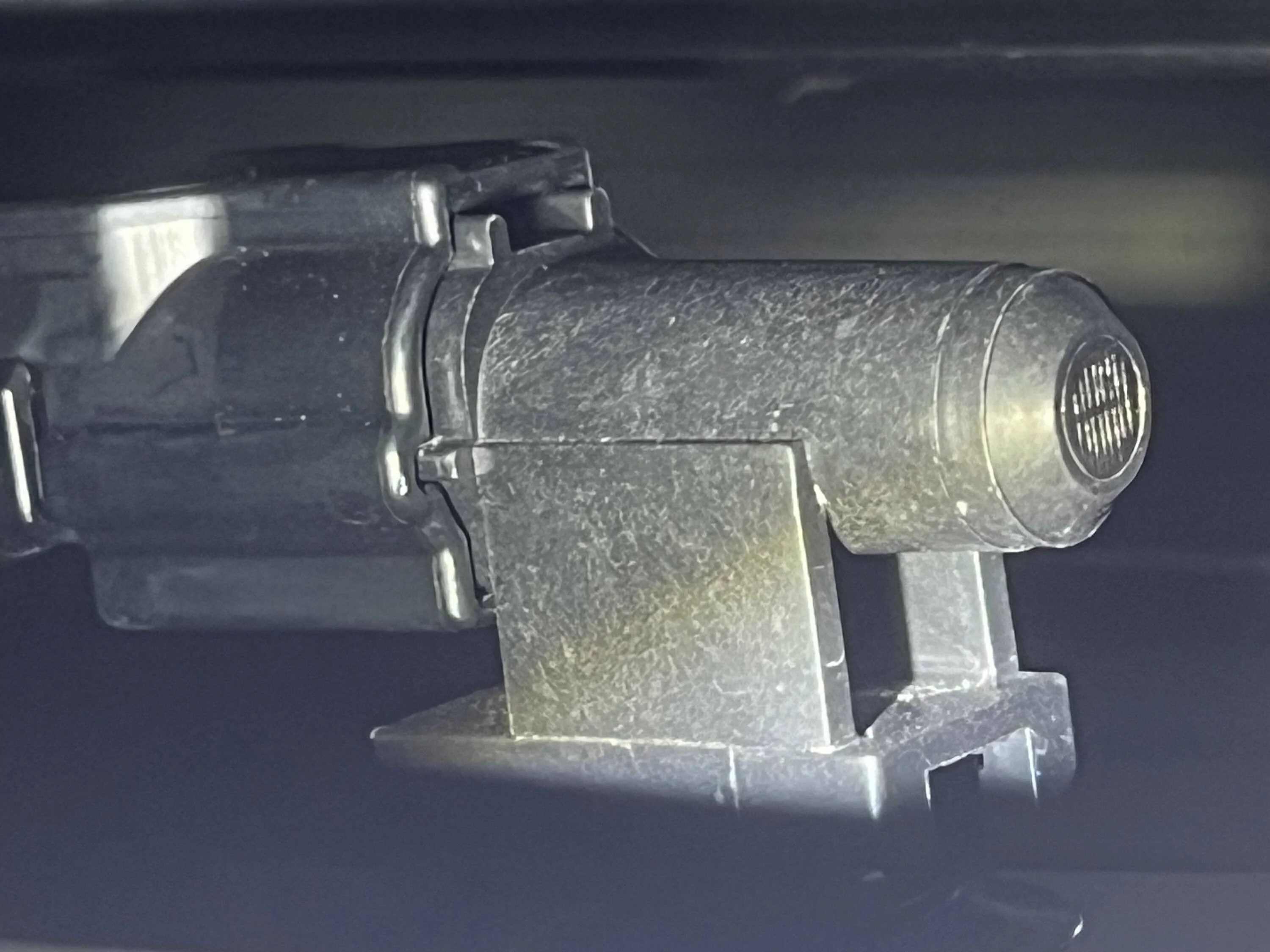

Is it the little sensor that is mounted near center above license plate bracket behind the grill and before the shutters?

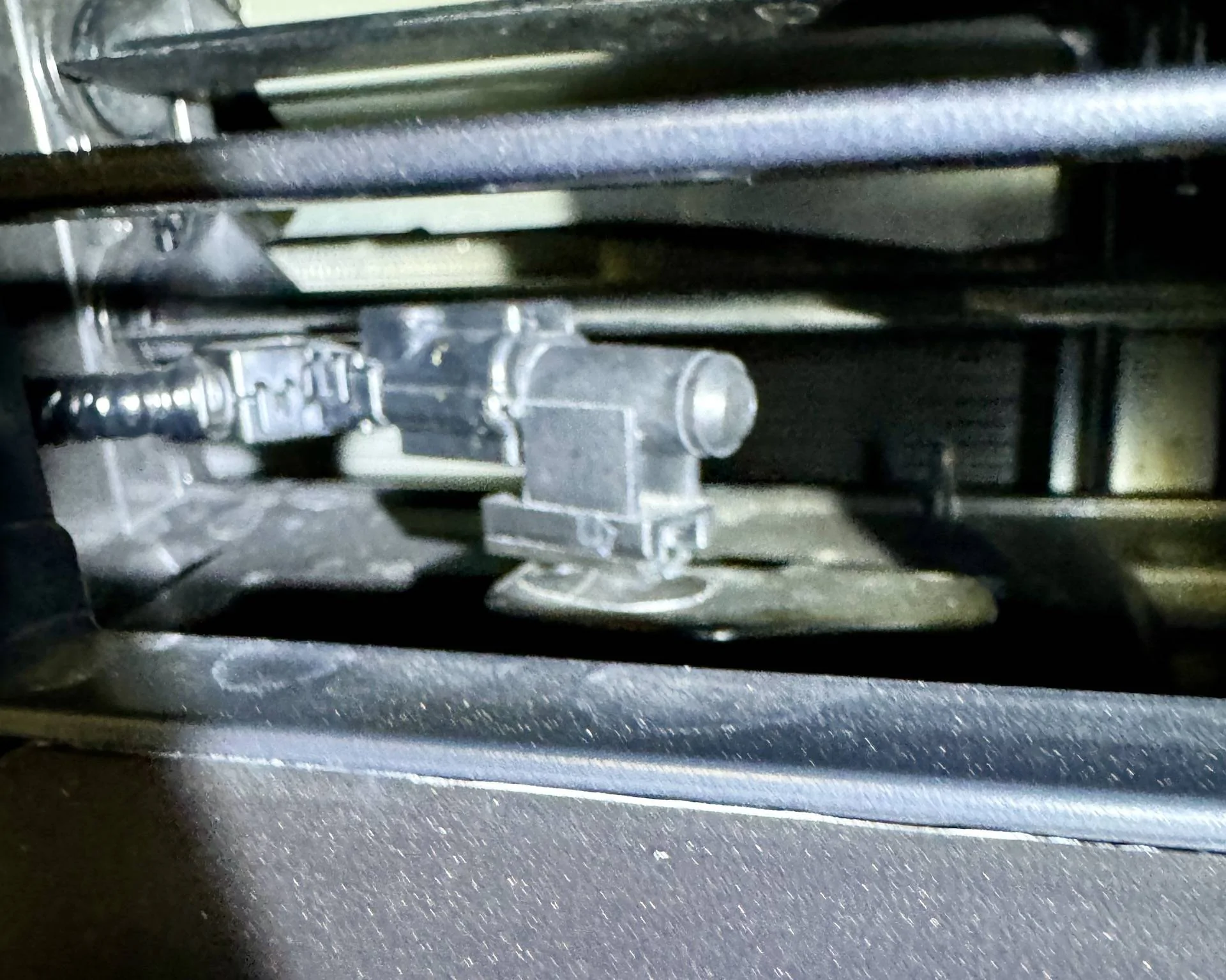

I’m guessing that’s the sensor that detect a the air temperature that controls the shutter. It clearly is a sensor by the looks of it. There are tons of connectors under these trucks and I am planning on checking all that I can this weekend to see if any are loose. I have 850 miles on mine and have driven it through some rough California rains these past couple of weeks and no issues so far. Will keep my fingers crossed. Here’s a closeup of that sensor.
