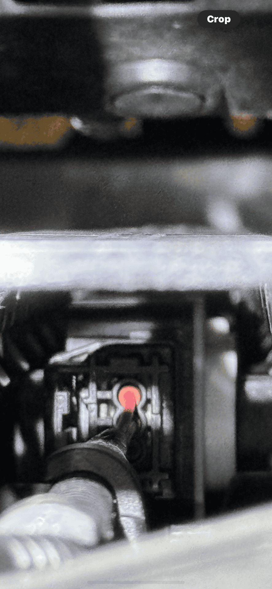

I wonder if this part the grill shutter assembly is also used in another model. How could there have been corrosion to the point of failing in a new truck? Looking athe grill blades etc they look plastic to me. Looking straight down the grill right in front of the hood latch you can see the acuator and the connector. You can see the connector is exposed. Will this issue keep happening?
I wondered the same. Thought to myself about an hour ago "I wonder if they're replacing it with an improved revised part, or if they're replacing it with the same part and hoping for the best.
Time will tell, but I'll be fuming if I get it a second time.

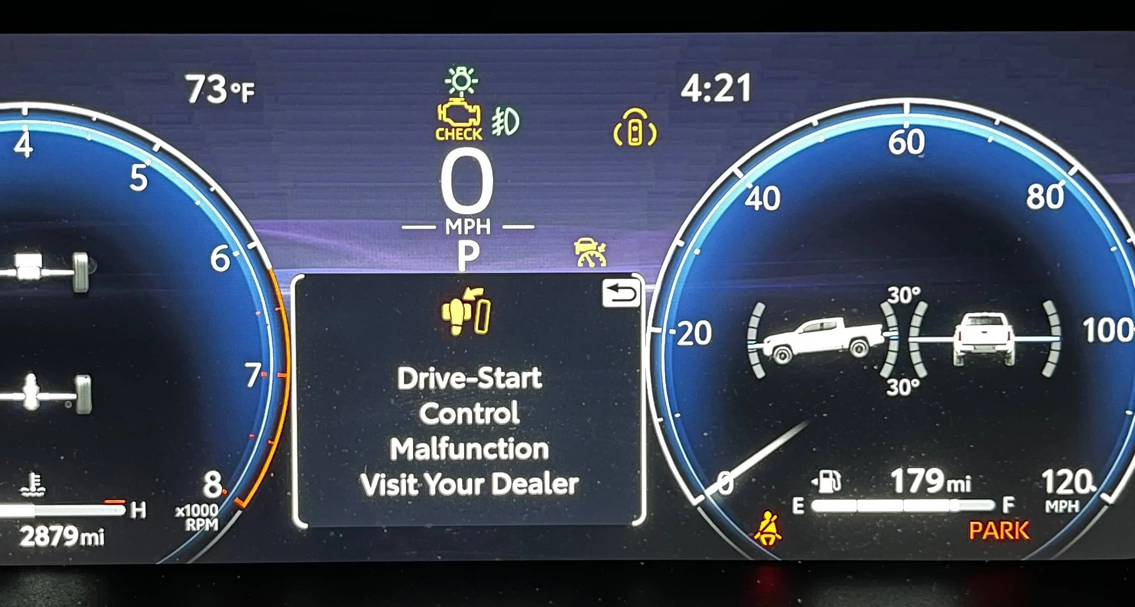

Welp, it was my turn. It's not like I didn't know it was going to happen. The error switches between grill shutter malfunction and drive-start control malfunction. Truck has 2,800 miles on it.
