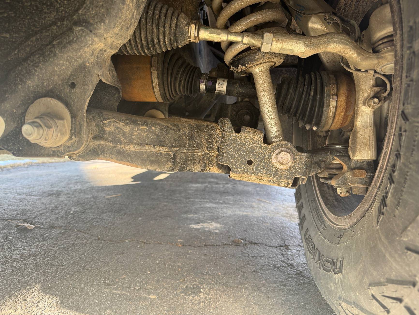

Just for reference, here’s mine with 1.5 inches of front lift.
I don’t think yours looks bad at all. Sucks that it’s leaking, just clean it and watch? Maybe tighten the clamp with a CV boot clamp tool? Definitely wouldn’t replace the entire axel unless it’s dry or dirt gets in it.
Thanks MT-Taco. I found a small pinhole tear in my boot. I'm not sure If I moved everything at a bad angle during my coilover install ,but I am going the route of ordering a new bootkit. The axle hasn't given me any trouble at all even with leaking some grease.

So just based on my interpretation of the video, he seems like he's trying to say anything other than the OR and up needs this diff drop when lifted (as in lower trims). To me it wasn't clear if it's needed and after reading a bunch of not so good reviews from vibrations with the Icon kit I rather not add more confusion to my issues. What I will say is that I ordered a new boot kit that has been delayed for a month or so. I'm convinced I made the hole when lifting the control arm to compress the shock. In the meantime, I got a gasket maker resin and applied it on the small pinhole I found and I have had zero issues since. I plan on replacing the boot for good measure. I also got a chance to get under a trail hunter at a dealership and well the CV angle is about the same. The trail hunter had a rather extreme looking angle as some commented on here from the factory. So I'm pretty convinced the CV angle is within range particularly since I've done a few road trips since and had no issues at all even before replacing the boot.

Yeah from what I've understood from my research not very many people have used that Icon diff drop kit when lifting the 4th gen and if they have I've read nothing but issues until one of the threads on a different forum said they reached out to Icon directly and they were told additional instructions when installing to properly get the kit to sit flush. I've read "vibrating" issues. My thoughts are that my truck isn't lifted much more than a trail hunter or a TRD pro if at all, King didn't recommend needing the kit, and ultimately my stupidity when doing the install is what caused the small hole. I will not be installing the Icon kit. I'd encourage you to go to a dealership and get under a pro or a trail hunter just to get an idea of what the CV angles look like. I also plan on putting a steel front bumper and a winch so that will bring it down a bit (fingers crossed).
