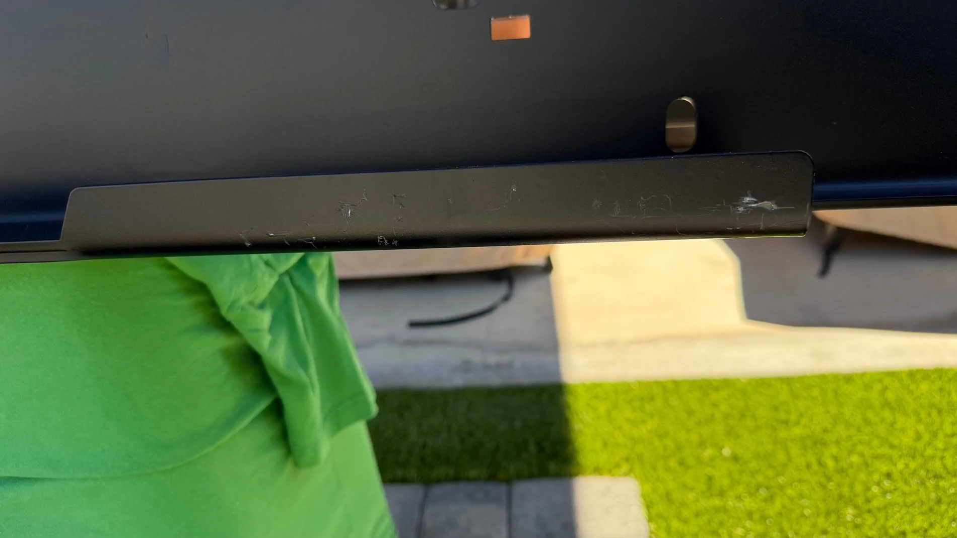

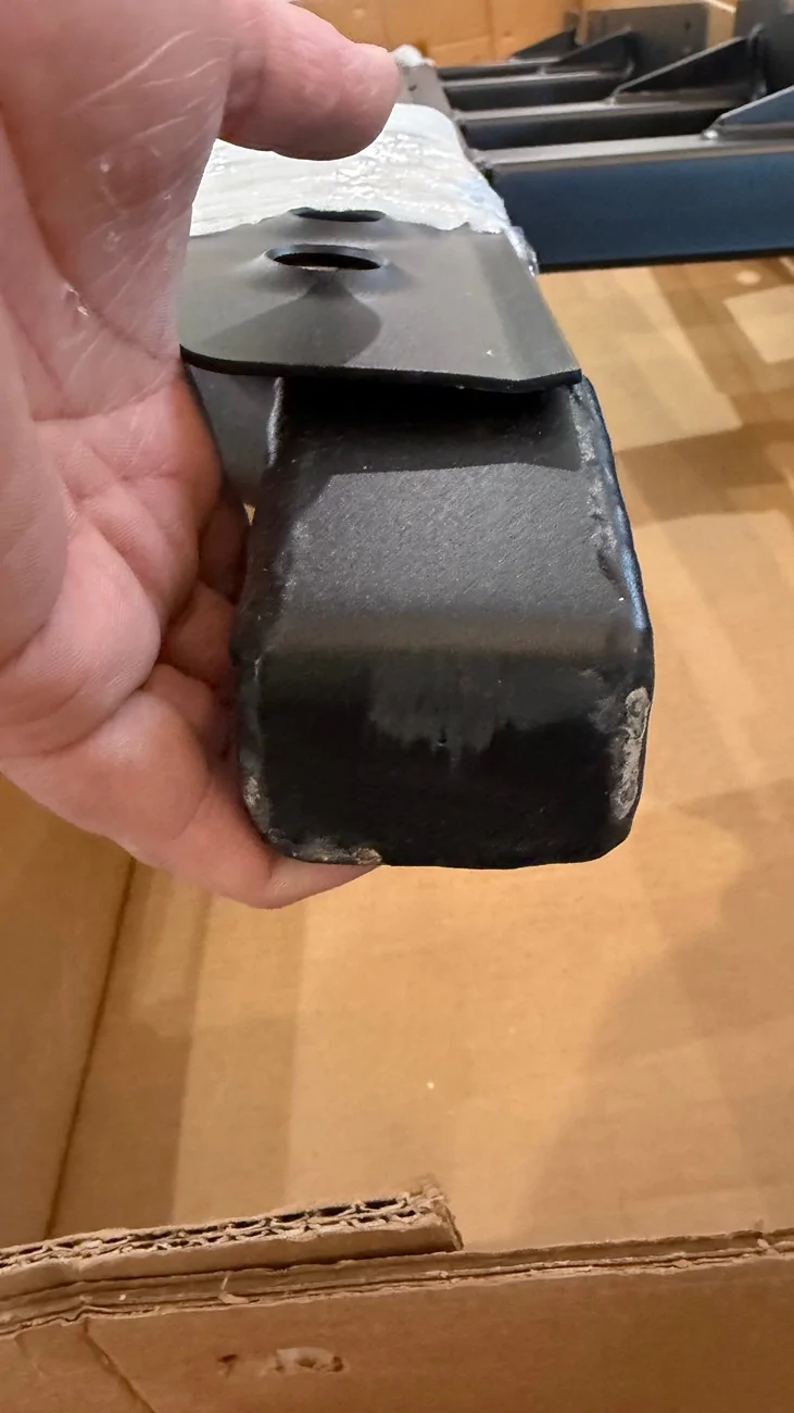

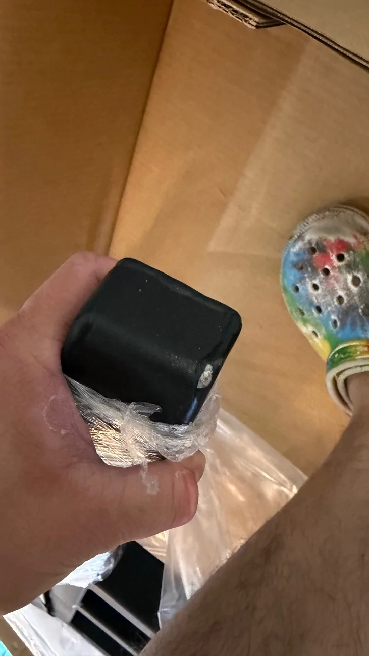

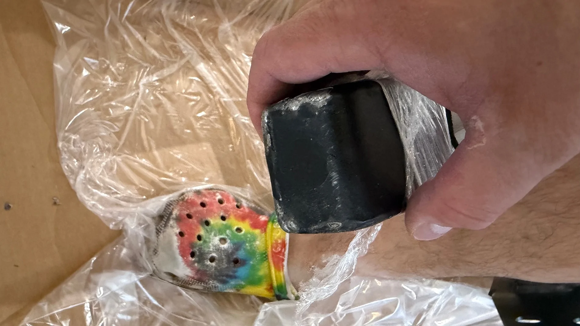

I recently purchased a new set of RCI rocksliders, but unfortunately, the flimsy box they came in caused the rocksliders to get scratched and scuffed at the ends. I sent them photos and they offered me a $75 discount and suggested I paint them. Now, I’m wondering if I’m being unreasonable for wanting more than $75 for the paint and the effort of painting them myself. I understand that they’re meant for off-road use and will eventually get scuffed up, But when you buy a new car you expect to be free of dents and scratches even though eventually it will have them?

I think that’s reasonable. I’d probably stay them with 3-4 coats in the damaged area.

Mine were delivered a month ago with similar damage. They were literally poking out of the box. I was going to hit them with a couple coats of rustoleum bedliner spray anyway, so I just laid it on extra thick on the ends that were dinged up.

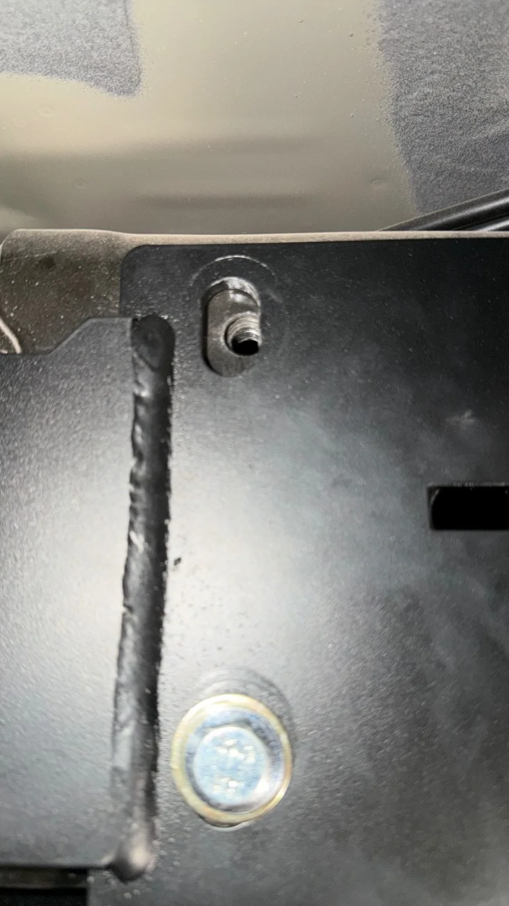

Yeah, I ended up doing the same thing. Did yours fit on your truck without any issues? Mine on the passenger side, one of the bolts didn’t align. I spent approximately two hours attempting to fit it, but unfortunately, it remained incompatible.

Get a step
get a step bit. Drill the hole out takes about 30 seconds. First pull all the bolts except one that’s furthest away, let the end down that needs drilled out then drill. This keeps the threads in the frame from getting damaged.

Good advice @MT-Taco. I had the same issue and I made it work by doing the same thing, but without drilling out the misplaced hole. The quality on my RCI sliders is great otherwise, and I am surprised that they have never fixed this.

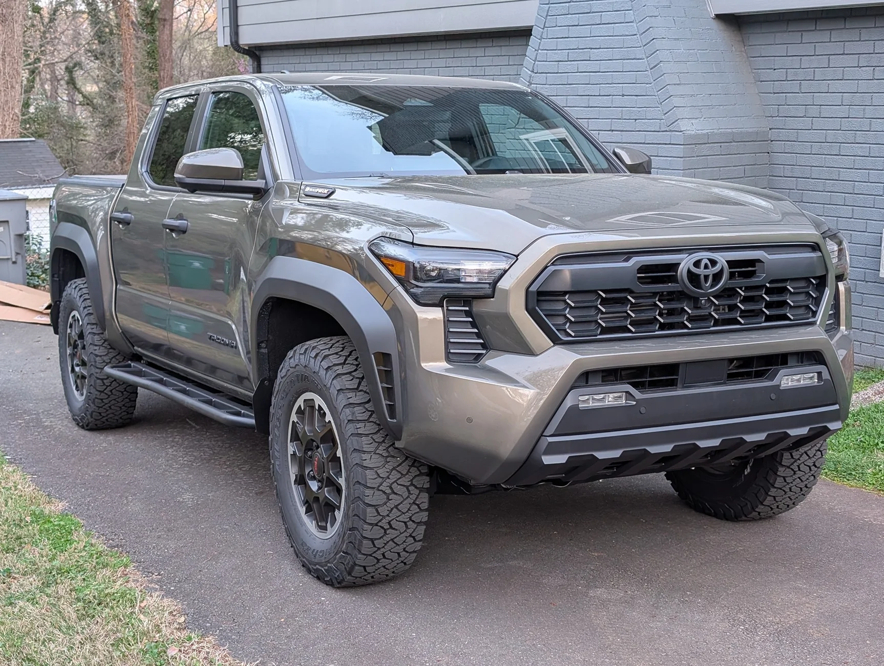

Nice rig!! That’s good that all your bolts fit exactly

Yes thank you, that’s what I’ll end up doing. I’m just annoyed that I had to paint them and now drill a hole to make them fit properly. I’m not the only one who’s experienced this, as evidenced by the reviews. I’ll never buy from RCI again.

One of mine was off a fraction. No damage.
