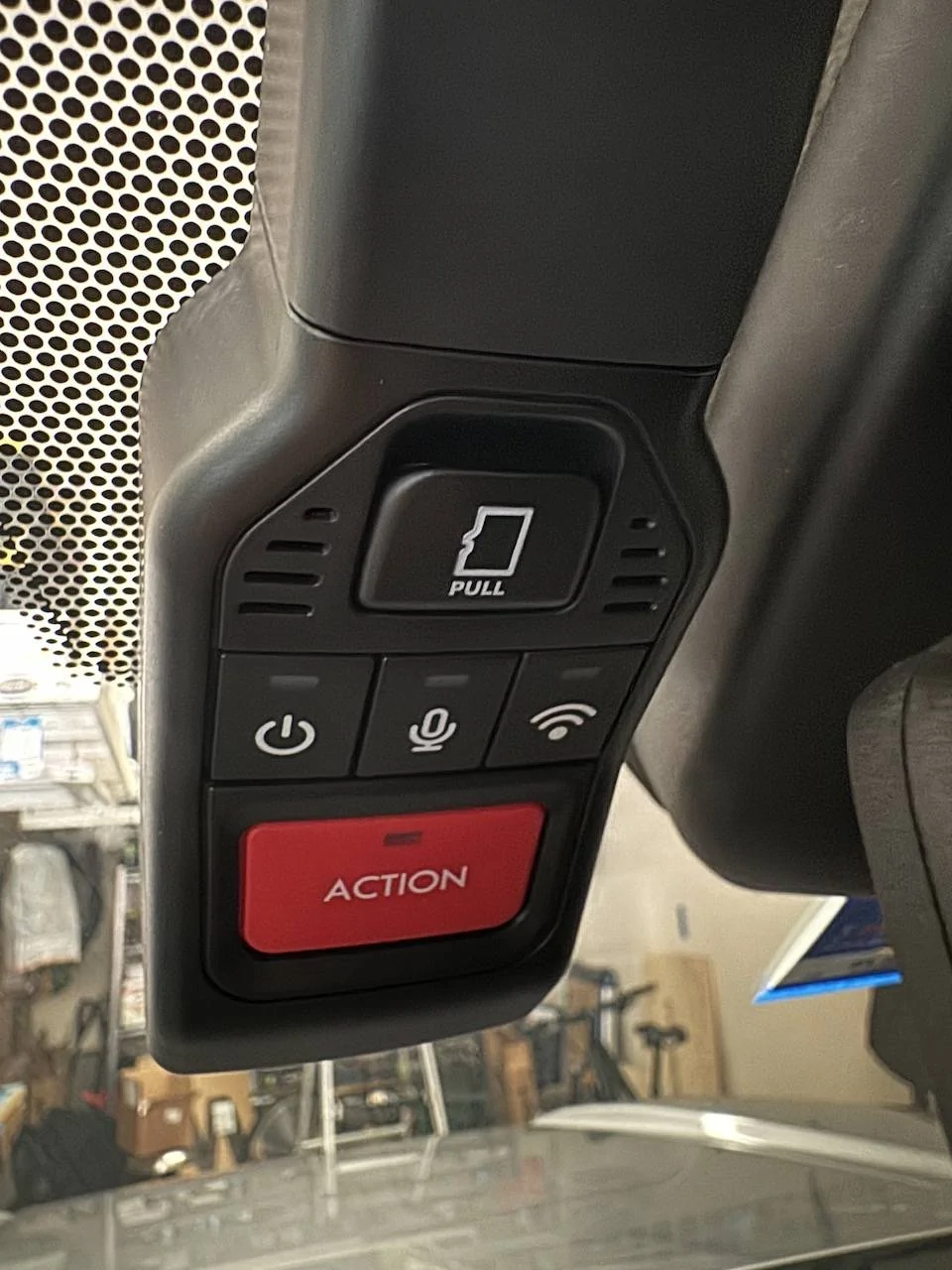

I also took out the card
I don't mean to sound like a numpty, but how do you remove the SD card? I've tried to eject mine but it defeated my intellect. Also, yeah the app is a pain in the ass to use. I can connect to the camera, but live view doesn't even work for me. I can see the files though.
So the picture of the micro sd card is the tray. At the top is a tiny notch for your thumbnail or fingernail. Just pull down and out and the entire tray will come out with the micro SD card. The live view is so slow. it will work if you wait long enough but very slow! it is faster to download the clip on your phone and watch it but still not that fast.
Thank you! I really appreciate it.

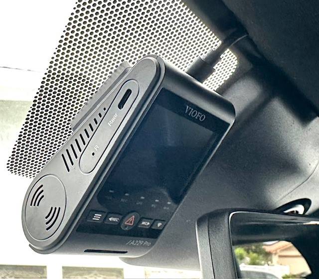

I ended up going with the Viofo A229 Pro, which I purchased from BBMC as Amazon didn't carry the 1 channel version and I wanted to keep things simple. My primary criteria when choosing a dashcam was good night time performance, such as that found in cameras containing the Sony Starvis 2 sensors. I've had good experience with Viofo in the past with family members '23 Taco and '17 Camry.
Next up, I ordered the Dongar 5-pin USB adapter as linked above, and removed the overhead plastic panel using a panel removal tool (Also exemplified in the above video on the Tundra). Patience is key here, as those clips (4 in total) are held into place quite good- just be gentle with the leverage. I did not remove any clips from the sun visor. I would say the overall wiring process took me about 5 minutes from start to finish, and I would consider myself a beginner with this type of job. What was nice about the 5-pin connection, at least on my 24 TRD OR premium package- it was completely unoccupied. There was nothing I had to disconnect, it was plug and play (See picture below of connector exactly how I found it). Important note here that this wiring does not allow for parking mode, but I'm waiting for more experienced folks to have fun exploring optimal fuse tap wiring setups before considering that route.
2024 Tacoma Dash Cam Solutions for 2024 Tacoma 1
One other note regarding the mounting of the A229 in particular, I needed to give it some space to the left of the mirror panel to allow for removal of the SD card as unmounting the cam/removing the card requires about 1/2" access towards the right of the camera. Overall I was pleased with how it turned out.
2024 Tacoma Dash Cam Solutions for 2024 Tacoma 3
If I had to recommend something a little cheaper within this family of Starvis 2 sensor cameras, I would consider the A229 plus (2K variant).

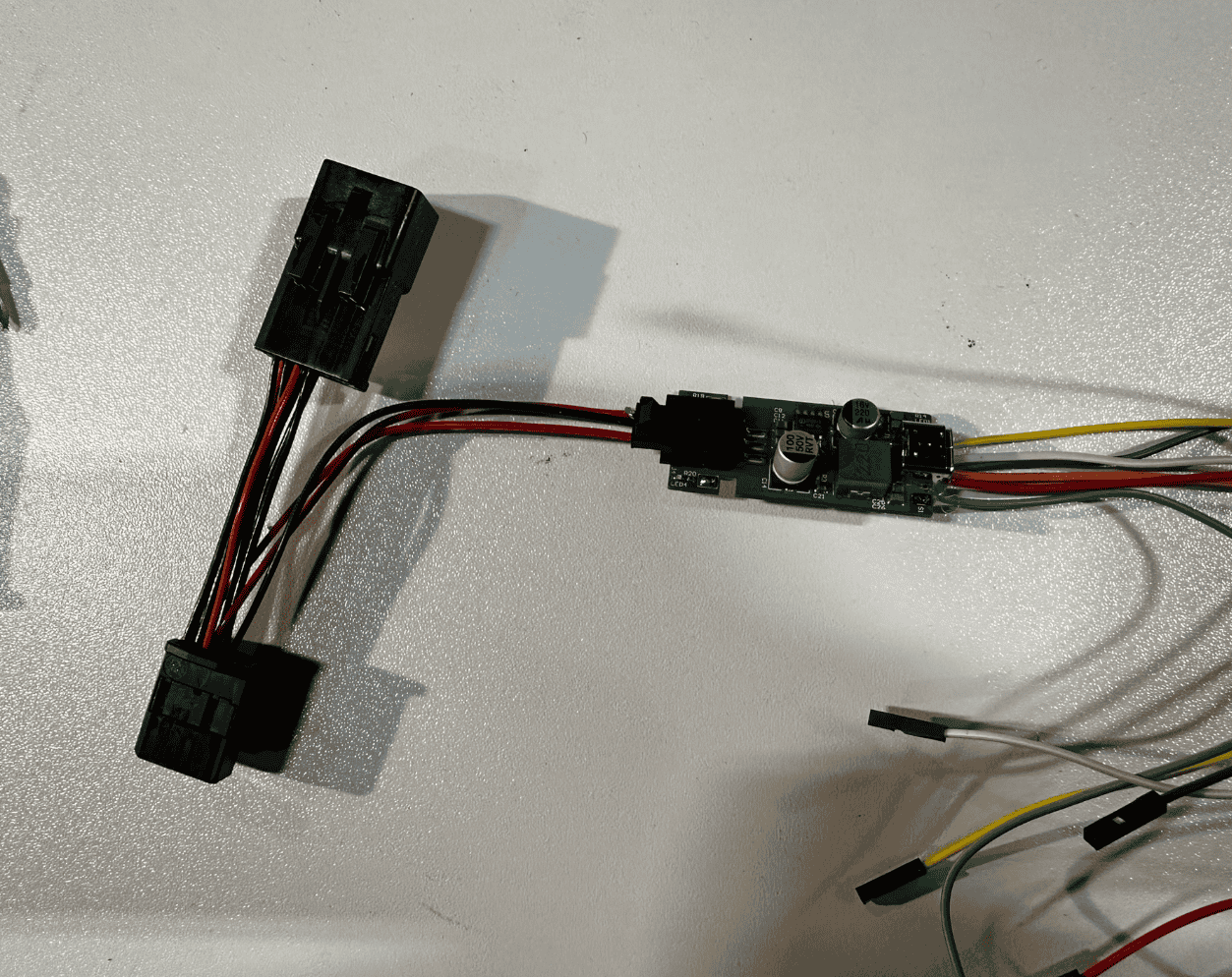

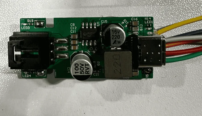

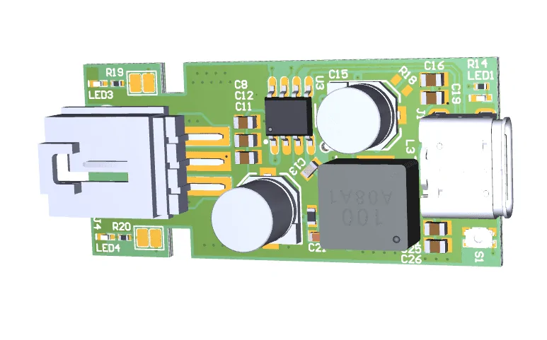

We're actually working on a parking mode adapter compatible with the 5-pin (the harness you found known as the roof connector) or 10-pin connector going to the mirror! It has a 3-position switch on it... mode 1 is ignition-switched only, like the current adapter, mode 2 is always-on with a 12V low-voltage auto shutoff, and mode 3 is low-voltage protection + timed shut-off (i.e. 16hrs or <12V, whatever comes first). USB-C means it can supply old school 5V microusb/miniusb cameras, as well as 12V blackvue cameras
The module is much much more improved, with USB-C output, an infinitely better buck module, and microcontroller with programmable status lights... prototypes are ready, but given our volumes required to source enough ICs, it's looking like a Q3 launch.
R&D sneak peek:
2024 Tacoma Dash Cam Solutions for 2024 Tacoma 1712249133956
2024 Tacoma Dash Cam Solutions for 2024 Tacoma 1712249118712
3rd generation Tacoma parking mode adapter prototype:
2024 Tacoma Dash Cam Solutions for 2024 Tacoma 1712249409688
BlackVue compatibility:
2024 Tacoma Dash Cam Solutions for 2024 Tacoma 1712249348476
PS, just picked up my brand new 2024 Taco TRD OR last night :cool:... more content to come!

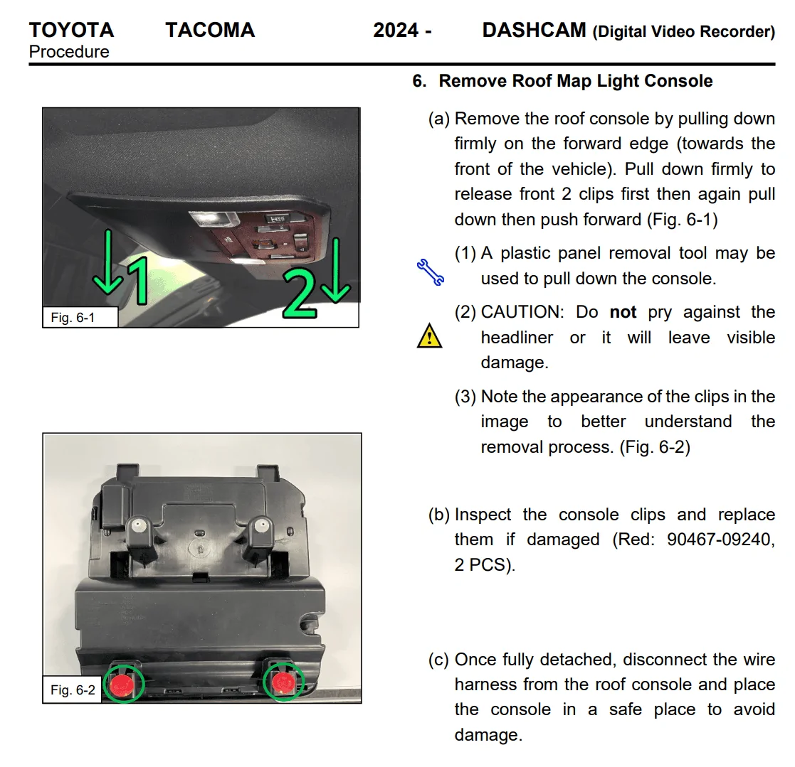

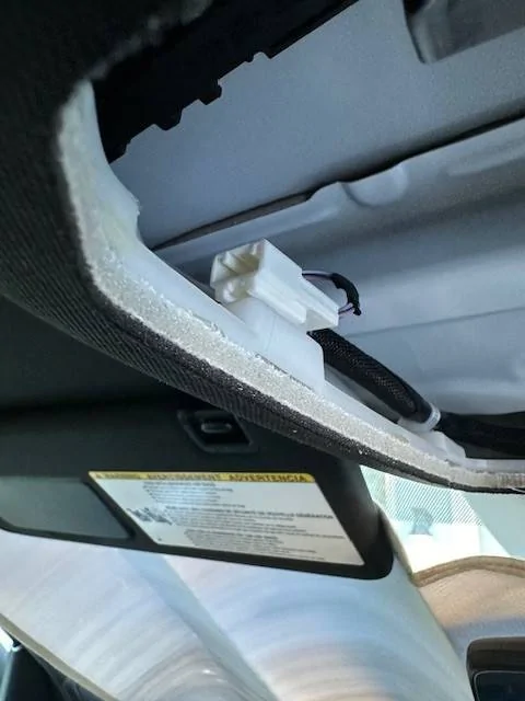

FYI, here are the official steps on accessing the 5-pin rooftop 'option' connector.. it is a tool-less process but it would be wise to use a flat & wide pry tool, if your fingers are too fat.
2024 Tacoma Dash Cam Solutions for 2024 Tacoma 1712249852868
Alternatively, you can access the 10-pin mirror connector (tutorial coming soon) which we also have a product for. The 5-pin connector is present in all 2024+ Tacomas and was placed to help upsell you on the OEM Toyota dashcam. The 10-pin is absent in the models without autodimming mirrors (i.e. SR5 without premium package). We have a slight preference for using the 10-pin connector since our current 10-pin dashcam adapter is designed to be windshield mountable whereas the 5-pin version is not. Our new parking mode adapter is modular and will include both 5-pin and 10-pin harnesses in one package.

Regarding your Figure 6-2, I thought my assembly had two additional red clips (instead of the smaller white), as I was surprised how hard it was to remove the other side, but maybe I'm misremembering.

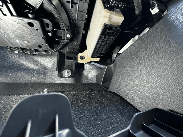

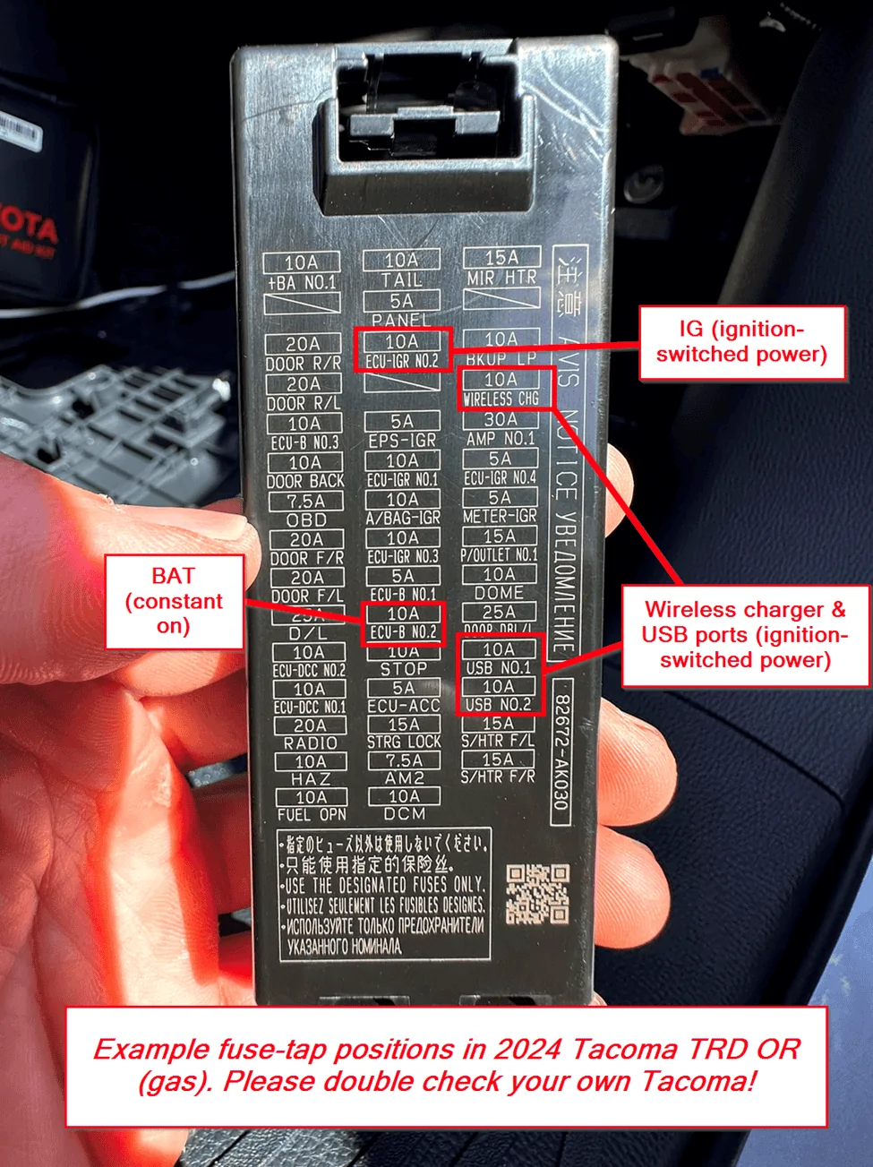

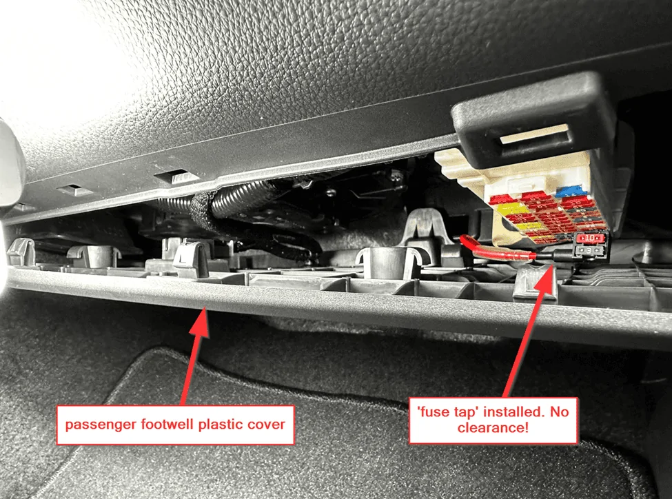

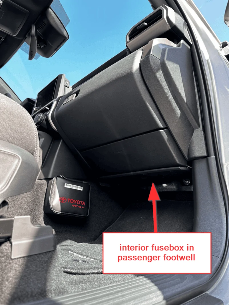

I checked out the interior fusebox on the 4th generation Tacoma to try out a couple of dashcam installation options. I got both a BlackVue dashcam (3-wire, with parking mode) as well as a traditional hardwire kit (2-wire, ignition-only) working….

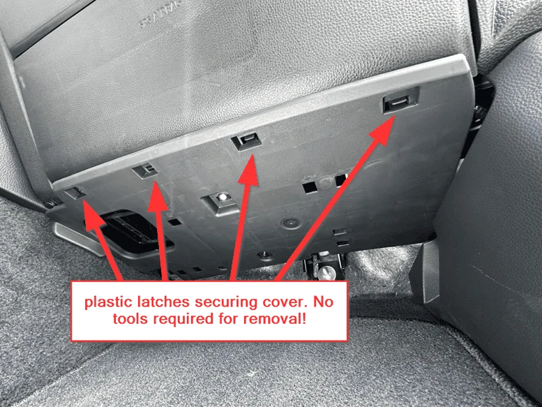

Skipping to the result…. Unfortunately the interior fusebox on the 2024 Tacoma (TRD OR gas model…. I’ll update after I confirm w/ a hybrid) is located under two plastic covers. There’s not enough clearance to put the plastic covers back on over a fuse holder (aka ā€˜add-a-circuit’ or ā€˜fuse taps’). As such, you must modify the plastic cover, or simply keep them off. This is a huge bummer for anybody attempting to use a fuse-tap style hardwire kit or dashcam!!
2024 Tacoma Dash Cam Solutions for 2024 Tacoma 1712600338621
Accessing 2024 Tacoma fusebox:
2024 Tacoma Dash Cam Solutions for 2024 Tacoma 1712600530972

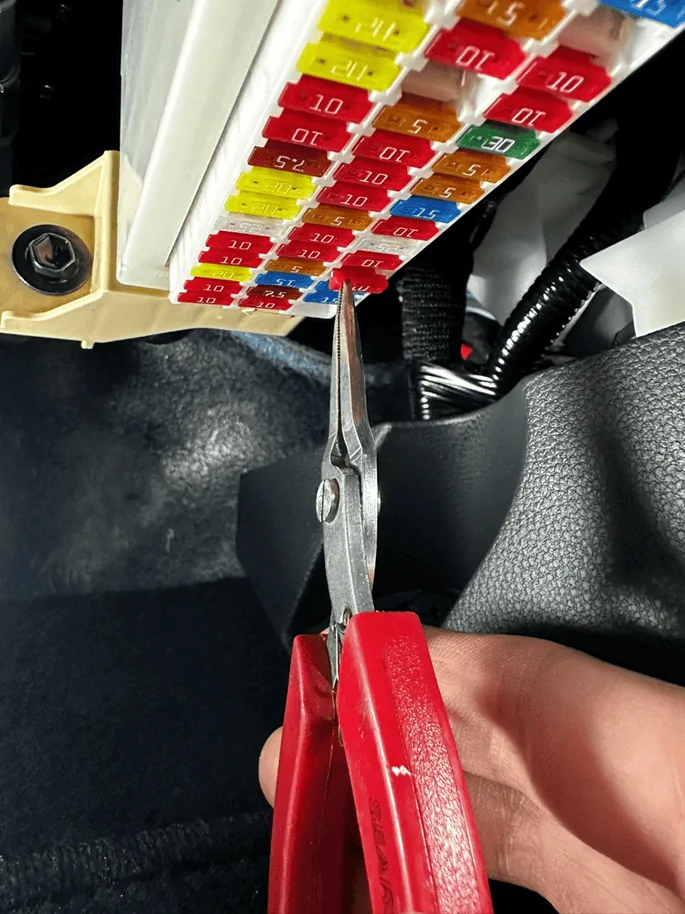

2024 Tacoma Possible Fuses for accessory installation. Do you own research and double check your own vehicle as these can and will change depending on model year, trim level, etc!
2024 Tacoma Dash Cam Solutions for 2024 Tacoma 1712600610510

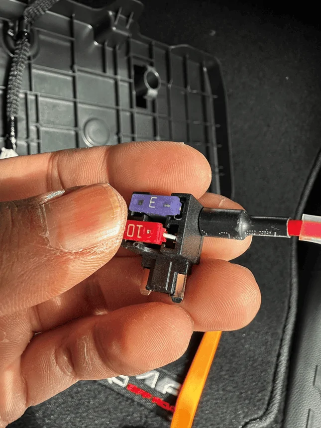

Low profile mini fuses can be pulled by needlenose pliers. Install fuse-tap.
2024 Tacoma Dash Cam Solutions for 2024 Tacoma 1712600624967
Original fuse usually goes into lower position. Only use fuses in this position with the designated OEM rating. Dashcam hardwire kits / BlackVue uses upper position … 3A in this hardwire kit example.
2024 Tacoma Dash Cam Solutions for 2024 Tacoma 1712600629878

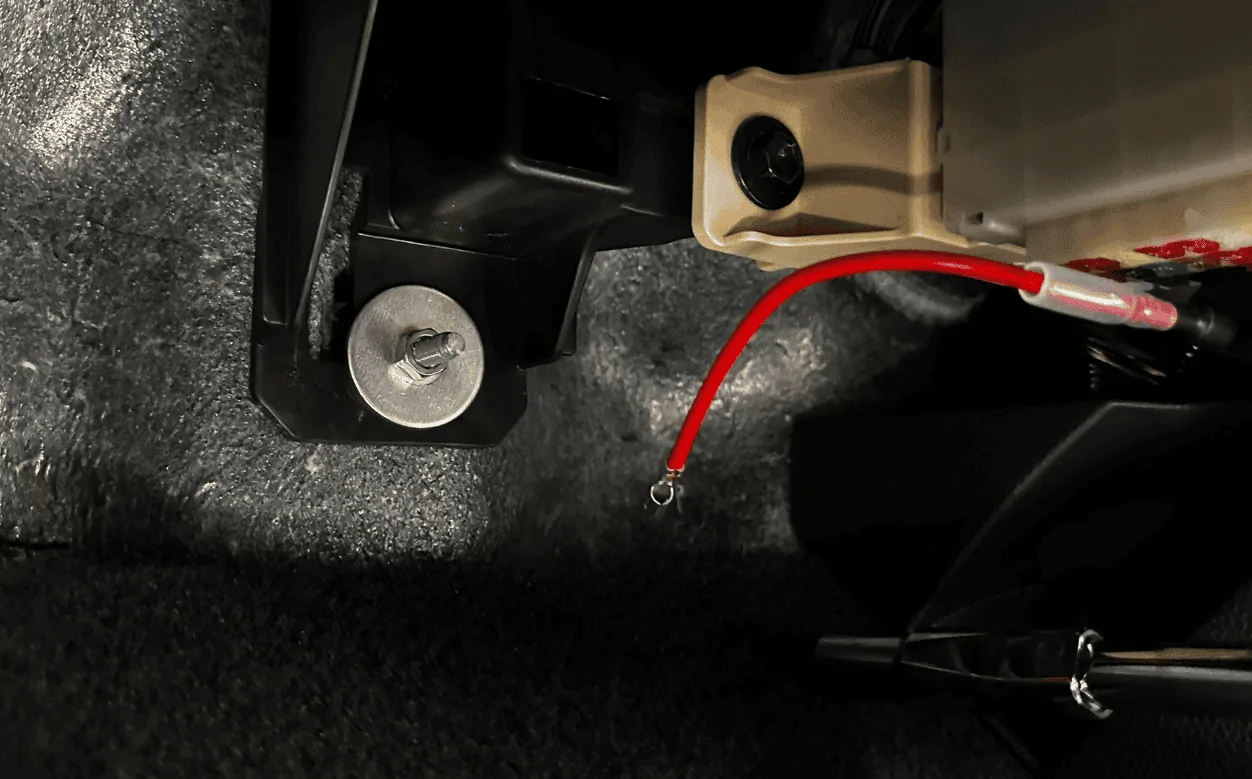

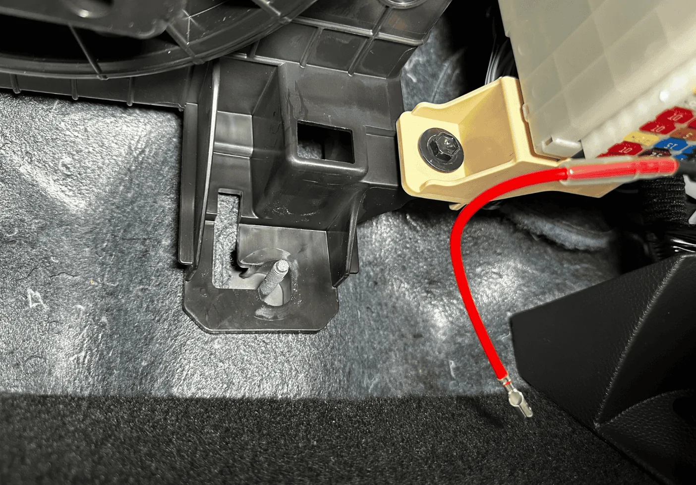

Suitable ground points are also slim pickings... There's this nut which turns out to be captive to a washer and not ideal for a fork spade as it’s also slotted behind. I’d recommend adding another nut on top.
2024 Tacoma Dash Cam Solutions for 2024 Tacoma 1712644540434
slotted behind nut/washer...means you can't secure a fork spade behind it.
2024 Tacoma Dash Cam Solutions for 2024 Tacoma 1712644468799
To be continued.
