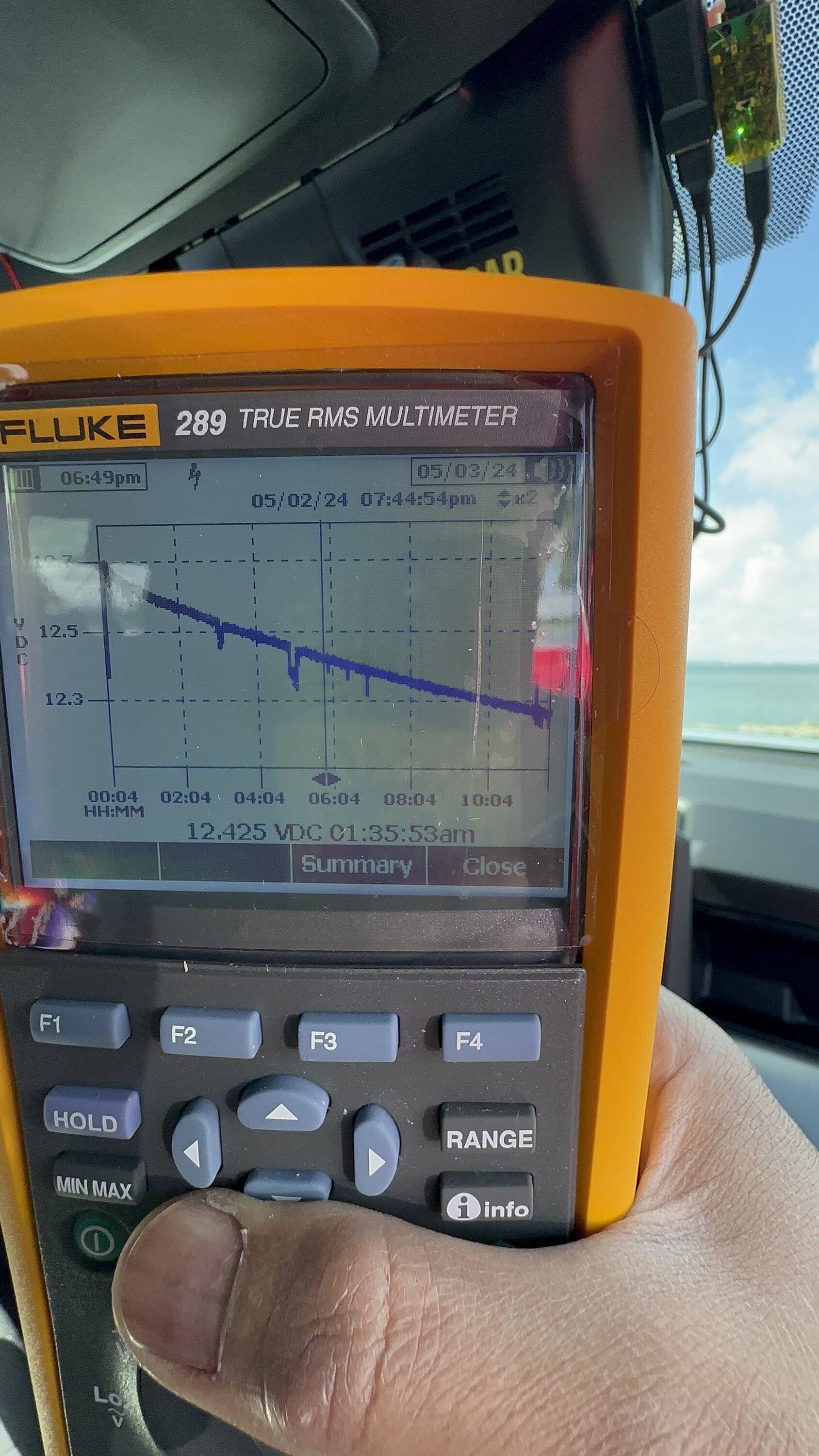

Testing battery levels with the BlackVue in parking mode and the Tacoma full OFF with my Fluke 289 logging voltage over a 24hr span.
The BlackVue 970x measured about 7W power consumption (parking mode, rear camera on, no cellular enabled). The brand new 12V oem Tacoma battery dropped from its 12.7V resting voltage to 12V in about ~18hr. I haven't tested draining it to below engine-starting levels but from what I've gathered from google, the danger zone is probably 11.8V and lower... or roughly 20-24hr on this setup. A smaller front-view only dashcam such as the Garmin Mini 2 only consumes about 3.5W so you could definitely stretch your battery depending on the camera.
I'm having a timed auto shut-off mode incorporated into our next generation Dongar PRO parking mode adapters for anybody who doesn't wanna risk draining their Tacoma battery too close to the danger zone.... I think maybe we'll split the difference and program the shutoff at 8hrs.
I'd love any opinions if people have any regarding:
-do you use or want to use parking mode on your dashcams? is it a must have?
-if so, how low are you comfortable draining your tacoma battery? (i.e. 11.8V, 12V? 12.1V?)
"Must have" - For some people I know who have had their car vandalized in secure garages, I think it's a great solution for those who don't want to make a visit to the local audio installation shop for wiring. Price vs convenience also definitely becomes a consideration here.
I know the Viofo kits have a cutoff voltage switch which may not be an easy implementation depending on how final your circuit is, but could account for lower voltages that come with aging batteries or situations where the car was used but not long enough to fully recharge the battery (a timer based solution that is agnostic to the voltage might accidentally drain the battery beyond a comfortable voltage if the car is turned on, used briefly, then parked again).

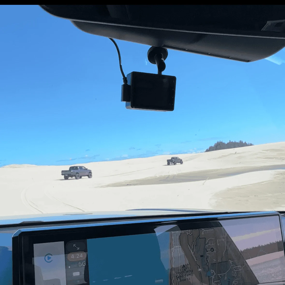

I've always just used a Garmin Dash Cam in my vehicles. My TRD OR is no exception. They sell them with an optional "constant power" cable that plugs into the OBD2 port that makes it super easy to use as a parking monitor. All you've gotta do is route the wire along the headliner and down the a-pillar. I could have placed it so the wire is totally hidden but I wanted the camera centered behind my rearview mirror.
2024 Tacoma Dash Cam Solutions for 2024 Tacoma dashcam
Here's the link: https://www.garmin.com/en-US/p/772586/pn/BUNDLE-DCLIVE-CPC

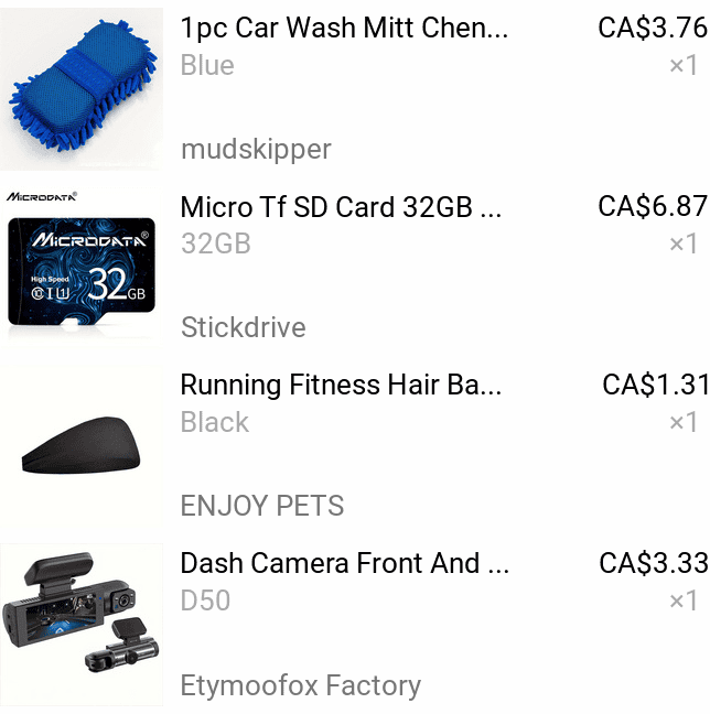

I spend US$ 2.43 for dash cam + US$ 5.00 for 32GB SD Card. (From Temu)
Total is US$7.43 for 1080 resolution 2 cameras (front 180 degree cam + inside cam)
I'm using it for 3 weeks now, and I'm very satisfied with recordings and other features.
I once considered OEM Toyota dashcam seriously, but I choose the cheap Temu dashcam.
And I'm satisfied, 95%. I would not spend $500 or more for dashcam.
Just for your information.
Below is Canadian dollars. ( I ordered more to meet the minimum $15 free delivery requirement.)
